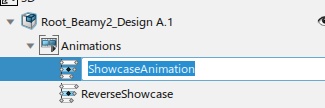

For ease of use, let's rename the animation into "ShowcaseAnimation" with the F2 keyboard shortcut or via right-click.

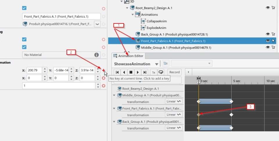

The animation will consist of Tracks representing each of the Actors and their animated properties. To create these tracks and add a keyframe, you can use the properties panel shortcut.
  1. By keeping open the Animation Editor panel and selecting the Actor in the project view, you will see new red dots in the Properties panel.
  2. Click on the dot next to transform values.
  3. It will create a new track for this property if one doesn't exist. (note: right-click on the dot for additional options)

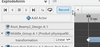

Record Mode
The Editor is capable of recording the modifications you do in the scene automatically.
To do this, toggle into Record mode via Record button.
Once you are done positioning your actors do not forget to leave Record mode with the same toggle button.

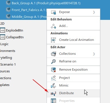

During Record mode, other authoring commands work and can be combined. For example, you can use the Distribute command in combination to create more than one key frame at once.

Let's rename this to "ReverseShowcase" and toggle on the Reverse option in the properties of our new Animation.
