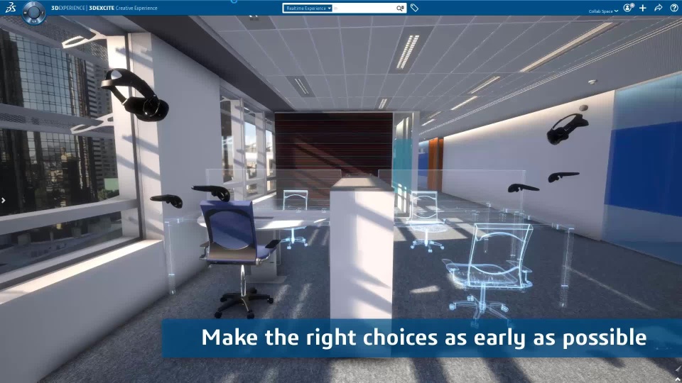

Interior, multi-user, immersive, design experience
The video showcases four users equipped with four HTC Vive devices that are connected to the same experience. They can see each other, and they can also teleport themselves within the scene. By accessing the immersive inventory, users can choose a piece of furniture and dynamically place it on the floor. The paint palette is then used to switch material options on the furniture providing a level of interaction that invokes a sense of ownership over the product and the final design.

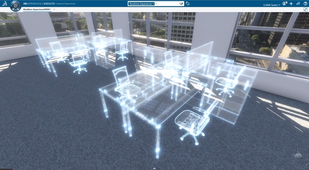

1. Create a layout template to assist the end-user
It’s highly recommended to provide a layout template for the user of the experience so they understand the purpose of the VR scenario. This template should include ‘ghosted’ furniture items that can be realized by adjusting the “Edge Bias Color” parameter of the specular/glossiness complex material type in the application.

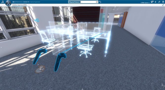

2. Add VR to theExperience
In the Immersive Virtuality section of the action bar, you can create a VR Headset Preset. It comes with two controllers, the headset and the navigation context. This preset also provides javascript functionality scripts so the user can teleport themselves, play and grab things easily. Here, for example, a user can grab the whole office set up! :)

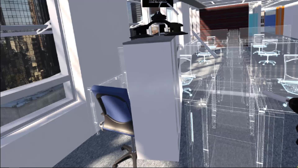

3. Customize the VR preset to create a “palette”
«The palette» is an immersive interface. in this case, it allows the end-user to simply search through an inventory catalogue , choose a furniture piece and place it on the floor.
With «the palette», users can change the materials for the different pieces of furniture.All these custom behaviors have been implemented by adding code to the ‘built-in’ scripts provided on the HTC Vive preset.

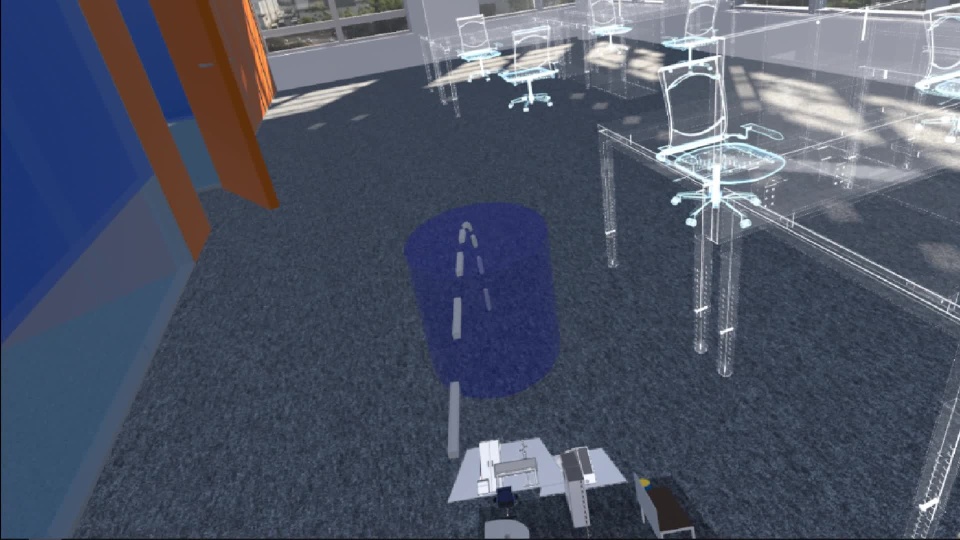

4. Make it multi-user
Custom javascript is so powerful that we created one to handle a multi-user experience. Start a ‘node-js server’ on one of the computers playing the immersive experience – this will act as the hosting computer. On each host, add the IP address of that hosting computer. When played, each host will appear in the experience.
