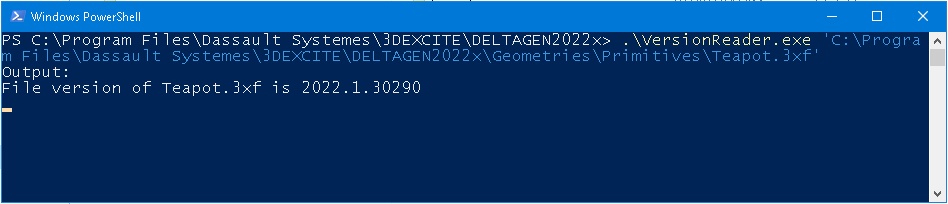

Version reader
The version reader is a command line application, which allows to show with which version of DELTAGEN a dataset was created.
We extended it, so that it supports both csb and 3xf files. Please be aware to always pass the absolute path pointing to the dataset.

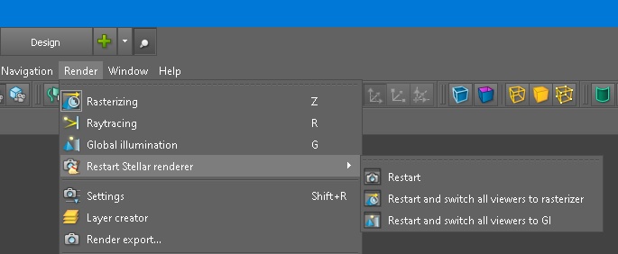

Restart Stellar renderer
GPU memory is limited resource and needs to be well utilized. With a restart option for the Stellar renderer unused memory (e.g. of cached objects) can be freed up.
The details are explained in the user guide of DELTAGEN.
