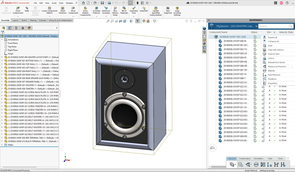

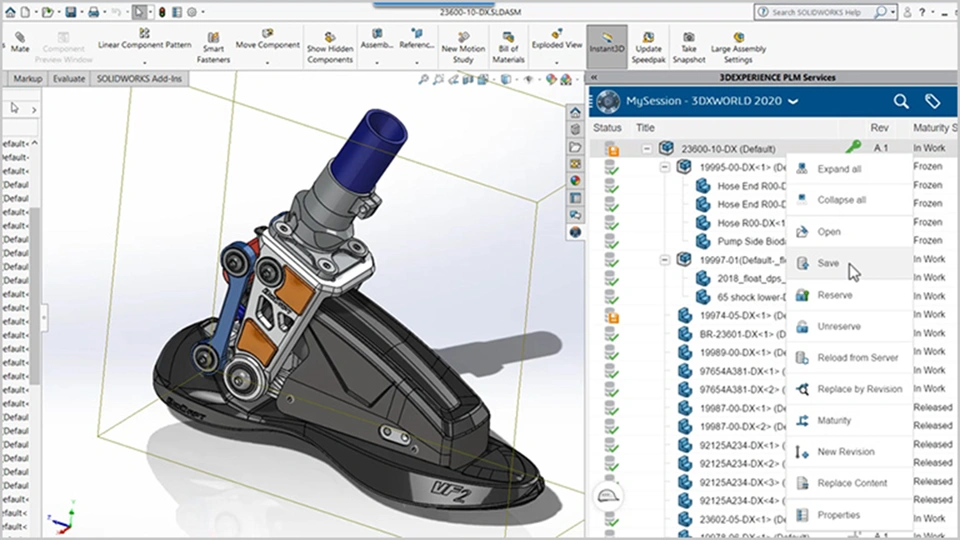

  1. Use 3DEXPERIENCE SOLIDWORKS Premium on the tenant to save files to the platform. Once data is on the platform (Collaborative Space, specifically), it can be used across other Apps.
  2. Or install Collaborative Designer for SOLIDWORKS, a small addin to your desktop SOLIDWORKS, to save files to the platform.

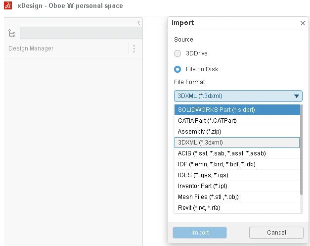

  3. Or import SOLIDWORK parts, STP files or other formats to xDesign on the platform. Then these saved physical products will be usable in xStudio😄
