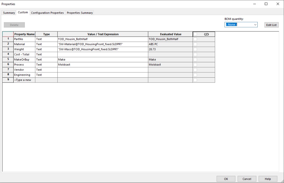

Hi Folks!

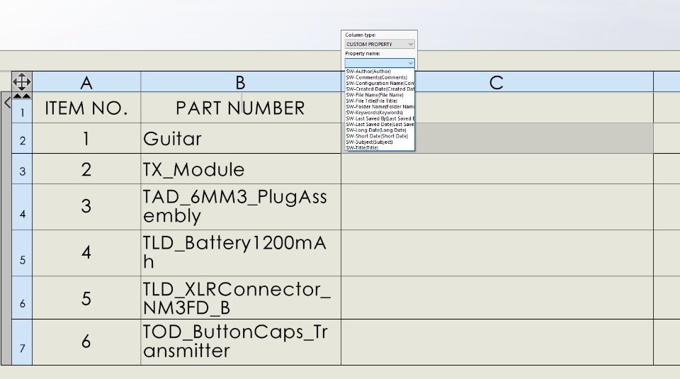

I have a few parts with assigned custom properties. I Can see the properties just fine in the "properties tab" for each part, but i cannot select them in the BOM table whenever i insert them in a drawing. (See pictures)
I am using 3D experience

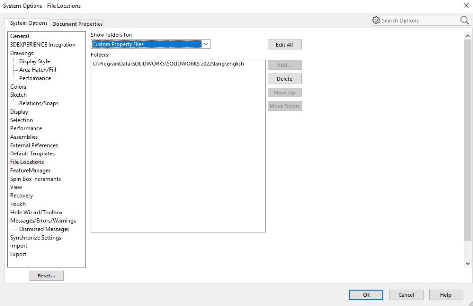

I have already changed the custom property file location to the proper location: C:\\ProgramData\\SOLIDWORKS\\SOLIDWORKS 2022\\lang\\englishA
However, they still refuse to show up in the drawing? Anyone have some suggestions as to how i should fix this?
