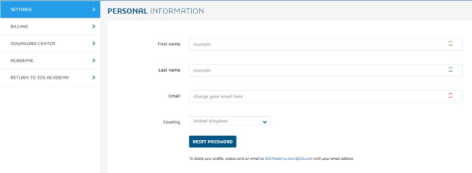

Update my login email and personal information
To update your login email (or your personal information), please connect to your Download Center and go to Settings (Click on CONNECT at the top of the page >Login > then click on your initials to access to your profile)
Change my password
A/ If you don’t remember your current password: Click on the CONNECT button on the top bar, then, on the “?” to activate the Forgot Password form
B/ If you remember your password but want to change it: Access to your account (CONNECT > Login > click on the top circle with your initials), in the Settings tabs, you have your personal information, click on the “Reset Password” button.
