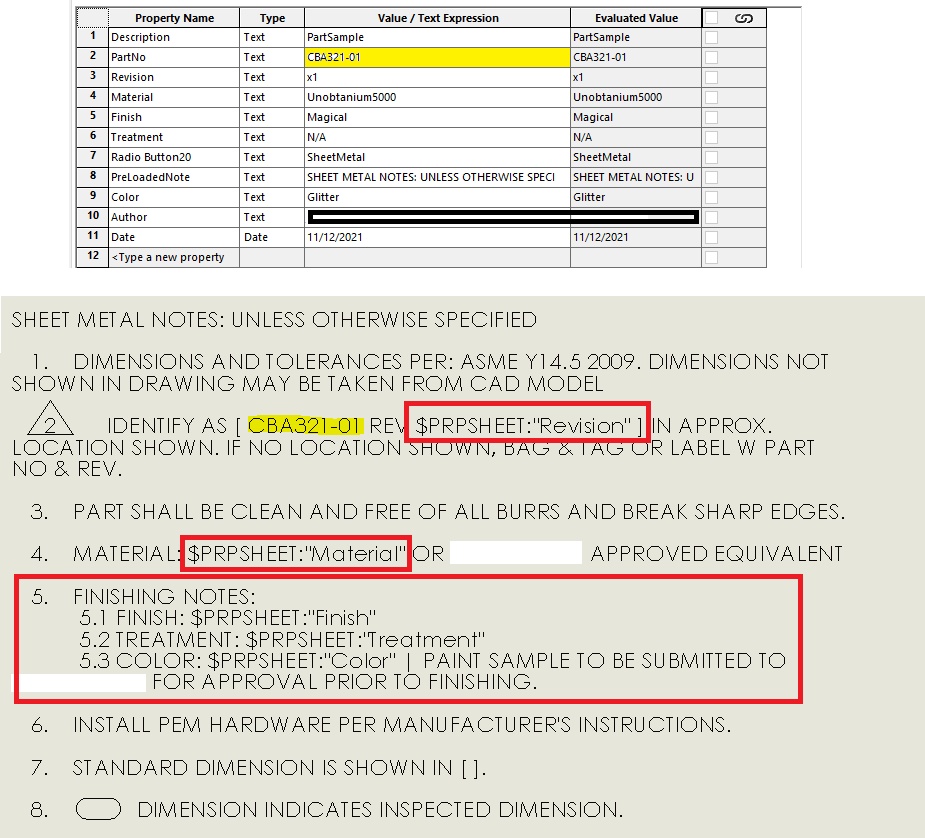

So I've been working on an excel file to create "Default notes" that are used in different types of drawings (Sheet metal / Machined / Molded / Assemblies / etc...).
Obviously these notes are intended to make everything semi-automated and much simpler for the user, One of my notes reads as follows:
IDENTIFIED AS [ \\\$PRPSHEET:"PartNo" REV \\\$PRPSHEET:"Revision" ] IN APPROX. LOCATION SHOWN. IF NO LOCATION SHOWN, BAG & TAG OR LABEL W PART NO & REV.
Additionally there are more multi-line notes that can be added (loaded via excel ref. file).
The problem is that once the note loads into the drawing, only the first \\\$PRPSHEET: reference works, all the others do not get "replaced" by the data.
Now, I originally thought that maybe I had a typo somewhere so I copied the note from excel and pasted it in solidworks and voila, everything worked beautifully and all the \\\$PRPSHEET callouts got replaced by their corresponding data. So that tells me that there are no Typos in my note. . .
However, when I "auto-load" the note from Excel (via the custom-property tab builder) only the first \\\$PRPSHEET callout gets replaced by its corresponding data, the remaining \\\$PRPSHEET callouts do not.
Why?
How do I fix this?
See picture for reference,
