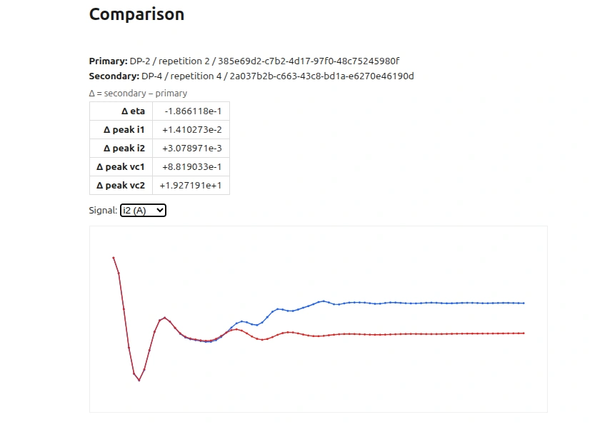

EP-001 — Continuous excitation
The first experimental program investigated the coupled system under continuous sinusoidal forcing.
Among its results, EP-001 established the characteristic coupled-mode structure of the simulated plant and provided the continuous-excitation baseline for later experiments.
It also became a much larger investigation into measurement-only adaptive resonance tracking.
Several controller architectures were explored.
That investigation did not end with the positive adaptive-control result I originally expected.
Different approaches failed for different reasons: acquisition latency, reference invariance, observation-window requirements, and ultimately the relationship between the plant's relaxation timescale and the time available for control.
One particularly important software defect was also discovered during this work.
A variable-frequency drive had originally been evaluated as:
V(t) = V0 sin(ω(t)t)
against an absolute simulation clock.
That expression is correct when frequency is constant, but changing ω instantaneously while retaining absolute t introduces an artificial phase discontinuity.
The drive implementation was corrected to maintain an accumulated phase satisfying:
dθ/dt = ω(t)
with:
V(t) = V0 sin(θ).
Experiments affected by the defect were explicitly marked suspect and rerun rather than silently replacing their previous results.
Some controller behavior improved dramatically after the correction, but subsequent experiments still identified genuine architectural and observation-timescale limitations.
Ultimately, the adaptive comparison originally intended by EP-001 could not be executed under its own measurement-only and timing requirements.
The hypothesis was therefore left unresolved, rather than being converted into either a success or failure after the fact.
For me, that became one of the most useful outcomes of the first program.
TesLab had already been designed around the idea that an experiment should be allowed to reject the researcher's expectations.
EP-001 was the first time the project actually had to do it.

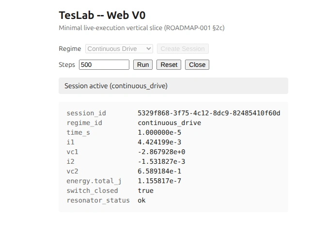

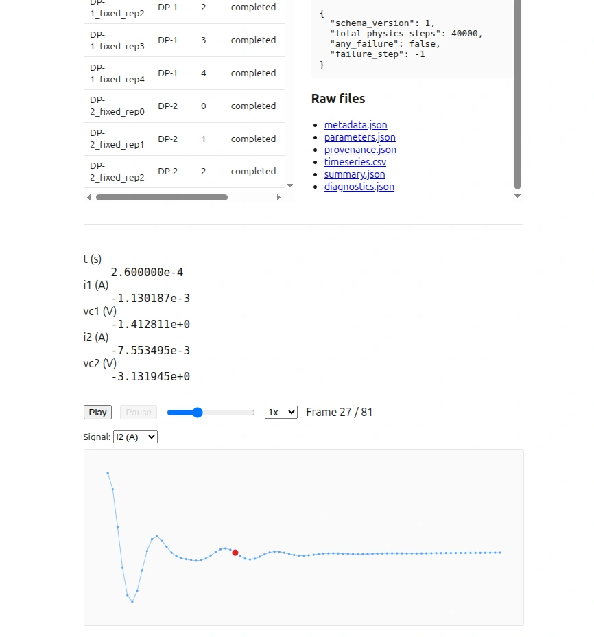

Running the experiments interactively
The virtual twin is now a real-time application rather than a prerecorded visualization.
Experiments can be:
Run
Paused
Stopped
Reset
and viewed at different presentation speeds.
Changing the presentation speed does not change the validated numerical timestep. The simulator simply executes the appropriate number of fixed physics steps between rendered frames.
This is particularly useful for the free-ring experiment because physically interesting energy exchange and decay occur on timescales that are too fast to inspect comfortably at literal real-time presentation speed.
The interface also supports screenshots and video recording directly from the application.

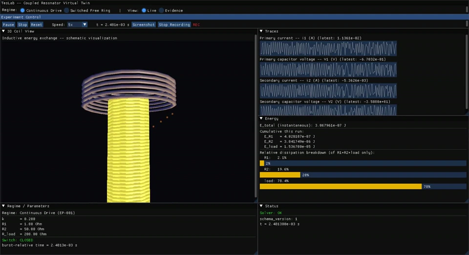

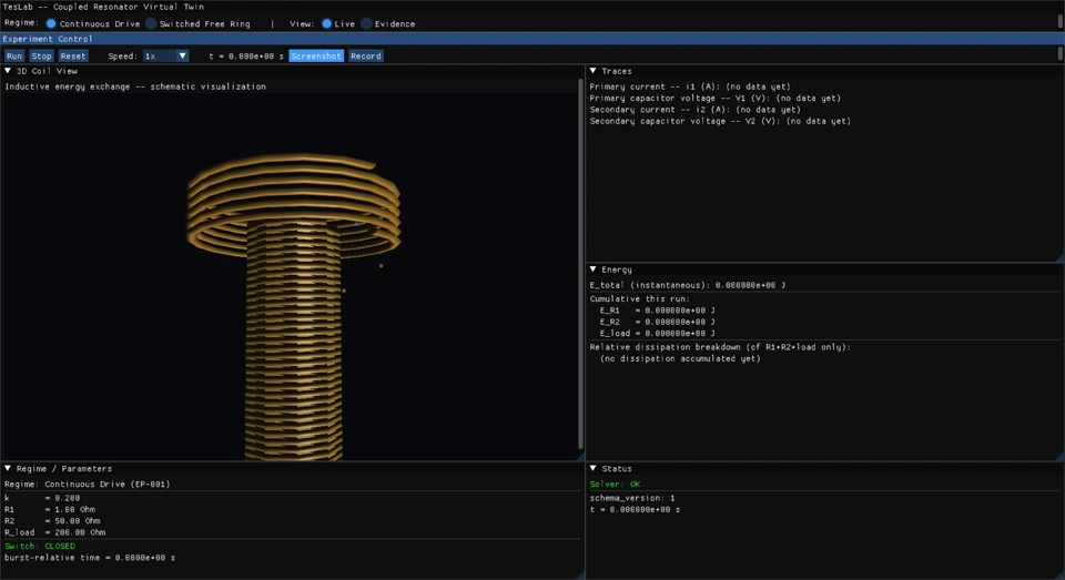

This sequence shows the coupled system under continuous sinusoidal excitation.
The electrical traces, energy accounting and 3D representation all originate from the evolving numerical state.

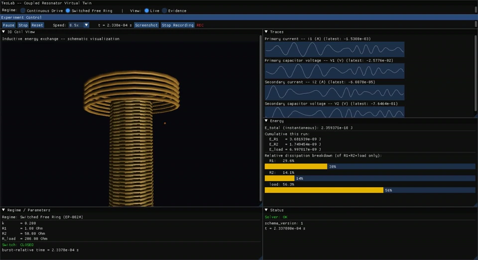

Switched free-ring response
This sequence shows the source-free natural response used by EP-002A.
The visible beating and decay are not scripted animation.
They emerge from the same coupled differential equations used by the experiment from which the modal frequencies and energy measurements were obtained.
The animated particles between the primary and secondary are intentionally schematic: they represent inductive energy exchange visually, not literal charges travelling between the electrically isolated conductors.

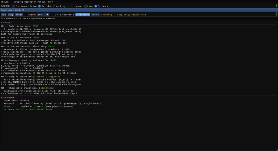

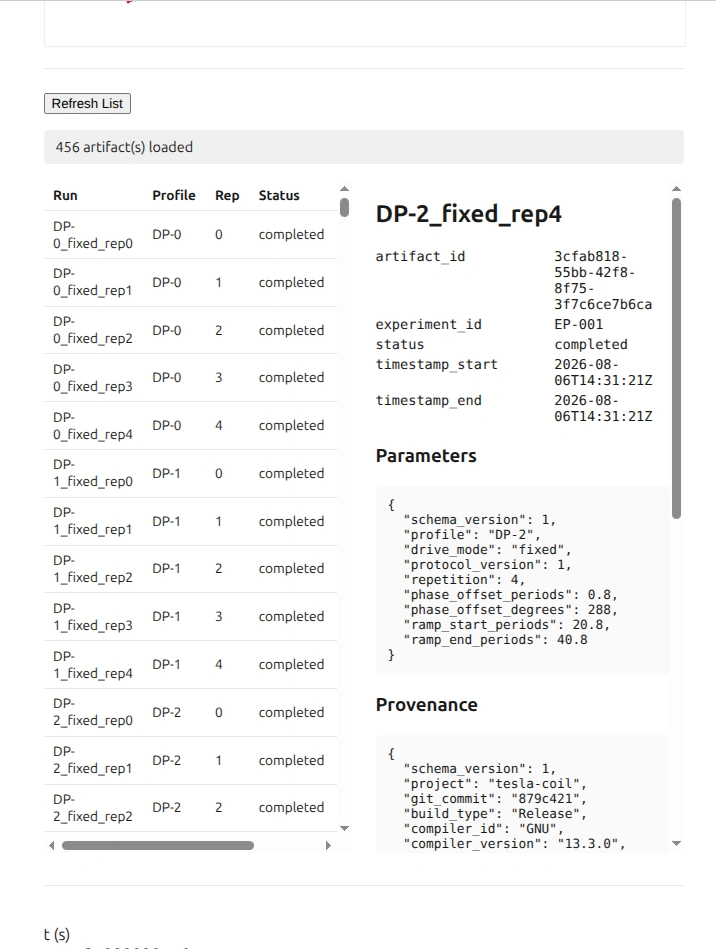

Separating live state from scientific evidence
I also added an Evidence Mode.
This distinction is important to me.
The live virtual twin consumes instantaneous simulation snapshots.
Experimental conclusions do not.
Recovered spectral peaks, modal amplitude ratios, hypothesis dispositions and other accumulated results are produced by experiment-level analysis and stored as evidence.
I therefore keep those two paths structurally separate:
live simulation state ≠ post-processed experimental evidence
The visualization can display both, but it should not blur the distinction between them.
A principle that emerged from this work is:
The visualization observes the experiment; it does not define the physics or manufacture the evidence.
The research record matters as much as the final screenshot
TesLab's research workflow currently follows approximately:
Research question → predefined protocol → validation → execution → amendments/corrections → evidence → closure
One of the things I wanted to test when starting this project was whether that degree of scientific governance would actually remain useful once experiments became complicated.
EP-001 and EP-002A provided a fairly strong test.

Where TesLab stands now
The first continuous-excitation investigation, EP-001, is closed.
The first switched/free-ring investigation, EP-002A, is also closed.
The coupled-resonator numerical foundation has dedicated validation for its major numerical and physical invariants.
The simulation now exposes a stable snapshot/output contract.
And the interactive virtual twin can execute and visualize both experimental regimes through the same observational architecture.

The 3D representation is useful because it makes the system easier to explore.
But it is not the end goal.
The goal is the experimental process behind it:
reconstruct the mechanism, validate the model, ask a precise question, run the experiment, preserve what actually happened, and let the evidence determine what deserves to be investigated next.
That is the direction I intend to continue exploring with TesLab.
From desktop application to research platform
Since completing the first research cycle, I've also finished the first web interface for TesLab.
Rather than exposing simulator internals directly, the browser communicates through a versioned HTTP API backed by a stable C ABI and Python ownership layer.
The first web version is intentionally minimal: create a simulation session, execute it, reset it, inspect the current state, and close it.
The purpose of this first slice was not visual richness, but architectural validation. It independently confirmed that the complete chain, from browser to native solver and back, operates correctly through explicit interfaces rather than shared implementation details.
This architecture now allows multiple future interfaces (desktop, browser, analysis tools, automation) to consume the same validated simulation engine without duplicating physics or diverging implementations.
The simulator is now also accessible through a browser-facing API. The first web interface is intentionally minimal and exists to validate the complete browser → API → native solver execution chain before richer visualization is added.

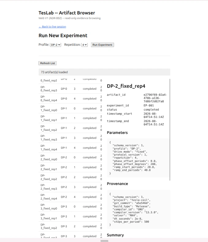

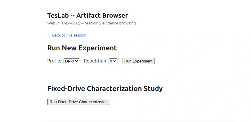

Defining an experiment
The first implemented workbench slice deliberately stays small.
Rather than exposing every simulator parameter immediately, it allows selecting one predefined experimental condition from the validated EP-001 protocol.
The browser therefore defines an experiment rather than directly manipulating simulator internals.
This minimal interface intentionally mirrors the existing experimental protocol instead of inventing a second way to describe the same study.
Native execution remains authoritative
Submitting the experiment does not execute any physics inside the browser.
Instead, the browser communicates through the versioned HTTP API to the Python backend, which orchestrates native execution.
The numerical simulation still runs inside the validated C implementation that produced the original experimental results.
The web layer defines the experiment and supervises execution.
The C implementation remains the single authority responsible for the experiment itself.

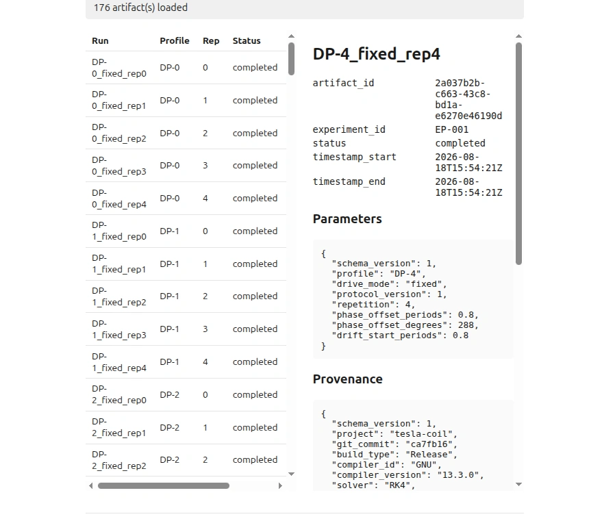

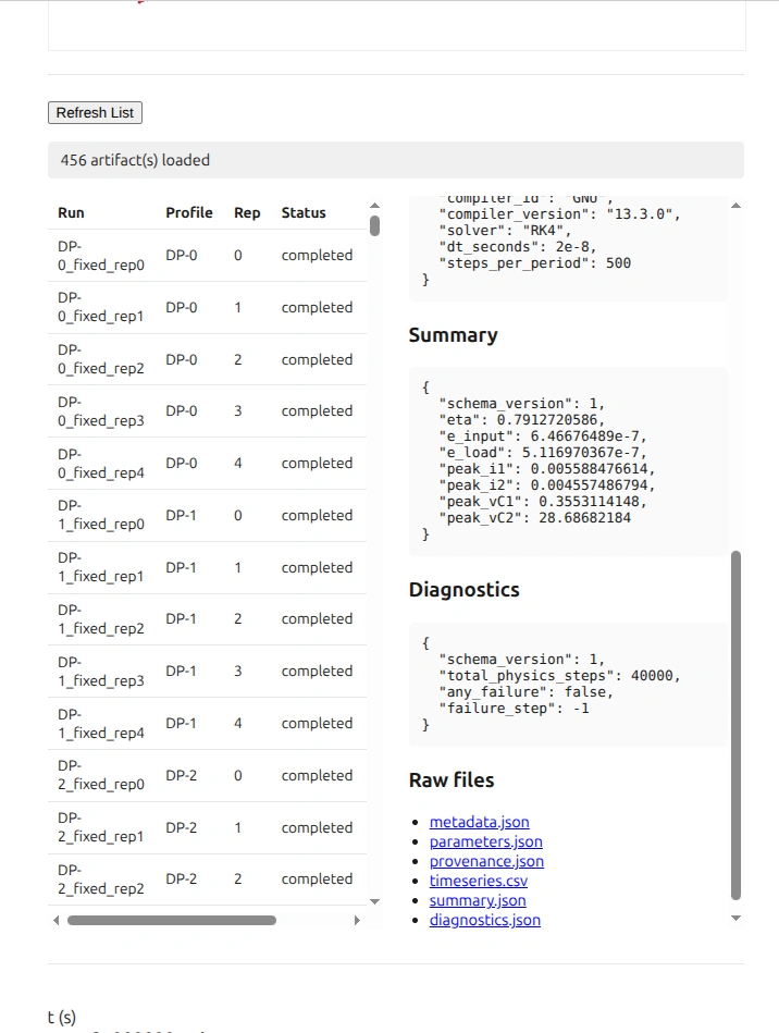

Immutable publication
When execution finishes successfully, the result is not simply displayed.
It is published as a new immutable research artifact.
That artifact enters exactly the same evidence system used by every previous experiment.
Nothing special exists for "web experiments."
Browser-triggered experiments and batch-generated experiments become identical research objects once published.
Immediate evidence review
As soon as publication completes, the browser automatically opens the newly created artifact.
The existing artifact browser immediately becomes the review interface for the experiment that was just executed.
This was an important architectural milestone for me.
The web interface does not maintain its own representation of experimental results.
It simply becomes another client of the existing immutable evidence architecture.

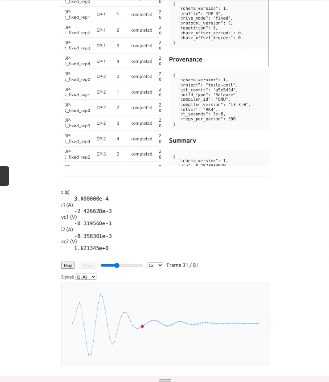

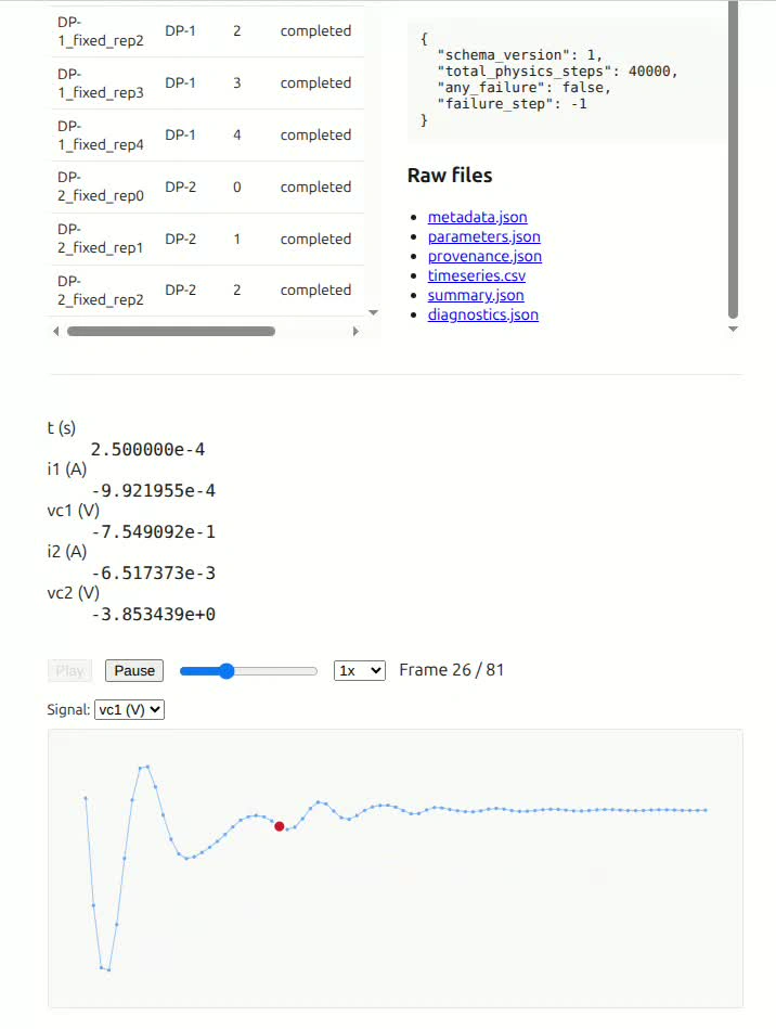

Replaying the experiment
The browser can now replay the recorded trajectory directly from the published artifact.
Playback controls, synchronized numerical readouts, and the trajectory plot all operate on recorded experimental data rather than a live simulation.
The replay system deliberately distinguishes recorded measurements from interpolated visualization.
Each recorded sample remains individually identifiable while the connecting line exists only to improve readability.
Exploring different observables
Different physical quantities can be reviewed without rerunning the experiment.
The trajectory viewer allows switching between:
  • Primary current
  • Secondary current
  • Primary capacitor voltage
  • Secondary capacitor voltage
while replaying exactly the same published experiment.
Changing the visualization never changes the underlying evidence.
Only the observation changes.

EP-001 Experiment Workbench Complete
The previous TesLab update introduced the first complete browser-driven experiment workflow: a single predefined EP-001 condition could be executed through the native solver, published as immutable evidence, automatically discovered, reviewed, and replayed from its recorded trajectory.
The next milestone was to determine whether that architecture could scale from one execution to an entire scientific study without introducing a second execution path or a separate evidence system.
That work is now complete.
TesLab can now execute the complete EP-001 Fixed-Drive Characterization study — 35 predefined experimental conditions — organize the resulting immutable artifacts into a Study, and use those artifacts directly for scientific review and comparison.

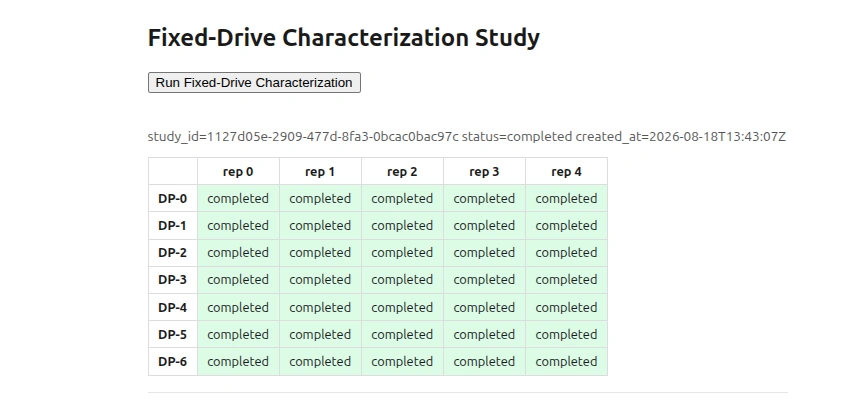

Scientific Studies
For EP-001, a single browser action can now launch the complete fixed-drive characterization protocol consisting of 35 predefined experimental conditions.
Each condition is:
  • executed independently
  • published independently
  • durably recorded
  • grouped into the Study
  • individually reviewable
Study execution was designed to remain crash-safe throughout the entire sequence while preserving immutable evidence for every condition that completed successfully.

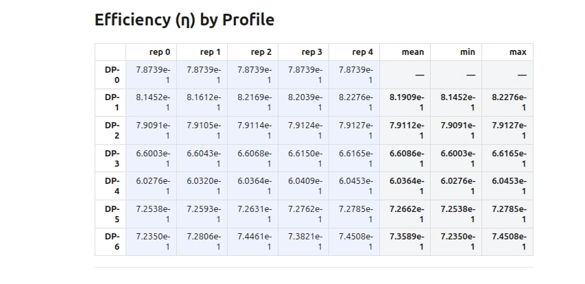

Scientific review
Execution is only the beginning of the workflow.
The Experiment Workbench now supports reviewing an entire Study scientifically.
Current capabilities include:
  • execution-status matrix
  • η result matrix
  • per-profile summary statistics
  • comparison between any two experimental conditions
  • signed parameter differences
  • synchronized trajectory overlay
  • trajectory replay through the existing evidence viewer
These review capabilities derive their information entirely from the already-published immutable artifacts. No secondary scientific authority or duplicated result store is introduced.
Two-condition comparison
Any two published conditions from a Study can now be compared directly.
The comparison view presents:
  • identities of both experimental conditions
  • signed parameter deltas
  • all four recorded electrical signals
  • comparison derived directly from immutable published evidence
This extends the Workbench from experiment execution and evidence review into direct comparative scientific analysis.
Immutable evidence
Every published artifact remains independently inspectable.
From any Study it is possible to navigate directly to:
Study
Artifact
Experimental summary
Recorded trajectory
Replay
Every visualization shown by the browser originates from the exact artifact produced during execution, maintaining complete traceability between experimental execution and scientific review.

  • immutable artifact publication
  • Study organization

two-condition comparison
  • trajectory replay
  • comparison replacement

Current status
The EP-001 Experiment Workbench is now complete.
The single-experiment lifecycle established in the previous milestone has now been extended to the complete EP-001 Study level:
  • 35-condition Study execution
  • durable Study organization
  • study-wide result matrices and summary statistics
  • direct condition-to-condition comparison
  • signed parameter-difference analysis
  • synchronized trajectory comparison
  • navigation from Study-level results back to the exact immutable evidence artifacts
All of these capabilities operate on the same native execution and immutable publication architecture established previously; the Study layer does not introduce a second scientific authority or duplicated evidence store.
This completes the experimental infrastructure required for the EP-001 Fixed-Drive Characterization study.
The Experiment Workbench is now available as the execution, evidence, and scientific-review foundation for subsequent TesLab research programs.
