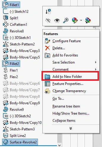

Press "Ctrl" and multi-select all the features that you want to move.
Once selected, right click anywhere inside the feature tree and click on "Add to New Folder".
