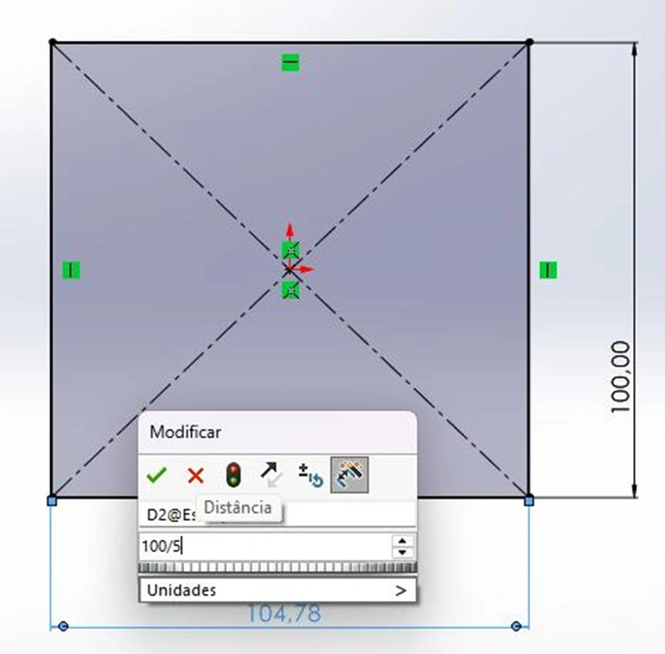

Whenever you enter a dimension — whether in sketches, features, or entities — you can simply type the equation directly into the input box. SOLIDWORKS will do the math for you.
For example, if you want to set a dimension as 1/5 of a height of 100 mm, just type 100/5.
The value will automatically be calculated and displayed as 20 when you confirm the entry.

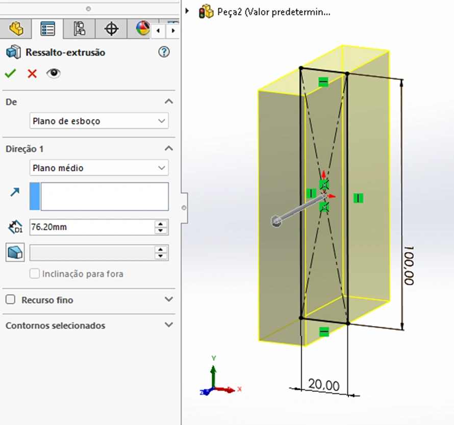

In addition to math operations, the SOLIDWORKS Calculator also performs unit conversions automatically.
Suppose you're modeling in millimeters but have a measurement in inches.
Instead of using an external calculator to multiply by 2.54, just type the value followed by the unit. For example, 3in.
SOLIDWORKS will automatically convert it to millimeters, according to the unit system defined in the document properties.
