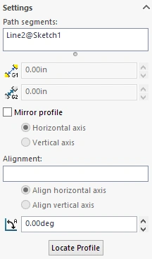

  • Profile positioning

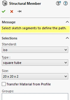

While creating weldment structures, the following settings are available to position the profile sketch according to the design intent:
Settings availabile while inserting weldment
  • Mirror Profile: Use this setting to flip the profile about on the horizontal or vertical axis.
  • Alignment: Aligns an axis of the group profile to any vector (edge, construction line, etc.) that you select. Select which axis of the profile to align:
    • Horizontal axis
    • Vertical axis
  • Rotation Angle: Use this option to rotate the profile. The profile rotates with respect to the pierce point.
  • Locate Profile: This option allows you to define the position of the weldment profile. By default, the location of the weldment profile is at the origin of its sketch.

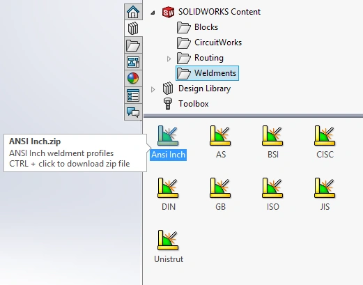

The Weldments folder of the Design Library contains additional weldment profiles for other standards. (Design Library > SOLIDWORKS Content > Weldments). To download the standards files, press the Ctrl key on the keyboard and then click a standard.
Additional weldment profiles in Task Pane

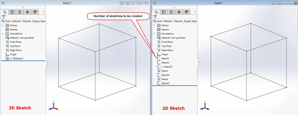

In SOLIDWORKS, you can use both 2D and 3D sketches as layout sketches. An advantage to using a 3D sketch is that all of the sketch entities and their parametric relations is under one sketch. This is the reason that many users prefer a 3D sketch for weldment layout.
2D sketch:
  • SOLIDWORKS creates 2D sketch geometry on a reference plane or face.
  • Using a 2D sketch for sketching complex geometry is time-consuming and might require the creation of additional reference planes.
3D sketch:
  • A 3D sketch does not require the creation of additional reference planes.
  • It is relatively quick and easy to sketch complex geometry using a 3D sketch.
  • You can create the complete geometry in a single 3D sketch.
The following image compares the number of sketches necessary to create a similar sketch profile using 2D and 3D sketches.
Comparison of 2D and 3D sketch profiles

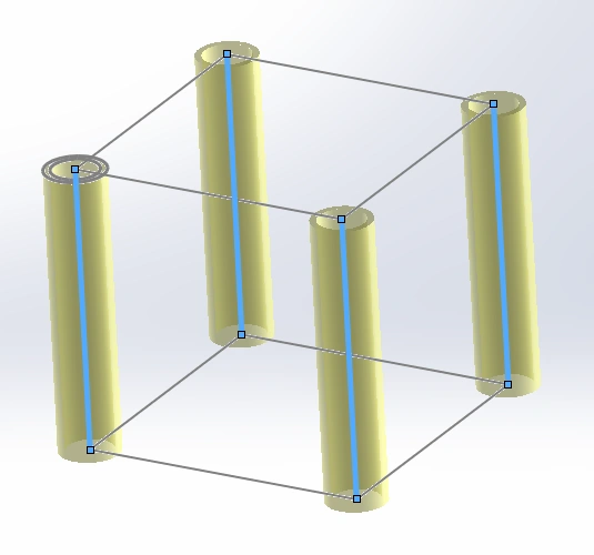

A weldment group is a collection of structural segments that have the same cross-section. When creating a structural member, users can select sketch segments within the same group or from different groups. Users can create a group that contains a particular feature to affect all segments without affecting other segments or groups in the structural member. Selecting sketch segments in the same group ensures application of the same settings for corner treatment, weld gap, alignment, etc. The advantage of working with groups is that bodies never intersect with each other, and the software automatically trims and extends them.
  • Types of groups
  • Contiguous group: A continuous contour of segments that join end-to-end. You can control how the segments join to each other. The end-point of the group can optionally connect to its beginning point.
Contiguous Group
  • Parallel Group: Includes a discontinuous collection of parallel segments. Segments in this group cannot touch each other.
Parallel Group

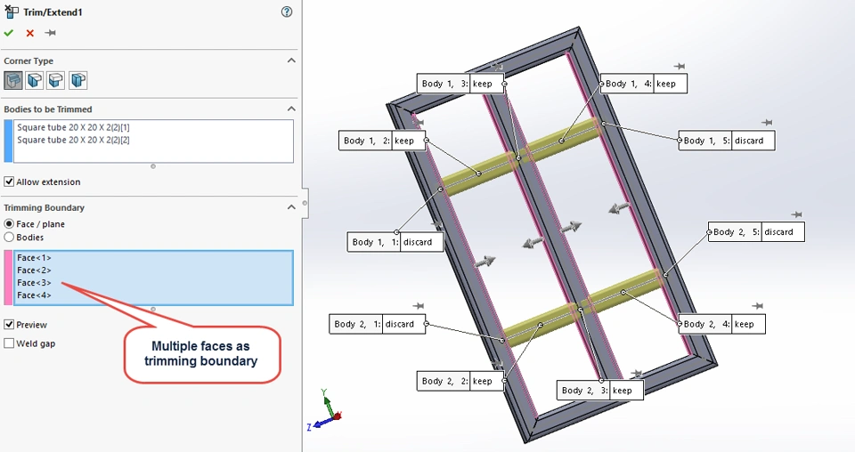

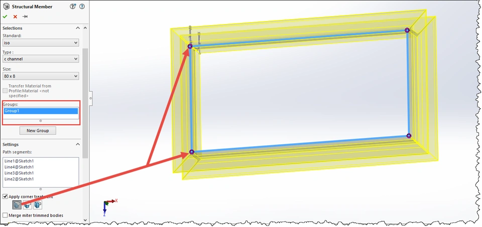

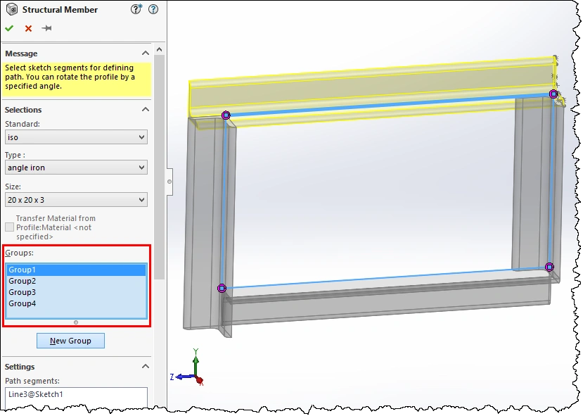

It is possible to create weldment structures by using either a single group or multiple groups. The following examples describe the advantages and disadvantages of the different behaviors.
a) Working with a single group
When all sketch segments connect with each other, the recommendation is to create a single group. With a single group, you can use multiple options for corner treatments, as shown in the following image. In this case, SOLIDWORKS applies the same corner treatment in all corners of the weldment.
Using a single group
Single groups also require less rebuild time when compared to multiple groups. When working with a complex geometry, use of multiple groups can increase the rebuild time and affect the overall performance of the model.
b) Working with multiple groups
When sketch segments do not connect, it becomes necessary to use multiple groups. In this case, you can create multiple groups in the same structural member feature by using the New Group option. Be aware that the weldment profile will be same across all groups, however, settings such as corner treatment, weld gap, alignments, etc. can be different between the groups.
The following example depicts the existence of multiple groups, and each group consists of a single sketch line segment.
Using multiple groups

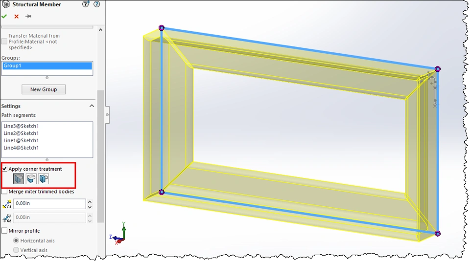

Unlike a single group, it is not possible to apply the corner treatment in this weldment structure.
Limitations of multiple groups
  • Limited availability of corner treatment options
  • You must specify the corner treatment at every corner separately
  • You must define the settings for each group separately
Because of the limited corner treatment option, if SOLIDWORKS does not create the corners you want, you need to use the Trim/Extend command. This increases the number of features and therefore affects performance.
Selecting a group in the PropertyManager highlights only that group in the graphics area.

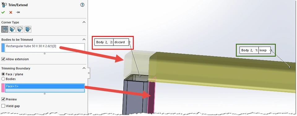

When using the End Miter corner treatment, an additional Merge miter trim bodies option becomes available in the Property Manager. As the name implies, this option combines miter trim bodies, and the cut list displays the length of all combined bodies.
Using the Merge miter trimmed bodies option
Before the release of SOLIDWORKS 2013, this was the default option. However, having this option active by default creates a cut list showing a single body with a combined length. This creates problems if left unnoticed. Therefore, the behavior changed effective with the release of SOLIDWORKS 2013 SP03. The Merge miter trimmed bodies option is now inactive by default.

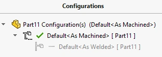

8) Weldment Configuration
In SOLIDWORKS, the addition of a weldment feature creates two default configurations. The default configurations are:
  • Default
  • Default , which is a derived configuration
This allows a user to keep machining features (such as hole, fillet, chamfer, etc.) active in the As Machined configuration. Whereas, the As Welded configuration suppresses the machined features to show the part as it appears prior to the machining operations.
Configurations in a weldment
Users can deactivate the automatic creation of derived configurations by going to Tools > Options > Document Properties > Weldments and then clearing the Create derived configurations option. The Assign configuration Description strings option controls application of the As Machined and As Welded suffix text.

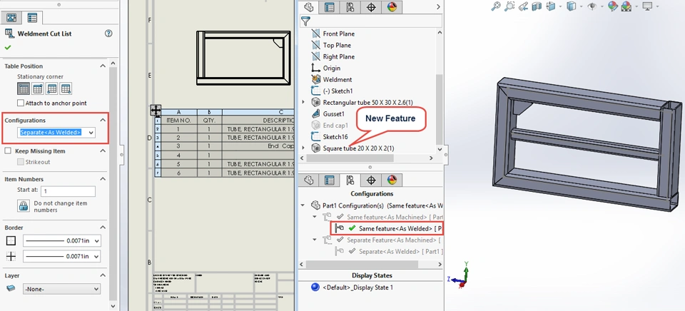

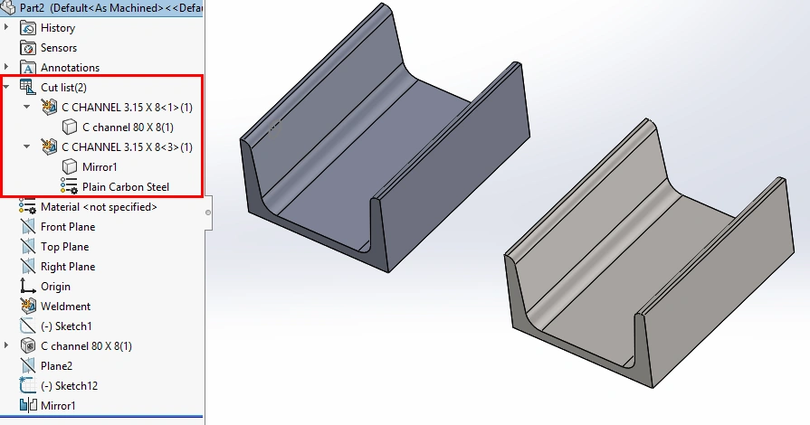

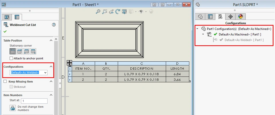

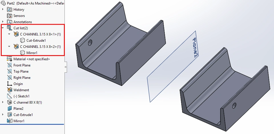

  • Weldment Cut List – Configurations
Whenever SOLIDWORKS creates a cut list in a drawing, the cut list always links to the Default configuration. In a scenario where a user deletes this configuration, then SOLIDWORKS creates the cut list with the Default configuration.
Be aware that the drawing cut list is an exact replica of the cut list table in the part. In many cases, users think that the drawing cut list is wrong when they compare it with the As Machined configuration in the model. However, users should always compare the As Welded configuration in part to the drawing weldment cut list. The following image demonstrates the case where the cut list in the drawing is pointing to the As Welded configuration, and the active configuration in the model is As Machined.
Weldment configurations in a part and drawing

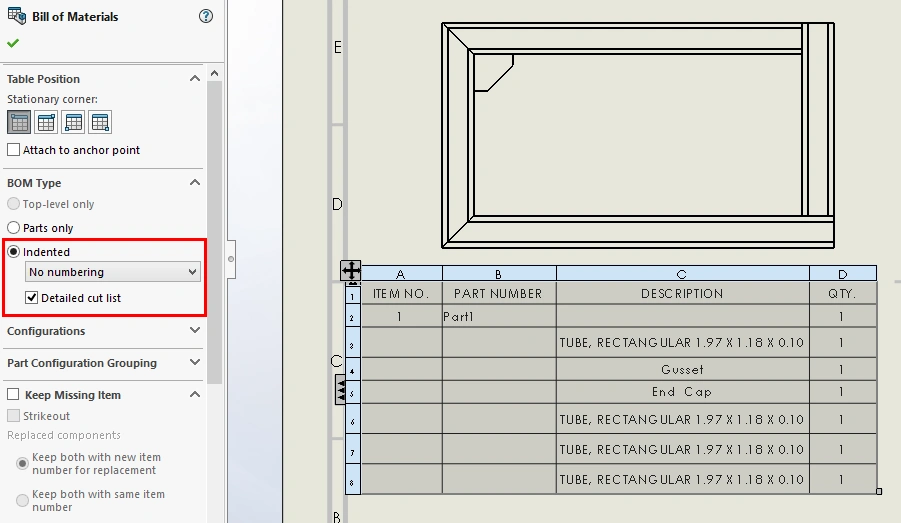

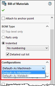

  • Bill of Materials – Indented – Detailed cut list
The BOM – Indented cut list is similar to the weldment cut list. Users can also insert cut list information by going to using Insert > Tables > Bill of Materials > Indented > Detailed cut list. This cut list is further customizable as Flat numbering, Detailed numbering or No numbering.
Indented BOM with ‘Detailed cut list’
The advantage of an Indented BOM is that the user can switch between the Default and Default configurations. The design intent of the weldment cut list is that you can only select Default configurations because the structural member bodies from this configuration are what companies buy from their hardware vendors.
Option to switch between different configurations in BOM
Another important advantage in a BOM is the use of equations, which is a limitation in a cut list.

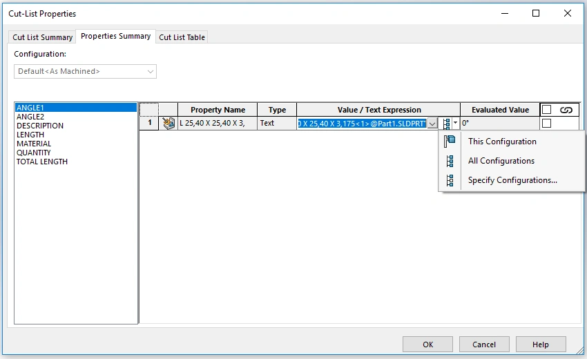

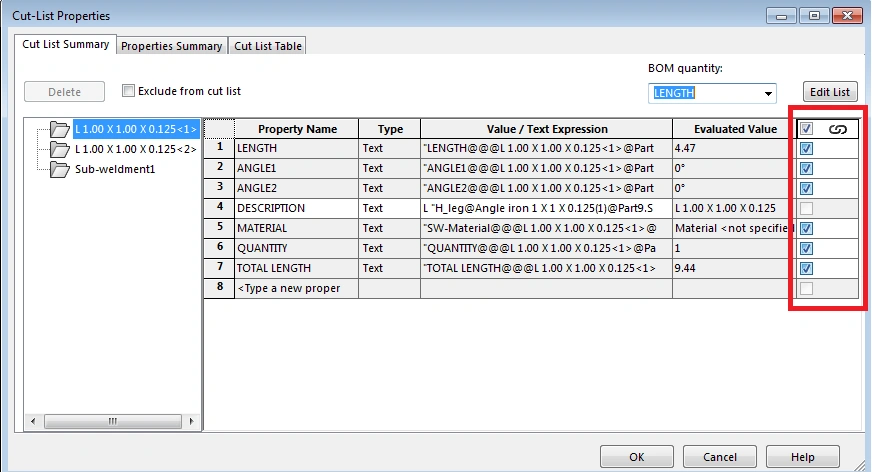

Similar to the custom properties in a SOLIDWORKS file, every weldment or sheet metal part contains cut list properties. The key difference between custom properties and cut list properties is that custom properties are created at the document level, whereas cut list properties are created in the cut list item. By default, cut list properties are inserted when you create a weldment or a sheet metal feature. The template file that drives the weldment cut list properties has the name cut list.sldwldtbt. The location of this file is:
[install_directory]\\..\\SOLIDWORKS\\lang\\[language]
Users can edit the cut list property template to add more properties that then become available in the drop-down list.
The Description property value can also govern then name of the cut list folder. To change this value, go to Tools > Options > Document Properties > Weldments and then activate the Rename cut list folders with Description property value option. These folder names help to identify the profile in use.

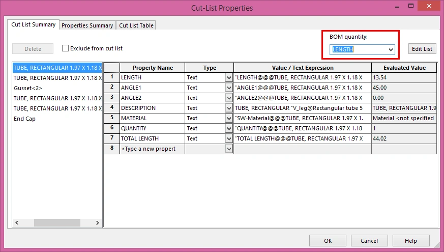

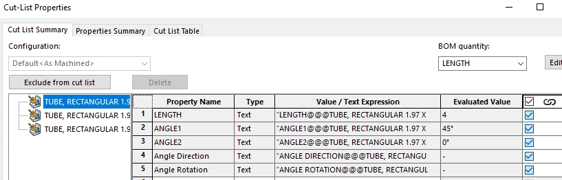

The default cut list properties are Length, Angle, Description, and Material. You can also get the bounding box properties of a body by selecting the Create bounding box option.
Effective with the release of SOLIDWORKS 2018, you can copy and paste the properties from cut list to custom, and vice versa.
Properties in detail
  • Description: This value is evaluated from the information in the profile's (.sldlfp) file properties. To add or modify properties that appear in the cut list, go to File > Properties and modify the Custom properties of the .sldlfp format file..
  • Length: This property value is derived by measuring the normal distance between end faces.
  • Angle: This is the angle between the normal of the cut face and the centerline of the body.
  • Quantity: This property reflects the quantity in each cut list folder. If the Detailed cut list option is not active while creating the BOM, the BOM quantity shows the length value.
  • Total Length: This value displays the combined length of all items that have the same profile, material, and size. From SOLIDWORKS 2016 onward, derived parts display the Total Length in the cut list properties.
Cut list properties
Effective with the release of SOLIDWORKS 2020, two new cut list properties are available for structural members:
  1. Angle Direction: This property indicates whether the two ends face of the body are along the same direction or not. You can specify:
  • Same
  • Opposite
  • Out of Plane
  • None
2.  Angle Rotation: The Angle Twist property indicates the angle between the normals of two end cut planes for out of plane trimming. You can set the angle from 0–180 degrees.

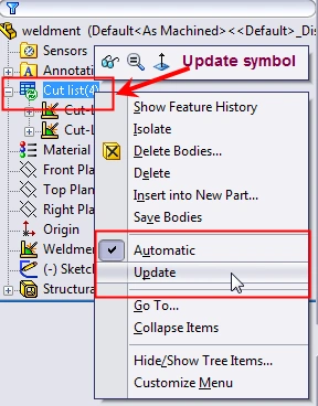

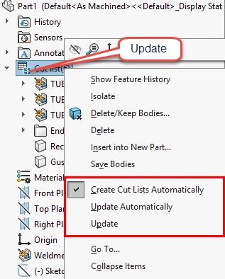

Cut list update:

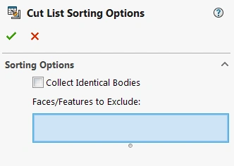

  • Before the release of SOLIDWORKS 2015, it was a requirement that all bodies under the cut list must be grouped as items. SOLIDWORKS provides automatic and manual options for the grouping. As shown in the following image, the Automatic option is the default active setting. This option groups the bodies automatically on the basis of geometrical similarity whenever the Update option is active. The Update option also rearranges the cut list when there is a change to the part design. When a cut list requires an update, the ‘Update’ symbol appears in the cut list as shown in the following image:
Weldment cut list update
An common observance is that when there are modifications to weldment sketches or profiles in quick succession, a user might complain that a drawing cut list does not display the correct information. In such cases, the first thing to try is to select the Update option in the Cut list feature of the part.
If the Automatic option is not active, you must perform the grouping of items in “manual” mode by right-clicking a body (or multiple bodies) and then creating a cut list item. You can then drag and drop bodies to rearrange them in the cut list.
  • Effective with the release of SOLIDWORKS 2015, a modification to the cut list update operation introduced the Automatically update cut lists option under Tools > Options > Document Properties > Weldments. This option also appears as Update Automatically on the context menu of the Cut list feature. When active, this option updates the cut list after any modification. However, users still have the ability to control this behavior manually. If the Update Automatically option is not active, then users can select the Update option to update the cut list manually.

  • Cut list sorting options: Effective with the release of SOLIDWORKS 2017, there is an option available to sort cut list items. Using this option, you can collect the identical bodies by excluding the faces generated from holes, fillets, and chamfers. A minor difference in the bodies caused the cut list to use different groups for similar bodies. This was once a problem when generating a stock list for such items.
Cut List Sorting Options

Use the Trim/Extend command to trim and (or) extend bodies. When creating structural members using separate features, the bodies do not produce the proper ‘corner’ geometry. In such situations, the Trim/Extend feature is very helpful.
There are four corner trim options.
Four corner trim options

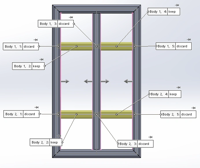

After selecting the bodies to trim, you also have the ability to specify whether to keep or discard individual bodies as shown in the following image.
Trim/Extend the bodies
In many cases, it is preferable to trim by using the Face/Plane option because it offers better performance. Select the Bodies option when trimming against a non-planar entity such as a round pipe or a stepped surface.
Keep in mind that use of the Trim/Extend feature creates a new set of bodies, which might cause the cut list to update. Users often ask why weldment cut list items lose their manually added cut list properties when trimmed. This occurs because when the Trim/Extend feature creates a new body, the cut list items and properties change. Users should add these properties again for the trim or extend bodies.
  • Avoid using multiple faces to trim and extend bodies. Using multiple faces when trimming or extending bodies can create multiple unwanted bodies.
Selection of multiple faces as trimming boundaries
For example, the previous image depicts the selection of multiple faces as the trimming boundary. In this case, after the trim operation, the user might expect that the creation nine bodies. However, the Trim/Extend feature creates 13 bodies. Because of the selection of multiple faces, the bodies get trimmed as well as extended because the Allow extension option is active and the user did not select whether to keep or discard bodies. Therefore, the operation creates eight trimmed bodies instead of four.
The following image displays the assignment of the keep and discard tags to each body. Bodies that receive the keep tag will result in the creation of many bodies. In this case, there are eight. Therefore, be watchful of the number of bodies. As an option to avoid such problems, you might deactivate the Allow extension option.
Selection to keep or discard bodies

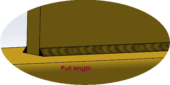

c) Fillet Beads
Fillet beads are the geometry in the welded portion. Users can create full length, intermittent, or staggered fillet weld beads between any intersecting weldment entities such as structural members, plate weldments, or gussets.
Types of fillet beads
Fillet beads create solid bodies in the cut list, however they are not added to any cut list folder. Fillet beads are considered for the mass calculations. To ignore fillet beads for a mass calculation, create a folder that contains all fillet bead features inside, and then suppress the folder.

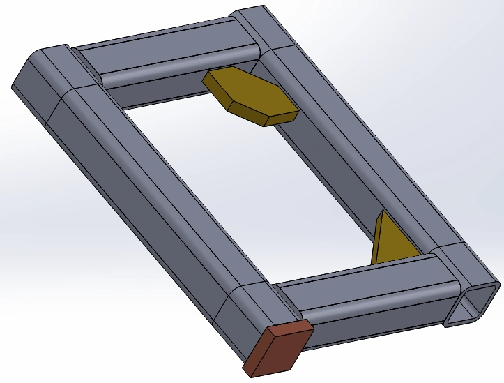

e) Gussets
Gussets are the supporting members for structural members. They act as reinforcement for the area between two intersecting structural members. You can create gussets between disjointed planar surface bodies that are separated by a structural member. Gussets are also supported on cylindrical faces. You can set the color for gusset features from Options > Document Properties > Model Display > Gusset. To can add multiple gussets, select the Keep Visible () option.
In the FeatureManager design tree for a gusset, there are options available to create a Polygonal Profile  or a Triangular Profile . You can control the thickness and location of the profile from the PropertyManager. In a cut list, gussets receive only the Material property.
f) End Caps
An end cap is used to close the ends of structural members such as pipes, square tubes, and rectangular tubes. Be aware that it is possible to add end caps only to profiles with linear edges.
Like a gusset, end caps receive only the Material property in the cut list.
Gussets and end cap

  • Automatically create cut lists: This is the default option, which enables the automatic creation of cut lists. This setting groups similar bodies together. If the option is not active, you can enable it by right-clicking on the Cut list item in the FeatureManager tree.
  • Automatically update cut lists: This default option activates the automatic update of cut lists. You can also control this behavior by selecting the Update Automatically option on the Cut list context menu. Consider turning this option off if you experience performance problems with large weldments.

12) Unlinking and Relinking Cut List Properties
Effective with the release of SOLIDWORKS 2018, the Link column in the Cut-List Properties dialog box allows you to select properties where the text in the Value/Test Expression column can link to a parent part or to a cut list folder. If the check box in the Link column is clear, you can override the value in the Value/Test Expression column. Be aware that a linked check box is active only for the system-defined properties.
The Link column controls the override of text in the Value/Test Expression column

In the Cut-List Properties dialog box, you can configure cut lists by making a selection from the Configuration drop-down list in the upper left corner of the Cut List Summary tab.
You can also apply a configuration to a cut-list property. To do this, in the Properties Summary tab, click the Configuration icon next to the text in the Value/Text Expression column, and select one of the following:
  • This Configuration
  • All Configurations
  • Specify Configurations
Selecting a configuration option updates the evaluated value.
If a property links to a parent configuration, clear the link before assigning a configuration to the Value/Text Expression property.
Configuration options for theValue/Text Expression property

  • Part cut list properties do not match drawing cut list
By default, a weldment part creates an and an configuration. In a weldment model, the default active configuration is . The configuration is used for a drawing cut list.
The most likely reason for a mismatch of cut list property values in a part and drawing is the use of different configurations. A primary troubleshooting tip is to verify the cut list properties by activating the configuration in the part.
  • Newly created structural members do not appear in a drawing cut list
In this case, a part consists of multiple configurations that also include the derived configuration. A structural member is added to another configuration and the weldment cut list refers to a different configuration.
Structural members are not added to a cut list
For example, the previous image depicts the addition of a new structural member to the Same feature configuration, while the cut list refers to the Separate Feature configuration.
  • Length and Angle values in the drawing weldment cut-list do not match the same values in a part:
This is similar to the case for the previous issue. Users work primarily in the active configuration of the part, and modify the length and angle values there. While modifying the dimension, the configuration option is set to This Configuration. The user might expect the dimension to change in the drawing cut list also, however this is not the case. The reason is that the dimension modification happened only in the configuration. Therefore, make sure to also apply the change to the configuration.
Applying dimension changes to configuration

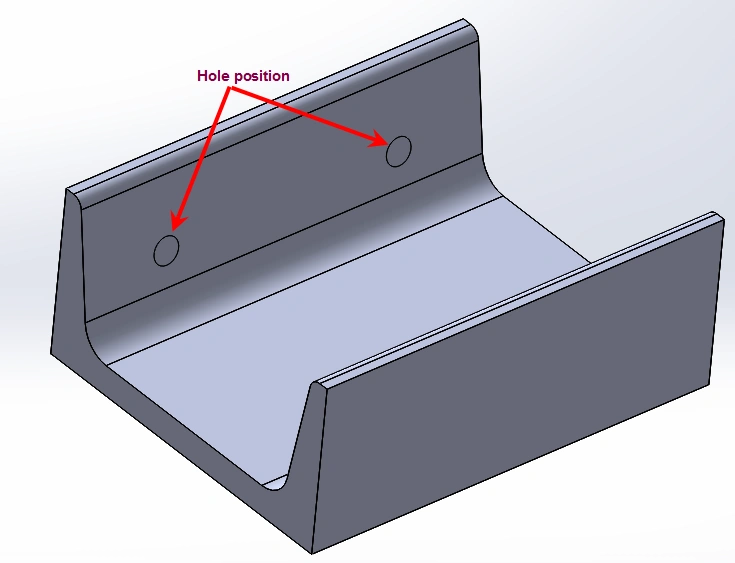

  • Bodies do not group together
    • Mirror bodies do not group together
In the following example, the bodies are mirrored. Therefore, users expect them to be grouped together.
Mirror bodies not grouped together
SOLIDWORKS only groups bodies when they are geometrically identical. However in this case, these bodies are not geometrically identical because the geometry of the hole is in a different position in both bodies. To verify if the bodies are identical, use the Move/Copy command to align the bodies and overlap the bodies as shown in the next image.
Use the Move/Copy command to align and overlap the bodies
In the example, the holes are on the same side but at a different location in both bodies. Therefore the parts are not identical and SOLIDWORKS groups them separately.
  • Geometrically similar bodies do not group together
Consider the same example if we remove the holes from the bodies, and yet SOLIDWORKS still groups the bodies separately.
Similar bodies are not grouped together
This behavior occurs because the bodies do not use the same material. Different materials have a different density, which creates a difference in mass. This makes the bodies asymmetrical, and so the software groups these bodies separately.
