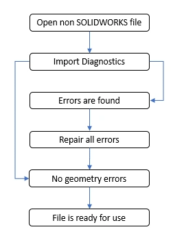

3) Sample File Import Workflow
The following image depicts an example workflow for importing files into SOLIDWORKS. The steps may not be representative of every file import into SOLIDWORKS and some files might require a more complex process. This document covers the steps of Import Diagnostics, that is, the steps for finding and repairing geometry errors. Regardless of the path used, the most important point to emphasize is that the resulting file must be 100% error free before using it in SOLIDWORKS.

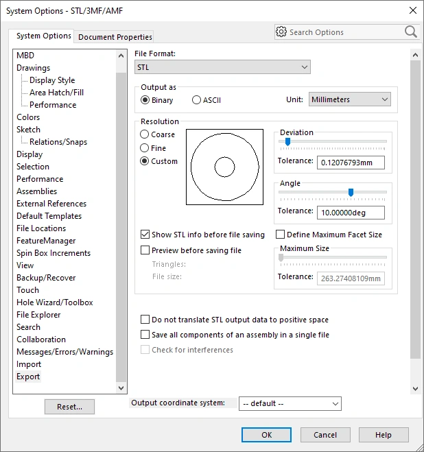

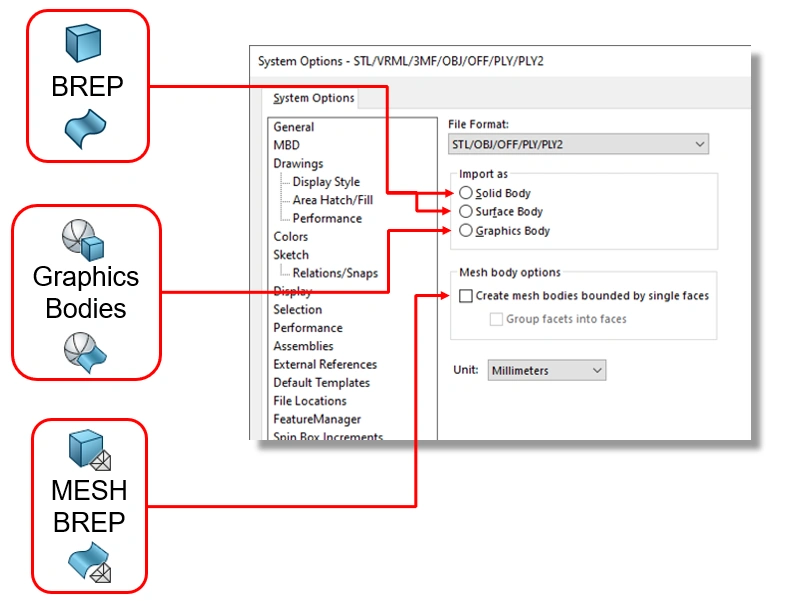

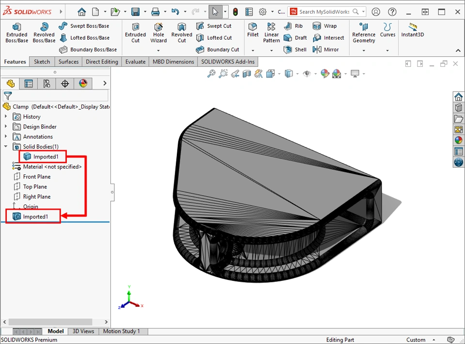

The final option for importing is to use an approximated (mesh) format like STL, VRML, or OBJ, that creates shapes from triangles. Many industries and application use these formats, including movies (animation and rendering), 3D printing, medical (3D scanning), reverse engineering, simulation (CAE), and others. These formats are useful where an exact representation is not a requirement for prototyping, when the hardware and software cost is prohibitive, or for archeological purposes. Other format types could be point clouds like *.xyz, or *.txt with coordinates for only points. For more information, see Working with Mesh Files.
e) Investigating and Fixing Problems
i) Import Diagnostics
Always run the Import Diagnostics tool for every file you import, even if no error is present on the features you feature. If you add new features and discover a problem, you cannot run Import Diagnostics to fix the issue until you remove all other features. This can cause the loss of many hours of work. If you think that there might be an error in the file, suppress any new features and use the Check tool. For more information, see Running import diagnostics. Imported files using 3D Interconnect with links to the original CAD files do not need to run Import Diagnostics. If you break the link, make sure to run Import Diagnostics. For more information about breaking the link to files imported using 3D Interconnect, see the section Breaking the link later in this document.
ii) Parasolid round trip
If you discover an issue with the imported solid or surface, and the Import Diagnostics tool cannot fix the issue, it may be necessary to fix these areas manually with new surfaces, trims, or knits. After repairing the geometry, several new features that you do not want might appear in the tree. Save the part to a Parasolid file, and then reimport the file. The new file import contains only the imported features without the edits to the original file. Make sure to use run the Import Diagnostics tool or the Check tool to ensure that there are no new errors.

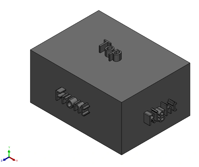

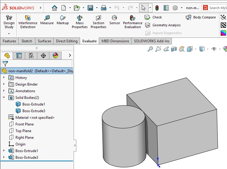

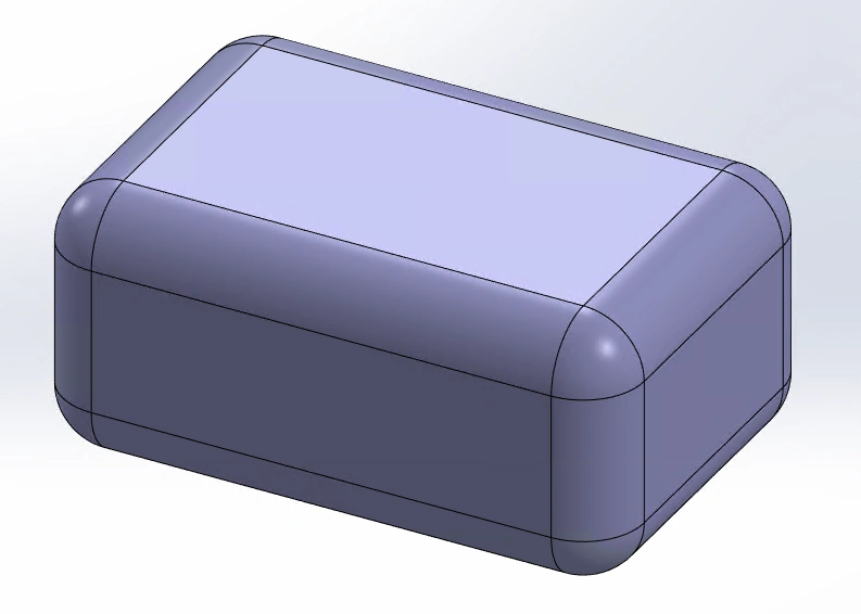

A non-manifold solid geometry is a solid body that cannot be manufactured. This geometry shows up in SOLIDWORKS by returning a Zero-Thickness Geometry error, and the model is created with multiple, discrete solid bodies.
A very common example is one edge bound by four model faces. That single edge is infinitesimally thin and there is no manufacturing process to generate it. Therefore, the result is two discrete solid bodies.
In another common occurrence, a cylindrical face is coincident to another face (cylindrical, planar, conical, etc.). This can occur with both solid and cut geometries, with the latter becoming apparent when trying to generate a section view in the model or in a drawing.

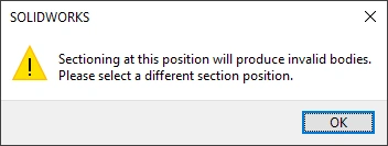

The next image depicts an error when creating a section view that is tangent to the cylindrical hole.
These are only a couple of examples representing non-manifold geometry within SOLIDWORKS. This category can include many conditions such as edge to face, vertex to face, vertex to edge, and vertex to vertex. These serve as easy to understand examples to aid end users in investigating the model to ensure that the account for these issues if they exist in the imported geometry.

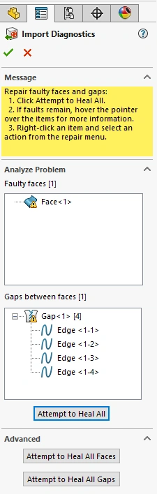

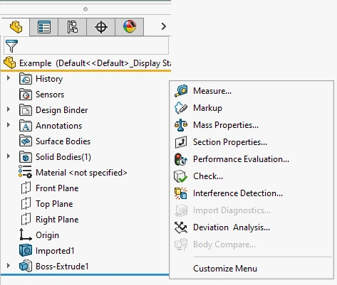

i) Running import diagnostics
After importing a file, consider running the Import Diagnostics tool before performing any other operation. This tool verifies the imported geometry, identifies problems areas, and provides automated tools to repair faulty faces and remove gaps between faces. You can configure SOLIDWORKS to run Import Diagnostics automatically by activating the Automatically run Import Diagnostics (Healing) Under System Options > Import. The result of this option on import:
If Import Diagnostics does run automatically, right-click an imported body and select Import Diagnostics or go to Tools > Evaluate > Import Diagnostics. This opens the Import Diagnostics Property Manager.

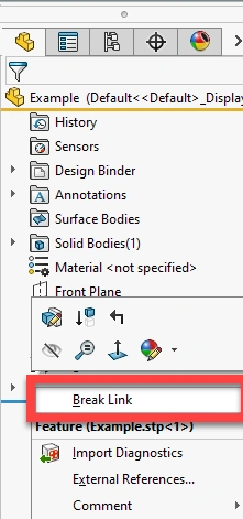

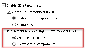

If when using Import Diagnostics on files imported using 3D Interconnect, you are initially unable to repair the geometry, this is because of the need to maintain the topological structure of the original file.
You can remedy this by right-clicking the imported geometry and selecting Break Link. At this point, a warning appears that you cannot undo the action. This means that the association between the SOLIDWORKS file and the source CAD data will be lost. However, the ability to heal the geometry within the Import Diagnostics tool is now available. For more information about this decision, refer to the 3D Interconnect section.

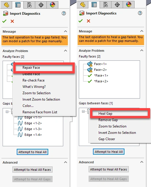

The Import Diagnostics tool provides functions to repair imported geometry automatically. These functions include:
  • Attempt to Heal All
  • Advanced > Attempt to Heal All Faces
  • Advanced > Attempt to Heal All Gaps.
These functions attempt to rebuild geometric and topological information for a model that seems to occur because of data translation errors. Depending on the complexity of the geometry, the complexity of the faults, and the number of faults, these repairs may take significant calculation time.
If the Attempt to Heal All function cannot repair all faulty geometry, you might try performing the function again. Alternately, you can use one of the advanced options (Attempt to Heal All Faces or Attempt to Heal All Gaps), or attempt to heal one face or gap at a time by right-clicking the face and selecting Repair Face or right-clicking the gap and selecting Heal Gap as shown in the following images.
After using of the various import diagnostics tools, users should have clean geometry with no faulty faces. If faces remain faulty, delete them, and use the Gap Closer tool to repair the area. Take care when using this technique, and use the technique only for very thin gaps. If you use the Gap Closer tool for gaps that are too large, the result may increase the tolerance above an acceptable limit and reduce the accuracy of the result. If you exhaust all other options and gaps remain, use subsequent manual geometry repair techniques as described in the section Manual geometry repair.

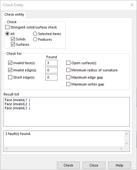

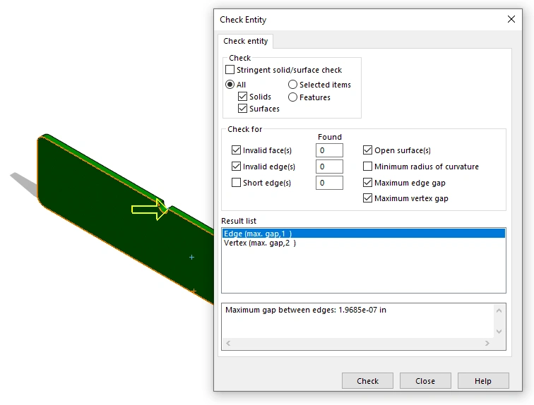

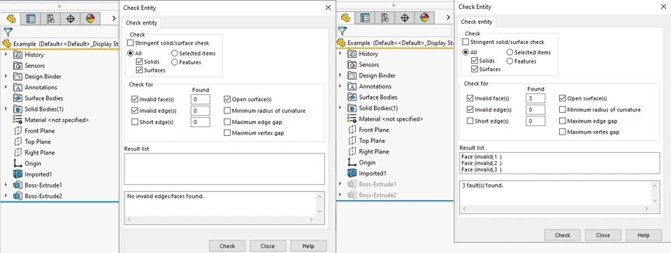

iv) Check tool
Within the workflow of some companies’, there are occasions where legacy data is in use and you are unsure if the previous user followed the proper import diagnostics procedures. If parts with subsequent features exist in the FeatureManager, the Import Diagnostics options are inactive.
In such scenarios, you can use the Check tool, which is accessible from Tools > Evaluate > Check. The Check tool examines the current state of geometry and gives users the ability to check geometry for faulty faces and faulty edges like the Import Diagnostics tool.
From the Check Entity dialog box, you can check the geometry for faults regardless of subsequent features. However, use caution when doing so. It is possible to have underlying faulty imported geometry if the subsequent features in the FeatureManager design tree conceal the faulty geometry. Therefore, before running the Check tool it is always a best practice to suppress all features in the FeatureManager design tree that are subsequent to the imported geometry.
If errors are present, be aware that when making substantial changes to repair the imported geometry, there is a possibility that IDs may change on the faces, edges, and vertices to which the suppressed features are applied. When unsuppressed, these features may have rebuild errors and require editing individually.

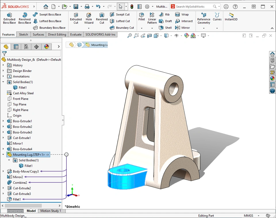

It is always a recommendation to apply these tools and repairs before adding any modeling features to ensure that the imported geometry is error free.
For design scenarios where the ability to suppress or unsuppress subsequent features is not required, it is a best practice to save the file with no faulty geometry as a Parasolid, import the Parasolid into a new file, follow proper Import Diagnostics procedures, and then replace the old file in assemblies with the clean version as required.
This technique of masking problem areas with additional geometry, exporting, and then reimporting a file is an acceptable technique where the geometry details are not critical and proper surfacing techniques (as described in Manual geometry repair)) prove too difficult or time-consuming.
In addition to highlighting geometry errors and faults, activating the Maximum edge gap and Maximum vertex gap options in the Check Entity dialog box, can reveal areas of the model that may be problematic because of differences in the tolerances of one CAD application to another. The tool uses this information to determine if the measured values are acceptable for the geometry use case. For example, the acceptable values for a part used in a massive structure are likely much larger than for a part used in a consumer electronic device.

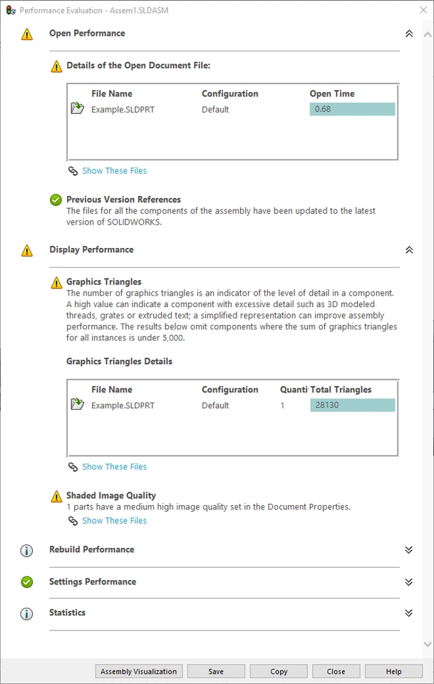

v) Assembly Level Performance Evaluation
Regardless of whether files contain translated data (features that appear as Imported* in the FeatureManager design tree), it is very important to always evaluate all files from sources outside of an organization before using the files a company workflow. The proper evaluation of externally provided data is critical in assessing whether subsequent simplification strategies are required before using in a company workflow. This helps to ensure proper functionality and performance.
To evaluate an externally provided file, it is first necessary to perform the proper repair procedures as discussed in the previous sections. Upon achieving clean geometry, it is worthwhile to insert the part into its own unique assembly, save the file, and then close all files.

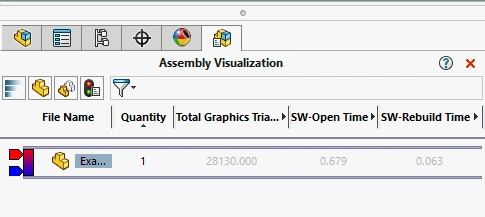

To properly evaluate the external file, open the newly created assembly run the Performance Evaluation tool from Tools > Evaluate. The Performance Evaluation tool provides insightful details about the external data including open time, graphics triangles, and rebuild performance considerations.
Users might also find interest in using the Assembly Visualization option available in the Performance Evaluation dialog box. This option provides a sortable list with information such as Total Graphics Triangles, Open Time, and Rebuild Time.

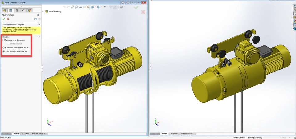

Depending on the downstream usage required, users can explore strategies for simplifying geometry as explained in the Simplification of Geometry section of this document.

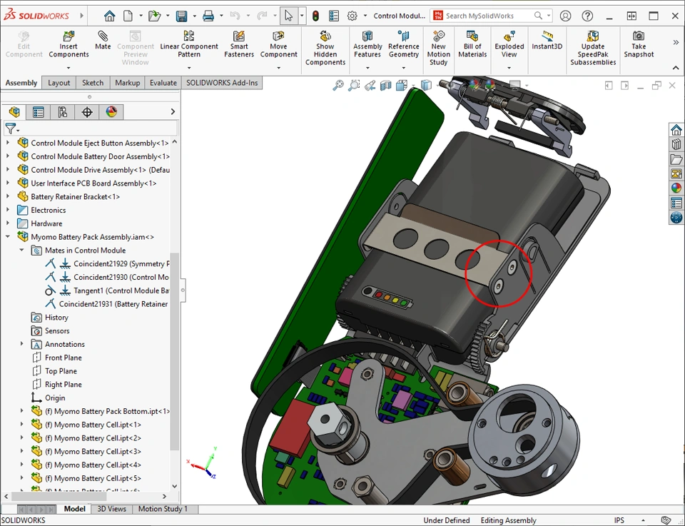

7) 3D Interconnect
First available with the release of SOLIDWORKS 2017, 3D Interconnect is the latest CAD interoperability technology. 3D Interconnect technology allows users to work seamlessly with multiple types of third-party native CAD and neutral files.
a) Why 3D Interconnect?
3D Interconnect introduces a workflow that is much easier, and faster, than traditional methods. It replaces the time-consuming process of importing, converting, and repairing CAD data.
3D interconnect allows:
  • Direct referencing of native CAD and neutral file formats for use in SOLIDWORKS. You can insert these files directly into SOLIDWORKS assemblies without conversion.
  • These files remain in the native format and retain an associative link to the source CAD file. If there is a change to the file by the source CAD application, the changes appear in SOLIDWORKS when updated.
  • When necessary, the associated link can be broken, and the file is translatable into SOLIDWORKS using the traditional methods.

3D Interconnect functionality is active by default for new SOLIDWORKS installations. To activate or deactivate the functionality, Go to Tools > Options > System Options > Import.
Many settings are straightforward and simple options to control the type of data that SOLIDWORKS reads from native third-party CAD files.

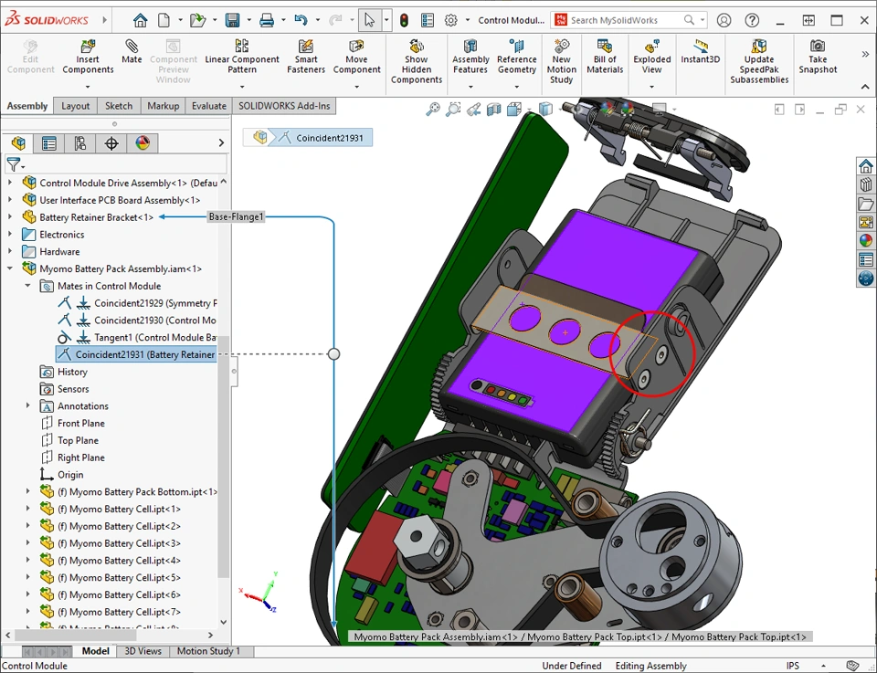

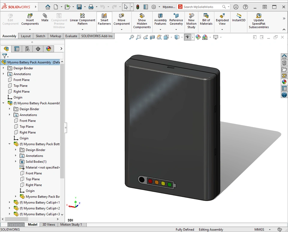

ii) Using files as an Assembly Reference
3D Interconnect technology allows you to insert native CAD and neutral files directly into a
SOLIDWORKS assembly by using the Insert Components , from the Insert >
Components > Existing Part/Assembly menu, or by dragging a component from Windows
File Explorer (SOLIDWORKS 2020 and newer). When added to an assembly, files maintain
the original file name, with extension, and have a unique FeatureManager icon representing
the external link to the native file format.
This assembly, and its components, behave like native SOLIDWORKS files and share many capabilities. They can be located with assembly mates, participate in assembly motion, be used in mass property calculations, and checks for interference and collision detection.
3D Interconnect facilitates true, multi-cad collaboration because you can base SOLIDWORKS parts and features off these models. In the following image, with the non-SOLIDWORKS battery model located, the retaining bracket is located on the battery face. This process ensures the design functions correctly when design changes occur.

vi) Breaking the link
There may be situations where a file used though 3D Interconnect requires significant modification in SOLIDWORKS. If required, you can break the link to the original CAD file and the file then traditionally translates into SOLIDWORKS. You cannot undo breaking a link. Before breaking a link, ensure that you no longer require the associativity.
The following option in System Options > Import defines whether broken files exist as virtual components or dissolve into external files and save as new files.
The options to break links vary depending on whether you selecting the top-level assembly,
an assembly with a 3D Interconnect node, or an inserted part with a 3D Interconnect node.
The following image depicts a sample assembly open in FeatureManager. The assembly
contains 3D Interconnect links at all levels; the assembly level, the component level, and
down to the feature level.
At the top-level assembly, it is possible to break 3D Interconnect links with a single right
click. This breaks links at the component level, where the individual parts maintain the 3D
Interconnect link as a feature. It is also possible to break links at the component and feature
levels, which removes all links down to the feature level, and the part contains imported solid
or surface features.
Break Component Links                Break Component and Feature Links
Assembly nodes provide an additional option to break This Link. This option removes only the assembly node link, leaving the component and feature links unaffected. Selecting the Component Links and Component and Feature Links options for the Break Links command behaves the same as the top-level assembly shown in the previous example.
Breaking the links at the part node has the same options as the previous examples and the
same results.
Breaking the links for a 3D Interconnect part that is open in a separate window, removes the
feature link in the FeatureManager tree.
After breaking the link, the file translates fully and contains imported solid or surface
geometry. At this point, the model needs to follow the workflow of checking for, and
repairing any geometry errors as described in the Repair and Evaluation of 3D Files Prior to
Use section of this document).

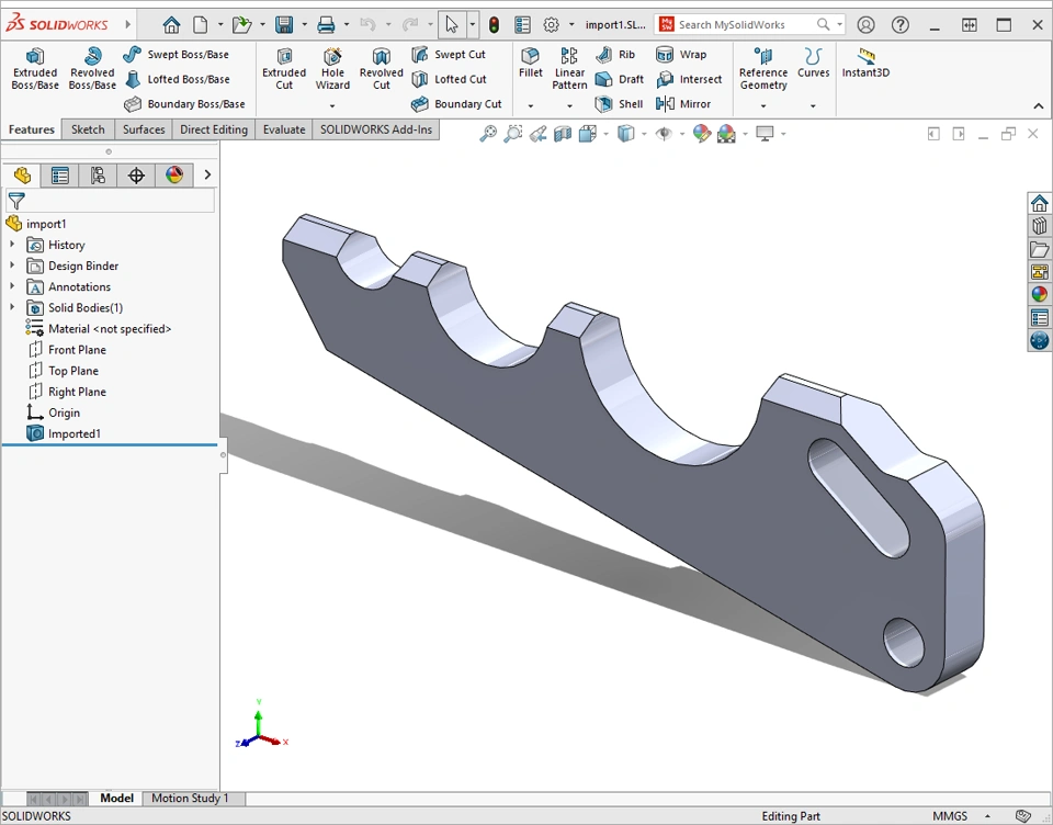

b) Mesh Files
Effective with the release of SOLIDWORKS 2018, you can import mesh files (*.stl, *obj, *.off, *.ply, *.ply2) as solid body or surface body boundary representations (BREP), graphics bodies, or meshes (mesh BREP) without the use of ScanTo3D. You can adjust the type of body that is imported from mesh files from Tools > Options > System Options > Import. Specify the File Format as STL/OBJ/OFF… as shown in the following image.
There are benefits to using certain options over others. For example, importing a mesh as a graphics body is the fastest way to open a mesh file. This gives you the ability to open and review the file before deciding to make any changes. If there is too much detail, the triangle count of graphics bodies can be decimated before converting to an editable format. Importing as a solid or surface body takes more time, uses the most memory and resources, and each triangle converts to its own face with edges. However, this format is compatible with all standard features without compromise.

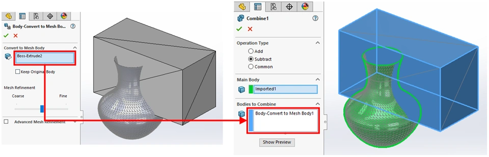

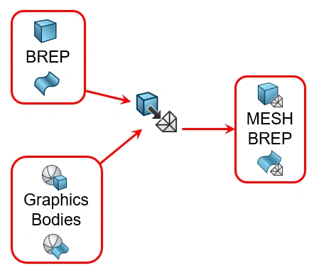

i) Converting meshes
To interact with each other, bodies must be of similar type. You can convert standard solid or surface BREP bodies to mesh BREP bodies. One reason to convert a standard body to a mesh would be to use the Combine   feature. The Combine feature can only be used on like bodies, so each body used must be all BREP, or all mesh BREP. However, some features are compatible with either body type, such as; Fillet and Chamfer.
To convert a normal BREP body, right-click the body from the solid or surface body folder
and then select    Convert to Mesh Body. You can use the same tool to convert graphics bodies to a
mesh BREP body from the graphics body folder.
Graphics bodies have an additional    Decimate Mesh Body feature to reduce the number of triangles in the mesh before converting to a mesh BREP body. After converting a body to a mesh BREP body, it is not possible to convert the body back. However, when finished making changes, you can export the mesh body as an STL file, and then reimport the mesh as a standard solid or surface body by adjusting the import options as mentioned in this section.
ii) Making changes to meshes
Working with meshes is very similar to working with standard SOLIDWORKS geometry. You can use a mesh BREP to determine mass or to create reference geometry like axes and planes. You can use a mesh BREP with sketches to add relations, section views, and surface features like Trim, Offset, and Thicken. You can apply appearances for rendering; and can even use a mesh BREP to detect interferences in an assembly. However, Boolean operations must be performed on geometry of the same type. These are features like Combine, Intersect, Split, Move, Copy, and Cut. For example if you want to add a cut, you first need to make a solid body representing the material to remove, convert the body to a mesh body, and then use Combine to subtract the body representing the cut area from the original imported mesh body.
For a list of features that support mesh BREP bodies, see the help documentation.
c) Simplifying Mesh Files with FeatureWorks®
If SOLIDWORKS reads a mesh file as a solid BREP body, FeatureWorks can simplify the file by merging the coplanar facets to a singular planar face. The general workflow is as follows.
  1. Import the mesh as a solid body.
2. Create a simple feature.
3. Export the file as Parasolid and then import the resulting Parasolid file.
4. Use FeatureWorks to recognize the simple feature. Notice that the planar faces no
longer consist of multiple facets.
5. Delete the simple feature.
Files consisting of large numbers of planar faces experience the greatest reduction of facets
because there is no modification to curved faces.

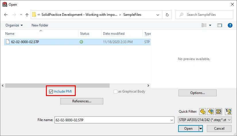

9) Importing PMI with SOLIDWORKS MBD
SOLIDWORKS MBD (Model Based Definition) makes it possible to create models without the need for drawings. This provides an integrated manufacturing solution for the SOLIDWORKS software. With a SOLIDWORKS MBD license, you can define, organize, and publish 3D product and manufacturing information (PMI), including 3D model data in industry standard file formats, such as STEP 242.
SOLIDWORKS MBD supports the import of 3D annotations with the Include PMI option within the File > Open dialog box for CATIA, Creo®, Solid Edge®, NX, Inventor, and STEP 242 files.
‘Include PMI’ does not use 3D Interconnect functionalities.
3D Interconnect cannot open this file so the file must be fully imported and translated. Before using the file, follow the recommendations in the Repair and Evaluation of 3D Files Prior to Use section of this document to verify that the file is 100% error free. The file contains all PMI data including any 3D views from the original.
The included PMI are semantic graphical annotations that cannot be modified. You can add other PMI and 3D views and save the file in the SOLIDWORKS, 3D PDF, eDrawings (with attached STEP files), and STEP 242 file formats. ‘Include PMI’ is also recommended for importing mesh bodies.
10) Importing STEP/IGES/ACIS data in analytic format
The parameter Tools > Options > System Options > Import > Create analytic faces (slower) Converts the faces with a complex geometric surface to a matching analytical form.
It is a solid body with an extruded protrusion and a fillet made up of flat, cylindrical, and spherical cut faces.
When exported and imported back into SOLIDWORKS with a default set, all faces will be returned as "BSurf". Even if a face is planar, you cannot add a sketch, and the mate may have limitations. Conversely, with 'Create analytical faces' enabled, analytical faces (planar, cylindrical, and spherical) will be returned.
11) Modification of Imported Geometry
As a best practice, do not add SOLIDWORKS features until after running the Import Diagnostics and Check tools to verify that an imported file is 100% error-free.

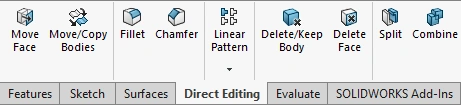

a) Direct Editing (Delete Face, Move Face, Standard Features)
Many situations arise when the imported geometry needs modification. This can prove challenging because the file only contains solid or surface data with no features to change. SOLIDWORKS contains several tools on the Direct Editing CommandManager tab to facilitate modifying imported geometry.
For example, you can use unnecessary geometry by using the Delete Face command, which allows you to select one or more faces to remove from the model. If desired, the model remains open and becomes a surface body or the remaining edges are extended, the model is patched, and it remains a solid.
You can modify sizes can be modified by using the Delete Face command with a similar technique. One or more faces are selected, and then offset, translated, or rotated. The model is then modified.
If the imported file contains multiple solid and surface bodies, you can remove or reposition those bodies by using the body-specific tools of Move/Copy and Delete/Keep.
The nature of these features is they only apply one change per feature. For example, if an imported body requires translation and rotation, two Move/Copy body features are required. One to translate the body, and a second to rotate the body.
In many situations, adding standard SOLIDWORKS features to imported solid geometry is the same as using them in a native SOLIDWORKS file. In a similar manner, imported surface bodies modifiable using any of the SOLIDWORKS surfacing commands.
As the Direct Edit tools are used, each becomes a feature in the FeatureManager that you can suppress, delete, or roll back if the feature order requires modification. These tools are not limited for use in only imported parts, you can add them to any SOLIDWORKS part where applicable. If in-depth knowledge of these tools is required, your local SOLIDWORKS VAR can provide training.

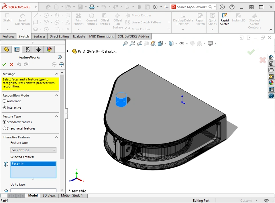

b) FeatureWorks
FeatureWorks is useful to reverse engineer an imported solid model, by recognizing the geometry and applying SOLIDWORKS features to the part. There is no difference between these recognized features and the features that a user creates with SOLIDWORKS. The recognized features contain editable sketches and feature parameters.
It is important to understand that some part models are too complex for full feature recognition, or the process is too time consuming to perform. In those instances, focus on the geometry that requires modification, while leaving much of the model imported body data.

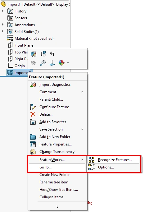

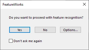

FeatureWorks runs automatically if a file contains an imported body feature in the FeatureManager. You can turn off this automatic feature from the FeatureWorks Options dialog box.
To run FeatureWorks manually, right-click the imported body feature, select FeatureWorks > Recognize Features.
The FeatureWorks process is either Automatic or Interactive, or a combination of both methods for imported prismatic solid and sheet metal models. It does not work on imported surfaces.
Automatic feature recognition is a faster process that contains a simplified list of standard features to recognize. However, there is no control over the order of recognition for the features, so the result might not follow the intended design intent.
Interactive feature recognition is a slower and more complete methodical process. Users have full control over the feature type to recognize, the faces or edges to include for that feature, and the order in which the features are recognized.
Automatic vs. Interactive options
As Imported
After using FeatureWorks

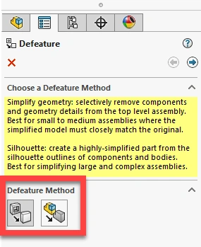

    b) Defeature Tool
    Oftentimes assemblies have components that contain a lot of unwanted detail, which can lead to long opening and rebuild times. The Defeature tool in SOLIDWORKS allows you to remove the unwanted detail from single-body parts, multibody parts, and assemblies. To run the Defeature tool, go to Tools > Defeature. There are two Defeature methods from which to choose.
    One method, the Simplify Geometry option, allows you to exclude components, maintain motion, and fill in parts with material to remove internal details. After simplifying the geometry, a preview of the result appears. At this point, you have the option to save the assembly as a new document. You then have the option of maintaining a link between the defeatured file and the original file, or publishing the file to the 3D Content Central website.
    Another Defeature method is the Silhouette option. Choosing the Silhouette method allows you to create a simplified part from the silhouette outlines of the components and bodies of an assembly. With the Silhouette method, you have the option of creating groups of the type of Simplification Method you want to apply for those parts. Then, clicking Next displays a preview of the result.
Lastly, several options are available for saving the newly Silhouette-defeatured assembly. The save options are the same as when using the Simplify Geometry option. However, two additional save options are available:
 The Create a new configuration option, from which you can choose to include the toplevel
reference geometry.
 The Store settings for future use option, which allows you to save the defeature options in the fully detailed original model.
  • The Create a new configuration option,
    from which you can choose to include the top-level reference geometry.
  • The Store settings for future use option, which allows you to save the defeature options in the fully detailed original model.

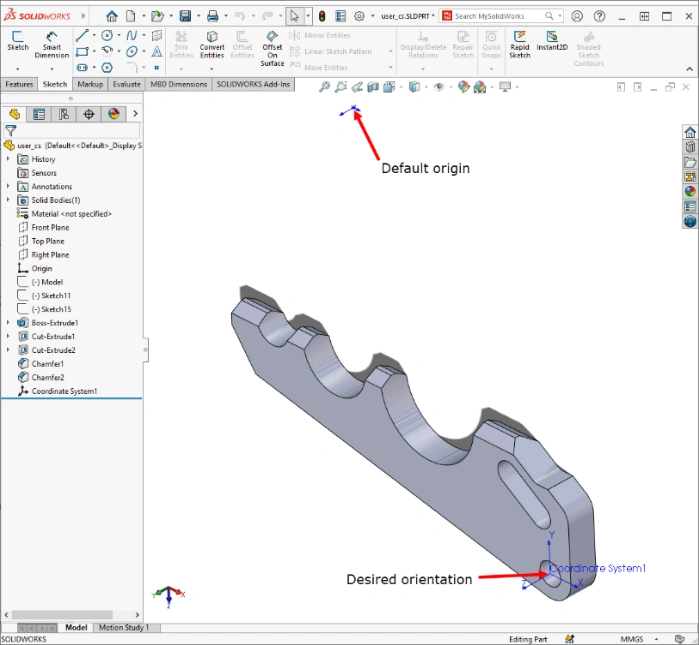

i) Output coordinate system
Several 3D file formats have an option to export relative to an alternate coordinate system. This may be necessary when the default Y-up coordinate system in SOLIDWORKS is not sufficient. Using this method redefines the file coordinate system during export to a specified coordinate system.
Files formats that include this option are: IGES, STEP, ACIS, Parasolid, VRML, IFC, VDAFS, and the 3D Manufacturing formats of: .STL, .3MF, and AMF.
The file to export must specify an output coordinate system in the Export options. For more information, see the topic Creating a Coordinate System in the SOLIDWORKS online Help.
An alternative workflow is to keep the default SOLIDWORKS Y-up coordinate system and use the Move/Copy command to reposition the solid (or surface) body relative to the default coordinate system. After repositioning the body, any file export uses this orientation as the coordinate system.
The following images depict the default SOLIDWORKS orientation and another orientation that is common in other CAD applications.
Default SOLIDWORKS orientation
ISO DIN orientation

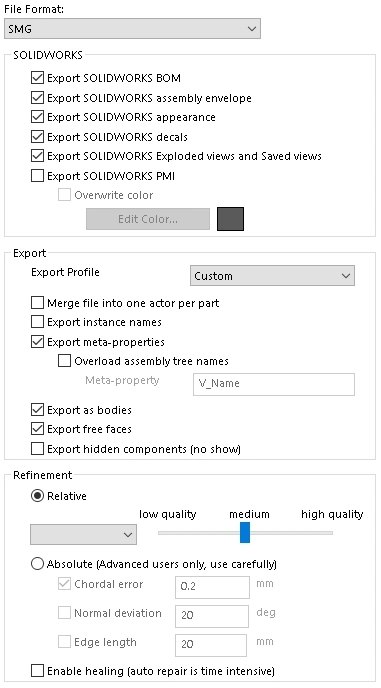

iii) 3D manufacturing file options
The 3D manufacturing file formats of STL, AMF and 3MF all share the same export options. This translation takes the smooth, curved, geometry of the SOLIDWORKS model and creates a tessellated file consisting of planar and triangular faces. It is important to strike a balance with the Resolution settings to represent the file accurately without causing a significant increase in size. The more curved the SOLIDWORKS model is, a higher resolution is needed, which increases the triangle count, the time it takes to save the file, and the file size itself. Perform trial exports to determine the optimal settings.
  • Units
When performing an export, it is very important that you specify the units correctly or the result may be a larger or smaller than expected. Ensure that the Unit specification matches the units of the model as created in SOLIDWORKS.
  • Resolution
Specify these options to increase or decrease the output resolution, which increases or decreases the number of triangles. Using Coarse or Fine sets the Deviation and Angle values and locks the slider bars. Choose the Custom option to allow full control to modify the slider bars and to enter values for the Deviation, Angle, and Maximum Facet Size tolerances, if active.

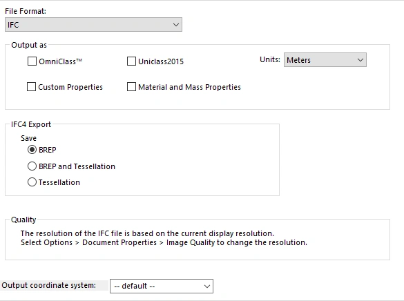

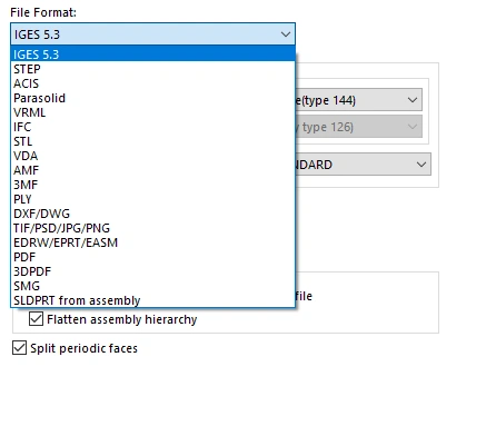

iv) 3D file format export options
Several 3D file formats share options to control the format of the data in the export. The IGES, STEP, ACIS, and PARASOLID formats may share one or more of the following options:
  • Solid/Surface geometry: The file export includes all surface and solid geometry
    data. If bodies or components are hidden, suppressed, or loaded lightweight, a
    message appears prompting resolution before export.
  • Export appearances: Exports file appearances. If you export in STEP AP214, enable this parameter.
  • 3D curves: All solid and surface data exports as wireframe 3D curves. Any 3D curves in the SOLIDWORKS file (composite, intersection, helix, etc.) exports as well. Some file formats support both solid and surface geometry and allow the export of 3D curves in the same file.
  • Export sketch entities: When active, this option exports all 2D and 3D sketches as a single 3D sketch. This can affect performance if the export contains a large amount of sketch data.
  • Flatten assembly hierarchy (assemblies only): Removes all subassemblies. The resulting file consists of a single level of multibody parts. Any part previously containing multiple bodies retains the same number of bodies after the export.
  • Split periodic faces: Exports a continuous cylindrical face into two coradial (share center point and radius) cylindrical faces. Activate this option to increase the quality of the cylindrical faces.
  • Export assembly components as separate STEP files (recommended for large assemblies): Exports assemblies as atomic STEP files. Separate STEP files are created for each component in the assembly. This parameter is recommended with big assemblies.

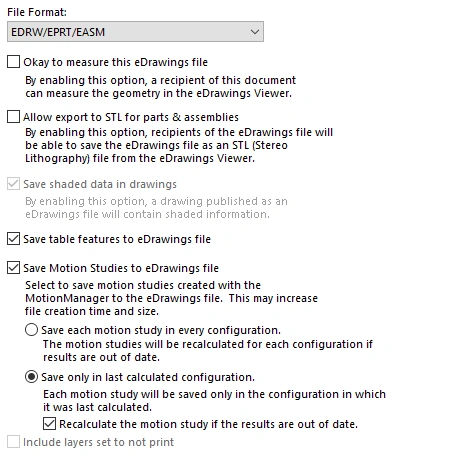

v) eDrawings file export options
eDrawings is the standard viewing application for SOLIDWORKS files and for many other file formats also. Saving SOLIDWORKS files in the eDrawings format is advantageous for reducing file size and ensuring security when collaborating across organizations. A SOLIDWORKS file becomes tessellated graphics and cannot be reverse engineered by a recipient with the native eDrawings file type. The following options are available for creating eDrawings files that share appropriate information without disclosing too much intellectual property.
vi) SOLIDWORKS Composer export options
SOLIDWORKS Composer™ is an authoring tool for creating graphical content from SOLIDWORKS design data. The SOLIDWORKS Composer export options specify the SOLIDWORKS data to include, how the SOLIDWORKS file translates to the SOLIDWORKS COMPOSER file format (.smg), and the levels of refinement.
The Chordal error and Normal deviation options for refinement control how SOLIDWORKS tessellates files when exporting to SOLIDWORKS Composer. Each option provides a slider to adjust the output quality from low to high to balance accuracy and file size.
The Chordal error option works well when the geometry is relatively the same size. However, this option can lead to image quality issues with models containing very large and very small faces. In those scenarios, switching to Normal deviation refinement produces better results.
Successful translation of assemblies to SOLIDWORKS Composer requires loading assemblies fully resolved with Large Assembly mode disabled.
vii) IFC export options
The SOLIDWORKS software supports interoperability for the Architecture, Engineering, and Construction (AEC) industries by exporting Industry Foundation Classes (IFC) files. IFC files are a neutral format to describe information found in the building and construction industry.
SOLIDWORKS supports export to the IFC 2x3 and IFC 4.0 file formats. For more information about IFC files, see the topic IFC Files in the SOLIDWORKS online Help.
SOLIDWORKS supports two classification systems that organize the massive amount of information used in the building and construction industry.
The remaining options are straightforward to select the output units, the properties to include, and the type of geometry data for IFC4 files: BREP (boundary surfaces) and/or a tessellated mesh.
  • IFC Properties
Before exporting a SOLIDWORKS file to the IFC format, it is important to define the IFC metadata that classifies the grouping to which the model belongs. This is managed from File > Properties for each file to be exported. The AEC Classification options appear at the bottom of the Property Name list.
The individual classifications have associate tables that populate the Value/Text Expression fields. Selecting the most appropriate classification defines the IFC metadata.
It is important to define the classification for each component (part). The results of an IFC export differs if the classification is defined for a subassembly that contains several identical parts versus defining the classification in the parts themselves.
