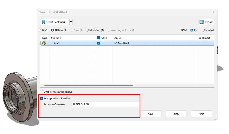

To start, the initial design will be captured as the first Iteration. Iterations are created during the Save to 3DEXPERIENCE operation. To create an Iteration of any SOLIDWORKS file type, the file must be saved to the 3DEXPERIENCE platform using the Save with Options command from the MySession task pane.
The Save to 3DEXPERIENCE dialogue contains a check box to Keep Previous Iteration and an option to add a comment for the Iteration.
It's recommended that users make sure that they add comments for each iteration. The comments are the primary method of identifying what design changes the iteration represents.

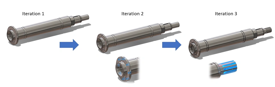

Capturing a Design Change as an Iteration
Next, the initial drive shaft design is modified by adding a circular pattern of counterbored holes to the end flange.
In this example, the designer would like to save the part back to the cloud to capture their changes, but there are still more modifications to be done to the drive shaft in SOLIDWORKS before the design is formally put forward for review by their team members.
To capture the change and keep the original design as it was, the designer could create a new revision to capture the modification. However, creating a new revision to capture an in-work change like this can add unnecessary overhead to the design process, especially if it requires a formal design review and release process first.

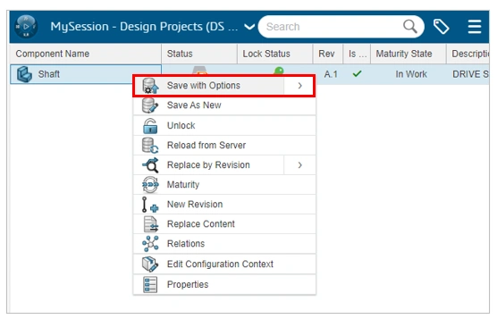

Instead of creating a new revision, when saving the design back to the 3DEXPERIENCE platform using the Save With Options command, the designer selects the option to keep the previous Iteration.
Note: To capture the current state of your part open in session as an Iteration with comments, the part must have been saved at least once to the 3DEXPERIENCE platform (in its current state). After this first save, next use the Save with Options command and select the option to Keep the Previous Iteration. Saving the design to the 3DEXPERIENCE at least once in its current state will ensure that the Keep Previous Iteration option will capture the current state of the model that is open in session.

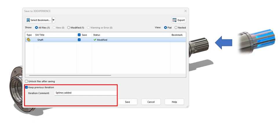

Splines are added to the end of the shaft, and a third Iteration is captured during the save to the 3DEXPERIENCE platform.
Each saved iteration becomes part of the design’s history, allowing designers to review how the part evolved.
The Iterations associated with a SOLIDWORKS file can be viewed by first selecting it in the MySession Task pane, followed by the Iterations command on the Lifecycle toolbar.
The Iterations dialogue box will display the Iterations, the comments added during each save, plus the date and time information.

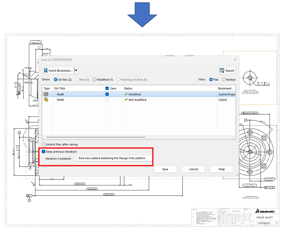

b) Working with Iterations of a Drawing

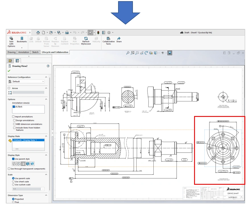

Iterations of a SOLIDWORKS drawing file are captured in the same way as iterations of a part file. Like parts, drawing iterations are intended for capturing In Work modifications that a user may want to revert the drawing to at a later date. Iterations allow users to maintain a history of a drawing while working, without needing to create copies of the file or having to create unnecessary revisions that could have additional lifecycle implications.
To create an Iteration of a drawing, save the drawing using the Save With Options command from the My Session Task Pane. In the Save to 3DEXPERIENCE dialogue box, check the option to Keep Previous Iteration and then add an Iteration Comment.
In the example below, a new view is added for detailing the flange and the counterbore hole pattern to the drawing of the Drive Shaft.
Note: To capture the current state of a drawing that is open in session as an Iteration, the drawing must have been saved at least once to the 3DEXPERIENCE platform (in its current state). After this first save, next use the Save with Options command and select the option to Keep the Previous Iteration. Saving the design to the 3DEXPERIENCE at least once in its current state will ensure that the Keep Previous Iteration option will capture the current state of the model that is open in session.Each iteration of a drawing will capture the changes made to the drawing file, but will not capture the state of the referenced part or assembly at that moment. Therefore, when restoring a previous iteration of a drawing, only the drawing file is restored. The part or assembly that the drawing is referencing will remain unchanged.
In a situation where the state of the referenced part or assembly must also be maintained alongside each major drawing modification, using revisions instead of iterations should be considered.

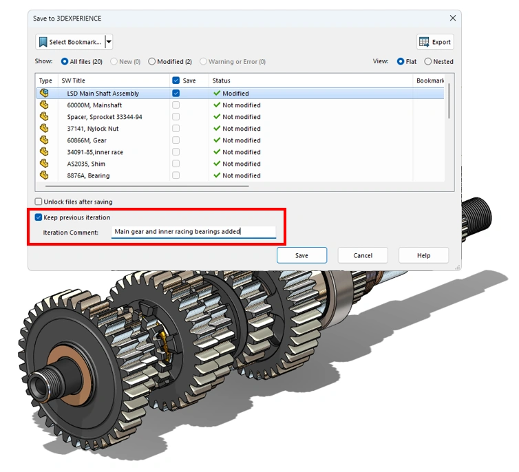

c) Working with Iterations of an Assembly
Iterations of a SOLIDWORKS assembly file are captured in the same way as iterations of a drawing and part file. As explained in the previous sections of this guide, iterations are intended for capturing in-work modifications that a user may want to revert to at a later date.
To create an Iteration of an assembly, save the assembly using the Save With Options command from the My Session Task Pane. In the Save to 3DEXPERIENCE dialogue box, check the option to Keep Previous Iteration and then add an Iteration Comment.
Note: To capture the current state of an assembly that is open in session as an Iteration, the assembly must have been saved at least once to the 3DEXPERIENCE platform (in its current state). After this first save, next use the Save with Options command and select the option to Keep the Previous Iteration. Saving the design to the 3DEXPERIENCE at least once in its current state will ensure that the Keep Previous Iteration option will capture the current state of the model that is open in the session.

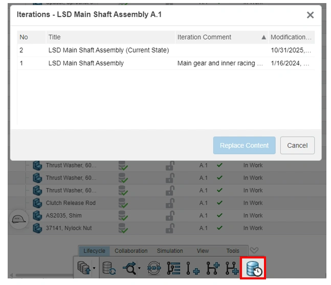

The Iterations associated with a SOLIDWORKS assembly file can be viewed and restored by first selecting it in the MySession Task pane, followed by the Iterations command on the Lifecycle toolbar.

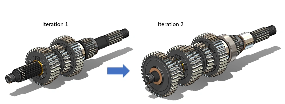

Each iteration of an assembly will capture the changes made to the assembly file (added and removed mates, components, assembly patterns, assembly features, and reference geometry, etc.), but will not capture the current state of any referenced parts or subassemblies at that moment. Therefore, when restoring a previous iteration of an assembly, only the assembly file is restored. The parts and subassemblies that the assembly is referencing will remain unchanged.
In a situation where the state of the referenced subcomponents must also be maintained alongside each major assembly modification, using revisions instead of iterations should be considered.
