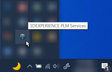

b) 3DEXPERIENCE PLM Services
3DEXPERIENCE PLM Services is a small application (EdmServerV6.exe) that assists with the client/server XML messaging activity of the PLMCSA client. The application appears in the Windows notification area as a 3DEXPERIENCE icon with the tooltip 3DEXPERIENCE PLM Services.

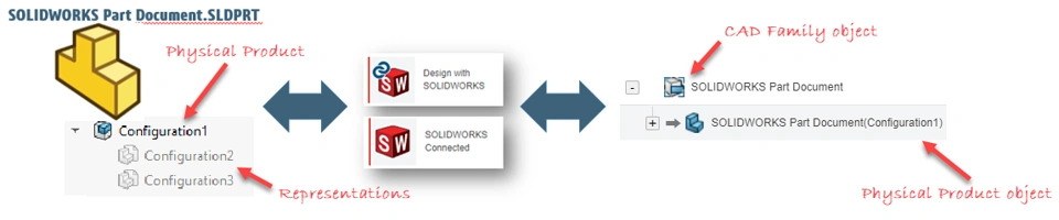

When you save a SOLIDWORKS file to the 3DEXPERIENCE platform, you create objects within the 3DEXPERIENCE platform that correspond to the components of the SOLIDWORKS structure. SOLIDWORKS files and SOLIDWORKS configurations map to certain 3DEXPERIENCE platform objects on the 3DEXPERIENCE platform.
SOLIDWORKS part (SLDPRT) and assembly (SLDASM) files map to CAD Family objects within the 3DEXPERIENCE platform. Each SOLIDWORKS configuration with a SOLIDWORKS part or assembly file maps to a Physical Product object within the 3DEXPERIENCE platform.
CAD Family objects for SOLIDWORKS part (SLDPRT), and assembly (SLDASM) documents with only one configuration are not visible within the 3DEXPERIENCE platform applications. For more information about this behavior, refer to the Knowledge Base Article ID: QA00000102922.
SOLIDWORKS drawing (SLDDRW) files map to Drawing objects within the 3DEXPERIENCE platform.
The following illustration depicts the SOLIDWORKS to 3DEXPERIENCE platform data model for a SOLIDWORKS part document.
In this illustration, a single SOLIDWORKS part (SLDPRT) document that contains three configurations creates one CAD Family object and three Physical Product objects within the 3DEXPERIENCE platform. Each SOLIDWORKS configuration is a Physical Product object.
The 3DEXPERIENCE platform data model keeps track of the relationships between the CAD Family, Physical Product, and Drawing objects for the SOLIDWORKS assemblies, parts, and drawings.

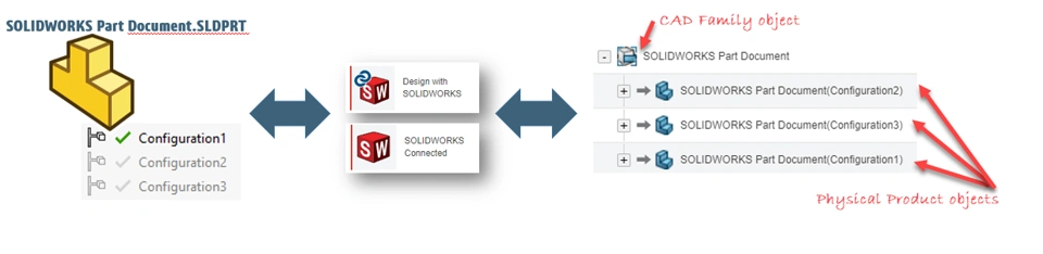

a) 3DEXPERIENCE Compatibility
You do not create 3DEXPERIENCE objects for representations within SOLIDWORKS assembly and part documents after converting the SOLIDWORKS files to 3DEXPERIENCE Compatibility.
The following illustration depicts the SOLIDWORKS to 3DEXPERIENCE platform data model for a SOLIDWORKS part document upgraded to 3DEXPERIENCE Compatibility.
In this illustration, a single SOLIDWORKS part (SLDPRT) document that contains one Physical product and two representations in SOLIDWORKS for a total of three configurations. This SOLIDWORKS part creates one CAD Family object and one Physical Product object within the 3DEXPERIENCE platform.
You may see performance improvements using 3DEXPERIENCE operations with a multiple configuration SOLIDWORKS file converted to 3DEXPERIENCE Compatibility using Representations versus the same legacy multiple configuration SOLIDWORKS file because you create/modify fewer 3DEXPERIENCE objects on the 3DEXPERIENCE Platform.

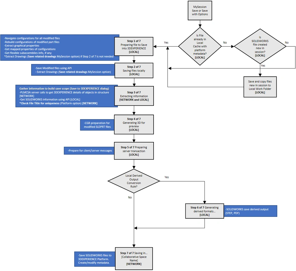

c) ENOVIA MySession Save Options
The MySession Save options may increase the amount of data or change how you send to the data to the 3DEXPERIENCE platform. Here are the options and how they influence the save behavior.
i) Save graphical properties (Default: OFF)
This option saves additional metadata to the 3DEXPERIENCE data model. This option extracts the color, hide or show state, and transparency of components within a SOLIDWORKS assembly (SLDASM) to the Physical Product object within the 3DEXPERIENCE platform.
This option may influence the save performance, especially for SOLIDWORKS assembly structures with more than one configuration or many component-level appearances.

iii) Activate asynchronous save (Default: ON)
This option changes the save behavior if you save 25 or more modified or new objects to the 3DEXPERIENCE Platform when Activate asynchronous save is on. The save procedure moves to a separate process (AsyncSaveinto3DEXPERIENCE.exe) outside of the main SOLIDWORKS process.
You benefit from better productivity working within the SOLIDWORKS application while the save is asynchronously running in the background.
Please note that asynchronous save requires more time to establish a new connection to the 3DEXPERIENCE platform.
iv) Save related drawings (Default: OFF)
This option uses the SOLIDWORKS Document Manager API to find related drawings to include in the Save scope (Save with Options dialog) for the SOLIDWORKS structure when the Save related drawings option is on.
This activity happens prior to Step 3 of 7, Extracting file information during the save to 3DEXPERIENCE platform save procedure.
You may experience a delay due to this activity if you have many SOLIDWORKS drawings in your local work folder with Save related drawings on.
v) Enable save optimization (Default: ON)
This option optimizes which SOLIDWORKS files within the SOLIDWORKS file structure to traverse when building the Save to 3DEXPERIENCE dialog for the list of new and modified files to save when Enable save optimization is on.
Listing fewer SOLIDWORKS files within the Save to 3DEXPERIENCE list results in better performance.

6) SOLIDWORKS Save Procedure to 3DEXPERIENCE Platform
The following workflow image provides a detailed technical summary of what happens when you save a SOLIDWORKS file within the MySession app from the 3DEXPERIENCE task pane.
There are many steps during the save process. Refer to the 3DS.com Knowledge Base article QA00000069720 for the details about each step during the save process.
See the FAQ below for additional questions about the save process.
a) FAQ
Question: Why might the Step 2 of 7 Saving files locally… process take a long time while saving a SOLIDWORKS assembly document?
Answer: Confirm that the MySession > Options > Save tab > Save information about weight and balance option is active. This option requires that the Tools > Options > System Options > Performance > Update mass properties while saving document in SOLIDWORKS is also active. Assembly documents that contain complex components may take additional time to recalculate the mass properties.
If you experience a significant delay accessing Tools > Evaluate > Mass Properties in SOLIDWORKS or when clicking Recalculate in the Mass Properties dialog box, then this could be the source of the delay.
Additionally, check for perpetual rebuild lights or files in a permanently modified state within the SOLIDWORKS FeatureManager Design Tree structure. SOLIDWORKS files always in a modified state are always saved during this step.
Question: Why might the Step 3 of 7 Extracting file information... process take a long time while saving a new simple SOLIDWORKS part document?
Answer: First, consult your 3DEXPERIENCE platform administrator to confirm that the Check for file uniqueness option is active. Next, review the 3DEXPERIENCE files on the This PC tab to determine how many files exist in your local work folder. This step queries the files in your local work folder. If thousands of files exist in the cache, this procedure may take longer than expected.
Question: Why might the Step 6 of 7 Generating derived formats… process take so long?
Answer: If your 3DEXPERIENCE platform administrator created a conversion rule, such as Step_AP203 with SOLIDWORKS (Synchronous, at save) for a SOLIDWORKS part, and you save a SOLIDWORKS part document with many configurations, you may experience this behavior.
SOLIDWORKS needs to create a .STEP file for each configuration during the save process.
