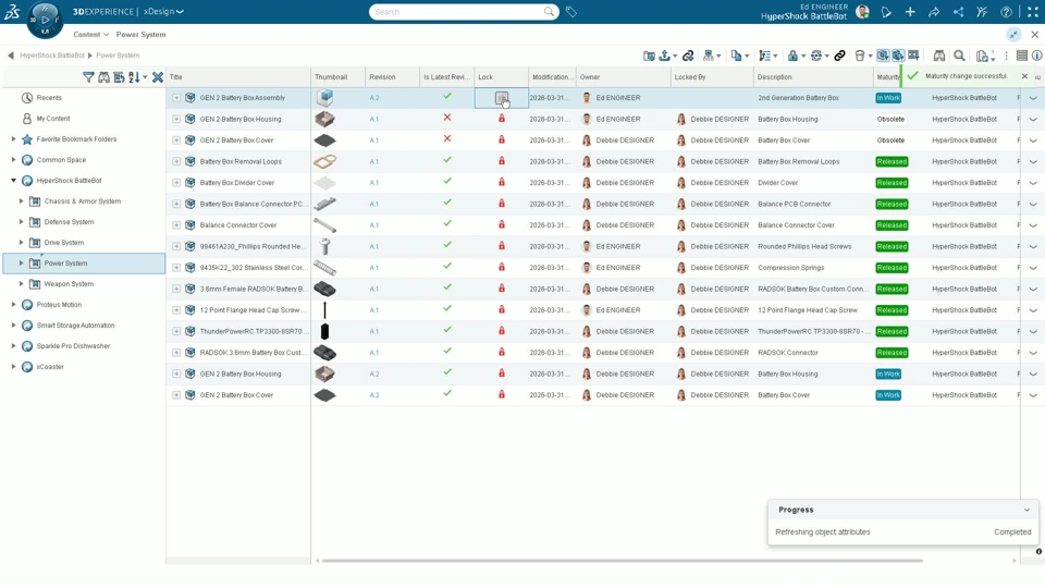

Manage, Organize, and Browse Your Data with Content Explorer
Organize and access your design files more easily with direct integration with Content Explorer. When you open or save content in xDesign, you are now prompted to browse or store your files in Content Explorer, providing a centralized place to manage, organize, and find your data quickly.

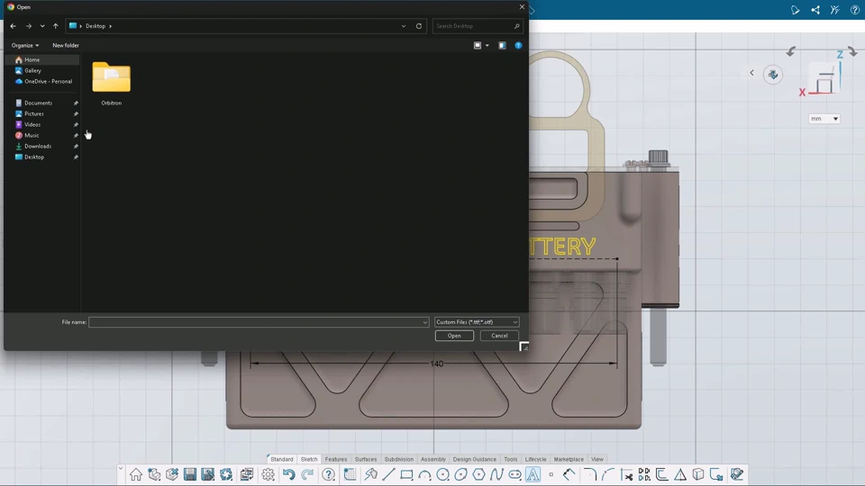

Use Custom Fonts in Sketch Text
Create text that fits your design and manufacturing needs by importing your own font files. Add .ttf or .otf fonts and use them directly in sketch text within your design, giving you greater flexibility to design labels, engravings, and markings with the exact style you require.
