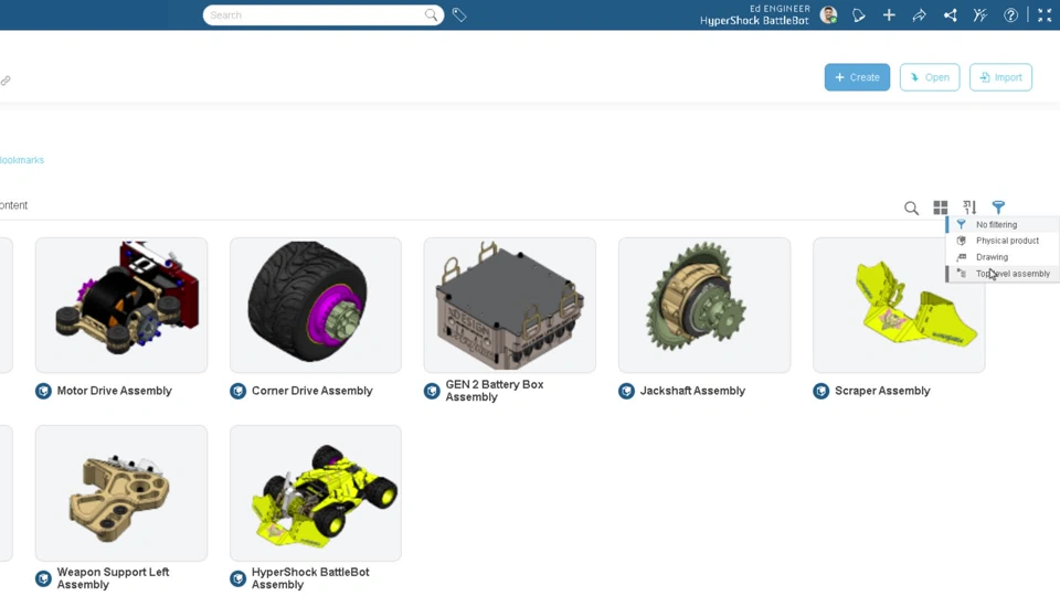

Improved Home Screen
Quickly return to your projects and manage your content with a more intuitive home screen. Access your “Recently Opened” files and “My Content” directly from the landing page. Use the three-dot menu for actions such as open item in a new tab, create drawing from part, view information, or delete content. Jump back to the home screen anytime using a new shortcut in the action bar. These improvements help you find your work faster, organize it with ease, and stay focused on designing.

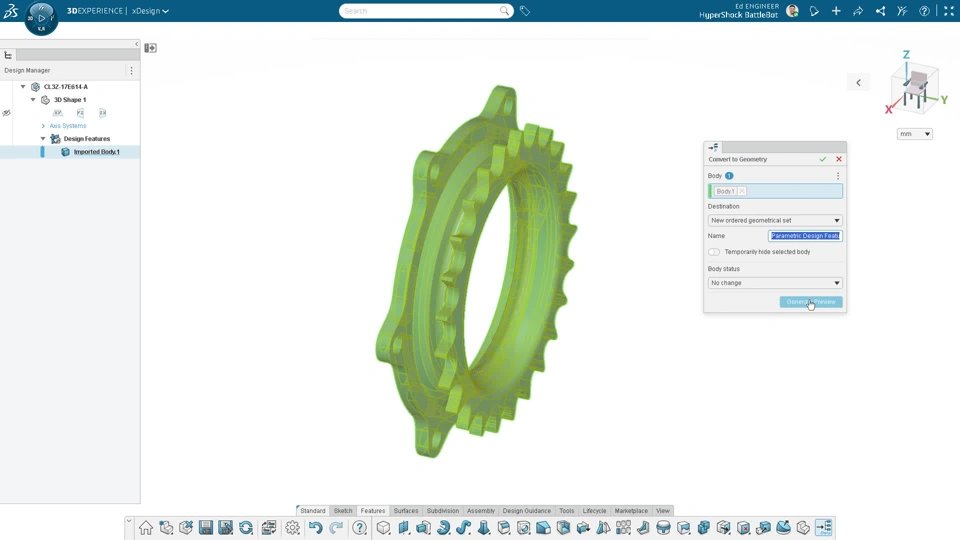

Convert Imported Geometry into Editable 3D Models (Beta)
Convert imported BREP geometry into fully editable 3D models so you can make design changes directly in xDesign. This gives you the flexibility to iterate and refine designs without starting from scratch, saving time and making it easier to work with imported data.

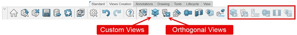

Improved User Experience
Reduce the learning curve for using a combined model and drawing definition environment with improved in-app terminology and action bar command grouping.
  • Terminology changes
    • Model definition manager >> Product Definition Manager
    • Model >> Physical Product
    • Model Definition >> Product Definition
  • Command name changes
    • 2D View >> Orthogonal View
    • 3D View >> Custom View
  • Action bar grouping
    • All view commands now present on the view creation tab.

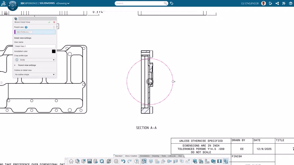

Automatic View Labels
Automatically generate clear, consistent, and standards-compliant view labels for section, detail views, and more, with no manual setup. Use the new Edit View Label context option to control label text, format, and style. Updated system and document options let teams define company-wide standards for faster detailing, fewer errors, and a more uniform drawings.

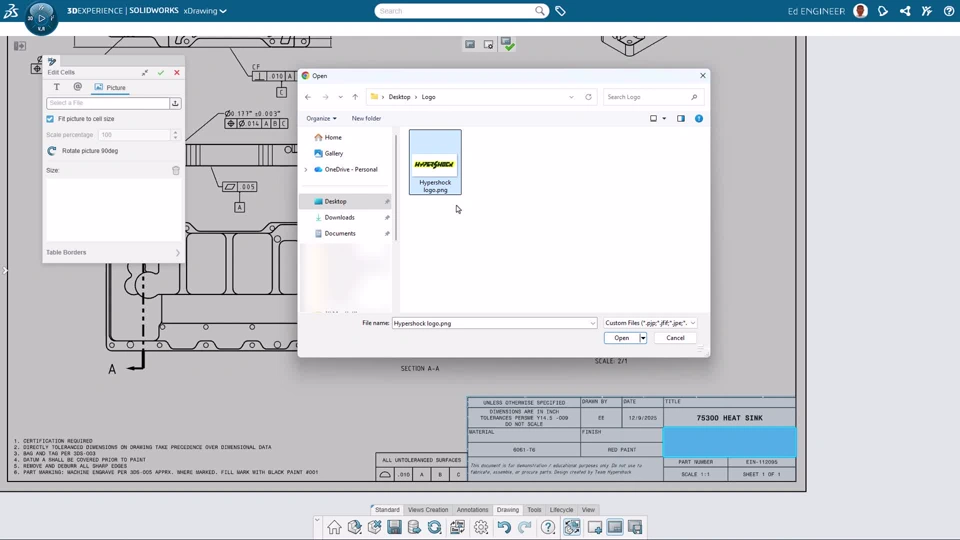

Image Support for Tables
Personalize your drawings and promote your company branding with image support for drawing tables.

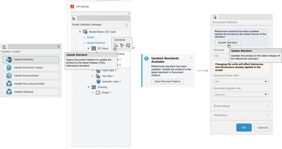

Improved Standard Initialization and Updates
Eliminate onboarding barriers by automatically creating all required xDrawing standards during Admin setup, ensuring every user can immediately create Annotation Sets without waiting for manual initialization. A unified update content workflow now keeps xDrawing standards current across releases while preserving existing settings, reducing admin overhead and preventing workflow disruptions. Users opening older Annotation Sets are guided with clear prompts and a simple update standard action to bring documents up to date. Together, these improvements deliver a smoother, more reliable experience for teams, classrooms, and large organizations alike.

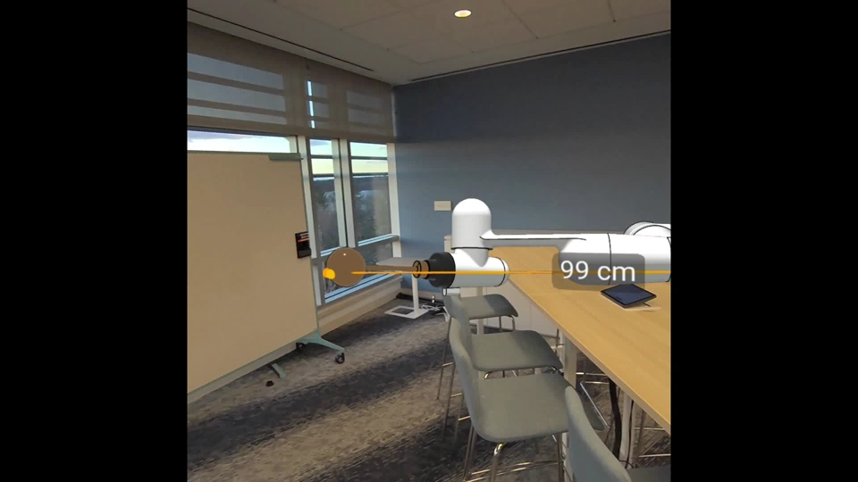

Measure
Gain better insights from your model and how it will fit within your surroundings with the ability to measure within an Extended Reality session. Choose between three measure modes:
1. Default - Measure between different parts of your model
2. Free - Measure anything whether in the real or virtual world
3. Normal - Measure from a place in the model to the next face normal to the first selection

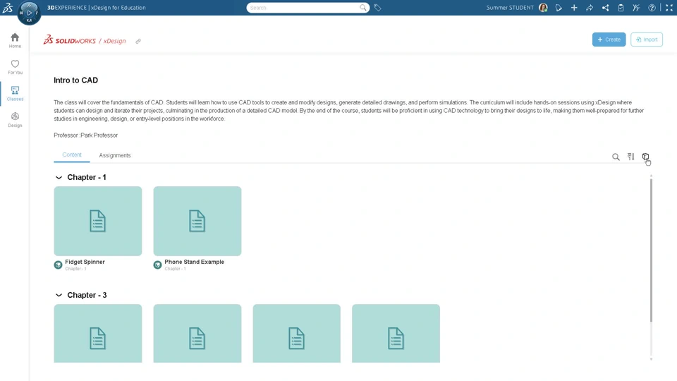

xDesign for Education

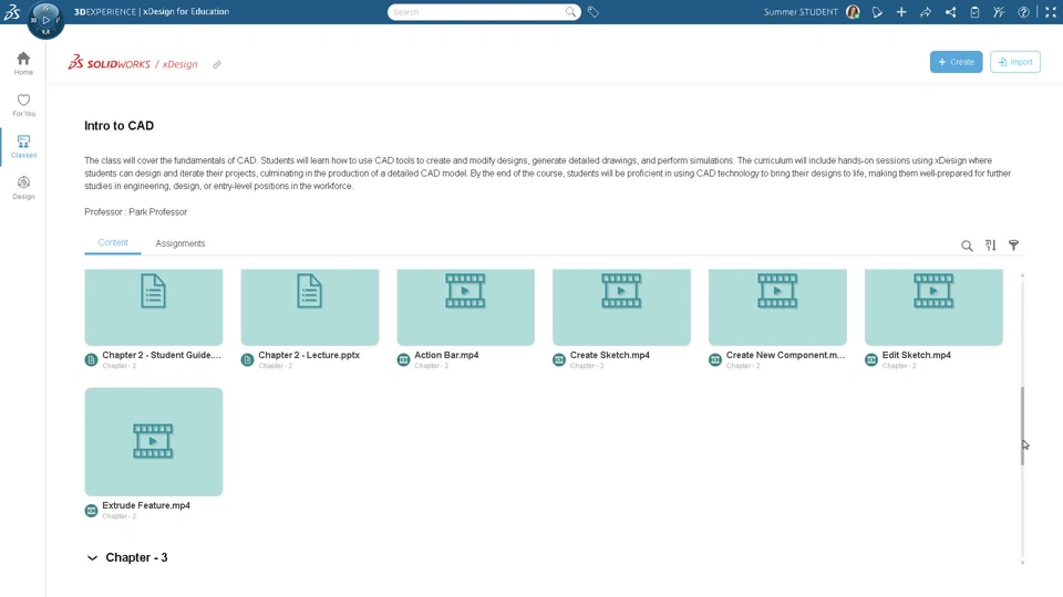

Streamlined Assignment Access
Easily stay on top of coursework with a clean, intuitive interface that keeps all assignments organized and accessible.
When you enroll in a class, you can view a summary of your class content, including assignments, on the xDesign landing page of your standalone experience. This summary includes a carousel displaying upcoming assignments. The View All option in the Class Summary allows you to access all your assignments in the Assignments tab, where you can sort them by most recent, oldest, or urgent ones. You can easily track the status of each assignment, which is labeled as To Do, In Work, Overdue, or Completed. By hovering over an individual assignment, you can see additional details such as the exact due date. Assignments can be opened in the side panel for quick access.
Seamless Content Refresh
Stay up-to-date with the latest class content through a convenient refresh that won’t disrupt your ongoing tasks.
You can check for new content as soon as your teacher makes it available by clicking the Refresh button, which appears next to the class title whenever new material is added. This action updates only the content on the Classes tab and does not disrupt or close any active design sessions in the Design tab or side panels. Additionally, newly added items in the Classes tab are marked with a “New” flag to help you identify them easily.
