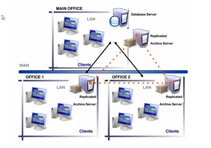

The following image depicts a typical multisite SOLIDWORKS PDM Professional installation:
This installation includes:

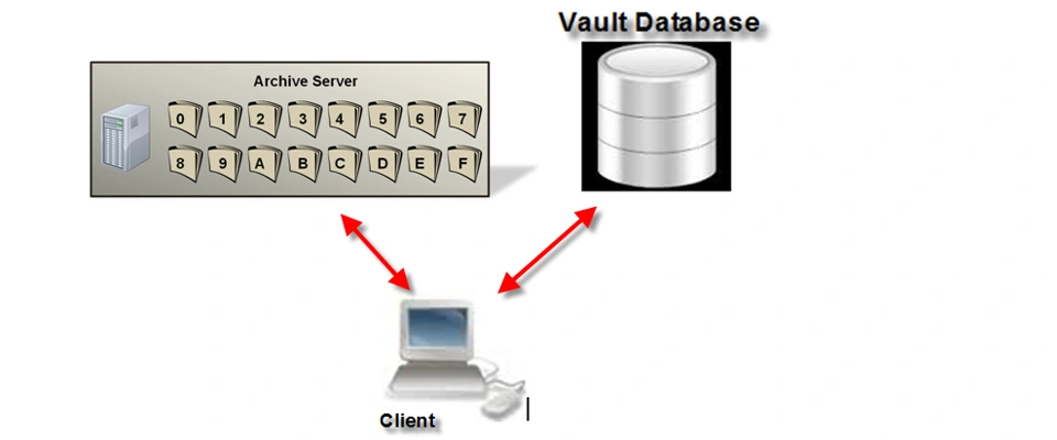

  • A SOLIDWORKS PDM Professional vault database, which is a Microsoft SQL Server (MSSQL) database.
  • One or more “archive” servers that store the file archives and archive server settings.
  • One or more clients that connect to the central database and the archive server to exchange data.
The SOLIDWORKS PDM Professional data spreads across the archive server (which stores the actual document in a hexadecimal folder structure) and the metadata (data about data) information, which is stored in the central (common to all sites in case of replicated environment) MSSQL vault database.
Each client works on data locally (where the data is cached to a user’s local view) and saves changes to the server through the check in process.

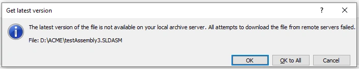

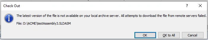

Be aware that documents in the vault have matching (“in sync”) information on the archive and database servers. Therefore, you should ideally back up these server components together for a perfect recovery.
Typical situations when restore of SOLIDWORKS PDM Professional components require more clean up and manual intervention (general recovery scenario) occur when the database and archive servers are not in sync.

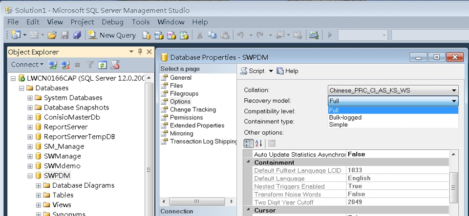

a) Simple Recovery Model
As the name implies, this is the simplest of the recovery models. If you choose this model, you can restore only full or differential backups. You cannot restore backups to any specific point in time. SQL Server truncates the transaction logs when the database reaches a transaction checkpoint, and it leaves no log entries for disaster recovery. Therefore, you lose any changes to the data that occur between the last full or differential backup and the failure.
b) Bulk Logged Recovery Model
This recovery model is for use on databases that already use the Full recovery model and when performing bulk load operations (such as a data warehouse load).
If you choose the Bulk logged database recovery model, you have the ability to create transaction log backups. However, you are not able to restore to a specific point in time with these log backups. You must restore the entire transaction log backup. This is better than in the simple recovery model, because at least you do not lose any data. However, it is probably not necessary to use the Bulk logged recovery model unless you continually perform data loads.
This method is not particularly applicable to SOLIDWORKS PDM Professional environments, so it is not discussed further in this document.
c) Full Recovery Model
The Full recovery model provides the most flexibility on the types of backups that you can create. You can use full database backups, file backups, differential backups, and transaction log backups. The choice of a backup strategy in this scenario varies greatly based on your database size, the backup medium, and the level of recoverability that you want to establish for the data.
d) Recommended Recovery Model
For ease of restoration, the recommendation is to use the Simple recovery model to control the transaction log file size, and to perform a Full backup rather than differential backups. If a dedicated database expert is available, then you can implement any convenient backup strategy as long as it restores the database correctly.
If you already have tools and processes in place for a different MSSQL database backup (which might be in use for a third-party system), you can use those for a SOLIDWORKS PDM Professional database also.
For more information about these recovery models, see the Microsoft topic “Recovery Models (SQL Server).”

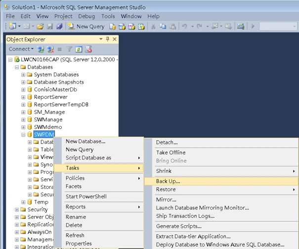

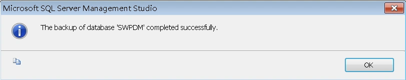

4) Backing Up the File Vault Database - Manual Method

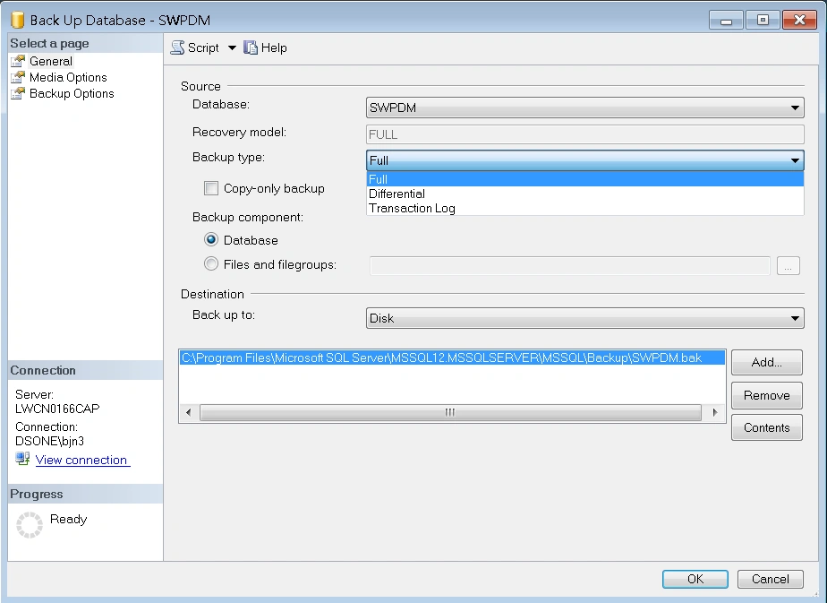

1. In Microsoft SQL Server Management Studio Object Explorer, expand the node for the SQL Server instance.
2. Right-click the database that you want to back up > select Tasks > and then click Back Up. The Backup Database dialog box appears.
3. For Backup type, select the Full option. Note that this is different from the “Full recovery model” discussed earlier in this document.
4. In the Destination group, specify the location in which you want to store the backup. By default, the tool specifies the location as ‘%SQL Server Installation Path%\\Backup\\[database name].bak’. However, this is not ideal. It is better to define a location specifically suited for the purpose - preferably on another disk drive.
5. Click OK. This initiates a full backup of the database. When the backup is complete, the following confirmation message appears.
6. Click OK to dismiss the message.

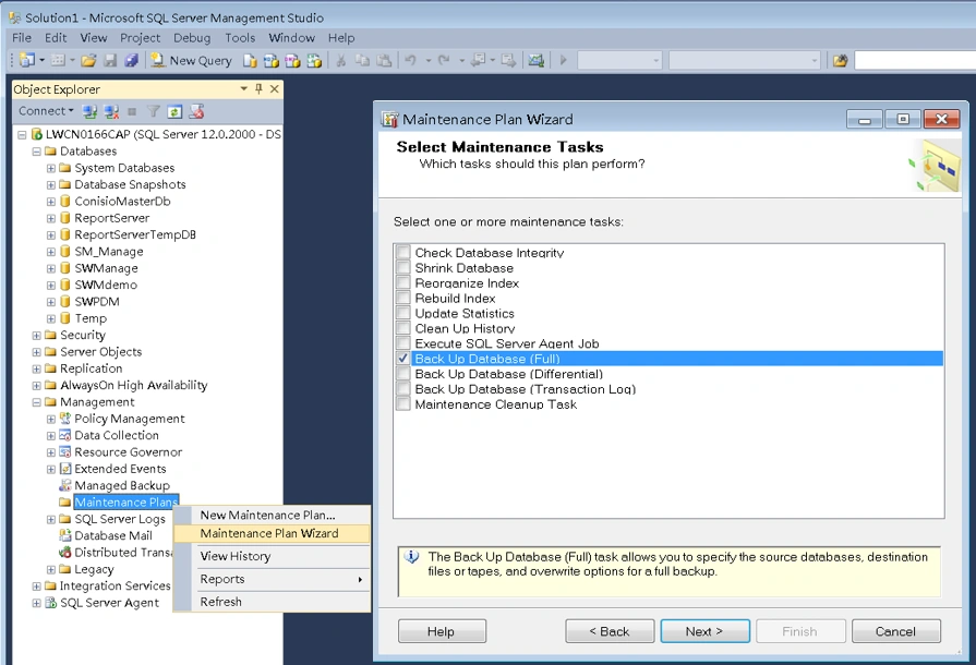

You can schedule a periodic backup by accessing the Maintenance Plan Wizard from the context menu for the Maintenance Plans folder of the SQL Server instance. Before running the backup, it is a good idea to check the database integrity. Make sure that you store backup files generated by the maintenance plan in isolation from working MDF and LDF files.
Users can configure the database to send email alerts with regard to a scheduled backup task, a consistency check failure, and others conditions. For instructions about how to configure database email messages, see the SOLIDWORKS Knowledge Base solution S-027967 and the Microsoft SQL Server documentation. This feature makes it possible for the database administrator to receive notifications about successful and failed backups. The administrator can then initiate corrective actions as necessary to minimize subsequent problems.

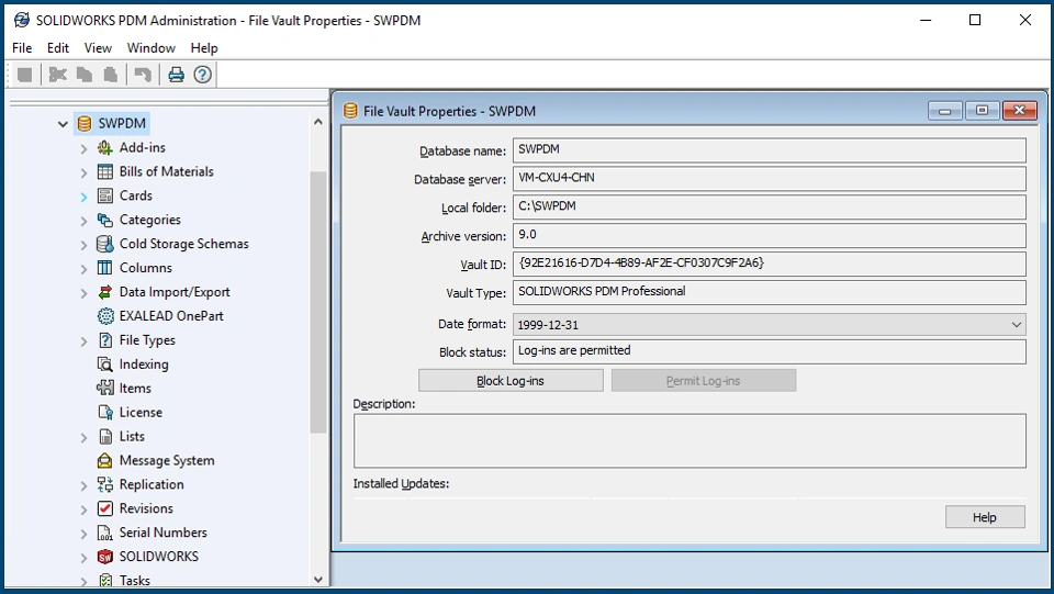

  • Option 1: The SOLIDWORKS PDM Administration tool provides a vault-specific Block Log-ins option shown in the following image. To access this option, right-click the file vault > [Vault Name] > Properties.
After selecting this option, new users cannot log in to the vault. You can use the SQL queries from Knowledge Base solution S-08712 to identify users with active sessions, and then ask those users to log off. You can then proceed to back up the database and archives.

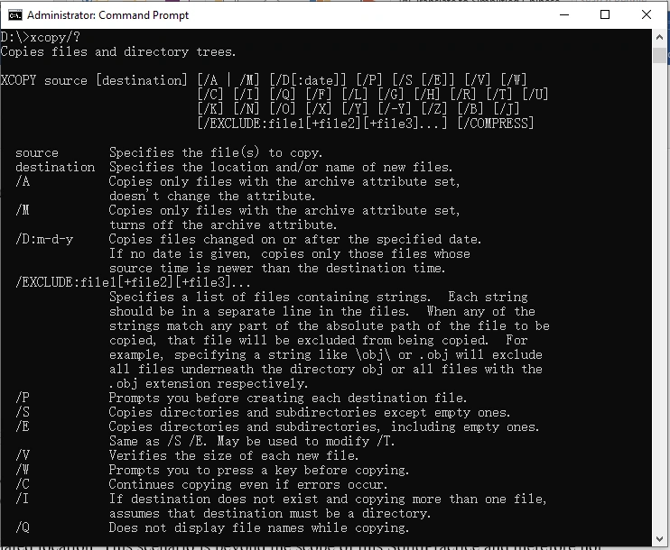

You can create a backup of the archive file set by using whichever tools are available at the server site. To make a full copy of the entire folder structure, you might use something as simple as a shell script that uses the ‘XCOPY /S’ command. There are also third-party tools available that are capable of performing full or incremental backups. Such tools are a recommendation where the number of files, the file size, and the available downtime for backup is a factor of concern.
The time necessary to back up the database is significantly smaller when comparing to archives for a relatively larger vaults.

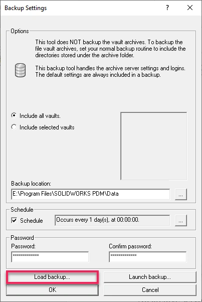

To back up the archive server settings:
1. On the archive server, from the Windows® Start menu, go to All Programs > SOLIDWORKS PDM Professional > Archive Server Configuration.
2. Select Tools > Backup settings.
3. In the Backup Settings dialog box, select the Include all vaults option. This is the default option.
Alternatively, you can select the Include selected vaults option and then specify the file vaults for which the settings will be backed up.
4. Specify or select the Backup location. The default location is the archive root folder.
5. To schedule an automatic backup, activate the Schedule option and specify the schedule.
6. Type and confirm a password for the backup file. This password is required while restoring these settings.
7. To perform a backup, do either of the following:
a. To perform the backup at the scheduled time, click OK.
b. To perform the backup immediately, select Launch backup and then click OK in the confirmation message.
The backup file saves in the specified location with name “Backup.dat”. The archive server settings backup should typically occur at either the same time as the file archive back up, or after. This information changes only when the archive server settings change. In a replicated setup, it is a best practice to back up the file archives and archive server settings on each archive server.

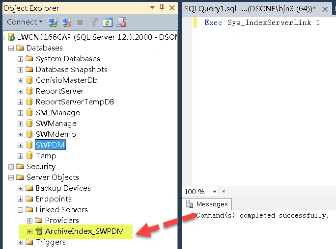

  6. Recreate the linked server for content searching.

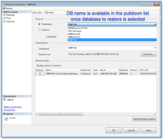

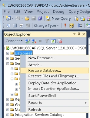

To restore the vault database, follow these steps. You can restore the ConisioMasterDB database in the same way. The steps to clean the database apply only to the vault database.
1. In Microsoft SQL Server Management Studio, right-click the Databases node, and then click Restore Database.
2. In the Source group of the Restore Database dialog box, select the database you want to restore. After selecting a database, the database name appears automatically in the drop-down list in the Destination group. The example in the following image restores the database to its original name.

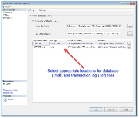

3. On the Files page, specify the appropriate locations for the database files.
4. In the Options tab, for Recovery state, keep the default selection of the following option:
RESTORE WITH RECOVERY. Leave the database ready to use by rolling back uncommitted transactions. Additional transaction logs cannot be restored.
5. To begin the restore operation, click OK. After restoring the database, a confirmation message appears to let you know that the database was restored successfully.

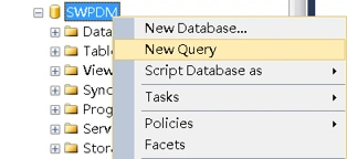

3. In Microsoft SQL Server Management Studio, right-click the restored database > New Query.
4. In the query pane, type the following statment and then click Execute (or go to Query > Execute):
DELETE FROM ArchiveServerStored

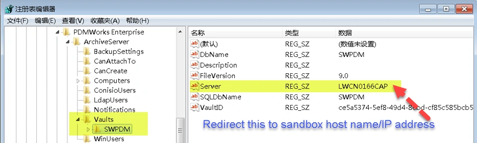

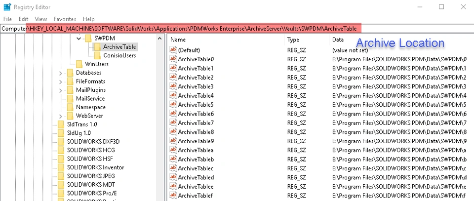

At this point, the assumption is that on this sandbox, there is a current installation of the archive server components, and that the archive server root folder exists. You can confirm this by reviewing the settings in the following registry key on the sandbox:
HKEY_LOCAL_MACHINE\\SOFTWARE\\SOLIDWORKS\\Applications\\PDMWorks Enterprise\\ArchiveServer\\Computers\\\\Archives
To import the archive server settings, use the Archive Server Configuration tool. Follow these steps:

For content search to work the vault, the SQL Server needs to have a linked server available for the restored vault database.
To allow indexing of the file vault database, follow these steps to create a linked server entry:
  1. In Microsoft SQL Server Management Studio, right-click the file vault database > New Query.
  2. In the query pane, type the following statement and then press the Execute button.
Exec Sys_IndexServerLink 1

1. Edit the Archiveservers table to match the new server name as shown in the following image.
2. Redirect the server registries to the sandbox environment.
Note that the following registry key points to the original server location:
HKEY_LOCAL_MACHINE\\SOFTWARE\\SOLIDWORKS\\Applications\\ PDMWorks Enterprise \\ArchiveServer\\Vaults\\[Vaultname]\\Server
It is necessary to point this registry key to the host name and IP address of the sandbox when applicable.
After completing these steps, open the SOLIDWORKS PDM Administration tool. The vault is now available in the list. Create a local view and test the restored vault.

In a production environment, it is more likely to have an asynchronous setup after the restore. In is not uncommon to experience some data loss. This section discusses the possibility of common scenarios.
a) Database is the latest available and archive restored from the last backup
In these cases, there are database entries for files added and checked in after the most recent archive server backup. Therefore, these files appear for authenticated users. However, the Get and Check Out functions for such files return the following errors:
Error on Get:
Error on Check Out:
For files that are new (that is, no single version of the file exists prior to the most recent archive server backup), follow these steps:
1. Have the user switch to offline mode.
2. Exit SOLIDWORKS PDM by right-clicking the tray icon and selecting Exit.
3. Copy all of the files in the user’s local view to a temporary folder. You can use the Copy and Paste commands for this, or you can use the ‘xcopy’ command. Use the following syntax for the xcopy command:
xcopy   \\E
The \\E switch copies all directories. To learn more about the switches, at the command prompt, type ‘xcopy/?’, following switches list pops out:
4. Go online. Delete and destroy such files from vault.
5. Add those files again from temporary folder to the vault, and then check the files in.
For files where newer versions are added before the archive server failed, do the following (perform this carefully per file basis):
6. Follow steps 1 through 3.
7. At step 4, instead of destroying the files, roll the files back to the last available version. Then, check out that document > copy and paste the files from the temporary folder, which adds the next version > check in that version.
