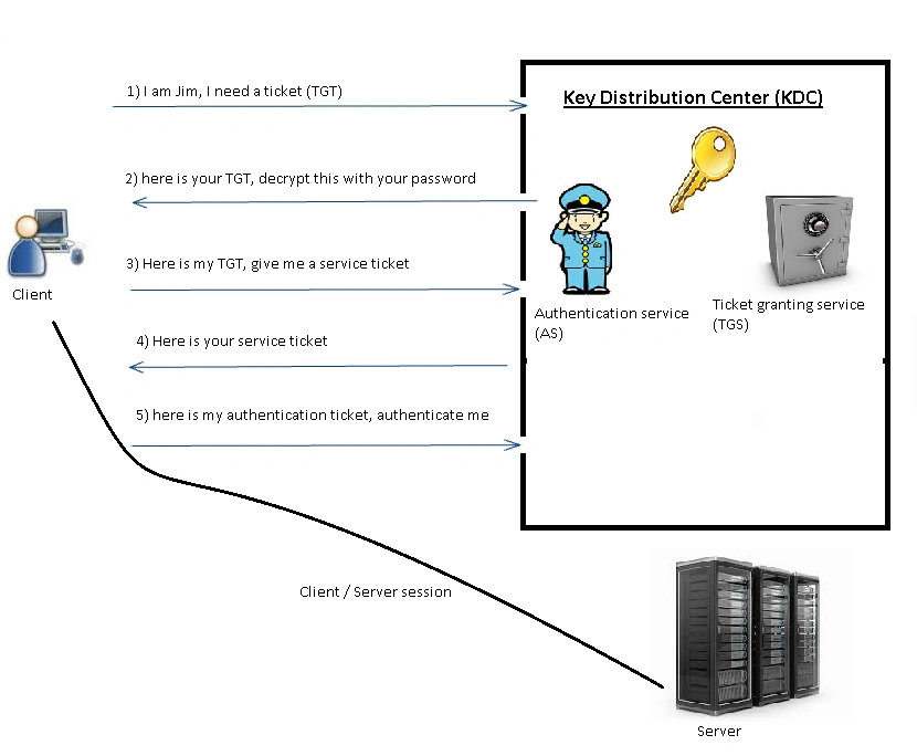

Kerberos is the default method of network authentication within Windows domains. Kerberos most commonly uses a password, and apart from the user entering a password, the process happens automatically in the background without user involvement.
The Kerberos protocol verifies the identity of users. This takes place between a client computer and an authenticating server. Both the server and client computer identity each other.
The Kerberos authentication mechanism issues tickets for accessing network services. A ticket, issued by a domain controller, is a set of identification data for authenticating a security principle. Tickets contain an encrypted password that confirms the user's identity to the requested service.
The following diagram shows depicts the occurrence of a Kerberos ticket exchange between a client computer and the authenticating server:

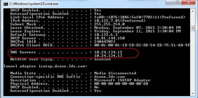

You can use the following commands to help identify the currently connected login server for authentication. Follow these steps:
- Open a Windows command prompt.
- Type: ipconfig /all
- Locate the DNS Servers line. The IP addresses of your preferred DNS servers appears on the right. The IP address at the top of this list is the primary DNS server connection. If the primary server is unavailable (due to maintenance or other reasons), then Windows uses the secondary server.

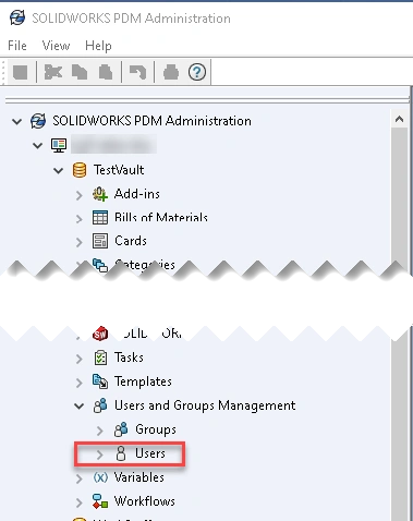

- Adding a new user in the SOLIDWORKS PDM Administration tool either by right-clicking Users > New user > New user, entering the Active Directory user credentials, and then clicking OK.
- Or, by right clicking Users > New user > New user, clicking List Users, selecting users to add, and then clicking OK.

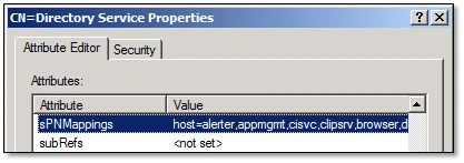

sPNMappings
If you want to see the default Host to SPN mappings, use either ADSI Edit or the Ldp tool to navigate to:
cn=Directory Services,CN=Windows NT,CN=Services,CN=Configuration,DC=[Your Domain Component]
Review the sPNMappings attribute.

The previous image depicts the following:
- The client takes approximately 0.20ms to request a ticket from the server (shown in blue highlight).
- The server takes approximately 0.20ms to respond to the client with the ticket (shown in yellow highlight).
- The total Delta Time for the pairs traced in this example is approximately 0.60ms, which indicates a good authentication time.
If the server response time is significantly higher than the client setup time, then this could indicate that the problem is on the server end or is a related network issue. If there are any retransmissions of the request, this could indicate that the network is dropping packets somewhere, or possibly an unreliable network connection is in use (for example - connecting through wireless with a poor wireless signal).
