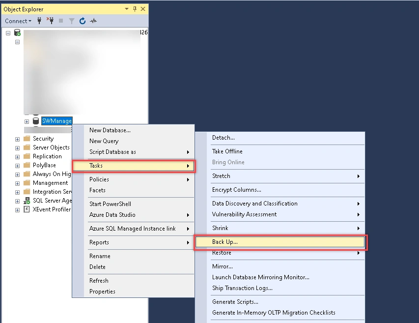

a) Backing Up the SQL Server Database
The database contains all item and project data created in your SOLIDWORKS Manage environment.

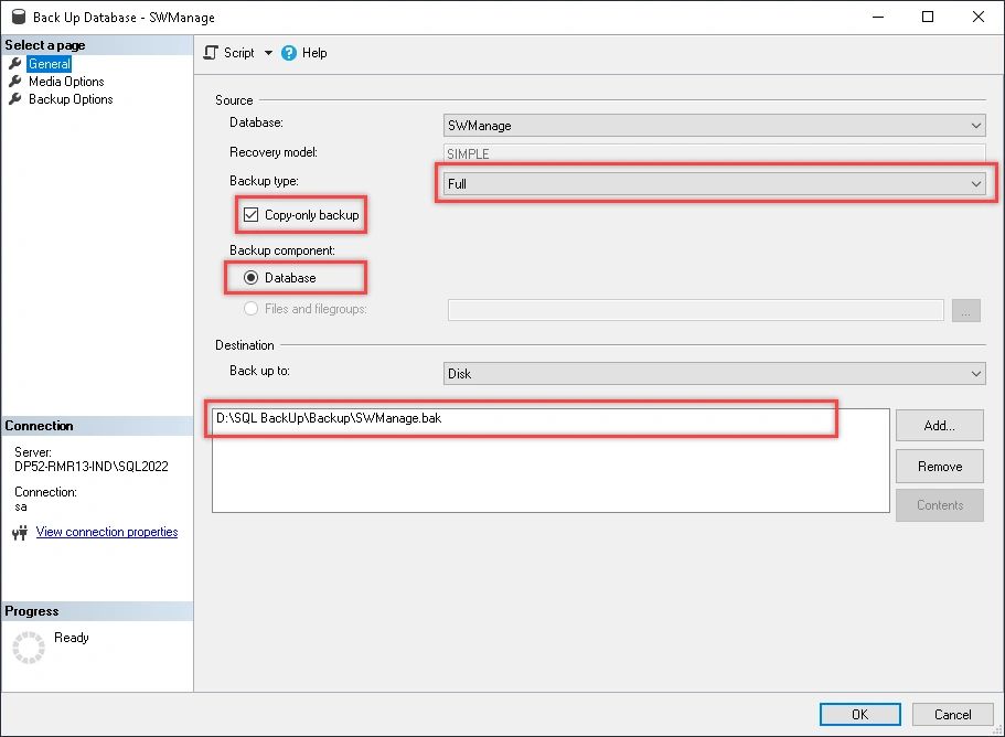

To back up the SQL Server database:
1. In SQL Server Management Studio (SSMS), right-click the SOLIDWORKS Manage database that you want to back up. Then go to Tasks > Back Up
2. In the Back-Up Database dialogue box, Select the General page
3. On the General page, select the following settings:
- Under Source, select Full as the Backup type.
- Enable Copy-only backup.
A copy-only backup is a SQL Server backup that is independent of the sequence of conventional SQL Server backups. Usually, taking a backup changes the database and affects how later backups are restored. Copy-only backups, however, do not affect the overall backup and restore procedures for the database.
- Set the Backup component to Database.
- Under Destination, select Disk as the Backup to location.
- Click Add to select the backup destination.
4. In the Media Options page, it is recommended to use the Overwrite media option and also mark the checkbox of Reliability > Verify backup when finished.
To learn more about backing up SQL Server databases, see Microsoft documentation.

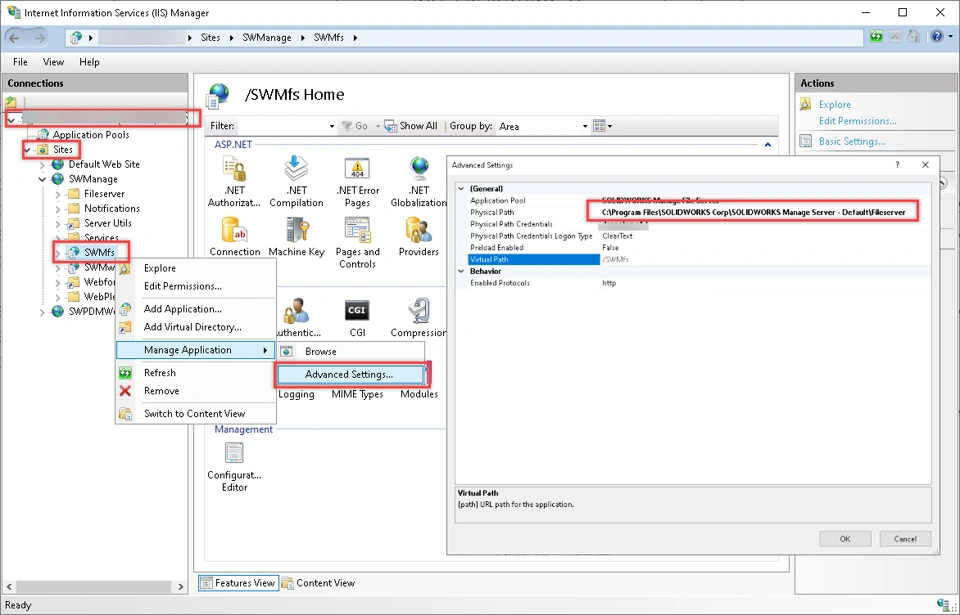

b) Backing up the Fileserver

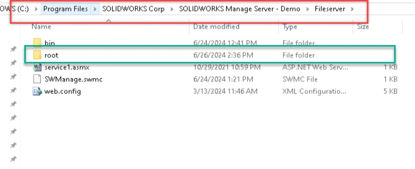

The Root folder contains all the files that are stored in document objects and the related files for all records in SOLIDWORKS Manage. Although the default location of the Root folder is , you might have selected a different folder location during installation.
To back up the Root folder, copy the contents to a secure, off-site disk. You might have selected a Root folder location different from the default location during installation.
To find the Root folder location on your SOLIDWORKS Manage server:
1. Open Microsoft Internet Information Services (IIS) Manage
2. In the Connection pane, Expand [ServeName] > Sites > SWManage > SWMfs (if the implementer maintained the default     settings.)
3. Right click SWMfs and select Manage Application > Advanced Settings. The Physical Path row lists the Root folder location.
4. Once you confirm the Root folder location, you can find it in File Explorer and perform the backup.

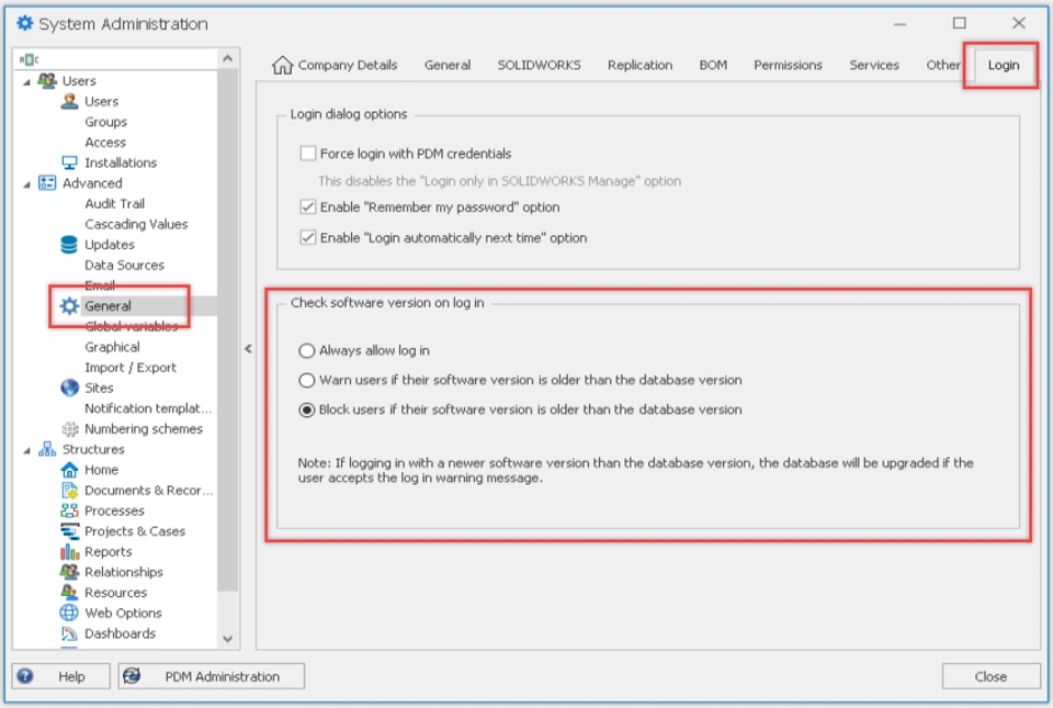

The database version is determined by the highest version client that is attached to the instance. After upgrading the first SOLIDWORKS Manage client and launching it, the user is prompted to upgrade the database. Users must be at least a Partial Administrator in order to upgrade the database; they do not require administrative privileges.
The new option ‘Check software version on login’ was introduced in 2024. These global options control the version with which desktop clients can log in, in SOLIDWORKS Manage.
Always allow log in - allows users to log in to SOLIDWORKS Manage with the same client version or older than the database version.
Warn users if their software version is older than the database version - If selected, users will be warned if their client version is older than the database version, however they can still log in.
Block users if their software version is older than the database version - (recommended option - This is the default setting when updating to Manage 2024) If selected, users will be blocked from logging in if their client version is older than the database version
Note: If logging in with a newer software version than the database version, the database will be upgraded if the user accepts the log-in warning message (only administrators and partial administrators can update databases).

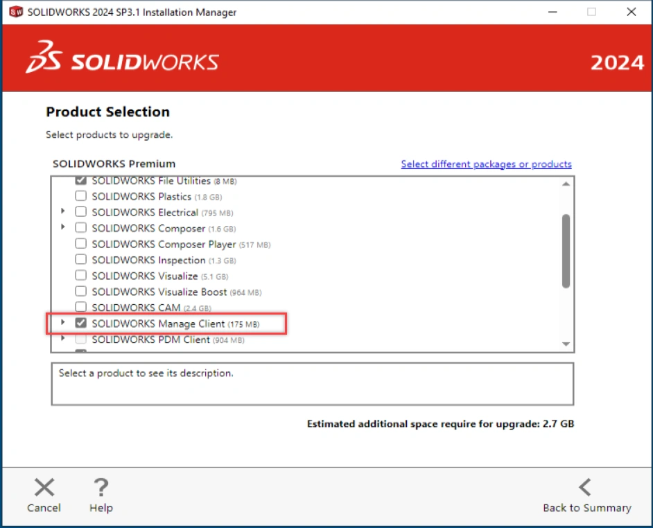

b) Upgrading the Clients
  1. Log in to a client workstation as a user with local administrative rights
  2. Browse to the installation media
  3. Run \\ SWManageClient\\setup.exe to start the SOLIDWORKS Manage client upgrade
  4. Follow the install wizard steps by clicking Next on each screen
If you are upgrading SOLIDWORKS Manage client using Installation Manager please refer to the below image:

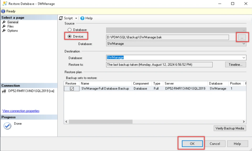

a) Restoring the SQL Database
1. Ensure that the backup file is intact and not corrupted. This may involve running checksum or validation tools
2. Use SSMS to initiate the restore process. This usually involves specifying the location of the backup file and the target database. Right-click the Databases node in Object Explorer and select Restore Database
3. Select Device and then click (...) to locate the backup file.
4. Click Add and navigate to where your SQL backup file is located.
5. Select the backup file and then click OK.
6. Select OK to close the Select Backup Devices dialog box.
7. Select OK to restore the database.

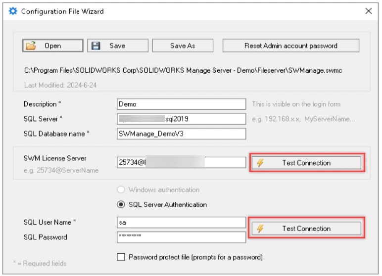

2. Creating Configuration File:
If the SQL Server name / Database Name / and SOLIDNetwork license manager Server name has changed, it is important to create a new configuration file (SWManage.SWMC). To create this configuration file, browse to the installed location for the SOLIDWORKS Manage Server > Navigate into the Server Utils folder > run the ‘Configuration File Wizard’ (swm.configwizard.exe). Use the 'Test Connection' feature to make sure that all information is correct.
After confirming that the settings are correct, use the 'Save' or ‘Save As' functions to save the new SWManage.SWMC file in the Fileserver folder. When you start SOLIDWORKS Manage client and expand the ‘Options’, you will be able to add or select the new SWManage.SWMC file or add multiple paths to different SWManage.SWMC files.

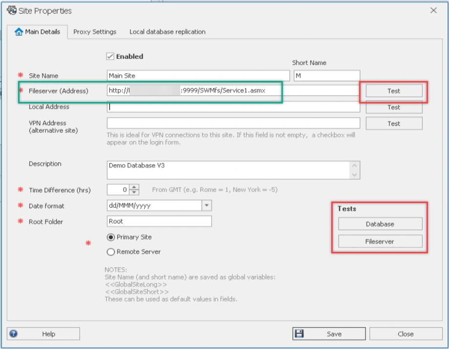

3. Update Site Settings:
Test the connection to the Fileserver as follows:
1. Run the SOLIDWORKS Manage client and log in as Admin.
2. Go to Options > Administration Options > Sites.
3. Edit the site by clicking on the pencil icon.
4. Test the connection by clicking the Fileserver button.
If you wish to create a new IIS application during a restoring phase of Manage refer to QA Article ID: QA00000299944
Abstract: Is there a tool to create new IIS applications during a restoring phase of a SOLIDWORKS® Manage Database?
Link: https://support.3ds.com/knowledge-base/?q=docid:QA00000299944
5. Specify the correct Address. For example: ‘http://MyServer9999/SWMfs/service1.asmx’. In many instances, the machine name is used instead of "localhost."
6. Perform the test again. Once the right string connection is set, you see the Success message.
