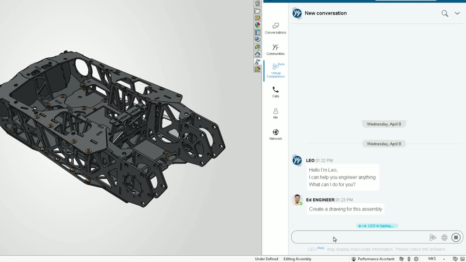

Manufacturing Documentation - Auto-Generate Drawings (Beta)
Take greater control over auto-generated drawings, such as customizing drawing tables, through text prompts.  A new button in the Auto‑Generate Drawing Property Manager provides direct access to the Drawing Creation skill, allowing you to customize your auto-generated drawing through natural text conversation.

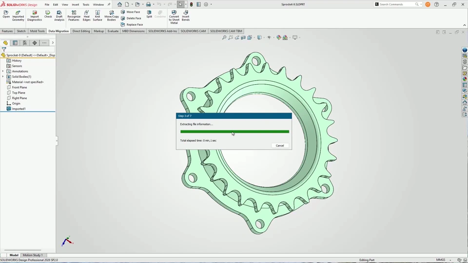

Intent to CAD - BREP to Parametric CAD (Beta)
Convert imported STEP and IGES models into fully editable, feature-based SOLIDWORKS components using AI — without rebuilding from scratch. Modify geometry, update features, and adapt the model to your requirements as if it were designed in SOLIDWORKS from the start.

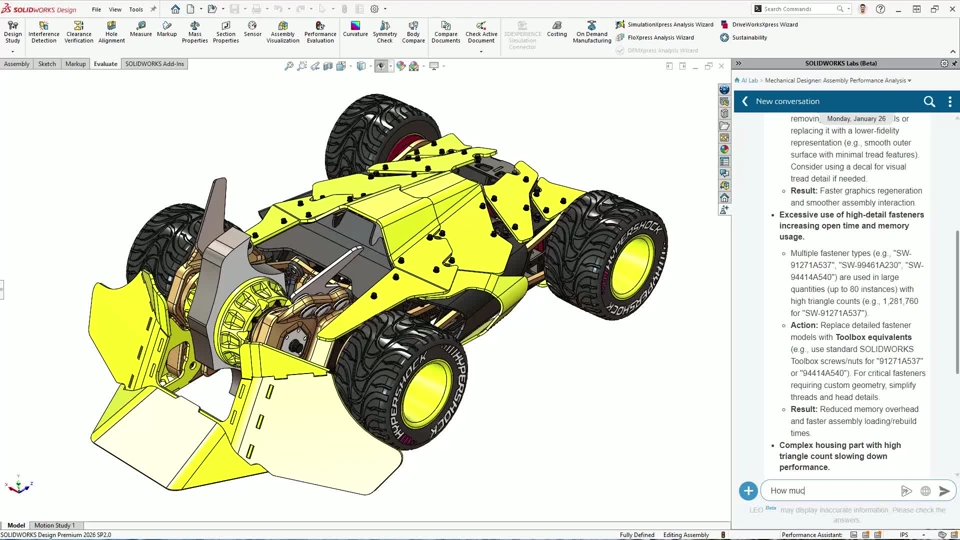

Assembly Optimization - Assembly Performance Evaluator (Beta)
Ask questions about your assembly and get AI-powered analysis that identifies specific performance issues and recommends targeted improvements — giving you actionable insights without manually diagnosing large, complex assembly structures.

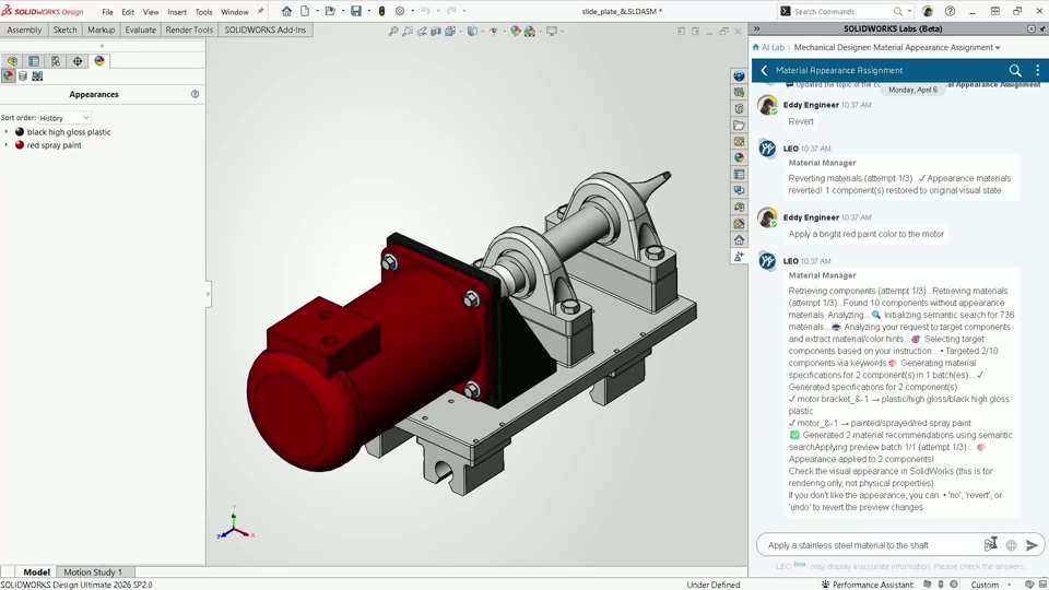

Engineering Guidance - Material Appearance Manager (Beta)
Reduce repetitive manual effort and save time when assigning and updating material appearances across assemblies. Simple prompts enable intelligent application and updates while maintaining visual consistency.

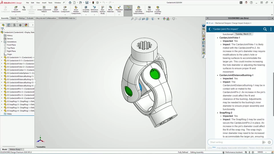

Design Validation - Design Change Impact (Beta)
Understand the full impact of a design change before you make it. AI-powered analysis identifies which parts, assemblies, and downstream dependencies are affected — and who is impacted — so teams can assess risk earlier, avoid unintended disruptions, and commit to changes with greater confidence.

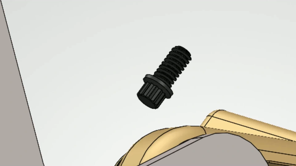

Performance Assistant - Fastener Simplification
Keep large assemblies running smoothly with automatic thread suppression suggestions from the in-context Performance Assistant. When you place fasteners with fully modeled 3D threads, the assistant prompts you to suppress them before they impact performance — with the option to ignore or disable the messages if you prefer to manage this manually.

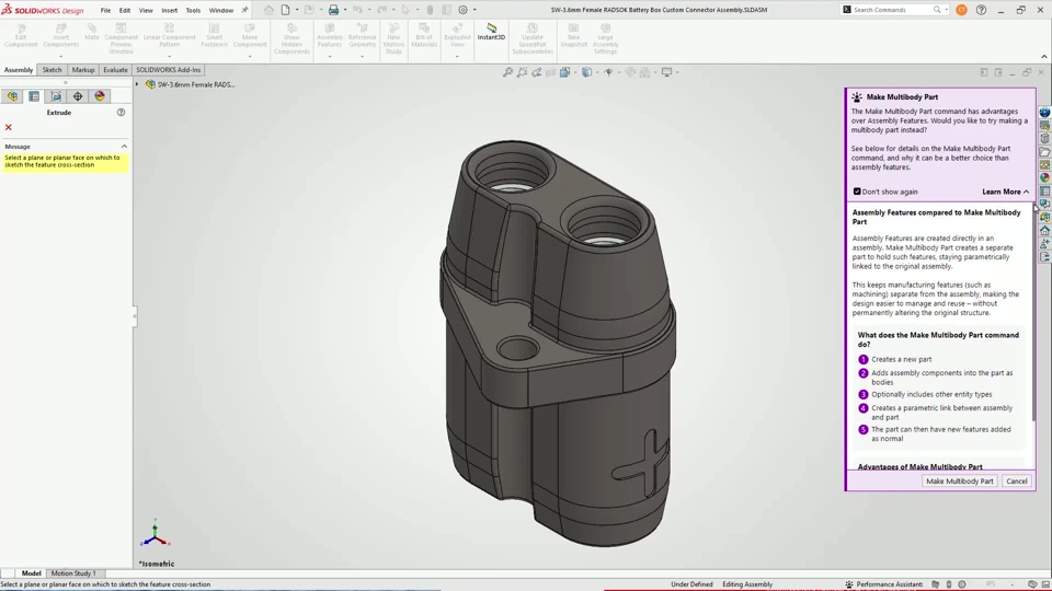

Make Multibody Part Assistant
Get in-context guidance when creating assembly features with the Make Multibody Part Assistant. Notifications appear directly in the graphics area suggesting a multibody part approach as an alternative. You have the option to launch the Make Multibody Part command immediately from the assistant, or ignore and disable the messages if you prefer to work without prompts.

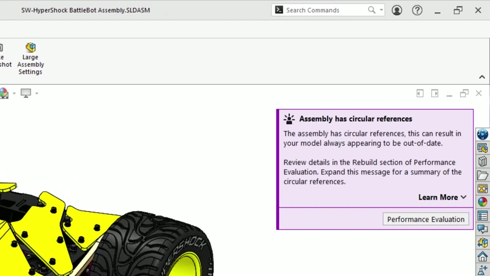

Performance Evaluation Assistant
Monitor assembly health at a glance with a persistent performance status bar in the bottom toolbar. The color-coded indicator continuously tracks assembly graphics performance, mate issues, and circular references — giving you an always-on signal to catch performance problems early before they slow down your workflow.

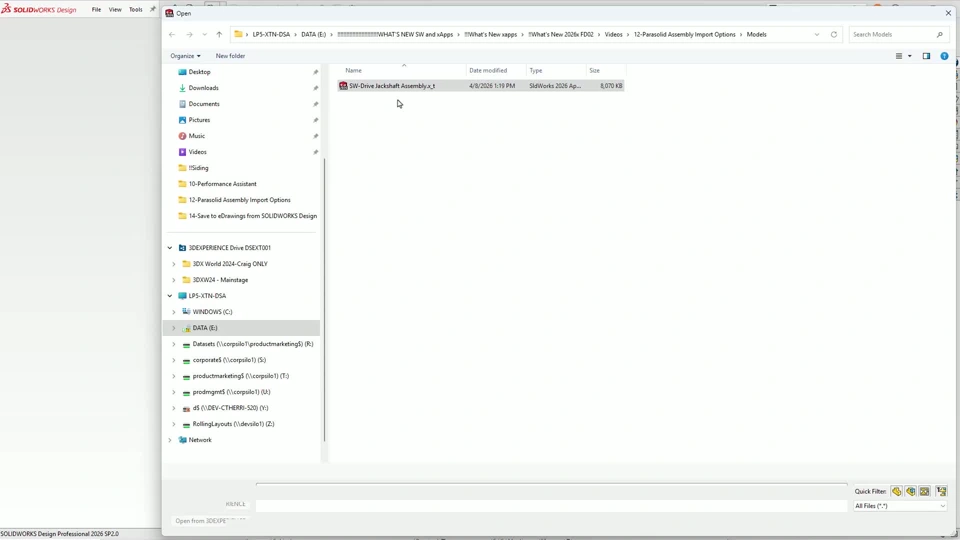

Parasolid Assembly Import Options
Apply part and assembly configuration templates automatically when importing Parasolid data, ensuring that you import all the configuration data within the imported Parasolid assembly.

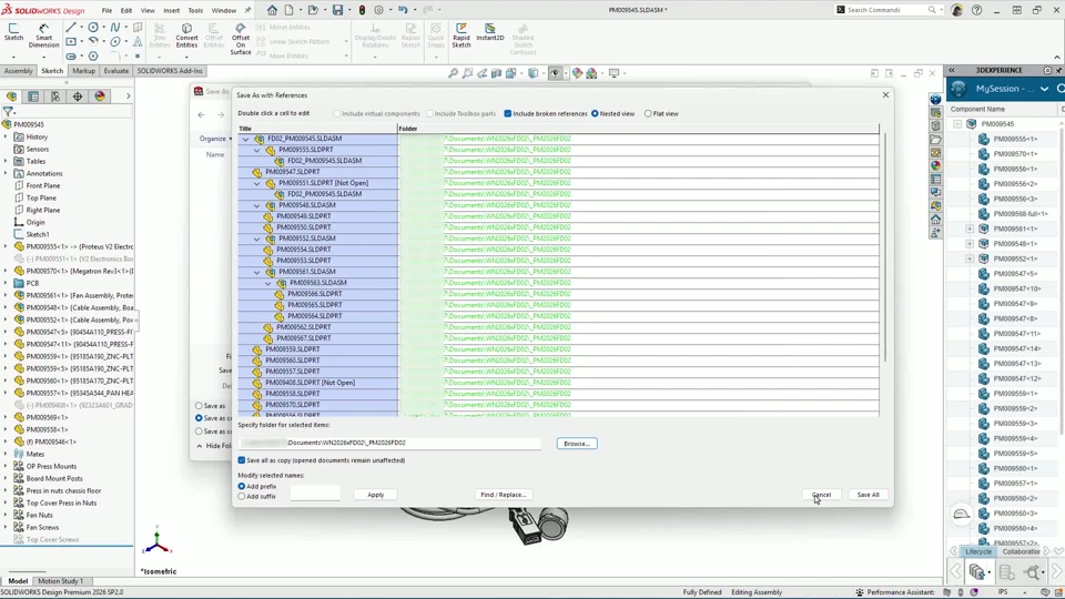

Updating Suppressed Components During Save As
Keep suppressed components correctly linked when saving assemblies with in-context references. External references for suppressed components now update correctly during Save As operations — eliminating broken references when components are later unsuppressed and reducing manual cleanup when reusing assemblies.

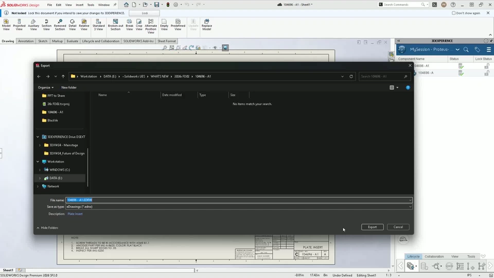

Save to eDrawing File Format from SOLIDWORKS Design
Export SOLIDWORKS documents directly to eDrawings file format from within SOLIDWORKS Design, or automate batch exports using Task Scheduler — making it faster to share lightweight, view-only files with colleagues and customers who don't have SOLIDWORKS installed.

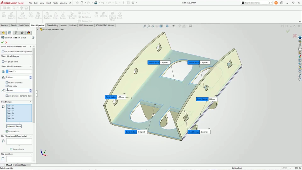

Edit Bend Radius for Imported Bend Faces
Modify the bend radius of any pre-existing bend face on an imported part during or after conversion to sheet metal — eliminating the need to rebuild bends from scratch when imported geometry doesn't match your manufacturing requirements.

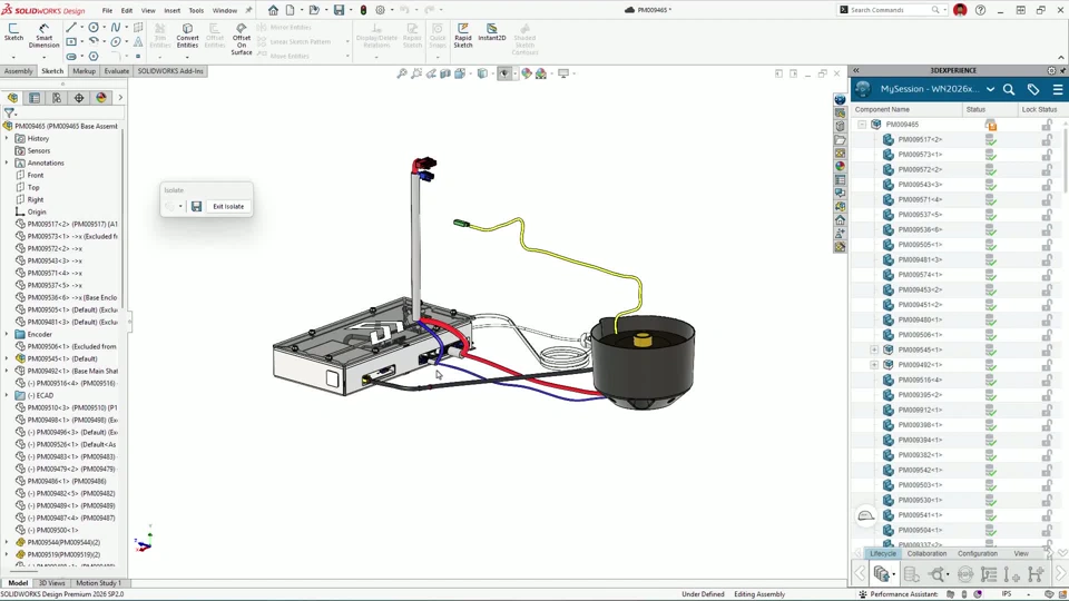

Progressive Isolate for Components and Bodies
Apply the Isolate command to an already-isolated assembly without exiting and restarting — progressively narrowing your focus to the exact components or bodies you need without interrupting your workflow.

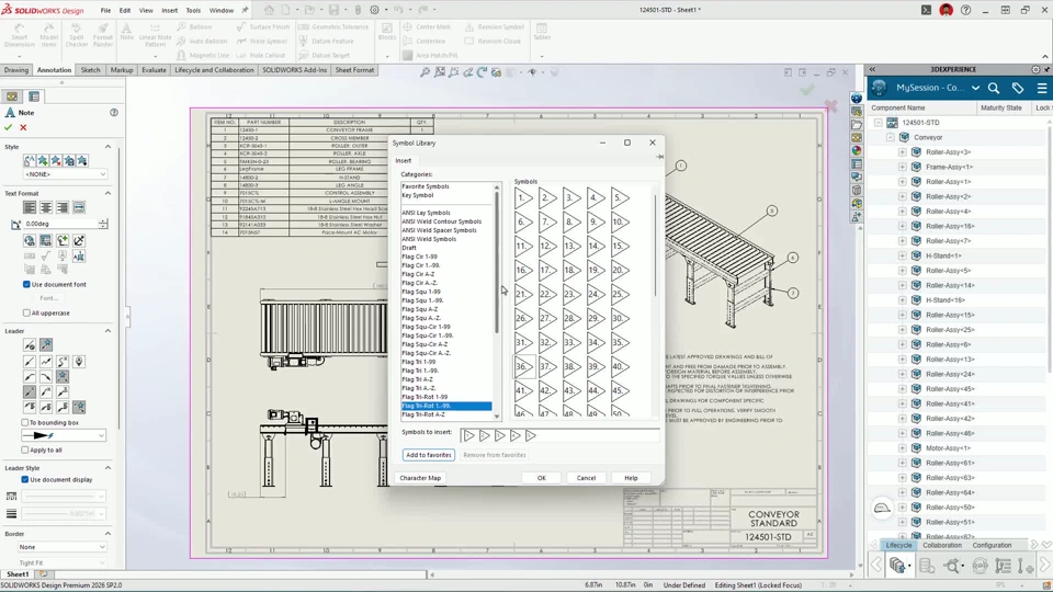

Favorite Symbols Folder for Dimensions and Annotations
Save your most-used dimension and annotation symbols to a dedicated Favorites folder for instant access — eliminating repeated searches through symbol libraries and speeding up drawing annotation workflows.

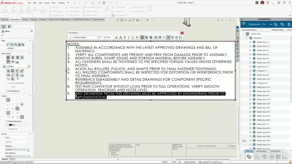

Highlight Color for Notes
Emphasize critical information in drawing notes by applying highlight colors from a selectable color palette — making important callouts and annotations stand out at a glance.

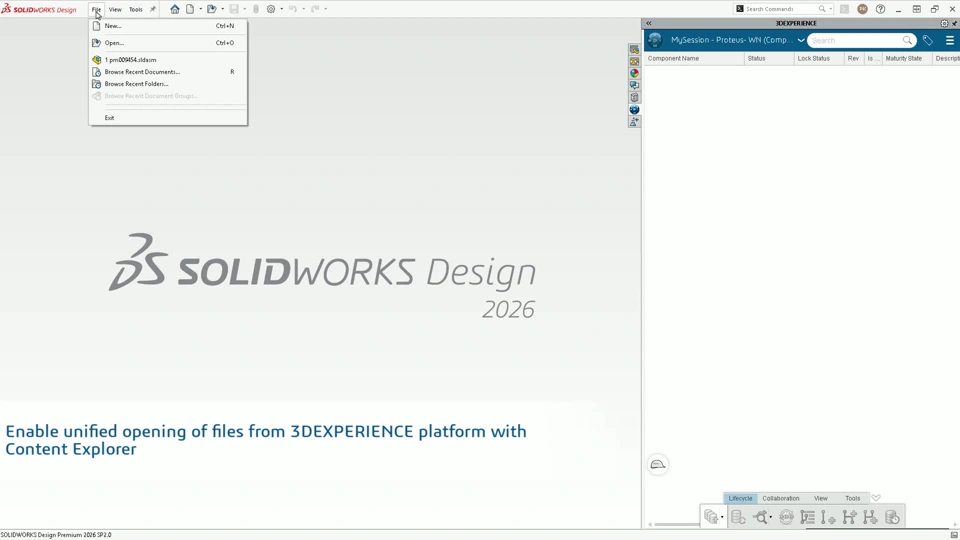

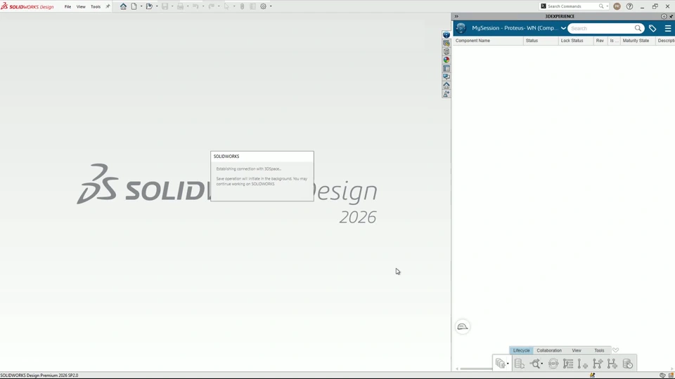

Content Explorer in the SOLIDWORKS Design Open Dialog
Browse, organize, and open platform files without leaving SOLIDWORKS. Content Explorer is now integrated directly into the Open dialog, giving you access to your bookmark folders and collaborative space content in a unified experience — with the same organizational flexibility available in the standalone Content Explorer app.

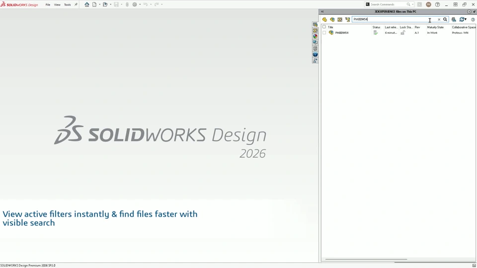

Search Box Behavior for 3DEXPERIENCE Files on This PC
See active search filters at a glance and clear them instantly with a new X icon — returning to the full file list in one click without having to manually reset search criteria.

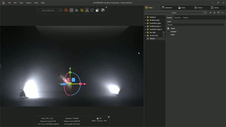

Volume Rendering in SOLIDWORKS Visualize
Create more realistic and cinematic renderings with the ability to add volumes to your scenes. Volumetrics add depth to your renderings with fog, smoke, and realistic lighting including god rays and misty environments — creating more immersive, photorealistic and reducing post-processing workflows.

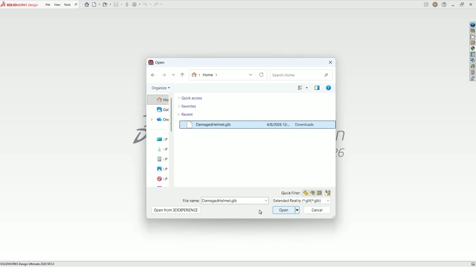

DSPBR Appearance Support in GLB & GLTF Import and Export
Maintain visual consistency between SOLIDWORKS Design and GLB/GLTF viewers with DSPBR appearance support in both import and export. As GLB and GLTF become the preferred formats for web and real-time applications, SOLIDWORKS Design now preserves high-fidelity appearances for your products — ensuring what you see in SOLIDWORKS matches what appears in downstream applications.
