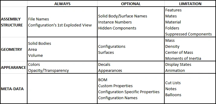

The following table outlines the data in SOLIDWORKS part and assembly files that is possible to translate to SOLIDWORKS Composer. Note that it is not possible to translate SOLIDWORKS drawing files.
In addition to the data limitations, there are also software limitations. When choosing to translate metadata, you must deactivate the following SOLIDWORKS System Options2:

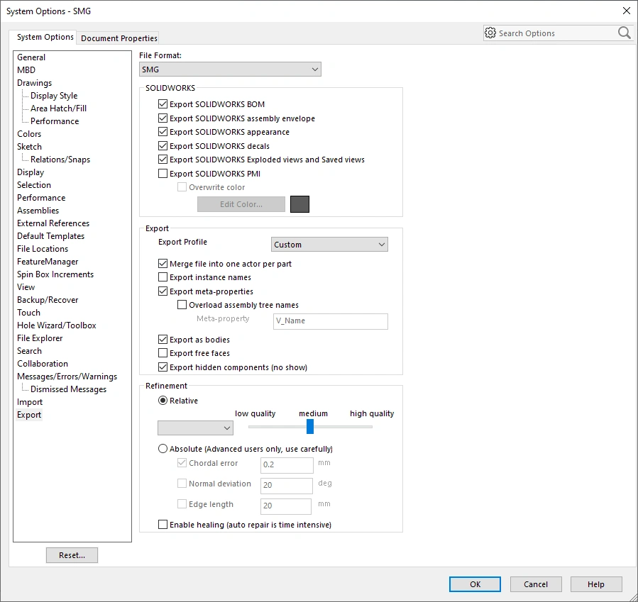

a) Export from SOLIDWORKS
You can export SOLIDWORKS part and assembly files to the *.smg file format by using the SOLIDWORKS Composer add-in. This method involves collaboration between a SOLIDWORKS user and a SOLIDWORKS Composer user. The intent is for a SOLIDWORKS user who does not have access to SOLIDWORKS Composer to create *.smg files. The SOLIDWORKS user then provides the *.smg files to the SOLIDWORKS Composer user.
Effective with the release of SOLIDWORKS 2018, users have control over what SOLIDWORKS Composer options are used to create the *.smg files. It is also possible to modify these SOLIDWORKS Composer default import options manually.
The following image shows the SOLIDWORKS Export options for SOLIDWORKS Composer (*.SMG) files.

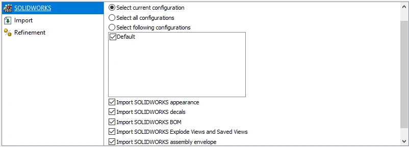

i) SOLIDWORKS Options
This option is available only upon selection of a SOLIDWORKS file. It specifies which configuration to convert. If you select the Import meta-properties import option, the name of the selected configuration is added as a meta-property. It also gives you option to import SOLIDWORKS BOM and assembly envelope.
Import SOLIDWORKS BOM
Enable this option to import a Bill of Materials (BOM) that exists in a SOLIDWORKS part or assembly. If you disable the Import SOLIDWORKS BOM option, then the resulting SMG file will not include a BOM. Instead, you have the choice to create a new BOM by using the BOM Workshop in SOLIDWORKS Composer.
The following image shows a SOLIDWORKS assembly with BOM imported with Import SOLIDWORKS BOM enabled.
Import the SOLIDWORKS assembly envelope
Enable this option to import envelopes that are contained in SOLIDWORKS assembly. Previously, SOLIDWORKS Composer always imported assembly envelopes.
The following image shows a SOLIDWORKS assembly with the Import SOLIDWORKS assembly envelope option enabled, and then not enabled.

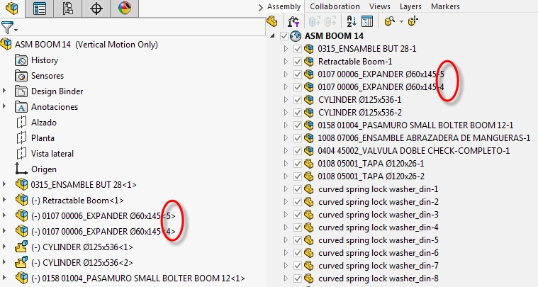

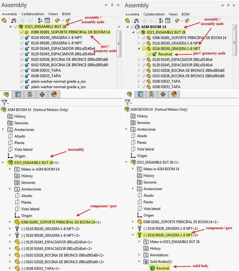

Merge the file into one actor per part
The following image shows the same assembly (ASM BOOM 14) imported with the Merge file into one actor per part option (left), and without the option (right).
With the option, the structure of the SOLIDWORKS Composer assembly tree is easier to navigate. You can click on a part or geometry node to see the properties. The part or geomerty node name also matches the SOLIDWORKS component name.
Without the option, the structure of the SOLIDWORKS Composer assembly tree is more complicated to navigate. The icons can be confusing; the “part” icon is an assembly node. You must therefore turn on Assembly Selection Mode to select the node, see the component properties, create a BOM ID, etc. The “cube” icon indicates a part or geometry node. The node name matches the name of the SOLIDWORKS component’s solid body.
You should not use this option if your part files contain multiple solid or surface bodies (such as weldments and sheet metal) and if your SOLIDWORKS Composer usage requires you to change, move, or identify those bodies individually.
Import as bodies
This option is redundant with the Merge file into one actor per part option. If you disable this option but have the Merge file into one actor per part option enabled, the assembly tree will be the same as an import in which both options are enabled.
If the Merge file into one actor per part and Import as bodies options are both disabled, each face of a component will be imported as a part or geometry node nested under the component’s assembly node. This is the same effect as importing with the Merge file into one actor per part option disabled, the Import as bodies option enabled, and then exploding a geometry node.

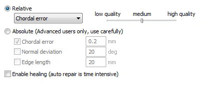

iii) Refinement Settings
By default, SOLIDWORKS Composer generates its own tessellation for imported SOLIDWORKS data. This tessellation is determined by the refinement settings chosen in the Open dialog box. By default, the Relative > Chordal error option is set with a medium quality. As with all default settings, this typically satisfies the users need.
If you require higher quality tessellation (which is often the case when using Silhouette render mode or when creating Technical Illustrations in SOLIDWORKS Composer), it is possible to adjust the refinement settings. In these cases, a user should import their SOLIDWORKS data several times, using different combinations of refinement settings, and then compare the results to pick the settings that meet their needs.
In general, the Chordal error option is most appropriate for use with datasets where components do not differ drastically in size, whereas normal deviation works best with datasets where components do differ drastically in size. In cases where a dataset consists of both large and small scale geometry, choosing the Chordal error option will result in the large scale geometry having much better quality than the small scale geometry, and vice versa for normal deviation. The Absolute refinement option can be chosen to use both tessellation techniques as a compromise. Note however that if choosing the Absolute refinement the Edge length setting is not applicable for SOLIDWORKS data.

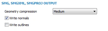

iv) Geometry Compression
Similar to the default refinement settings being satisfactory for most needs, the SOLIDWORKS Composer default Geometry compression setting of ‘Medium, is satisfactory for most needs as well. The Geometry compression option exists in File > Properties > Default Document Properties > Output. For this setting to apply to the tessellation, you must assign the setting before import. Also, the geometry compression choice affects the file size of *.smg and *.smgGeom files. For example, choosing the High (low quality) option will result in a smaller file size than choosing the Low (high quality) option.
In addition to adjusting refinement settings to create higher quality tessellation, you can also set the geometry compression to Low (high quality) to create higher quality.

  • Do not apply kinematics (parent/child relationships) to geometry actors. Doing this violates the rules as shown in the following image.
  • If updating from a SOLIDWORKS file, do not create meta-properties in the SOLIDWORKS Composer document. Meta-properties that you create manually will be removed after update because they do not exist in the updating SOLIDWORKS file.
    If updating from a SOLIDWORKS Composer document, manually created meta-properties will not be removed. However, these properties will also not be updated if both SOLIDWORKS Composer documents contain the same manually created meta-properties.

After making a configuration in the SOLIDWORKS file and saving the file, you can import the exploded views into SOLIDWORKS Composer using the following steps:
1. Click File > Open.
2. In the Open dialog box, browse to and select the SOLIDWORKS file to import, but do not click Open.
3. In the left pane of the import options, click SOLIDWORKS.
4. Ensure that the Import SOLIDWORKS Explode Views and Saved Views option is active.
5. Click Open.
In the Views pane, the Views tab displays the saved and named views and the steps of the exploded views.
7) Importing Appearances from SOLIDWORKS Files
SOLIDWORKS Composer 2020 also introduced the Import SOLIDWORKS appearance option. Previously, SOLIDWORKS Composer imported all appearances silently, whether you wanted them or not.
After applying an appearance in the SOLIDWORKS file and saving the file, you can import the appearance into SOLIDWORKS Composer using the following steps:
4. Ensure that the Import SOLIDWORKS appearance option is active (the default), and click Open.
