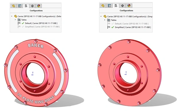

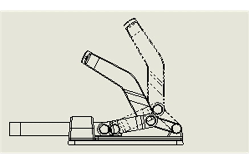

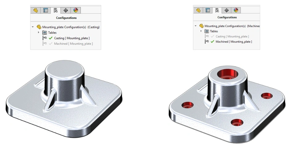

SOLIDWORKS configurations allow a user to represent different variations of a part or assembly within the same file. Common use cases for SOLIDWORKS configurations include capturing a size range of a part or assembly, different component positions within an assembly, and different levels of geometric detail, plus many more.
SOLIDWORKS drawings do not have configurations, but drawing views can be set to display a specific configuration of the file they reference.

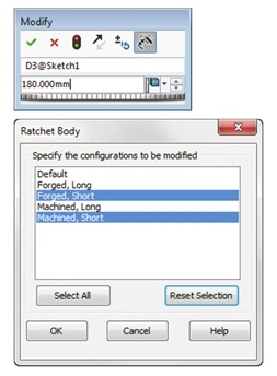

One of the key advantages of using SOLIDWORKS configurations is that all the different variations associated with a specific part or assembly are contained within the part and assembly file. The ability to apply design changes to specific configurations makes it easier to manage SOLIDWORKS files using the Microsoft® Windows file system because only one part or assembly file is created.
For example, when a user modifies a part or assembly that contains configurations, they can apply the change to all or individual configurations within the file.

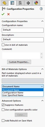

Configurations are created and managed using the ConfigurationManager, which is located within the same window as the FeatureManager design tree. The ConfigurationManager is available in every part and assembly.
You can create manual or fully automated configurations using a Configuration Table or a Microsoft® Excel spreadsheet-driven Design Table.
To differentiate configurations from one another, each can have its own unique name, unique SOLIDWORKS property values, and specific part number display in a SOLIDWORKS Bill of Materials (document name, configuration name, or user defined). When saving SOLIDWORKS parts and assemblies to the 3DEXPERIENCE platform, the Bill of Materials property may affect the amount of design information that becomes available to other users.

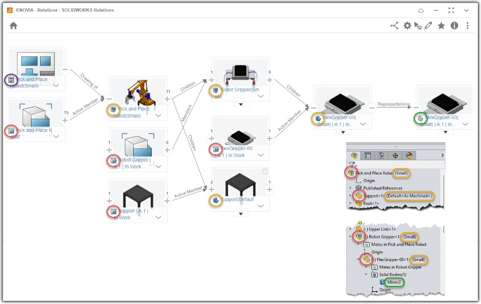

You can use the Relations app to visualize and better understand these objects and the object hierarchy.
In this example, an assembly and a drawing that references the assembly has been saved to the 3DEXPERIENCE platform, and the corresponding database objects and hierarchy is automatically created.

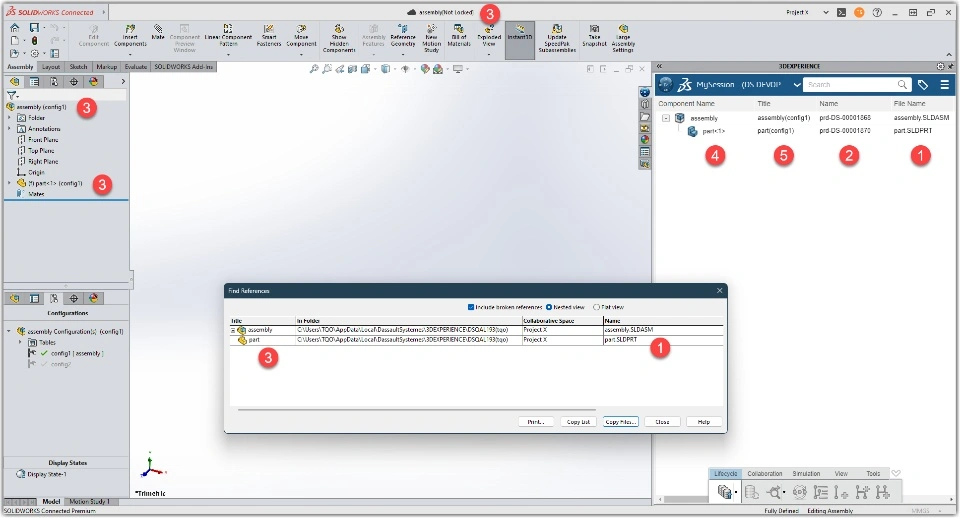

b) SOLIDWORKS & 3DEXPERIENCE Platform Identifiers
Once you understand the SOLIDWORKS Data Model for the 3DEXPERIENCE platform, you can better understand the identifiers that are used within SOLIDWORKS. Understanding the identifiers is another essential part of using and accessing CAD data within the 3DEXPERIENCE platform.
See detailed descriptions of each identifier below
  1. File name is the unique identifier for Windows. It is the name of the file on disk and includes a file extension. After you save a SOLIDWORKS file to the 3DEXPERIENCE platform, you cannot change the File name.
  2. Name is the unique identifier for the 3DEXPERIENCE platform. It is the name of the object in your collaborative space. You cannot change the Name.
  3. File Title is the common identifier for Windows and the 3DEXPERIENCE platform. It is a 3DEXPERIENCE platform attribute that appears in the FeatureManager design tree, title bar, and other areas of the user interface. You can change the File Title at any time. Changes to the File Title propagate to CAD Family, Physical Product, 3D Shape, and Drawing object Titles.
  4. Component Name is a unique identifier for SOLIDWORKS. It is a 3DEXPERIENCE platform attribute that appears in the MySession app. It matches the File Title that appears in the FeatureManager design tree, including instance numbers when used in assemblies. You change the File Title to change the Component Name.
  5. Title, also called Physical Product Title in some contexts, is an identifier for the 3DEXPERIENCE platform. It is a 3DEXPERIENCE platform attribute that appears in the MySession app and dashboard apps like Properties and Bookmark Editor. You can change the Title at any time.
By default, the Title for parts and assemblies with one configuration is the same as the File Title. The Title for parts and assemblies with multiple configurations is a concatenation of the File Title and configuration name, with the configuration name enclosed in parentheses. For drawings, the Title matches either:
  • The File Title of the part or assembly that the drawing references.
  • Its own specified File Title.

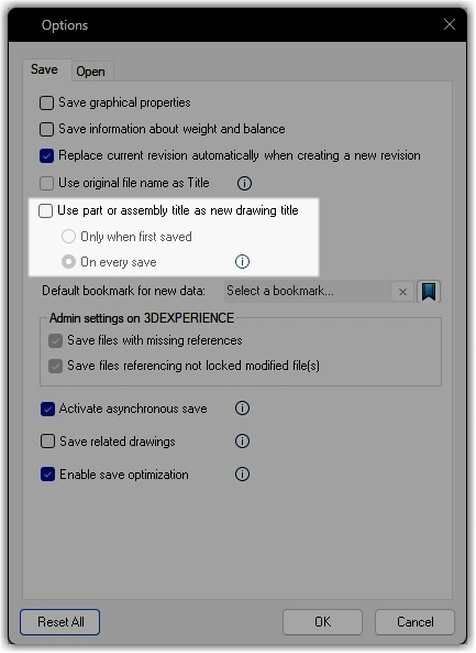

The MySession option highlighted in the following image determines the Title behavior for drawings.

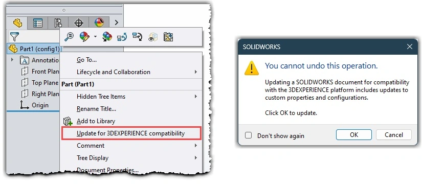

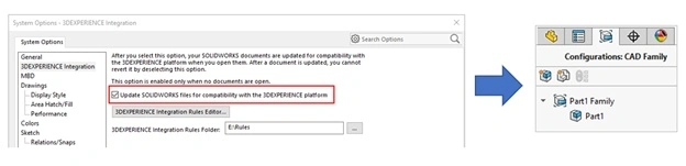

    Create or open a part or assembly file and select the Update for 3DEXPERIENCE compatibility command from the FeatureManager Design Tree context menu.
    ii) Automatic Update

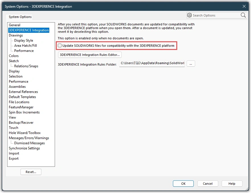

    Activate theUpdate SOLIDWORKS files for compatibility with the 3DEXPERIENCE platformsystem option and create or open a part or assembly file.

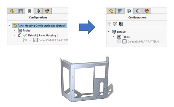

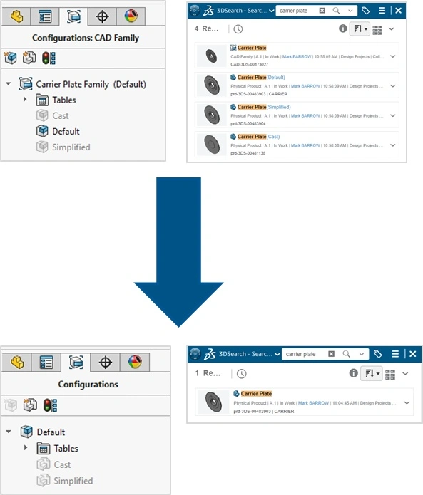

    After you update a part or assembly file for compatibility, three things happen:

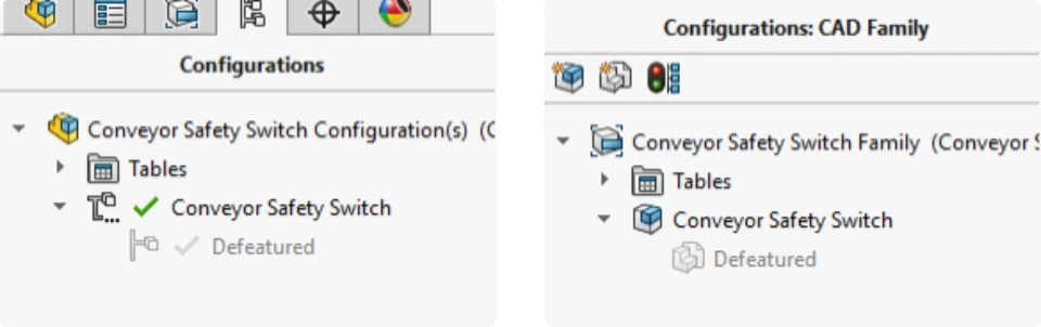

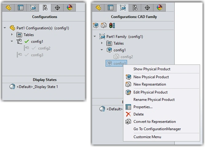

    i) New configuration view becomes available in the FeatureManager Design Tree
    The CAD Family View uses 3DEXPERIENCE platform terminology and concepts. It displays the CAD Family object, Physical Product configurations, and Representation configurations. With CAD Family View, you can create Physical Product configurations or Representation configurations, convert from one mode to the other, and then back again if you wish.

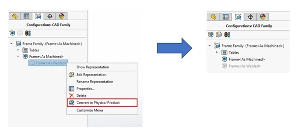

    ii) Configurations display as Physical Product configurations or Representation configurations
Like traditional configurations, Physical Product configurations represent your manufactured designs. They have a single engineering definition, including maturity state, Enterprise Item Number (EIN), and relevant properties or attributes.
Like traditional derived configurations, and as the name suggests, Representation configurations represent your Physical Product configurations in a different way, to aid in the design. These include sheet metal flat-pattern configurations, weldment "As Welded" configurations, SpeedPak configurations, and any other use cases where positional or alternate views of the Physical Product configuration are needed.

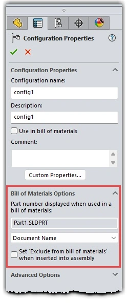

The Part number displayed when used in a bill of materials property, for each configuration, determines whether a configuration is updated to a Physical Product configuration or a Representation configuration.
iii) Custom properties are removed
If custom properties exist, then they are merged into configuration properties.
Before updating for 3DEXPERIENCE compatibility
After updating for 3DEXPERIENCE compatibility

The name and Part number displayed when used in a bill of materials property, for each configuration, determines whether a configuration is updated to a Physical Product configuration or a Representation configuration. The following logic, which applies to parts and assemblies, satisfies the majority of use cases.

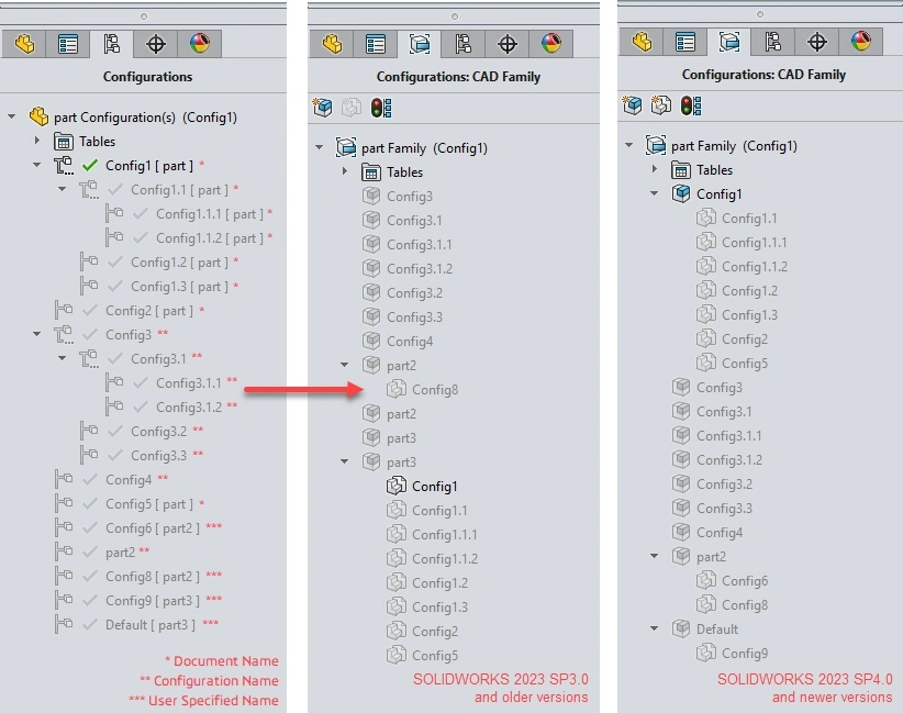

i) 3DEXPERIENCE SOLIDWORKS / Collaborative Designer for SOLIDWORKS and SOLIDWORKS 2023 SP4.0 and newer versions
  • If there is a configuration named Default, it takes precedence to update as a Physical Product configuration.
  • Configuration Name updates as a Physical Product configuration.
  • Derived configurations with this property update as Physical Product configurations.
  • Document Name updates to a Physical Product configuration.
    • If there are multiple configurations with this property and one is named Default, then all others update as Representation configurations of Default
    • If there are multiple configurations with this property and none are named Default, then the first history-based configuration updates as a Physical Product configuration, and all others update as Representation configurations of the first.
    • Derived configurations with this property update as Representation configurations.
  • User Specified Name updates as a Physical Product configuration.
  • If a User Specified Name matches a Configuration Name, then it updates as a Representation configuration of the matching Physical Product configuration.
  • Link to Parent Configuration updates as a Representation configuration.
    ii) Collaborative Designer for SOLIDWORKS + SOLIDWORKS 2023 SP3.0 and older versions
    • Document Name updates as a Representation configuration and the system automatically creates a parent Physical Product configuration with a name that equals the Windows file name.

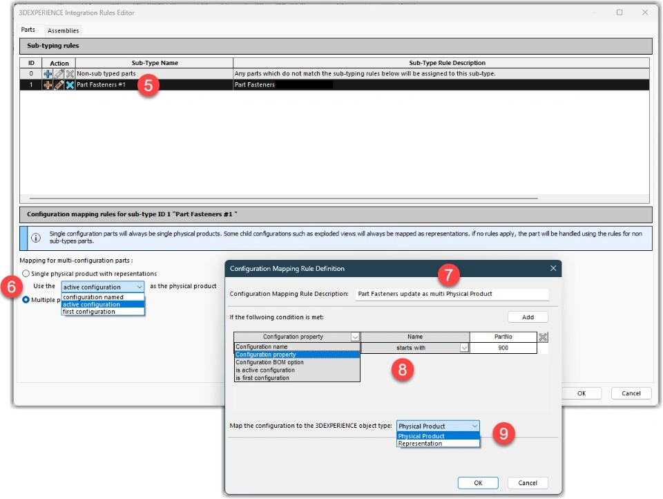

    b) User-Defined Update Logic | 3DEXPERIENCE Integration Rules Editor
    If system-coded update logic does not give you the results that you expected, then you can create user-defined update logic using the 3DEXPERIENCE Integration Rules Editor.
    NOTE: This utility is only available in 3DEXPERIENCE SOLIDWORKS and Collaborative Designer for SOLIDWORKS + SOLIDWORKS 2024 SP0.1 and newer versions.
The 3DEXPERIENCE Integration Rules Editor cannot be launched separately. It must be launched from within the 3DEXPERIENCE Integration page of the SOLIDWORKS system options.
Unlike the system-defined update logic, which applies to parts and assemblies, the 3DEXPERIENCE Integration Rules Editor allows you to define different update logic for both file types, if needed. Defining update logic requires two sets of rules:
  • Sub-typing rules: These rules categorize your part and assembly files.
  • Configuration mapping rules: These rules determine if a part or assembly sub-type will update as a single Physical Product configuration with Representation configurations, or multiple Physical Product configurations.
    Combined, the rules determine how parts and assemblies are updated for 3DEXPERIENCE compatibility. For example:

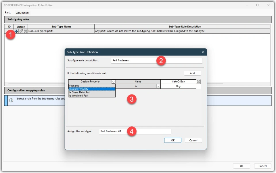

    1. In the Sub-typing rules pane on the Parts tab, click the button.
    2. In the Sub-Type Rule Definition dialog, enter a description for the rule.
    3. Define a condition that identifies the parts based on any combination of: filename, custom property, is sheet metal part, or is weldment part. In this example, a custom property named MakeOrBuy that equals Buy is defined.
    4. Give the sub-typing rule a name, then click OK to save.
    5. Select a sub-type rule.
    6. Choose a configuration mapping. In this example, Multiple physical product.
    7. In the Configuration Mapping Rule Definition dialog, enter a description for the rule.
    8. Define a condition that identifies the parts based on any combination of: configuration name, configuration property, configuration BOM option, active configuration, or first configuration. In this example, a configuration property named PartNo that starts with the number 900.
  • 9. Choose a configuration mapping object type. In this example, Physical Product
    10. Click OK to save the rules.
As stated, files that do not match the sub-typing or configuration mapping rules update with the system-coded logic.
NOTE: Your rules are saved to an XML file. By default, the XML file is saved to [%appdata%\\SolidWorks\\SOLIDWORKS 20XX\\3DXIntegrationSubTypeRules]. If you want to share the rules to other users, you can either send them the XML file or you change the file location to shared network location that all users have access to. If you understand the structure of the XML file, then you can edit it in any XML editor or text editor.
Continue creating sub-typing rules and configuration mapping rules that you need. With both sets of rules defined, when you update files for 3DEXPERIENCE compatibility, whether you do so manually or automatically, files that meet the conditions will update per your user-defined rules.

Parts and assemblies designed and developed in-house, and for production, should only have one SOLIDWORKS configuration update as a Physical Product. This nominated SOLIDWORKS configuration should be configured to contain any key SOLIDWORKS properties related to engineering and manufacture.
The resulting Physical Product, in the 3DEXPERIENCE platform, will represent a single engineering definition for that part or assembly including the maturity state, Enterprise Item Number, plus any Physical Product specific attributes.
When additional configurations are required to aid design in SOLIDWORKS, create them as Representation configurations so that additional Physical Products are not created.
For more information, refer to the Part Configuration Use Cases and Assembly Configuration Use Cases sections of this guide.
To manage the two different configuration types, enable the following SOLIDWORKS option for all users: Update SOLIDWORKS files for compatibility with the 3DEXPERIENCE platform.
Maintaining one Physical Product configuration per SOLIDWORKS file reduces unnecessary complexity for all SOLIDWORKS and 3DEXPERIENCE users within an organization.
If your company uses SOLIDWORKS 2024, use the Remove CAD Family option so that only one Physical Product configuration can exist per file. With this option set, additional SOLIDWORKS configurations will be automatically created as Representation configurations.
NOTE: It is recommended that SOLIDWORKS part and assembly templates are updated with the CAD Family removed to make this the default behavior for every new part and assembly file.
For companies using SOLIDWORKS 2023 or earlier, users must manually choose which SOLIDWORKS configuration to nominate as the Physical Product configuration. It is not possible for the platform administrator to configure their 3DEXPERIENCE platform to make this the default behavior. Therefore, it is important that users are well trained and have a complete understanding of the recommended strategies from this section of the guide.

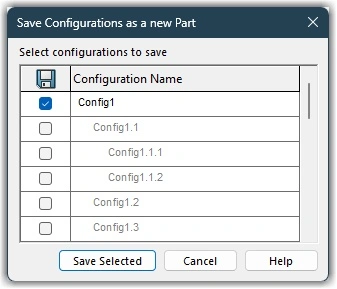

ii) Saving Pre-existing SOLIDWORKS Designs to the 3DEXPERIENCE Platform
If you are an existing SOLIDWORKS customer adopting the 3DEXPERIENCE platform, it is important to understand how configurations have been used in their parts and assemblies before any files are saved. Due to the versatility of configurations, it is common practice for design teams to treat configurations as individual part numbers. In that scenario, take time to carefully analyze the files and factored in to any migration project. (See the Working with Existing SOLIDWORKS Files page for details.)
If you decide to maintain any part or assembly configurations as individually life-cycled engineering items, then those configurations must be split or saved into individual part and assembly files, with each file containing only one Physical Product configuration.
NOTE: Saving configurations to individual files is a manual process that can be automated using a SOLIDWORKS macro.

Externally purchased parts and assemblies are typically managed in a library and are not modified or revised by the engineers who utilize them in their designs. When deciding which SOLIDWORKS configuration strategy to adopt for purchased parts, consider the following:
  • Part files with configurations that represent different size variations
    • If there are 20 or less configurations per part file, Physical Product configurations can be used without negatively affecting performance.
    • If there are more than 20 configurations per part file, the one Physical Product configuration per file strategy should be used to maximize performance. Each configuration needs to be saved to an individual part file.
      • In this scenario, Representation configurations must not be used to represent different size variations. Representation configurations are not saved to the 3DEXPERIENCE platform. Therefore, the size variation of the part will not be displayed in any of the 3DEXPERIENCE platform viewer apps.
  • Assembly files with configurations
    • For all assembly files, the one Physical Product configuration per file strategy should be to maximize performance. Each configuration needs to be saved to an individual assembly file.

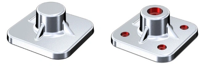

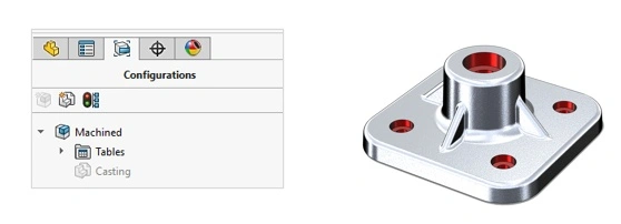

    i) Managing Cast and Machined Variations
    SOLIDWORKS configurations provide a simple and efficient method of capturing the cast and machined variations of a part.
    When working with the 3DEXPERIENCE platform, the required strategy will depend on the lifecycle requirements of each variation.
    If the requirement is to treat both as one part number, then it's recommended that both the cast and machined variations are created as configurations in the same part file. This part file should contain only one Physical Product configuration. Any other variations of the part that are required to represent different machined states should be created as Representation configurations. During the first save to the 3DEXPERIENCE platform, the Physical Product configuration will generate the Physical Product that is used to represent the overall design including its lifecycle information. For example, maturity state, revision, and key attributes. Typically, the finished machined version of the part is nominated to be the Physical Product configuration.
    In a scenario where the requirement is to treat cast and machined versions of a design as separate part numbers, and revision-control them independently, a derived part modeling methodology should be used. Using the derived part methodology, the part file for the cast version is represented by its own Physical Product, and any machined variations of the design are created by inserting the cast part file into them as the first feature. Each of the “machined” part files are then saved to the 3DEXPERIENCE platform and represented by their own individual Physical Products which are revision controlled, independently. For information on how to work with derived parts in SOLIDWORKS, refer to the Derived Part  section of the online help.

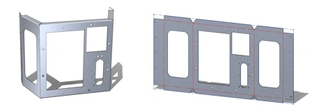

    ii) Sheet Metal - Flat and Folded States
    When designing Sheet Metal parts in SOLIDWORKS, configurations are used to represent the folded and flattened states. The flattened state configuration represents the manufacturing definition of the finished part. For most companies both configurations will represent the same part and part number, therefore the one Physical Product configuration per file strategy should be applied. It is recommended that the folded configuration of part is defined as the Physical Product configuration, and the flattened configuration is defined as a Representation configuration.
    Taking this approach, the fully detailed folded version will always be shown when viewing the part using any of the 3DEXPERIENCE platform viewer apps. The flattened configuration is only used in SOLIDWORKS, by the designer, to create the necessary outputs for manufacture. For example, drawings and DXF files.
    In the scenario where multiple variations of the same sheet metal part need to be revision managed independently, with unique lifecycles, individual flat patterns, and part numbers, separate part files should be used to represent each variation. Each individual part file should contain one Physical Product configuration to represent the fully detailed part and a Representation configuration that represents the flattened state.

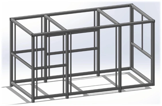

iii) Weldments - Welded and Machined States
NOTE: Before using SOLIDWORKS weldments functionality with the 3DEXPERIENCE platform, it's recommended that users are familiar with the Weldments training course material.
A weldment is an object made up of several parts welded together. In SOLIDWORKS, a weldment refers to a special type of part model containing multiple bodies which can be described with a cut list. Often times these bodies are welded together in production, such as structural members welded together to form a frame.
Even though a weldment model could technically be described as an assembly, working within a multibody part allows for easy manipulation of multiple pieces and minimizes complex file relationships. Specialized weldment commands also automate common functions of working with structural members and frames.
Although primarily targeted for working with structural steel and aluminum, SOLIDWORKS weldments are also commonly used for modelling wood working projects and plastic extrusions.

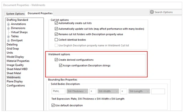

The default behavior when adding a weldment feature to a part model includes the creation of a derived configuration and configuration as follows
The description is added to the active configuration.
A derived configuration with the same name is added with the description .
Additionally, any new top-level configurations created will automatically have a corresponding derived configuration.
These configurations provide a means for representing the weldment as it will initially be welded and as it will be following post assembly machining operations.
In the Weldments page of Document Properties, settings can be adjusted to modify how these configurations are created.
With the Create derived configurations setting activated, any subsequent top-level configurations will automatically have a corresponding "As Welded" derived configuration. Deactivating this setting will prevent the creation of additional configurations in the part.
To set up your own standard for how weldment configurations are created, consider modifying these settings and save them to a part template.

In the scenario where there is a business requirement to manage both the "As Welded" and "As Machined" configurations as independent items, with unique attributes and Enterprise Item Numbers, then both configurations must be created as Physical Product configurations. In this scenario, the "As Welded" configuration needs to be converted from a Representation configuration to a Physical Product configuration.
Both the "As Welded" and "As Machined" configurations will now be represented in the 3DEXPERIENCE platform by unique Physical Products.

The SOLIDWORKS Toolbox Library offers three different user settings for the creation of component sizes:
  1. Create Configurations
  2. Create Parts
  3. Create Parts on Ctrl-Drag
The Toolbox integration with the 3DEXPERIENCE platform only supports the Create Parts setting. This setting creates individual part files for each size. The Toolbox integration does not support managing Toolbox sizes as SOLIDWORKS configurations.
  • Collaborative Designer for SOLIDWORKS
To enforce the correct behavior, the system automatically activates the Create Parts setting when you install the Design with SOLIDWORKS app and activate the 3DEXPERIENCE add-in.
To avoid any unexpected complications, do not disable the 3DEXPERIENCE add-in or change the Files setting in Toolbox Settings.

v) Part Geometry Simplification
There are many scenarios in which a fully featured part model is not required and may even have a negative impact on performance. For examples, large assembly designs and SOLIDWORKS Simulation studies. In these scenarios, configurations are the recommended method of controlling the level of detail in a part model. Configurations representing a de-featured version of a part are typically used to aid design in SOLIDWORKS and will not be related in any way to the final manufactured version.
  • It is recommended that any configurations created to represent de-featured or simplified variations of a part are created as Representation configurations, and that the configuration representing the fully-detailed model is nominated to be the Physical Product configuration.
    The part file will be represented in the 3DEXPERIENCE platform as one Physical Product that contains all of the information related to the design and its lifecycle (attributes, Enterprise Item Number, revision, maturity state). Maintaining one Physical Product configuration per part file reduces unnecessary complexity, as opposed to having multiple Physical Products represent one part.
    Another benefit of adopting this methodology are scenarios where parts are simplified to aid in large assembly design and visualization in SOLIDWORKS. SOLIDWORKS users get optimized performance when using simplified representations, and anyone viewing a complete assembly outside of SOLIDWORKS, in a 3DEXPERIENCE platform viewer app, will see the fully detailed models.

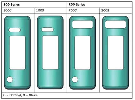

    i) Assembly Size Ranges
    SOLIDWORKS configurations are a powerful feature that allow you to create variations of a design within a single file. When working with assembly size ranges, configurations can be particularly useful. The common uses cases include, but are not limited to, creating:
    1. Product families
    2. Parametric design
    Maintaining one Physical Product configuration per SOLIDWORKS file reduces unnecessary complexity for all SOLIDWORKS and 3DEXPERIENCE platform users within an organization.
    The recommendation is to not use multiple SOLIDWORKS configurations and instead use a single Physical Product configuration. In order to handle the product structure, the best practice is to create multiple assembly files with single Physical Product configurations. If you have legacy data with multiple SOLIDWORKS configurations, then it is recommended to use the Save Configurations command to save each configuration as a separate assembly file.

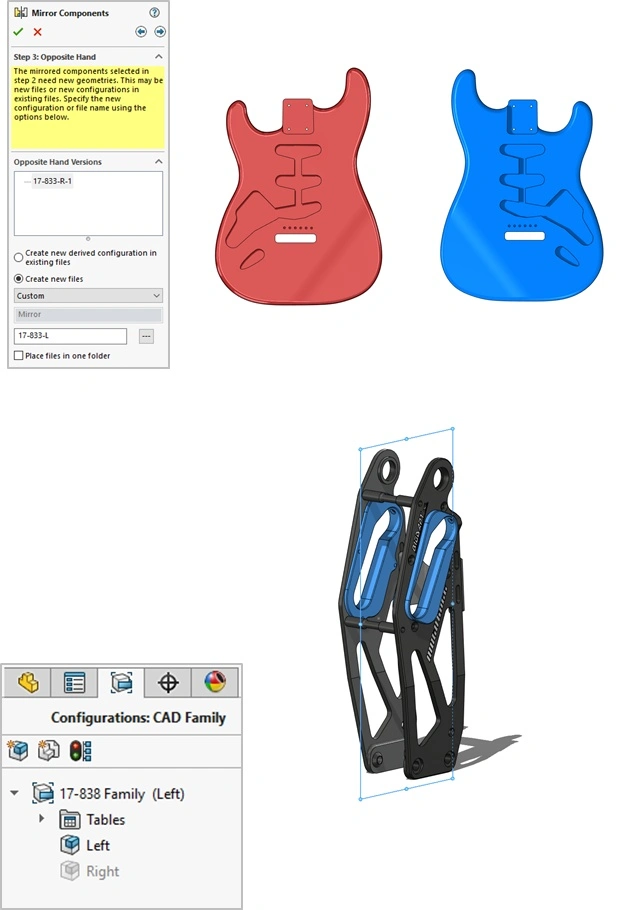

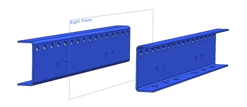

    ii) Mirrored Components and Split Parts
    When you create opposite-hand mirrored components as new files or you create split parts, and the base part has multiple configurations, the resulting derived part is created with multiple configurations that map to the base part configurations. You can edit the external reference of the derived part and change the referenced base part configuration if you need to. In these types of derived parts, SOLIDWORKS does not enforce any external reference after the derived part is created.
    The recommendation for these types of parts is to create one Physical Product configuration and create SOLIDWORKS Representation configurations for any additional design needs. This means that if you add a new Physical Product configuration to your base part, SOLIDWORKS will not automatically create a matching Physical Product configuration in the derived part. It is your responsibility to create a corresponding Physical Product configuration in the derived part if needed. And then you can then edit the external references in the derived part to map to the appropriate Physical Product configuration in the base part.
    In the case of opposite-hand mirrored components, the components should have a unique Enterprise Item Number and should be independently life-cycled. Therefore, the recommendation is to always create opposite-hand mirrored components as new files, instead of creating derived configurations in the base part. This way, the components will have individual Physical Products configurations, with individual Enterprise Item Numbers. Only create multiple Physical Product configurations in mirrored components if all the components have the same lifecycle.
    iii) Alternate Component Positions
    While designing, users can configure whether the position of a component is fixed or floating in an assembly. To fix or float an assembly component:
    1. Right-click the component.
    2. Select Fix or Float, and then one of the following options:
    • This configuration
    • All configurations
    • Specify configurations
    When incorporating an assembly containing dynamic components into a larger assembly, the default behavior restricts the movement of those components. If you intend to enable these movements within the top-level assembly, you must adjust the properties. To do so, right-click on the subassembly within the assembly tree and open the properties window. From there, you can switch the assembly from "Rigid" to "Flexible," and your desired functionality will be achieved. Users should use flexible assemblies in one Physical Product configuration. It's a current limitation that 3DPlay will only show the Physical Product positioning, not the flexible positions.
