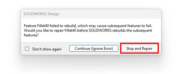

If that feature or any related feature cannot be rebuilt correctly after applying the change, a warning message is displayed. The warning message will state which features have failed and offer 2 options: Continue or Stop and Repair.

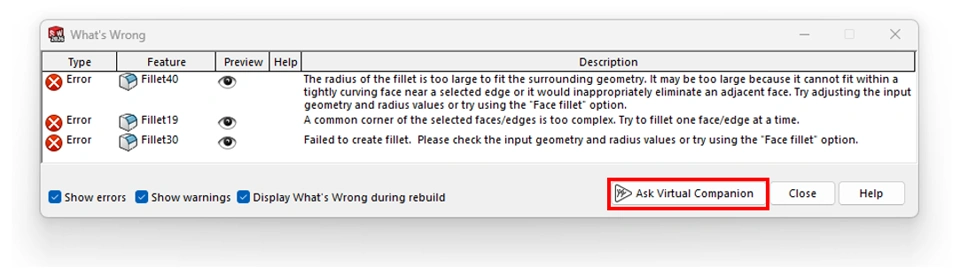

Selecting the Stop and Repair option will display the What's Wrong dialogue box. This displays a list of all of the affected features that cannot be successfully rebuilt.

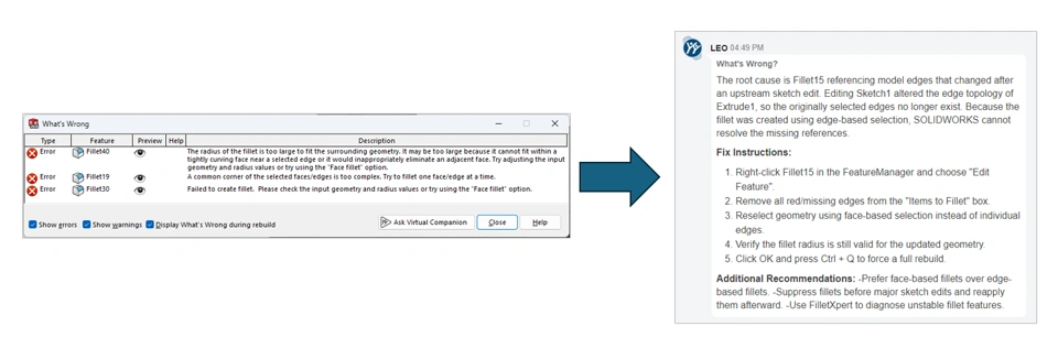

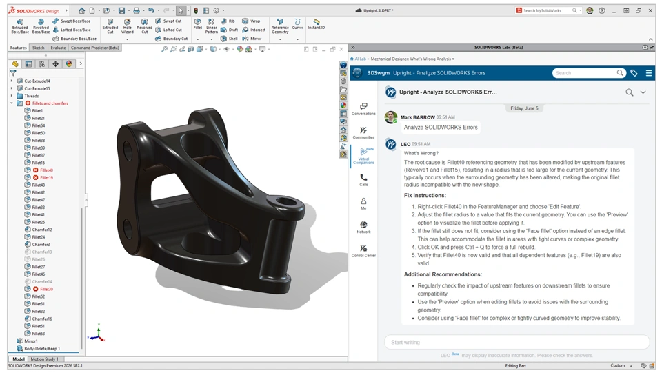

To use LEO to provide deeper insight into how to resolve the issue, select the "Ask Virtual Companion" button on the What's Wrong Dialogue.
A new LEO conversation will be automatically started in the Task Pane. LEO will explain the root cause, provide instructions on how to fix the issues, and offer additional recommendations on how to avoid a similar issue occurring in the future.

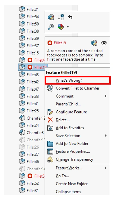

The Ask Virtual Companion command isn't only available after a rebuild of the model; it can be accessed by right-clicking over any feature that displays an error icon and selecting What's Wrong.

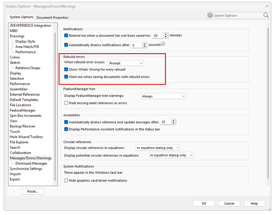

The out-of-the-box SOLIDWORKS system settings ensure that errors are displayed after a rebuild of the model. However, experienced users can switch this behaviour off. To display the What's Wrong dialogue box after a rebuild, the SOLIDWORKS System Option Show What's Wrong For Every Rebuild must be enabled.
