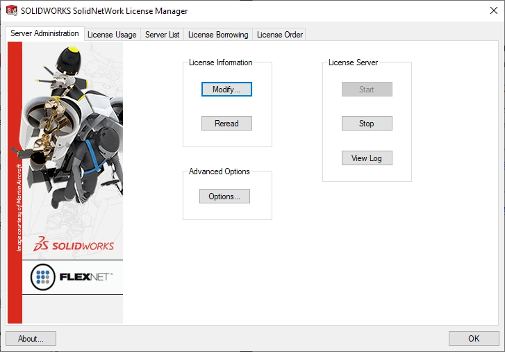

b) SolidNetWork License Manager and Options File
Network licenses allow multiple users within an organization to access licenses from a license server. This is particularly helpful when there are many users who need access to the software, but not necessarily at the same time. For example, an organization may have numerous SOLIDWORKS users who occasionally perform simulation analyses on their designs. With one license of SOLIDWORKS Simulation on the network license server, they can each use the license as needed. The license returns to the pool when the add-in turns off, and another user can claim the license to perform their analysis.
CAD administrators may want to monitor and control the usage of these network licenses. The SolidNetWork License Manager provides a log that can be helpful in monitoring usage. Administrators can see which licenses are in use, who is using them, and the duration of each session.
Administrators can also use an options file within the SolidNetWork License (SNL) Manager. To create the options file, the administrator can save a text file to this location:
SolidNetWork_License_Manager_install_dir\\Licenses\\sw_d.opt
This file allows administrators to limit licenses to specific users, or a group of users. Licenses can also be returned after a custom configured idle time.
For more information about the capabilities and syntax within the options file, refer to the following resources:
FlexNet Publisher License Administration Guide in the SolidNetWork License Manager Installation directory, by default the location is “C:\\Program Files (x86)\\SOLIDWORKS SolidNetWork License Manager\\Docs\\flexuser\\fnp_LicAdmin.pdf”
Help Document: Managing Access to SOLIDWORKS Versions
Help Document: Monitoring License Idle Time

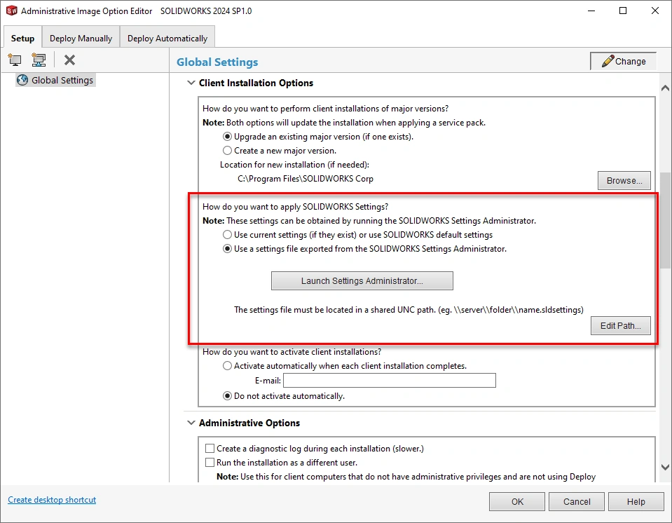

b) Administrative Image Option Editor
The Administrative Image Option Editor (Option Editor) permits manual deployment through an email message. In this case, users receive a link to the network location where the image exists. From there, they can run the StartSWInstall.hta script to install the SOLIDWORKS software with the options specified in the administrative image. To accomplish this, users must have administrative privileges on their systems. Optionally, users can browse to this network location and run the script without receiving a link in an email message.
Administrators can also use the Option Editor to deploy installations automatically and remotely. Microsoft Task Scheduler carries out the process, which requires no input or actions from individual users. This process requires read access to the administrative images folder, and read and write access to the [admin images folder]\\64bit\\logs folder.
Help Document: Prerequisites for Deploying Automatically
To deploy SOLIDWORKS automatically, administrators can go to the Deploy Automatically tab in the Option Editor. From this tab, they can choose specific destination client systems and groups in the Deploy column. It is possible to schedule installations to deploy immediately or for a later date or time. Administrators need to enter the client credentials of one or more destination systems. Finally, click Deploy to begin the deployment process. The status shows either Pending, Successful or Failed.
Help Document: Deploying Automatically
In addition to assisting with automatic deployment of administrative images, the Option Editor allows for customization of the option settings per group of machines or individual machines.
Help Document: Administrative Image Option Editor
Specific options that are customizable include defining which specific components of the SOLIDWORKS software to install. It is possible to specify other items, such as Toolbox options, SOLIDWORKS PDM Client options and SOLIDWORKS Electrical options. Administrators can also make decisions such as whether or not to upgrade an existing major version to the current version, or to create a new major version and leave the existing major version intact. The options can also specify to uninstall the existing major version before installing the new major version and to activate the product automatically when each client installation completes.
Help Document: Administrative Image Option Settings
Administrators can also choose to apply a preset collection of SOLIDWORKS options by using a SOLIDWORKS Settings File.
Help Document: Including an *.sldsettings File in SOLIDWORKS Installations

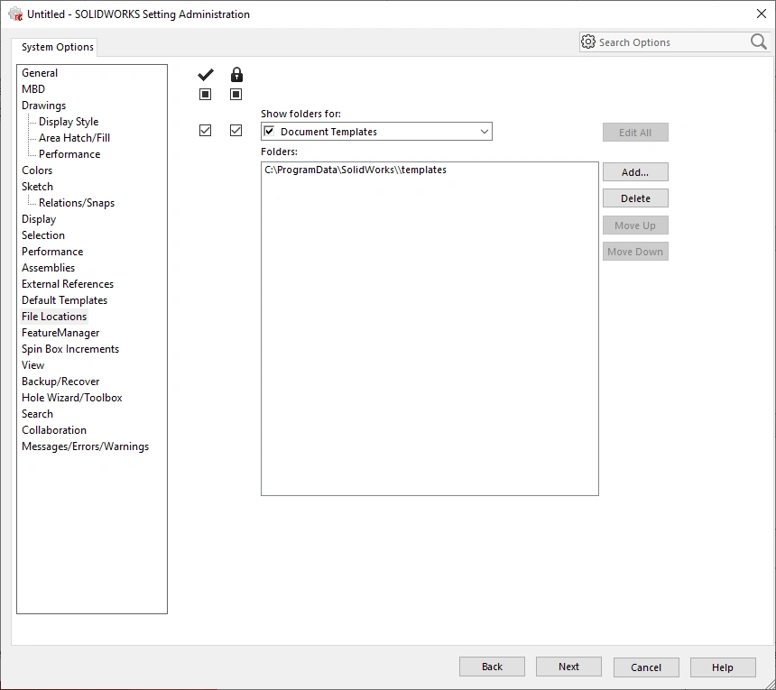

a) SOLIDWORKS Settings Administrator
Standardizing practices and documentation across an organization is a primary responsibility of CAD administrators. To ensure that everyone’s CAD environment behaves identically, it is a recommendation that all users use the same settings in SOLIDWORKS. An easy way that CAD administrators can enforce this is to use the SOLIDWORKS Settings Administrator tool to create a settings file. Administrators can then apply this settings file when creating the administrative image.
Help Article: Settings Administrator Tool
An additional benefit of the SOLIDWORKS Settings Administrator tool is that it allows administrators to lock the settings for specific options. It is a good practice to lock settings such as template file locations and default templates to ensure that users adhere to organizational standards.
The SOLIDWORKS Settings Administrator tool allows multiple starting options. Administrators can start with a default set of options, a set of options imported from a local SOLIDWORKS installation, an existing SOLIDWORKS registry file, or an existing sldsettings file.
Help Article: Using the Settings Administrator Tool
After choosing a set of options as a starting point, administrators can make modifications to the settings within the Settings Administrator tool. It is possible to activate any modifiable setting by marking the check box in the first column. Users can still modify this option unless the check box in the padlock column is also active.
Help Article: Applying and Locking Options
After customizing the settings, a dialog box with support contact information appears. This allows administrators to choose whether they want the Get Support command in SOLIDWORKS to go to the default website for SOLIDWORKS Support, or to provide users with specific support contact information, such as the customer support of their local value-added reseller (VAR).
Administrators can also choose how to apply the options. If specific options should be locked from the users, then specify the Every time a user starts SOLIDWORKS option and activate Apply locked options. In addition, administrators can choose to display the CAD administrator contact information to users if locked options are present. Administrators can provide a password to users who make a justifiable case for changing a locked option. When saving the settings file, the recommendation is to save the file to a UNC path with restricted write access.
Help Article: Finish Setting Options

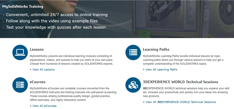

a) MySolidWorks Training
SOLIDWORKS offers self-paced online training through the MySolidWorks platform. There are several levels of MySolidWorks access:
  • MySolidWorks Guest
  • MySolidWorks Standard
  • MySolidWorks Professional
Any user can create a free MySolidWorks Guest account. This allows users to search the forums, blogs, videos, online help and 3D Content Central.
MySolidWorks Standard is available to users with a current subscription for SOLIDWORKS products. This level includes all the functionality of the Guest access, and adds hours of online training, as well as access to online file storage, advanced forums and the SOLIDWORKS Knowledge Base.
For users seeking additional, more in-depth training, MySolidWorks Professional provides online product tutorial videos. This training is presented as individual lessons, as well as specific learning paths of group relevant lessons. There are also a number of eLearning courses that were developed from SOLIDWORKS instructor-led training classes. These include guided practice, offline exercises and interactive content.

a) SolidNetWork License Manager Log File
The SolidNetWork License Manager provides a log file that shows the dates and times that users pull and return SOLIDWORKS licenses, as well as the system that uses the license. To view this log, open the SolidNetWork License Manager Server [version] application from the Windows Start menu (SOLIDWORKS Tools [version] > SolidNetWork License Manager Server [version]). On the Server Administration tab, click View Log to open a text file of the log, which displays information about recent license activity. This log file is also accessible from the SolidNetWork License Manager Installation directory.
Help Article: Troubleshooting SolidNetWork License Manager

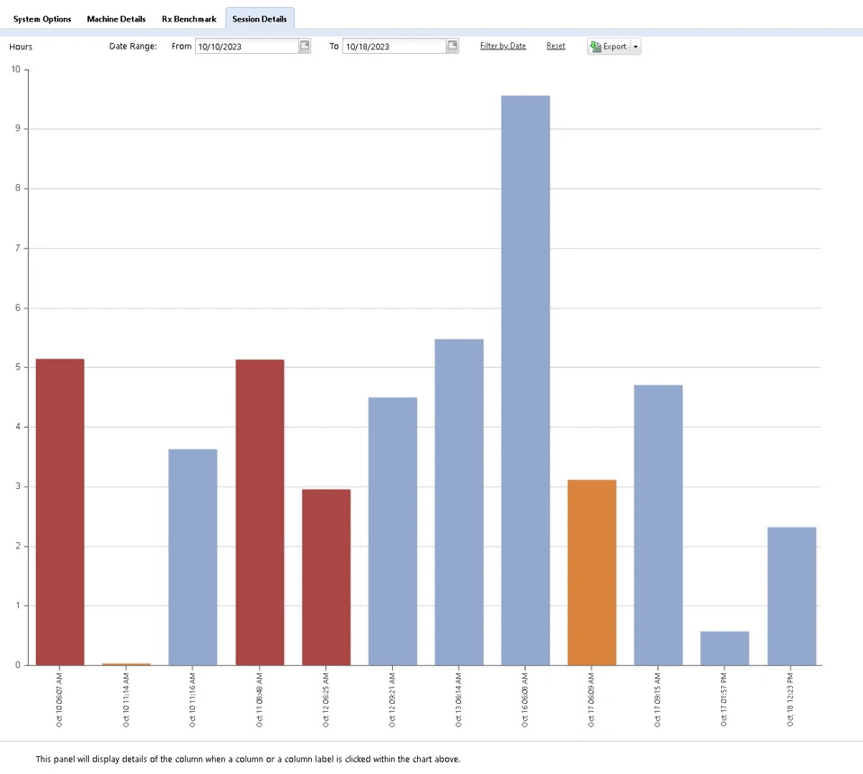

b) CAD Admin Dashboard
Another tool that allows administrators to monitor SOLIDWORKS usage and session statistics is the CAD Admin Dashboard. The CAD Admin Dashboard is accessible through SOLIDWORKS Support Home > Monitor Products > CAD Admin Dashboard.
Help Article: Accessing the CAD Admin Dashboard
After logging in to the dashboard, administrators can choose a specific system and view session details for that system. Sessions appear for each date that SOLIDWORKS was used. To view session details for a specific date, click the date on the X-axis of the chart or the bar of a bar chart. Sessions that terminate normally appear in blue. Sessions that appear in red terminated abnormally. The user-terminated sessions appear in orange.
Help Article: Monitoring Session Statistics

c) SOLIDWORKS Performance Test
The SOLIDWORKS Rx utility can also run a benchmark test. The Benchmark tab in the utility provides the ability to perform the test and allows you to compare your score against other systems that run the benchmark. The Rx Benchmark tab in the CAD Admin Dashboard displays the score for any system that runs the benchmark.
To run a SOLIDWORKS Performance Test, users can either open the SOLIDWORKS Rx [version] program, or open the performance test program directly from the Windows Start menu by selecting SOLIDWORKS Tools [version] > SOLIDWORKS Performance Test [version]. The recommendation is to close all applications and restart your computer before running the test. A low score in any of the categories may suggest that a hardware upgrade is necessary.
Help Article: Benchmarking Your Hardware

c) Upgrading Network Licenses
When upgrading a network license, administrators should first update the SolidNetWork License Manager. This ensures that a current version of the license is available after upgrading individual clients.
Help Article: Upgrading the SolidNetWork License Manager
d) Upgrading Administrative Images
If an administrative image was used to perform installations, it is best to upgrade that image for deployment to clients. Administrators can choose to create a new image by using the default settings, or create a new image that uses the settings and files from an existing image.
Help Article: Upgrading an Administrative Image
