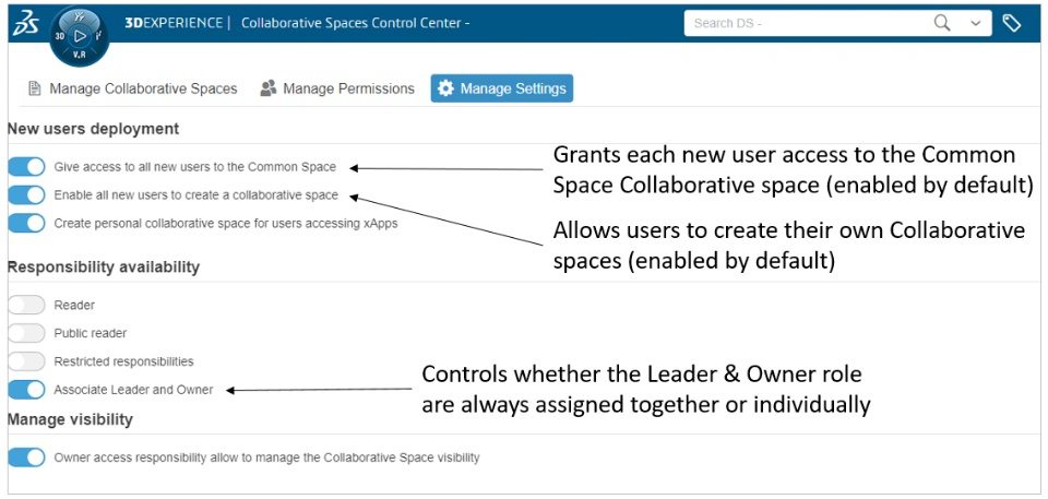

Each new customer 3DEXPERIENCE tenant is preconfigured with one collaborative space called Common Space. For a small number of designers, e.g. 1-3 users who are going to be using 3DEXPERIENCE primarily for cloud storage and basic revision control, the Common Space collaborative space can be used straight away as the default repository for content. However, be aware that by default, all new users added to a tenant are automatically added to Common Space, and the majority of companies will want full control over the collaborative space behavior, it’s recommended that at least one new collaborative space be created for storing SOLIDWORKS designs, and this is used instead of Common Space.
Note: The default behavior of each new tenant is to allow all users to create their own collaborative spaces. This can lead to lots of collaborative spaces being created that result in extra clutter. Instead, it’s recommended that the creation of new collaborative spaces be restricted to the platform administrator(s). This behavior is controlled using the option Enable All New Users to Create a Collaborative Space, and is located in the Collaborative Spaces Control Center.

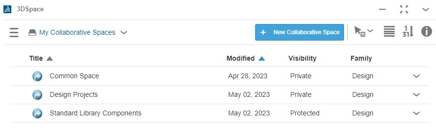

New collaborative spaces are created using the 3DSpace app on the “Content” tab of the Collaborative Designer for SOLIDWORKS Design role dashboard. When creating a new collaborative space, a user can set the Title and Description, and then choose from three options that determine the visibility of the content to other platform users.
  1. Private – Content is only visible to members of the collaborative space. Recommended for projects where the design content needs to be restricted to only the people working on it.
  2. Protected – Only content in the Released and Obsolete maturity states will be visible to all platform users within the company. Recommended for standard parts and libraries.
  3. Public – Companywide visibility of all content to all users regardless of maturity state
Note: When creating a new collaborative space, select the family option “Design” for all collaborative spaces that will contain content created using SOLIDWORKS.

The Owner role allows a user to administer the collaborative space, for example, add or remove users. The default behavior for each new Tenant is to combine both the Leader and Owner roles. This is useful for smaller companies because a user assigned the Leader & Owner role has the combined ability to both release designs and control which users have access to the Collaborative Space content. In large organizations, often a platform administrator or another dedicated user will have the responsibility of managing access to each Collaborative Space. This person or persons may not be part of the design release process. In this scenario, the Owner and Leader roles can be assigned separately. The people responsible for releasing design content are assigned the Leader role only, and the people responsible for managing collaborative space access are assigned the Owner role only. The associativity between the Leader and Owner roles is set using the Associate Leader and Owner option in the Collaborative Spaces Control Center.

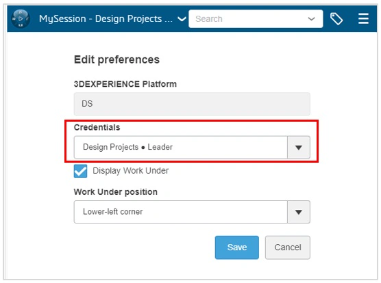

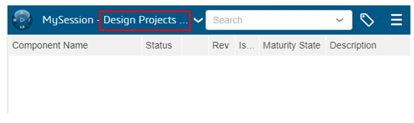

After creating a new collaborative space, before saving any files from SOLIDWORKS Design, it is important to ensure that the SOLIDWORKS session is connected to the desired collaborative space. The top bar of the MySession task pane area displays the name of the collaborative space that the current session is connected to. Any new files saved to the 3DEXPERIENCE platform will be automatically assigned to this collaborative space (unless the user chooses a different space in the Save to 3DEXPERIENCE dialogue box).
To switch SOLIDWORKS Design to a different collaborative space, select the drop-down arrow next to the collaborative space name, click on the preferences icon, and set the credentials to the desired collaborative space.
All new files saved to the 3DEXPERIENCE platform for the first time will be assigned to the collaborative space displayed under Credentials.

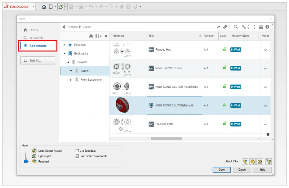

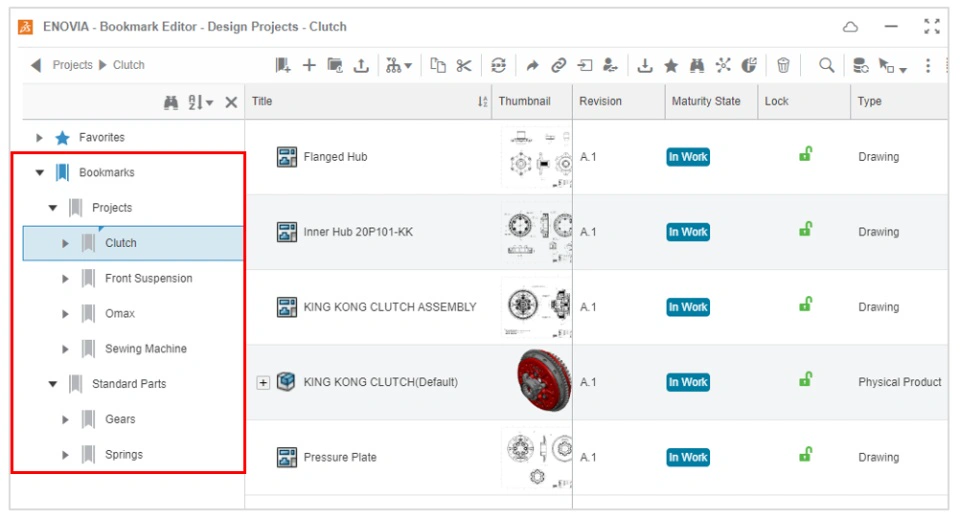

As stated previously in this section, Collaborative Spaces are not intended to act as folders, and the content contained within a Collaborative Space is stored in a flat structure. To help you transition from folders to the 3DEXPERIENCE platform, it is strongly recommended that you are familiar with Bookmark folders as the primary method of organizing your SOLIDWORKS Design content. Bookmark folders behave similarly to Windows folders; users can add SOLIDWORKS content to a Bookmark for easy access, and create Bookmark hierarchies in the same way that they would folder structures.
Bookmark folders are created and accessed using the Bookmarks Editor app, which is located on the Content tab of the Collaborative Designer for SOLIDWORKS dashboard.
Bookmark folders can also be accessed from inside SOLIDWORKS Design. A SOLIDWORKS Design part, assembly or drawing can be added to a Bookmark folder when saving it to the 3DEXPERIENCE platform, and files can be opened in SOLIDWORKS Design directly from a Bookmark folder in the same way a user would have previously done using folders.
Organizing SOLIDWORKS designs with Bookmark folders provides a folder-like experience and will provide continuity through a familiar way of working, aiding adoption in the early stages.
Once users become more familiar and comfortable with finding and navigating their Bookmarked content, other methods of content organization can be introduced that utilize the 3DSearch and 6WTag filtering capabilities to increase productivity further. However, for many users, Bookmarks will meet all of their needs.

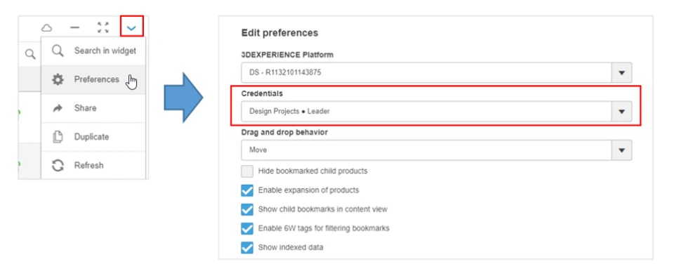

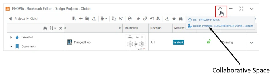

Although Bookmark folders are simple to use, there are a few concepts that users need to be aware of to avoid confusion. When a new Bookmark folder is created using the Bookmarks Editor web app, a Bookmark object is created in the Collaborative Space that the app is set to. Therefore, if a user is a member of multiple collaborative spaces, before creating a new Bookmark folder, they will need to check that their Bookmarks Editor widget is set to the correct Collaborative Space. The Collaborative Space setting can be viewed by hovering the cursor over the cloud symbol in the top bar of the widget.
Switching to a different active Collaborative Space is done via the preferences of the Bookmark Editor widget.

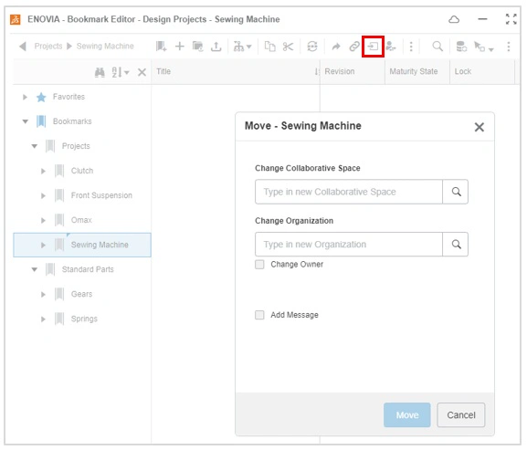

Note: If a user accidentally creates a Bookmark folder in a different Collaborative Space from the one in which they intended, it can be easily moved by selecting the Bookmark folder and using the “Move” command from the Bookmark toolbar.

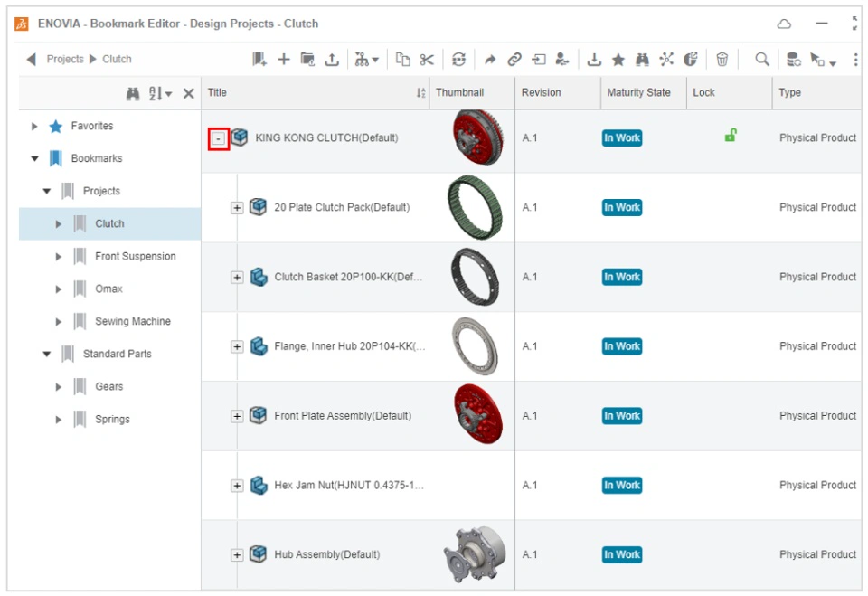

​​​​​​​Another recommended preference for Bookmarking SOLIDWORKS Design content is “Enable Expansion of Products. This preference is on by default and allows the user to expand a Bookmarked Assembly to view the complete structure without needing to have any of the child parts or sub-assemblies individually bookmarked.

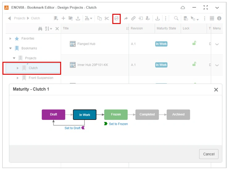

Like Windows folders, Bookmarks can be shared with other users. When a Bookmark folder is created in a collaborative space, by default, it will be visible to other users. The visibility is governed by the Maturity State of the Bookmark folder, and by default, all new Bookmarks are set to the In Work state. When Bookmark folders are set to the In Work state, they are visible to all members of that Collaborative Space. To make a Bookmark folder only visible to the person who created it, set the maturity state of the Bookmark folder back to the Draft state using the Lifecycle command from the Bookmarks Editor toolbar.
The default maturity state of new Bookmark folders can be set in the Bookmarks section in the Collaborative Spaces Configuration Center.
Some design teams may prefer to keep all new Bookmark folders private to each user and have them choose to share a Bookmark with other team members. In this scenario, the option Set the Maturity State to In Work should be unchecked.
