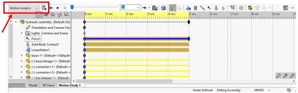

b) SOLIDWORKS Motion Analysis Study
Each Motion study has a tab in the motion manager bar near the bottom of the SOLIDWORKS user interface. A Motion Analysis study setup typically involves the application of mate constraints through SOLIDWORKS, and inputs in the form of motors and forces, which are defined in the time domain.
For example, a study might include a force of 1000 pounds applied at t=1s, ramped up to 2000 pounds at t=5s. Figure 3 depicts such a force definition within the SOLIDWORKS Motion Analysis study interface within the SOLIDWORKS MotionManager. To view this interface, you must first load the SOLIDWORKS Motion add-in and change the study type to Motion Analysis by using the drop-down menu in the upper left corner of the study pane.

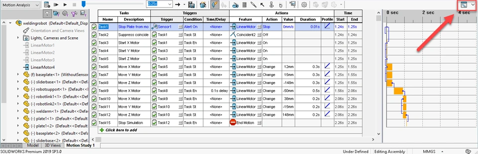

c) Event-Based Motion Analysis Study
In addition to Motion Analysis studies that involve triggers that are purely time-based, SOLIDWORKS Motion also supports analyses involving sets of motion actions that result from different types of triggering events. This event-based motion functionality requires a SOLIDWORKS Simulation Professional or SOLIDWORKS Simulation Premium license. SOLIDWORKS Premium does not include this feature.
The event-based motion functionality is built on top of a standard motion study. In addition to allowing time-based triggers such as turning a motor on or off, event-based actions involving a variety of trigger types are available. For example, a sequence of motor or force events can be set to occur when a component moves across and triggers a specified proximity sensor. This can be very helpful when setting up complex studies involving system feedback, and then making adjustments to shift the exact timing of certain events.
This motion analysis feature is useful and powerful, especially when analyzing complex machinery that is highly dependent on timing. Such machinery is a common component of an automated assembly line.
Users can toggle between the standard Timeline View shown in Figure 3, and the Event-based Motion View shown in Figure 4 by clicking on the view icon in the upper-right corner of the MotionManager.
When in Event-based Motion View, a task-based table appears in the central portion of the MotionManager. A Gantt flow chart appears at the extreme right side. The Gantt flow chart is a visualization of the task sequence in the time domain.

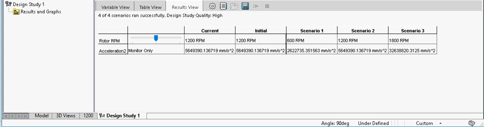

Figure 5 shows the setup forDesign Study 1, which examines the acceleration of a component at a specific time for three different motor speeds.
Figure 5 – Design Study setup (Variable View)
Figure 6 shows the results from Design Study 1.
Figure 6 – Design Study Results view

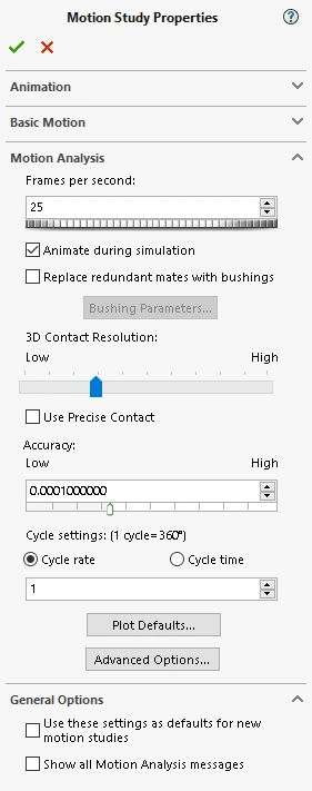

Motion Analysis studies use the same general interface as the Animation and Basic Motion type studies, but have many more features and settings available. This section will go over the basics of some of these features.
a) Frames per second
In the Motion Analysis study properties, the first option is Frames per second. Multiplying this value by the length of the animation returns the total number of frames that you want to save the results for. This value does not affect the playback speed.
It is fundamental that you having enough frames per second in the motion study to capture important events. You can think of the Frames per second setting as a sampling rate, where the solver continues taking its own steps in the background while snapshots of the model are saved only at specific frames.
b) Replace redundant mates with bushings
The Replace redundant mates with bushings option converts redundant mates in the assembly into bushings during the calculation. In most cases, this increases the necessary calculation time. The Bushing Parameters change the stiffness and damping for all bushings that replace redundant mates.
Including bushings in a Motion Analysis study is equivalent to adding a flexible mate. You can think of a bushing as a spring and damper system.
c) Cycle settings
The Cycle settings specify the cycle rate or period. These settings define the cycle angle for use as an alternative independent variable in custom Motor or Force profiles.
Figure 9 - Motion Study Properties

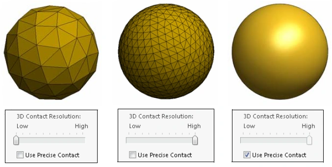

d) 3D Contact Resolution
The 3D Contact Resolution slider controls the number of facets that SOLIDWORKS uses to represent the geometry. The position of the slider influences the resolution accuracy of geometries involved with contact when the motion analysis runs.
If high contact precision is necessary, always select the Use Precise Contact option, which represents the geometry exactly as modelled.
Figure 10 – 3D Contact Resolution
e) Accuracy
The Accuracy parameter is independent of the model dimension and units. This parameter controls the relative error allowable in between each solver iteration.

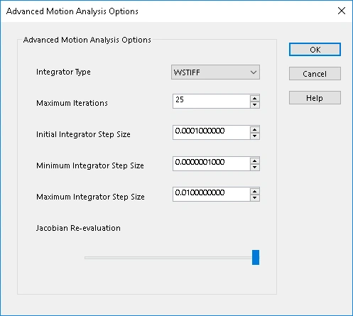

In the Motion Analysis study properties, there is another menu for Advanced Options, which allows you to adjust some of the options used when the solver calculates a solution.
Figure 11 – Advanced Motion Analysis Options
a) Integrator Type
SOLIDWORKS Motion solves a set of coupled differential and algebraic equations (DAE). There are three types of integrators available in SOLIDWORKS Motion:
i) GSTIFF
The SOLIDWORKS Motion solver uses the GSTIFF method by default. The GSTIFF method uses a variable order and variable step size integration. This is a fast and accurate method for computing displacement for a wide range of motion analysis problems.
ii) WSTIFF
The WSTIFF method is similar to the GSTIFF method in formulation and behavior. The only difference is that the coefficients used internally by GSTIFF are calculated assuming a constant step size. In WSTIFF, these coefficients are functions of the step size. If the step size changes suddenly during the integration, GSTIFF introduces a small error in the solution, whereas WSTIFF can handle the error without any loss of accuracy. Therefore, the problems run more smoothly in WSTIFF.
Sudden step size changes occur whenever there are discontinuous forces, discontinuous motions, or abrupt events such as 3D contacts in the model.
iii) SI2_GSTIFF
The Stabilized Index Two GSTIFF (SI2_GSTIFF) method is a modification of the GSTIFF integration method. The SI2_GSTIFF method provides better error control over velocity and acceleration terms in the motion equations. If the motion is sufficiently smooth, the SI2 velocity and acceleration results are more accurate when compared with GSTIFF or WSTIFF computations, even for motions with high frequency oscillations. SI2 is also more accurate with smaller step sizes, bit it is significantly slower.
b) Maximum Iterations
The Maximum Iterations option specifies the maximum number of times the numeric integrator iterates in the search for a solution for a given time step. If the program exceeds this limit, a convergence failure is recorded. The default value is 25.
c) Initial Integrator Step Size
The Initial Integrator Step Size option controls the speed at which the integration method starts, and its initial accuracy. You can run the simulation more quickly in subsequent runs by increasing this value. Enter the desired first integration step size used by the variable step integrator.
d) Minimum Integrator Step Size
The Minimum Integrator Step Size option makes it possible to decrease the simulation time by increasing this value. Enter the desired lower boundary of the integration time step.
e) Maximum Integrator Step Size
The Maximum Integrator Step Size option is important if the integration method does not detect short-lived events such as impacts. Enter the desired upper boundary of the integration time step. Set this value to be of the same order as the short-lived events. If this value is too large, the simulation can ignore some events.
The maximum integrator step size controls the value of the largest time step the integrator can take during the solution.
Increasing the value for the Maximum Integration Step Size option speeds up the solution and reduces the amount of time it takes to solve the Motion Analysis study. However, if this value is too large, there is a chance that the solver will take too large a step and enter a region from which it may not recover and subsequently fail to converge.
When using the GSTIFF integrator, velocities and acceleration can experience discontinuities for larger values of integrator time step.
If you confirm that the motion is smooth and does not experience abrupt changes, you can increase this value to speed up the solution.
f) Jacobian Re-evaluation
Use the Jacobian Re-evaluation slider to set the frequency at which the software re-evaluates the matrix.
The Jacobian matrix is a matrix of partial derivatives that are required to solve the linearized approximation of the original nonlinear equations of motion during the Newton-Raphson iteration process.

7) Motion Study Properties - Recommendations for Troubleshooting
An important and fundamental setting is the integrator step size. In cases where motion studies fail on the first time step, lowering the initial integrator step size may be helpful. Similarly, decreasing the value of the maximum integrator step size can also help the solver get past sudden discontinuities throughout the duration of the motion study.
Be aware that changing these settings can drastically affect the time that it takes to solve a motion study. However, in some cases, it may be necessary to use a very small initial or maximum integrator time step to solve a study successfully.
Parameters that commonly require adjustment include:
  • Accuracy
  • Maximum Integrator Step Size
  • 3D Contact Resolution
If changing these parameters does not help the study convergence, make sure that your inputs are smooth and differentiable, especially the user input expressions with mathematical functions.
For motion loads, it is a general recommendation to use the STEP function instead of an IF statement when possible.

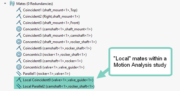

Keep in mind that each motion study can have so-called “Local” mates, which are mates created within a motion study that will only appear in that specific study. These “Local” mates have no effect on other studies or on the mates in the model itself. When a “Local” mate is created, its name automatically starts with the word “Local,” as shown in Figure 12.
Figure 12 – “Local” mates in a Motion Analysis study

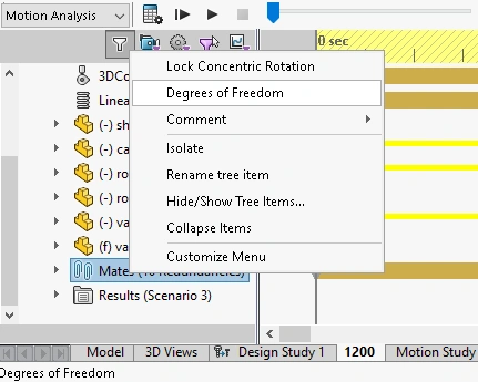

Figure 13 – Degrees of Freedom (aka Gruebler Count) tool
The problem with using bushings is that users will often simply enable the global Replace redundant mates with bushings option in the Motion Study Properties and expect their mechanism to solve. While this may be the case for some models where forces and torques between components are of similar and relatively constant magnitudes, more often than not, problems will occur. This is because applying global bushings in this way will impose a single set of stiffness and damping values for each translational and rotational DOF in every mate. As a result, some may be too stiff to allow the solver to converge, some may be severely imbalanced, and some may simply fly apart due the mate “breaking” as a result of insufficient stiffness.
The best approach when using bushings is to specify the bushing parameters for each mate individually based on your knowledge of the actual assembly. This is possible when editing a mate by clicking on the Analysis tab and selecting the Bushing option, which will allow modification of the bushing parameters. Determining the best parameters is often a trial and error process because it depends on the forces acting on the mate. In general, if you do not have an estimate for the flexibility of a mate, it is often best to select the values so that the stiffness is high relative to the forces acting on the mate, thereby resulting in small displacements.
