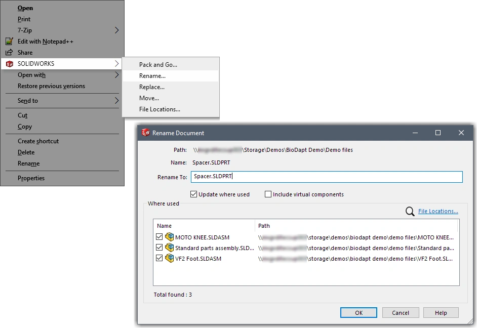

b) Pack and Go
Pack and Go is a very powerful SOLIDWORKS File Utilities tool. It is useful to gather all related files for a model and it allows you to rename and copy all related files to another location.
Pack and Go is accessible when you right-click a SOLIDWORKS file in File Explorer, or from the File menu within SOLIDWORKS.
Use this tool during the file preparation phase to locate your file set.

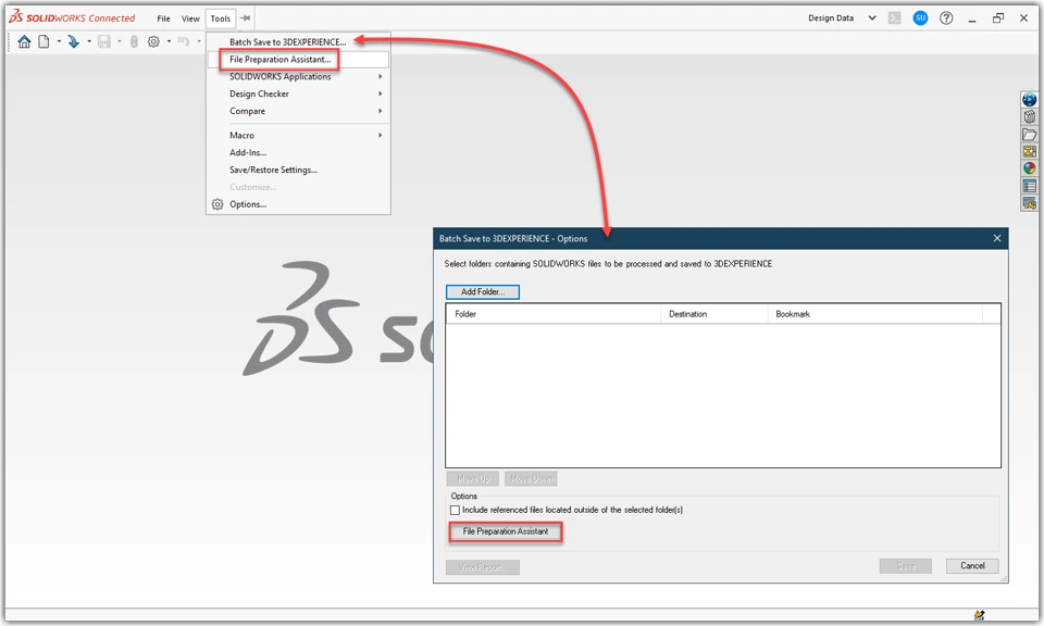

c) File Preparation Assistant
The File Preparation Assistant is included with all packages of SOLIDWORKS Design and with Collaborative Designer for SOLIDWORKS and SOLIDWORKS Desktop 2023 SP1.0. It is available with limited capability in SOLIDWORKS Desktop 2022.
You can access this tool from the Tools menu within SOLIDWORKS and from the Batch Save to 3DEXPERIENCE tool. It runs independently without requiring a connection to the 3DEXPERIENCE platform.
The File Preparation Assistant is designed to analyze the quality of legacy file sets and to find compatibility issues that may prevent a successful move to the 3DEXPERIENCE platform, and which may cause downstream issues when working with the data.
Use this tool during the file preparation phase to analyze and
  • Detect and fix file-related issues across multiple folders simultaneously.
  • Detect and merge unnecessary duplicate files.
  • Identify missing files and configuration references.

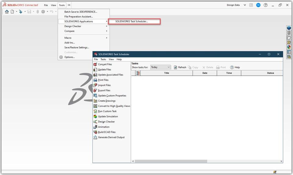

The SOLIDWORKS Task Scheduler is included with all packages of SOLIDWORKS Design and SOLIDWORKS Desktop.
This tool is accessible from the Start menu and from the Tools menu within SOLIDWORKS.
Use this tool during the file preparation phase to refresh your file set.

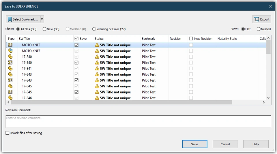

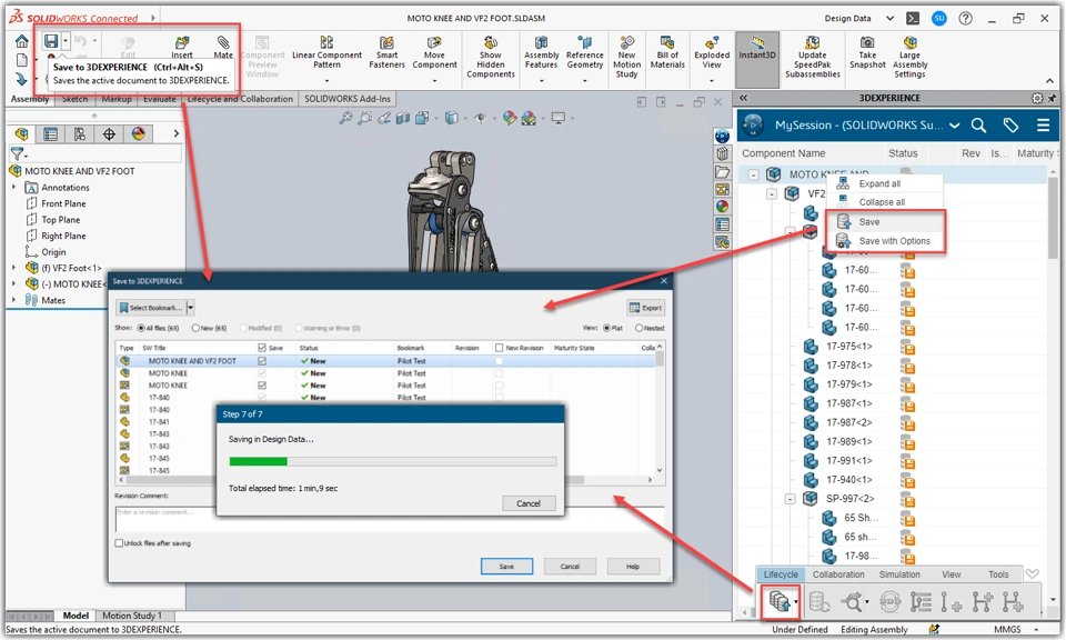

e) Interactive Save to 3DEXPERIENCE

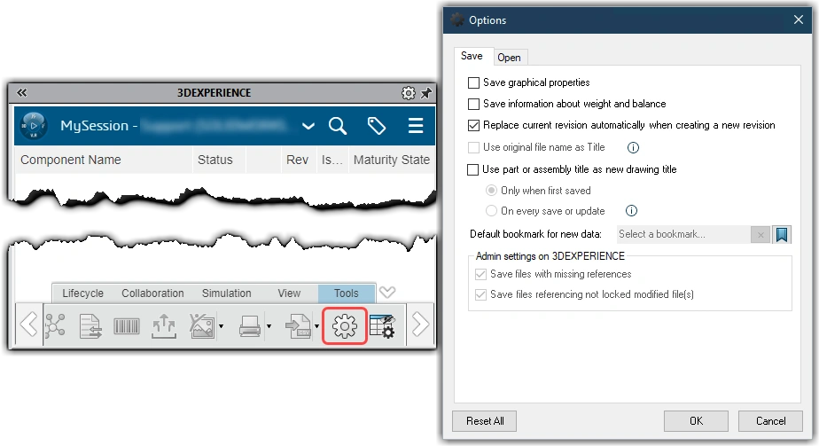

The Save to 3DEXPERIENCE command is available from the SOLIDWORKS File menu, toolbars, and from the MySession app within the 3DEXPERIENCE task pane. This is an interactive, synchronous command that securely uploads SOLIDWORKS files and creates corresponding SOLIDWORKS mastered database objects in a specified collaborative space. This command is suitable for a file set that contains several projects with a total file size < 500 MB.
  • Accessible to all platform members
  • Included with all SOLIDWORKS Design roles and Collaborative Designer for SOLIDWORKS
  • There is no gatekeeper. If several platform members save the same files, the system only warns you that duplicate data will be created. The system does not block the creation of duplicate data in the collaborative space.
  • Limited efficiency since it prevents you from using SOLIDWORKS while the save processes.

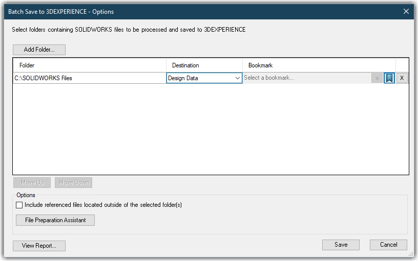

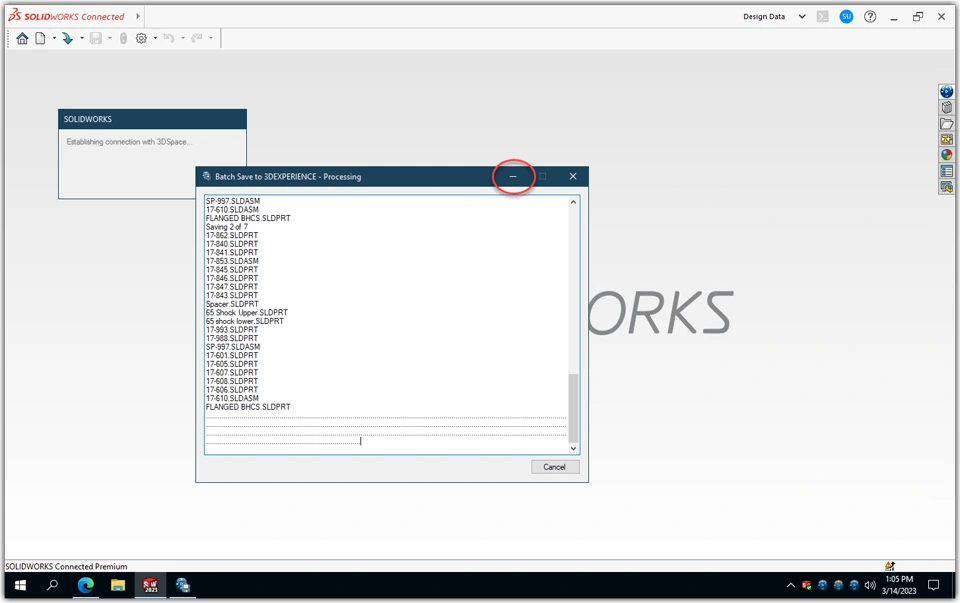

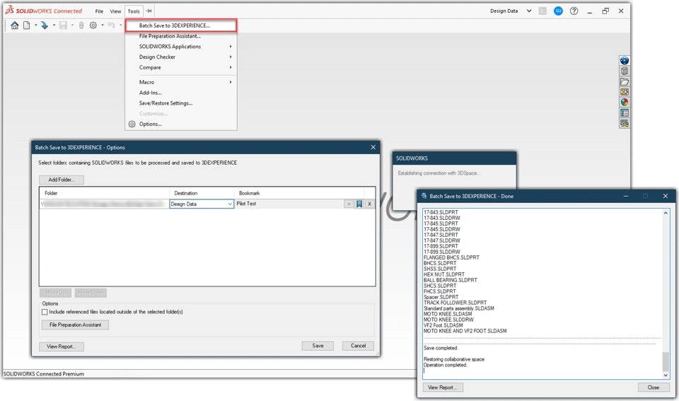

f) Batch Save to 3DEXPERIENCE

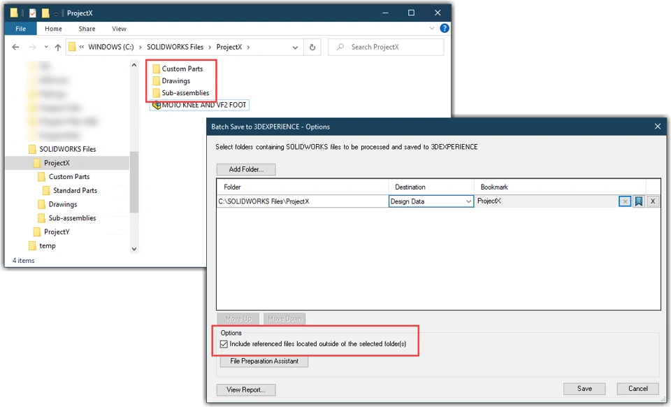

The Batch Save to 3DEXPERIENCE tool is available from the SOLIDWORKS Tools menu. This is an automated, asynchronous tool that has the same secure upload and database object creation capability as the Save to 3DEXPERIENCE command. It provides the ability to save SOLIDWORKS files from multiple folders into various collaborative spaces and bookmarks. This command is suitable for a large data set that contains multiple projects with a data set size that is less than 5GB.
  • Ability to save referenced files located outside of the selected folders
  • Provides a save report
  • Prevents files from the same file location from being duplicated if the tool is run multiple times on the same file set
The tool improves efficiency because the saves runs asynchronously, in a separate process. This allows you to use SOLIDWORKS while the save processes.

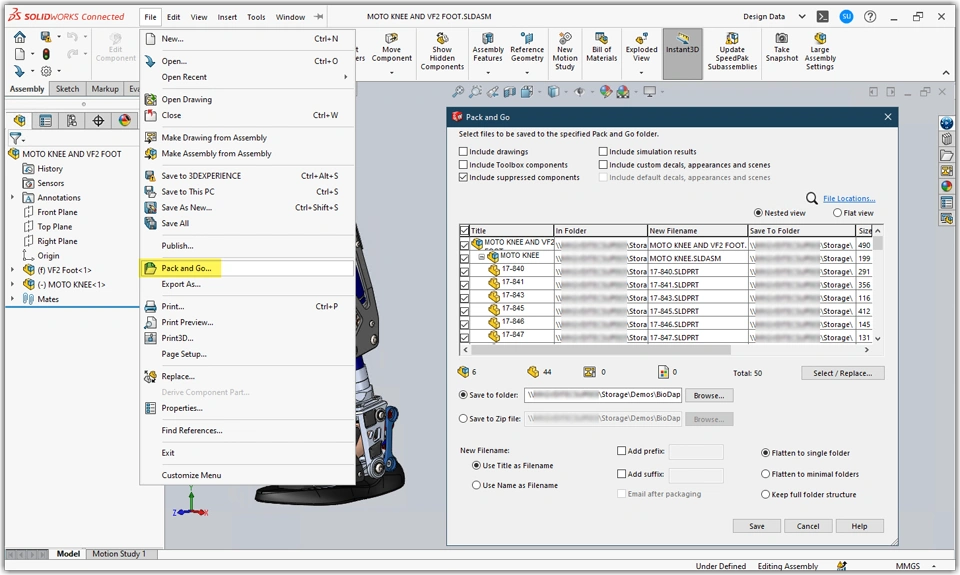

In this case, use Pack and Go on each top-level assembly to create copies in root paths on the dedicated computer. For example, [C:\\ProjectX]. More options are available when running Pack and Go from within SOLIDWORKS, so make sure to enable all the correct options:
  • Keep full folder structure
  • Include drawings
  • Include suppressed components
Do not activate the Include Toolbox components option. The 3DEXPERIENCE platform automatically recognizes, saves and manages Toolbox components. If your file set contains Toolbox components, then STOP and read the SolidPractices document “Working With Toolbox” to become familiar with that methodology.
Figure 1 – Pack and Go launched from Windows File Explorer
Figure 2 - Pack and Go launched from SOLIDWORKS has additional options

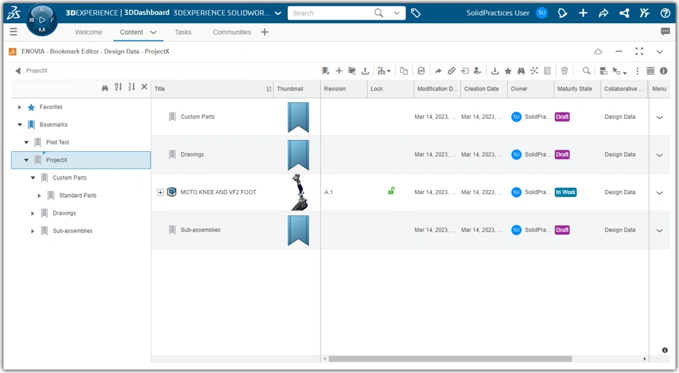

ii) Reorganize data in the 3DEXPERIENCE platform
If you want to reorganize your data in the 3DEXPERIENCE platform, then the recommendation is that you use Pack and Go on each top-level assembly in your file set to create local copies in root paths on the dedicated computer (such as [C:\\ProjectX]), and choose the Flatten to single folder option.
You will save your file set to a single bookmark, in the same way as the Pilot Test (see section 6)a). After moving and validating the file set, you can create additional bookmarks and move your SOLIDWORKS data to the new bookmarks.

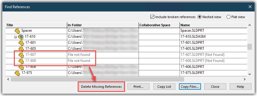

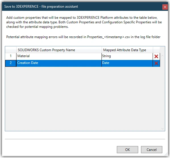

Fourth, use the File Preparation Assistant to analyze your file set for missing file references, incompatibility issues and unwanted duplicate files.
One of the many advantages of using the 3DEXPERIENCE platform is its powerful range of capabilities for tracking and managing relations. When you save your file set to the 3DEXPERIENCE platform, all file references are analyzed and reconstructed as relations in the database. This gives you complete traceability of where each part, assembly and configuration is used. Because of this, it is vital for your file set to be accurate and up-to-date.
Figure 4 - Example of the Relations app showing parent and child relations of a SOLIDWORKS object.
The File Preparation Assistant can help prevent you from saving an inaccurate, out-of-date or incompatible file set. It also ensures that your file set is prepared for the 3DEXPERIENCE platform to successfully reconstruct the all-important relations.

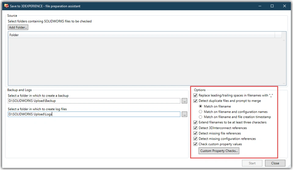

i) Using the File Preparation Assistant
The basic steps to use the tool are as follows:
1. Click Add folder and select the folders you defined during the Locate step.
2. Select a backup folder. This folder is used to back up any files that are modified by the check and fix commands.
3. Choose a log folder. Several log files are created in this folder.
4. In the Options section, choose the checks you want to run.
5. Click Start to run the checks. This may take a while if your file set has a large number of files.
6. (Only applicable if you choose to detect duplicate files.) Take corrective action to address duplicate files.
7. Review the results in the logs.
ii) File Preparation Assistant Options
  • Replace leading/trailing spaces in filenames with "_”: Because the 3DEXPERIENCE platform does not support leading or trailing spaces in filenames, this check finds any such files and renames them, replacing leading or trailing spaces with an underscore character. Any Where Used file references included in the scope of the file set will be updated.

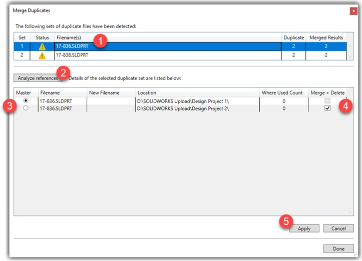

  • Detect duplicate files and prompt to merge: The 3DEXPERIENCE platform does not block you from saving duplicate files. Therefore, the recommendation is to use this check to identify any duplicate files and resolve those conditions before moving the file set.
    This check finds duplicate files and prompts you to either keep the duplicates (and rename one of the files to avoid duplicates,) or merge the duplicates (remove one and automatically update references with the other.)
  • Match on filename: Checks only for identical filenames.
  • Match on filename and configuration names: Checks for identical filenames, identical configuration names and the quantity of configurations.

  • Merge Duplicates Dialog
    The Detect duplicates files and prompt to merge check requires user interaction while it is running.
    Any duplicates found appear in the Merge Duplicates dialog box.
    The top pane lists all duplicate files. The Duplicate column shows the quantity of duplicates. The Merged Result column shows the quantity of files after the merging operations complete.
1. Select a duplicate row in the upper pane.
2. Click Analyze references to find any Where Used references for all the duplicates of the selected file.
3. Identify one of the duplicates as the Master.
4. All other duplicates can either be:
• Merged with the Master and deleted – NOTE: This deletes the duplicate from disk!
• Kept as unique files. A new filename is assigned and you can choose to override that value.
5. When your analysis is complete, click Apply. Any Where Used references included in the scope of the selected folders will be updated to reflect the changes.
Extend filenames to be at least three characters: 3DSearch queries require at least three characters.
To avoid this limitation, this check finds files that only have one or two characters and renames them by adding an underscore to the end of the filename. Any Where Used references included in the scope of the selected folders will be updated.
  • Detect 3DInterconnect references: Although you can save SOLIDWORKS files with 3D Interconnect links to the 3DEXPERIENCE platform, you cannot save the referenced non-native CAD files. This check finds files that have 3D Interconnect links and lists them in a log file. No changes are made to your file set.
    With this list, you must decide whether you want to maintain the links and separately manage the locally stored non-native CAD files, or whether you want to break the links to streamline performance and reliability. The recommendation is to break all 3D Interconnect links.
    For more information about 3D Interconnect, including how to use it, refer to the SOLIDWORKS Online Help.
  • Detect missing file references: It is a best practice to correct or remove all missing file references before moving your file set to the 3DEXPERIENCE platform. For example, an assembly with missing component references, or derived parts with a missing inserted part references. You can save a file set with missing references to the 3DEXPERIENCE platform, but the platform blocks you from resaving that data until you resolve the missing file references.
    This check analyzes your file set and creates a MissingFiles_[timestamp].csv file. No changes are made to your file set.
    The CSV file contains a comprehensive history of any missing files. It lists every file location in which a given missing file once existed, for every time it was inserted into an assembly or part and saved. For example, if your file management methodology included copying and pasting files or folders to start new projects, then you also unknowingly copied the previous file location history. This check exposes that history and may show file locations that no longer exist.
    Open the CSV file in Microsoft® Excel® and filter the Missing file name column to identify the number of unique files that you need to locate or remove from your file set.
    When resolving missing file references in SOLIDWORKS, use the Delete Missing References command in the Find References dialog box to delete missing references that you no longer need, or cannot otherwise resolve.
  • Detect missing configuration references: Like missing file references, it is a best practice to correct or remove all missing configurations references as well. This check should be run in tandem with the Detect missing file references check. For example, an assembly referenced a configuration X of a part when initially inserted, and configuration X was deleted since the assembly last saved.
    No changes are made to your file set. The intention is that you will decide what course of action to take after reviewing the log file.
  • Check custom property values: Only use this check if you plan to configure attribute mapping in your 3DEXPERIENCE platform. (Go through the SolidPractices document “Attribute Mapping for SOLIDWORKS” to become familiar with that methodology.) For attribute mapping to succeed, your SOLIDWORKS file properties must have an appropriate Type for the attributes to which they map. For example, you may map a file property with the name [Release Date] to an attribute with the name [Release Date], which has a data type of Date. If that file property for a SOLIDWORKS file specifies Text, then the attribute mapping fails.
    This check finds files where the attribute mapping would fail because of mismatched data types, and creates a Properties_[timestamp].csv file with a list of those files. To define this check:
1. Click Custom Property Checks.
2. Add your SOLIDWORKS file properties by Name.
3. Add the data type of the corresponding mapped attribute in your platform.
4. Click OK then Start.
iii) File Preparation Assistant Best Practices
It is a recommendation to run as many of the checks as possible, even if you think some do not apply. (The exception is the custom property check.) For example, if you are sure that your file set does not have 3D Interconnect links, run that check anyway. If it detects a file, that saves you a lot of trouble that may otherwise require deleting data from your platform and resaving.
If any checks return positive results, the recommendation is to rerun the checks after you resolve the issues.
It is also best to run each check individually. That way it is easier to systematically review each log and not forget any of the checks.

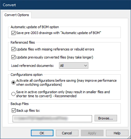

e) Refresh
Finally, use SOLIDWORKS Task Scheduler to complete the preparation of your file set. Create a Convert Files task with the following options to convert, update and resave your file set. This task may be time-consuming, but it helps ensure an error-free file set.
Figure 5 - Make sure to activate Update previously converted files (may take longer)
Load referenced documents: All, and Activate all configurations before saving.

b) Recommendations for MySession Options
None. The default specifications are sufficient.
Figure 6 - Default MySession save options.

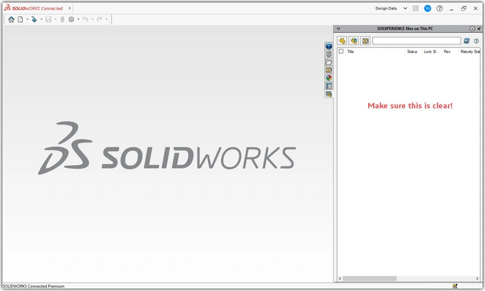

d) Local Work Folder
Make sure your local work folder that appears in the 3DEXPERIENCE files on This PC task pane is clear.
The system uses your local work folder to keep track of which files in your file set are saved to the 3DEXPERIENCE platform. Once you start your move, you must never delete files from the local work folder.

1. With the collaborative space that you created for your design data, create a bookmark titled Pilot Test.
2. Open SOLIDWORKS and connect to that collaborative space as a Leader.
3. Open your pilot test assembly in Resolved mode, from the location you specified in section 4a.
4. Save the assembly to your 3DEXPERIENCE platform, choosing the Pilot Test bookmark, using one or both of the methods (to test both) as described in sections 6b and 6c.
ii) Pilot test validation

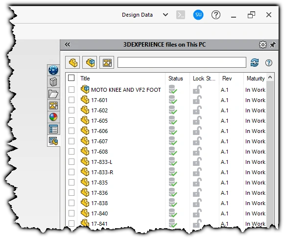

1. Review the data in the bookmark.
  • Are thumbnail previews created?
  • Can you open the data in 3DPlay
  • Can you lock and unlock the data?
2. Use the MySession app to confirm that all objects have correct metadata (title, maturity state, revision, ownership and others)
3. Close the assembly.
4. Clear your local work folder using the 3DEXPERIENCE files on This PC task pane.
5. Use 3DSearch or Bookmark Editor within the MySession app to search for and open your assembly.
6. Validate that the assembly opens the same as it did in step 3.
iii) Pilot test cleanup
1. Close the assembly and clear your local work folder.
2. Use Bookmark Editor to delete all the Pilot Test data.

b) Interactive Save to 3DEXPERIENCE
This method of moving files to the 3DEXPERIENCE platform involves opening a file from your file set, clicking a save command, and waiting for the file to save. You then repeat this process until you finishing moving the entire file set.
This is also the save method you use after moving your file set. After moving a file set, an interactive save is what all users use when resaving data to their 3DEXPERIENCE platform.
The general procedure for interactive save is:
1. Open a file in Resolved mode.
2. Click any of the following Save to 3DEXPERIENCE commands:
  • File > Save to 3DEXPERIENCE
  • From the MySession app within the 3DEXPERIENCE task pane, right-click the top node in the tree > Save.
  • From the MySession app within the 3DEXPERIENCE task pane, right-click the top node in the tree > Save with Options.
    This is the recommended command. It ensures that the Save to 3DEXPERIENCE dialog box appears, where you can interrogate what to saved.
  • From the MySession app within the 3DEXPERIENCE task pane, select the top node in the tree, Action Bar > Lifecycle > Save Active Window.
3. Wait for the seven steps of the save process to complete. See the Knowledge Base article QA00000069720 for details about this process.
4. Repeat these steps for all files in your file set.
Important: Do not clear your local work folder unless you are restarting the move. The system uses the local work folder to determine which files have been saved. If you clear the local work folder at any time during the move, duplicate data may be created.
Figure 7 - Interactive save interests you or pauses when needed if important information, like duplicate data warnings, need to be communicated. In this example, platform data with the same titles as the file set being saved already exists and therefore should NOT be saved.

c) Batch Save to 3DEXPERIENCE
This is an automated method of moving files to the 3DEXPERIENCE platform. It uses the Batch Save to 3DEXPERIENCE tool, which can save your entire file set in one step. You typically only use this method once, when moving your file set.
The general procedure for batch save is:
1. Open the Batch Save to 3DEXPERIENCE tool.
2. Add the folders in which you store your file set.
Important: If you do not have a flat folder structure, then make sure to activate the Include referenced files located outside of the selected folder(s) option.
3. Select bookmarks for each folder.
4. Click Save.
5. Wait for the save process to complete and review the report.
Important: Do not clear your local work folder unless you are restarting the move. The system uses the local work folder to determine which files are saved. If you clear the local work folder at any time during the move, duplicate data may be created.

• If you use an existing folder structure, this method automatically recreates your File Explorer folder structure as bookmarks and places the resulting SOLIDWORKS data in the corresponding bookmarks.
Figure 8 - Batch saving a file set with a folder structure.
Figure 9 - You can minimize the Batch Save to 3DEXPERIENCE tool while it processes the save.
Figure 10 - The Windows File Explorer folder structure is automatically recreated as bookmarks and objects are automatically added to the bookmarks accordingly.
Figure 11 - When the save completes, the local work folder is populated with data. This is how to verify that your file set was saved successfully from your chosen file location.
  • The save runs asynchronously, which means that you can interact with and use SOLIDWORKS while the save processes.
  • You can rerun a batch save if a previous attempt fails or is interrupted, or if you forget to add a folder or option. As long as you do not clear your local work folder, the tool will restart the save process starting with the group of files that previously failed. Always rerun the tool after a failure.
  • The tool generates a report. Although not advisable, if you omit the Refresh step of file preparation, the tool does not convert files to the current version.
