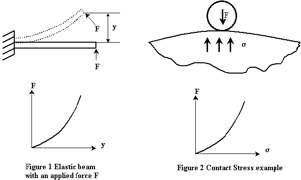

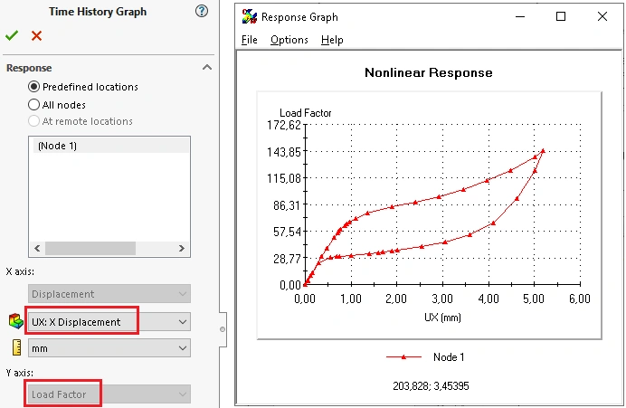

Therefore, for various reasons, a problem may become nonlinear and the load versus displacement plot ceases to be a straight line. The following figures depict two types of nonlinear problems:

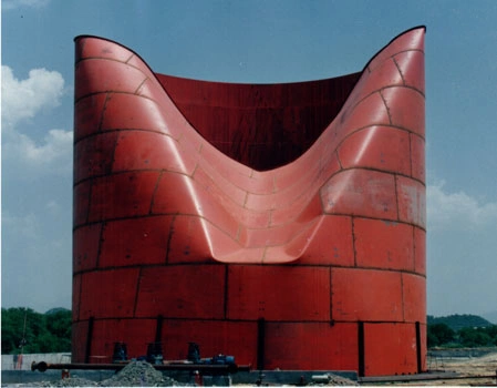

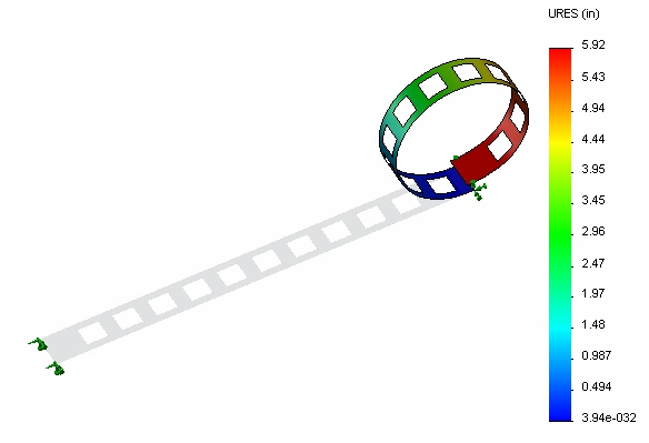

Figure 1 shows an elastic beam with a force F load that acts normal to the axis of the beam at all times. The graph between F and the vertical displacement y represents the actual nonlinear displacement, which occurs because of geometric nonlinearity. This means that because of significant changes in the geometry of the structure as it deforms, the deflection y is not proportional to the applied force F.
In Figure 2, the contact area between the bodies increases as the load F increases. Unlike the first example in Figure 1, the displacements and the strains are significantly smaller here. Nevertheless, the problem is nonlinear because of the change in contact surface area.
SOLIDWORKS Simulation solves nonlinear problems in several steps by updating the tentative solution after each step and repeating the procedure until satisfying a convergence criterion. The application of loads occurs gradually in each step, and an iterative procedure is used to ensure that the equilibrium conditions are satisfied. Therefore, every load step is a separate linear analysis by itself!

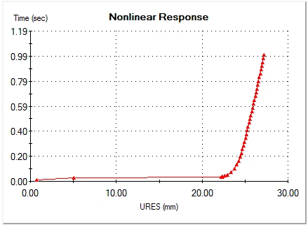

a) Time Increment
i) Nonlinear static analysis
General considerations
What you need to know about the time increment (time step) in nonlinear static analysis:
  • It is pseudo time
  • Time steps control the loading increment and the solution steps
  • If the time step size is too large just prior to a difficulty in a solution (change in stiffness or behavior), then then analysis may fail
General recommendations

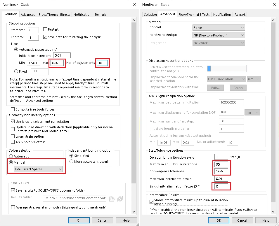

In general, it is better to use the default Automatic (autostepping) option. This is because the optimal time step size may vary throughout the solution process depending on local singularities, changes in loads, and other nonlinearities. This option gives the solver the freedom to adjust the step as necessary to smoothly get through any points in time where the solver encounters convergence difficulties.

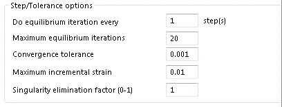

If you encounter convergence issues in the first few steps, the following change can help:
  • Decrease the Initial time increment. As an example, instead of the default value of 0.01, try 0.001.
If you encounter convergence issues in later steps, the following change can help:
  • Decrease the Max time increment. For example, instead of the default 0.1, you might want to change the value to 0.05 or even 0.01.
Please note that making these changes will most likely significantly increase the total number of steps and the size of the result data (.cwr) file. Therefore, the study will likely take more time to solve as well.
It is possible to limit the increase in solution time and result file size by using the Save data for restarting the analysis option in conjunction with the Restart option. For example, if you know that in a study with an end time of 1, there will be convergence difficulty requiring smaller and tighter time steps at t = 0.3, you can reduce the initial and maximum step sizes, making sure that the Save data for restarting the analysis option is active. After the solver gets past this time, you can cancel the analysis > return to the Study Properties > relax the time step settings somewhat > and enable the Restart option before continuing the run. This should cause the solver to resume solving from the last time step, now using the new changes to the stepping parameters.
The Min and No. of adjustments settings in the Automatic (autostepping) options are usually less helpful in resolving convergence issues. This is because by default, the minimum is equal to 1e-8. Increasing it will almost never help with convergence. Conversely, making it even smaller is also unlikely to help because if such minuscule time steps are necessary, then there are probably issues causing the analysis to fail regardless of the time step.
The No. of adjustments setting controls how many times in a given step the solver can retry the same step in a new iteration with a reduced time step. The actual "new" step that the solver chooses depends on the range that the minimum and maximum time step settings allow. By default, the number of adjustments is equal to 5, which should help the solver get through most issues. If the solver needs to adjust the time step more than 5 times in a given step, there are probably issues that adjusting the time step parameters cannot resolve. Sometimes, the issue is also that the time steps were too large just prior to this localized problem, and no amount of reduction in the time step at this point will help the solver move further. In this case, the recommended approach is to rerun with a decrease to the maximum time step. It can also help to use the Save data for restarting the analysis and Restart options as mentioned previously in this document.
Using the Fixed option is generally not useful except in certain cases. One reason to use this option might be if you need results at very specific times. However, be aware that if a time curve is applied for a load or restraint, any point in time specified in the curve will force the solver to insert a step at that specific time. This approach is a possible alternative to using the Fixed option. It is also possible to use the Save data for restarting the analysis and Restart options along with fixed time steps to closely control the analysis. However, this approach requires careful supervision of solver progress and can ultimately be time consuming and inconvenient.
Which settings should you try?
In the case of difficulties in convergence, adjusting some parameters can help. However, there are other parameters that you should not change.

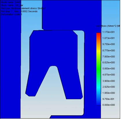

ii) Nonlinear dynamic analysis
For a nonlinear dynamic analysis, the time step value:
  • Is crucial
  • Must be constant (no autostepping)
  • Should be chosen using the following three criteria:
    • Time resolution of the highest important modal wave
    • Time resolution of the loading
    • Resolution of the shock wave propagation (optional)
The time step must be sufficiently small to represent the highest important modal wave correctly.
Ts ≤ 0.1 × Tmin
Where:
Ts = Max time step size (s)
Tmin = Period(s) of the highest important vibration mode
The time step must be sufficiently small to represent the load correctly.
Ts ≤ 0.1× Tload
Where:
Tload = Characteristic time of the load (duration for shock, period of oscillation, etc.)
Example: For a load that is a full sinusoidal cycle, you need at least 10 points to represent the curve correctly. 5 points is not enough, and 20 is a luxury that you may not be able to afford.
Time resolution of the shock wave propagation
The time step must be sufficiently small to represent the shock wave propagating along the model correctly.
Ts ≤ 0.1× LCharacteristic / Cl
Where:
LCharacteristic = Characteristic length of the model – the length along which the waves will propagate
Cl = Speed of sound (and of wave) in the material
Cl (steel) = 5900m/s
-> Ts max = 1.6 µs for a 100mm long steel plate
Spatial resolution of the shock wave propagation
The element size must be sufficiently small to represent the shape of the propagating shock wave correctly.
Es ≤ 0.1× Cl / f
Where:
Es = element size
f = load frequency. For a shock of duration d, f = 1/d
-> Es max = 4.72 mm for a steel plate and a shock duration of 4µs

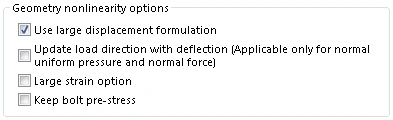

b) Geometry Nonlinearity Options
i) Uses the large displacement formulation.
Always keep this option ON.
ii) Update load direction with deflection
When active, the solver updates the direction of the applied load (only for normal uniform pressure or normal uniform force) for every solution step.
It is a requirement for loads like pressure caused by gas or liquid.
This option was previously available also for 2D simplification analyses until the release of SOLIDWORKS 2011 SP2.0, at which time it was removed and then reinstated in SOLIDWORKS 2013 SP2.0.
iii) Large strain option (for plasticity material models only)
Only activate this option if the expected strain is 5% or more, and only for the von Mises plasticity and Tresca plasticity material models.
Do not activate this option every time you expect large displacements.
This option only affects the formulation of bodies with the von Mises plasticity and Tresca plasticity material models.
The Drucker-Prager model in SOLIDWORKS Simulation is limited to the small strain formulation.
The hyperelastic models (Mooney-Rivlin, Ogden) always take large strains into account.
iv) Keep bolt pre-stress
Effective with the release of SOLIDWORKS 2017, a new Keep bolt pre-stress option appears in the Properties of nonlinear studies. With this option ON, the solver performs (for the first time step) a procedure similar to the one for static analysis, with two successive runs of the analysis:
a) The software applies the user-defined Pre-load value to pre-stress the Bolt Connectors. The analysis runs without any other load applied. Then, the tensile forces in the bolts are obtained and are compared with the pre-load values for each bolt.
b) Based on the difference between the tensile forces in the bolts and the pre-load value specification for each bolt, a new adjusted pre-load value is calculated internally such that when used in a new similar run, the new tensile forces obtained in each bolt will match the initially desired pre-load.
c) The analysis is run once again with all the loads and the internally adjusted pre-load for each Bolt Connector.

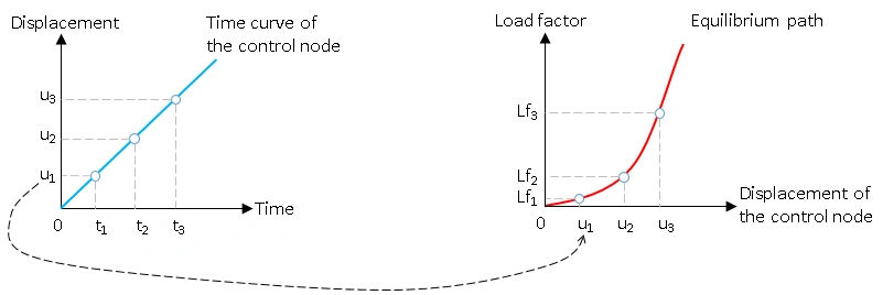

d) Control Method
i) Summary
All three methods consist in ultimately applying the loads that you defined in the study. The methods differ in how they incrementally apply the loads, and in the limitations inherent to each method.

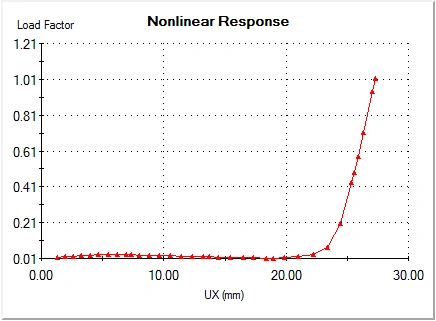

Many analyses presenting some kind of buckling may fail using a nonlinear study with Force control once the simulation reaches the onset of buckling. This is because the force control method is somewhat sensitive to localized instability, which often occurs with buckling. Force control is still suitable to detect the occurrence of buckling, but not to simulate the buckling phenomenon itself.
In general, to simulate the buckling phenomenon itself, the Arc-length control method is preferable.
The Arc-length control method is not available for models with prescribed displacement. The Displacement control method then becomes the preferred method. The Displacement control technique can go through the snap through region and provides the buckling load factor and the load factor vs displacement curve like the Arc-length control technique.

ii) Detailed explanation of the Displacement control technique
In the Displacement control method:
  • The Variation with Time (Linear or Curve) of the loads does not play any role. Only the load value matters. During the simulation, at each increment of the solution, the solver applies the same load factor to all the loads.
  • In Properties > Advanced tab > Displacement control options, you define a location (the control node), a direction of displacement and a time curve. All together, these inputs determine both the incremental and final displacement of the control node.
    Note: It is customary to use a linear curve so that the displacement is proportional to time. This makes the results more readily understandable.
  • The solver follows your Displacement control options: At each increment of the solution, the solver increments the time in the displacement curve of the control node. Then the solver determines what value of the load factor corresponds to that displacement value. In doing so, the solver also calculates the displacements and stresses in the model.
  • The solver uses the Stepping options you defined in Properties > Solution tab to increment the time value and to determine the finish condition for the simulation.
Limitations:
When you use the Displacement control method:
  • You can only have Contact interactions of the Surface to surface type of Contact formulation.
  • You can only use the Intel Direct Sparse solver (or the Direct Sparse solver).
  • There cannot be any prescribed displacement in the study.
  • It is impossible to apply loads sequentially.

In a response graph
It is possible to create a Time History Graph showing the variation of the Load Factor as a function of the Displacement of the controlled vertex:
From the Response Graph dialog box, click File, Save As... to save the data points of the curve as a .CSV file.

To determine the limit load for the snap-through buckling, follow these steps:
  1. Right-click the Results folder.
  2. Select Define Time History Plot.
  3. Select to plot the Load Factor versus the Displacement of a meaningful node.
  4. Determine the limit value of the load factor from the response plot as the loading at which the system starts to snap-through.
  5. You can obtain the actual limit loading of the system by multiplying this load factor with the pattern of the applied loads.

e) Step/Tolerance Options
For information about fine-tuning analysis options for better convergence in the case of convergence problems, see section 7)b)iv).
i) Do equilibrium iteration every [number] steps
Sets the frequency of performing equilibrium in the number of solution steps.
Always leave the default value of 1.
ii) Maximum equilibrium iterations
Sets the maximum number of equilibrium iterations for any solution step.
The default value of 20 is generally sufficient.
The solver automatically increases the value by 5 if it estimates this could be helpful.
iii) Convergence tolerance
Relative displacement tolerance used for equilibrium convergence.
Default value is 0.001 = 0.1%. If difficulties arise, you may either decrease or increase the value. However, the value should not be larger than 0.01 = 1%. Use of larger values will compromise the accuracy of results.
iv) Maximum increment strain
The Maximum incremental strain sets the tolerance for strain increment for models with creep or plasticity.
It is mainly useful for small strain analysis (assuming linear summations between two consecutive steps).
The thing to remember is that if you can get a solution using a number higher than 0.01, either the problem has been resolved throughout iterations, or it may involve some local instability while the overall solution is ok, otherwise convergence would not be reached.

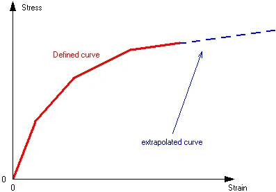

Extrapolation of the stress-strain curve after the curve's last data point: for plasticity or non-linear elastic material definition, it takes the last couple of data points and uses that to extrapolate linearly

iv) Nonlinear analysis options
Try the following suggestions only when difficulties remain after trying the previous troubleshooting techniques.
  • The following settings have proven successful in many cases:
  • Reduce the step size or use autostepping:
    • If there are convergence issues in the first few steps, decrease the Initial time increment value. For example, try using a value of 0.001 instead of the default value of 0.01.
    • If there are convergence issues in later steps, decrease the Max time increment value. For example, instead of the default value of 0.1, you might want to change it to 0.05 or even 0.01.
  • Change the solution control method. When contacts are not considered, try switching to Displacement control and monitoring when load factor is 1. This is useful when the solver detects limit state of buckling behavior. You can detect this type of behavior by displaying a response graph of displacement vs time for nodes with large displacements. A vertical tangency when the analysis fails indicates a local buckling. You can overcome a local buckling by using the Displacement or Arc-Length controlled methods.
  • Slightly increase Convergence tolerance (no more than 0.01) or the Maximum incremental strain (no more than 0.05).
  • Adjust the Singularity Elimination Factor value (to 0.5 or 0 for maximum effect).

Try not to change the tolerance values such as:
Convergence tolerance (default = 0.001)
Maximum incremental strain (default = 0.01)
For small strain analysis, a smaller Maximum incremental strain may improve accuracy. However, sometimes during equilibrium iterations, the strains may go higher until reaching the time convergence, where it then reduces.
