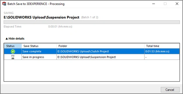

Batch Save to 3DEXPERIENCE
The Batch Save to 3DEXPERIENCE tool is available from the SOLIDWORKS Design Tools menu. This is an automated, asynchronous tool that has the same secure upload capability as the Save to 3DEXPERIENCE command. It provides the ability to save SOLIDWORKS files from multiple folders into various collaborative spaces and bookmarks in a single operation.
The Batch Save utility is suited to large datasets that contain multiple projects with a datasize <5GB. Once a Batch Save is underway, the tool will run asynchronously in the background, enabling the user to continue working in their SOLIDWORKS session.
