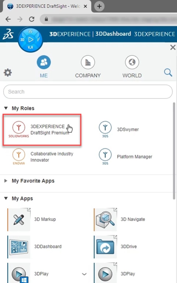

 2. To install DraftSight Connected, click on the Compass to show your Roles and Apps. Under My Roles, select DraftSight Premium and then click on the DraftSight app.

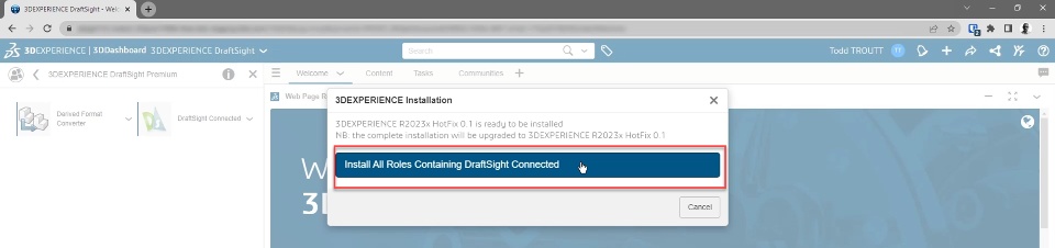

 3. If this is the first platform app you’ve installed, it will ask you to download and then install the 3DEPXERIENCE Launcher. That’s the basic application that is needed to start all your installed apps.
Once the launcher is installed, you can click continue to install DraftSight.
Select the option to install all roles containing DraftSight.

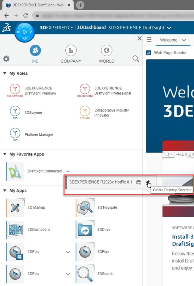

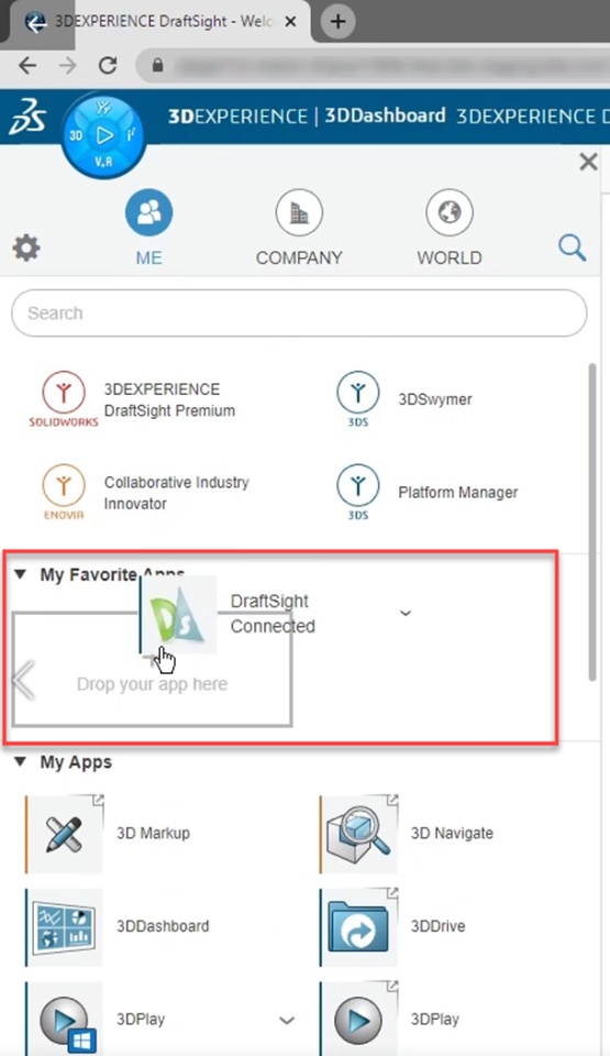

 6. To add it as a favorite, click on the Compass and scroll down to find the DraftSight app under My Apps. Drag and drop it to the My Favorite Apps section for easy access.
 7. You can also add a desktop shortcut by clicking on the dropdown arrow of the app and selecting Create Desktop Shortcut.
