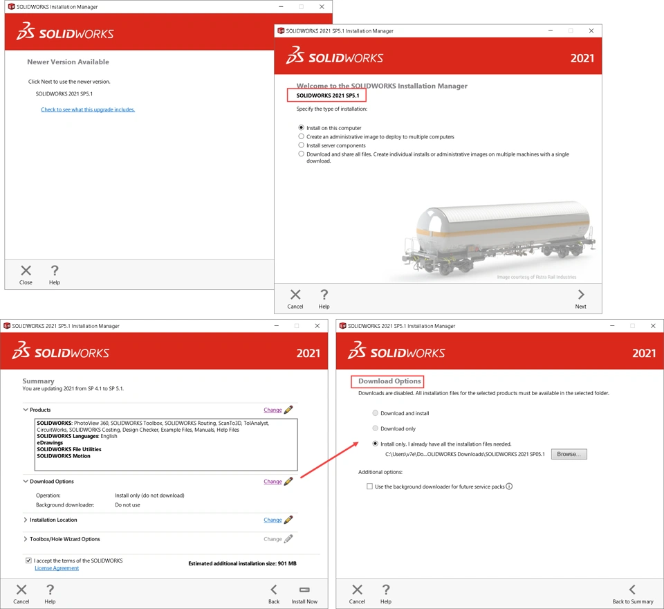

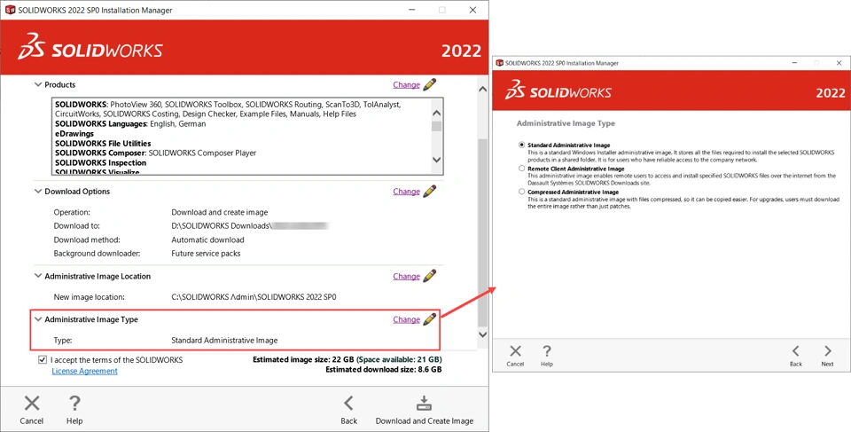

5) Upgrade Installation Files
Users can obtain all the latest installation files by using the SOLIDWORKS Installation Manager. The Installation Manager software is available from the SOLIDWORKS download page by clicking the on the SOLIDWORKS version that you need. You should use the Installation Manager to manage all download, installation, and upgrade processes and to ensure successful download and installation of all necessary files. This applies to both SOLIDWORKS Installation Manager individual installations and administrative image installations.
For command line or Active Directory® based installations, SOLIDWORKS recommends that you use the Installation Manager to download and create administrative images. These images will include any requisite components as well as the SOLIDWORKS installation files.

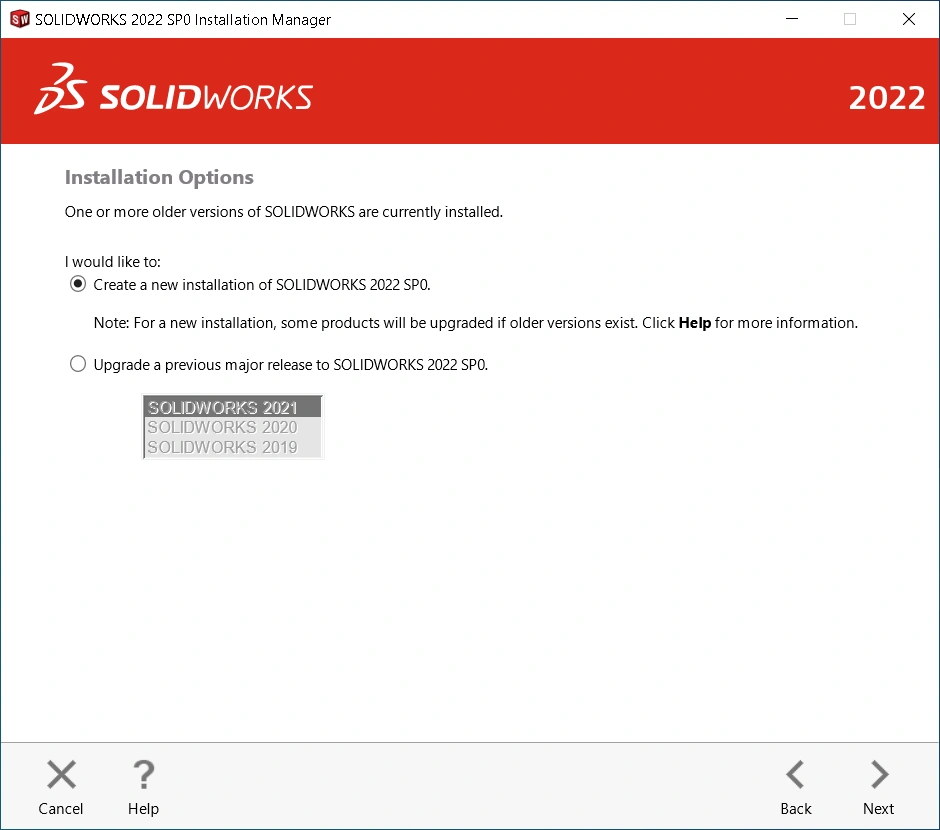

6) Preparing Client Machines for Upgrade
One or more older major versions of SOLIDWORKS are installed on this computer. You can create a new installation, which will coexist with the older version, or you can upgrade, which removes the older version (see Figure 4).
Figure 4: Installation options
a) Create a New Installation of SOLIDWORKS version.
If you choose to create a new installation, you can select which SOLIDWORKS products to install.
For each of the selected products, a new installation of this major version is created. The older major versions remain on the machine, except for SOLIDWORKS Electrical and SOLIDWORKS PDM Client.
If you clear a product, the new version does not install.
Create a new installation is useful if you want to access the older version of SOLIDWORKS after the newer version is installed. For example, if you are sharing files with other users who are still running the older version, you can avoid version incompatibility with files saved using the newer version.
b) Upgrade SOLIDWORKS previous_major_version to SOLIDWORKS 2022 current_major_version.
If you choose to upgrade, you can select which SOLIDWORKS products to upgrade. For each of the selected products, a new installation is created, and older versions are removed.
If you clear a product, the new version does not install, and the older version remains on the machine.
Whenever possible, users should keep the latest version of SOLIDWORKS on the client machines. If this is not possible, make sure that the client machines apply upgrades to the version-specific directories. If a current installation is on a machine that will no longer be used, the following information can help clean up the client prior to a new installation.

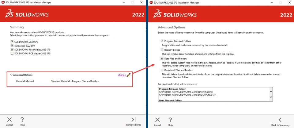

c) Uninstalling Individual Installation
To properly uninstall all previous installation files, go to Control Panel > Add or Remove Programs (or Programs and Features) > select the appropriate version of SOLIDWORKS > and then select the ‘Uninstall’ option. For a more complete uninstall, users may select the ‘Change’ option in the Advance Options menu of the Installation Manager. Select all of the check boxes to perform a more complete uninstallation (see Figure 5).
Figure 5: Advanced options for a complete uninstall
d) Uninstalling Administrative Image based installation
Similar Uninstall operation can be performed using Administrative Image Option Editor (see Figure 6).
Figure 6: Administrative Image Option Editor - Advanced options for a complete uninstall

Newer Version Available
SOLIDWORKS Installation Manager has detected a newer version of SOLIDWORKS products. You can update to a newer version by selecting the SOLIDWORKS Installation Manager for that version.
This newer version can download installation files based on the products you specify in the installation. You can share the downloaded files with other users who install using SOLIDWORKS Installation Manager.
Note: These downloads are only for use by SOLIDWORKS Installation Manager.
These options are available:
  • If there are multiple versions available, you can select a version from the list.
  • For details about this version, click Check to see what this upgrade includes. (see Figure 7 and Figure 8).
Note: Clicking Next obtains and runs the selected version of SOLIDWORKS Installation Manager.
Figure 7: Check for Updates – Updating a service pack
Figure 8: Check for Updates – Updating major version
To enable automatic periodic checks for updates, when SOLIDWORKS Installation Manager completes its processing select Check for Updates every __ days and specify the frequency of checks.
No New Downloads Available/Unable To Check for New Versions
SOLIDWORKS Installation Manager has not found a newer version of SOLIDWORKS products, either because you are installing the latest version available or because it could not connect to the SOLIDWORKS site to check.

iii) Administrative Image Types
In the Administrative Image Option Editor, administrators can create a standard image, a remote client administrative image, or a compressed administrative image (see Figure 9).
Figure 9: Administrative Image Option Editor - Administrative Image type
  1. Standard Administrative Image
    This image is a standard Windows Installer Administrative image. All files required to install the selected SOLIDWORKS products are uncompressed into a shared folder.
  2. Remote Client Administrative Image
    The remote client administrative image helps remote users who cannot reliably pull an installation from a shared image folder on the company network. When installing this type of image, remote users inherit all the installation options you specify, such as the serial number and the products to install. Remote users download these images from the Dassault Systèmes SOLIDWORKS download site. Accessing and installing these files from the internet is more reliable and may reduce the load on company networks. Remote users install this image using the same techniques supported by the standard administrative image. Administrators who script installations using sldim.exe or startwinstall.exe can still push them from a remote client administrative image. Before installing, installation files download to a path specified in the Administrative Image Option Editor.
    Installing from a remote client administrative image requires more disk space since the client machine stores the download and installation files. Users can delete the download after the installation completes. Please note, to start installing, remote users must still connect to the admin image folder and run any batch or settings files hosted there.
  3. Compressed Administrative Image
    The compressed administrative image is for organizations that copy images to multiple sites or client machines as part of their install process. This image is 60% smaller than a standard administrative image. Installations from a compressed administrative image take the same amount of time to install as a standard image. All install operations, such as modify and repair, are supported. Compressed administrative images also have shorter file paths, which help to avoid problems when hosting an image stored in deeper folder structures.
    A limitation of the compressed administrative image is that when you upgrade it to a new service pack, it requires that you download all the installation files. When you upgrade a standard administrative image to a new service pack, you can download and apply smaller patch files instead.

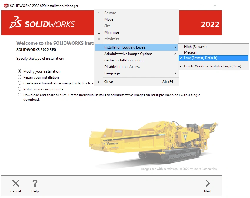

a) Installation Manager based individual deployment
Single user environments can simply activate the Create Windows Installer Logs option from the right-click context menu in the Installation Manager (see Figure 10).
Figure 10: Enabling verbose installation logging
This will create a verbose installation log. By default, the verbose installation log exists in the following folder:
%appdata%\\SOLIDWORKS\\Installation Logs\\[version]
