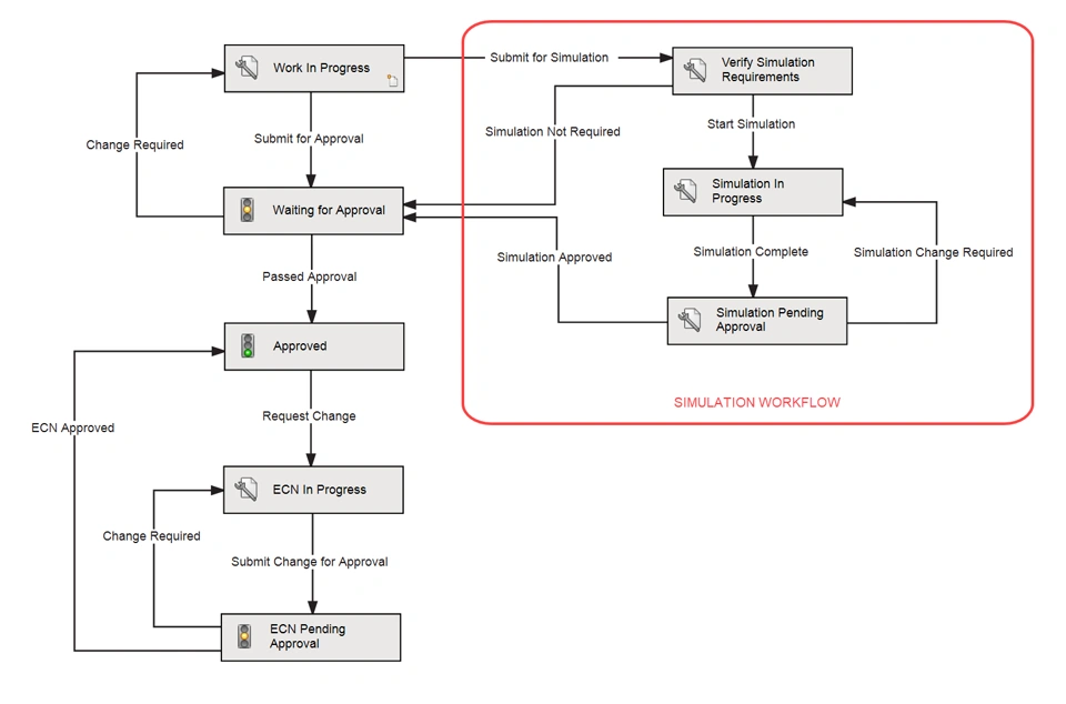

The simulation workflow now becomes a branch of the main engineering workflow. The result of this being that we can now not only manage, but also share simulation methods across cross-functional departments. This leads to improvements in reliability, consistency, and communication. Figure 5 illustrates a skeleton of how an entire engineering workflow with the integrated simulation workflow might look. Figure 6 illustrates a close up detail on the simulation workflow.
Figure 5: Skeleton of an engineering workflow including simulation workflow
Figure 6: Simulation workflow branched off the engineering workflow

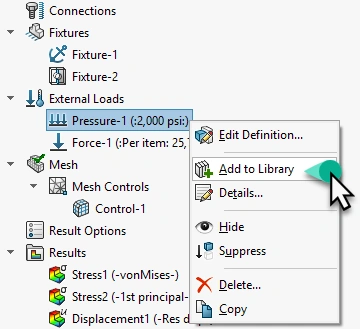

Another way the simulation engineer can reuse simulation data is a smart Analysis Library feature managed in SOLIDWORKS PDM. Some of the CAD integrated simulation tools offer this technology. Figures 11 and 12 show how this might work in the SOLIDWORKS Simulation environment.
  • The simulation input such as a load or fixture is first saved to a folder that exists in the Analysis Library by using the Add to Library option.
Figure 11: Creating a simulation library feature

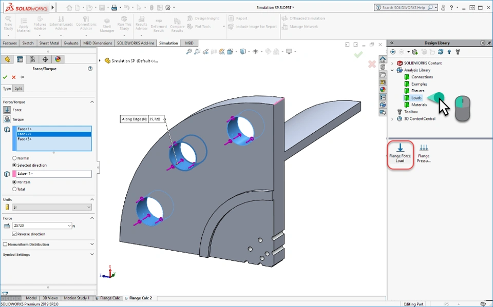

  • You can simply drag the analysis library feature and drop it into the CAD graphics window. The appropriate properties dialog box then opens with a pre-defined load and all that needs to be done is to complete the geometry selections. Figure 12 shows an example of the application of a force load analysis library feature on a flange design.
Figure 12: Reusing a simulation library feature using drag and drop
Simulation library features serve as templates and are a great means of enforcing standard simulation guidelines and best practices as set forth by an organization. Most importantly, intelligent simulation data now has become a knowledge base that can be reused anytime, anywhere, and by anyone in an organization.

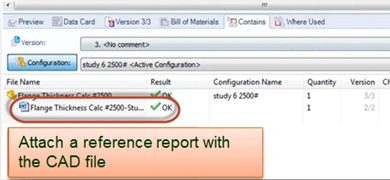

After completing a simulation, the simulation engineer can create additional supporting documents such as reports and videos and integrate those documents into the simulation workflow process as well. Figure 14 shows a simulation report referenced with the CAD file used for the simulation.
Figure 14: A report file referenced with CAD file in data management system

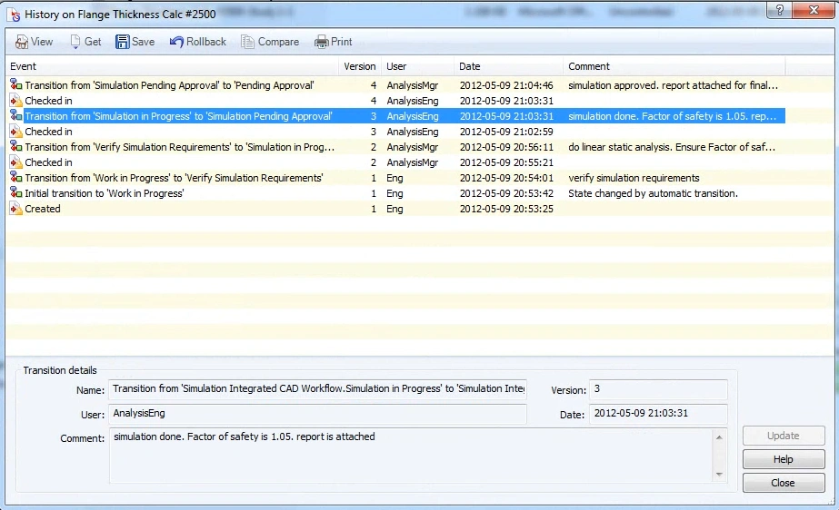

Figure 16 illustrates the simulation workflow history as recorded by the data management system. All information and activity from the initial stage through the final stage of the workflow is tracked and monitored, thus addressing the 5Ws of simulation data management.
Figure 16: Simulation workflow history
