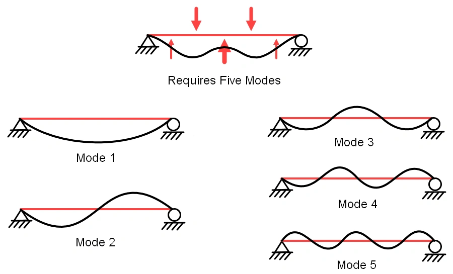

In many scenarios, it is mainly the lower frequencies that dominate the response of a structure, with higher frequencies being ignored. However, to get a better measure of the frequencies that you might need to consider in an analysis, you can use the mass participation factor.
The mass participation factor in a frequency analysis is the expected contribution of each frequency mode to the kinetic energy of the structure in a particular direction. The total participating mass in the direction of motion is equal to the total participating mass of the structure.
In general, a ratio of 80% in each of the three directions is indicative of a reasonable solution accuracy. In addition to the number of modes included in the frequency analysis, the mass participation will also depend on factors such as:
  • The model geometry
  • The components materials
  • The connections between components
  • The interactions between components
  • How the model is restrained
This mass participation factor is used to approximate the adequate number of modes to include in the dynamic analysis. A higher value is better than a lower value. However, an 80% value does not necessarily guarantee that all important modes are included. You must be sure that the mesh is fine enough to properly discretize the model, and that the mass in regions of interest adequately participates in the included frequency modes.
In some cases, depending on the restraints or geometry, a value of 80% might be impossible to reach. For example, if the analysis includes base or ground components, the base plate may be much stiffer and heavily restrained than the other components. Often, base components may even be fully fixed. This would result in high natural frequencies which may be difficult to resolve and would typically fall outside the frequency range of interest.
If such a base component contributes significantly to the overall mass of the analysis model and its associated modes are not important, then you can expect a mass participation lower than 80%, even with all important modes included. If you are unsure if this is the case, you may run tests that exclude base components and replace them with appropriate fixtures. This type of test can provide a sense of how much the base components affect the overall mass participation.
It is also a good practice to re-run the analysis with a finer mesh and higher number of modes to verify that the results are converged.

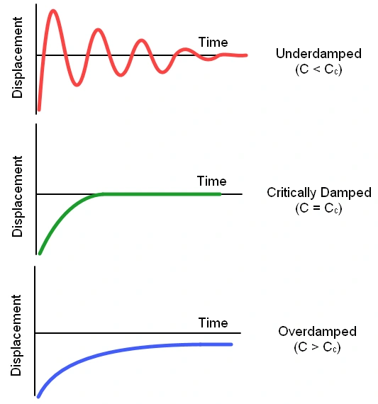

In a damped system, there is a critical damping value at which the system converges to zero in the minimum amount of time. If the system is underdamped, the system will oscillate with decreasing amplitude before returning to zero. Overdamped systems will not exhibit oscillations, but takes longer than the optimal time to return to zero. Figure 3 depicts that in both the underdamped and overdamped cases, the system takes longer to reach equilibrium than the critically damped system.
Figure 3: Underdamped, critically damped, and overdamped systems
The SOLIDWORKS software supports two types of damping: Rayleigh damping and modal damping. For Rayleigh damping, the damping matrix is a proportional combination of the mass and stiffness matrices where:

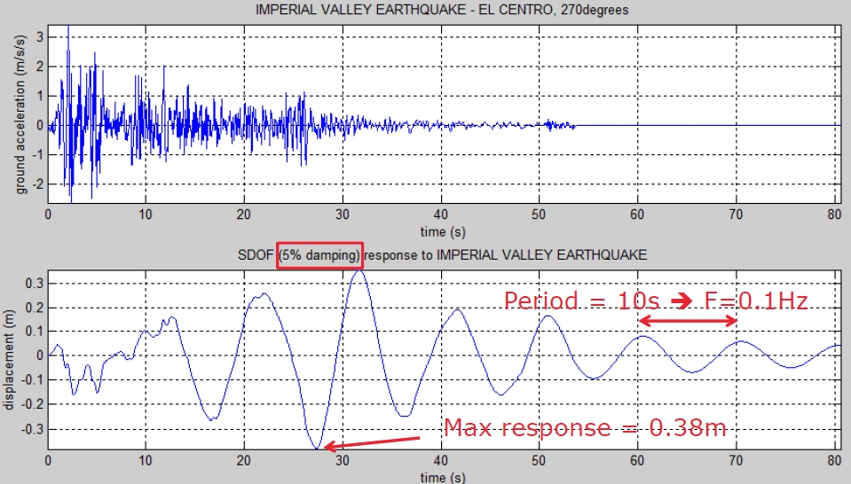

Random vibration studies determine the response of structures due to random (nondeterministic) excitations described by power spectral density (PSD) functions versus frequency. This study type can represent loads such as:
  • Base accelerations generated by earthquakes
  • Loads generated on a car wheel traveling on a rough road
  • Pressure generated by air turbulence
  • Pressure from sea waves or strong wind
The analysis calculates the root mean square (RMS) and PSD response to the PSD excitations.

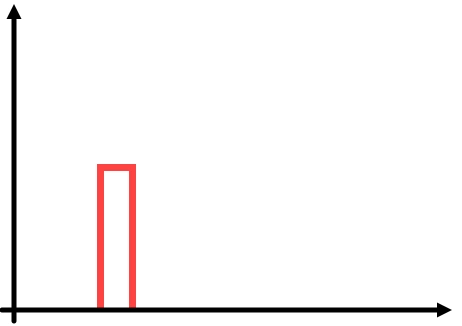

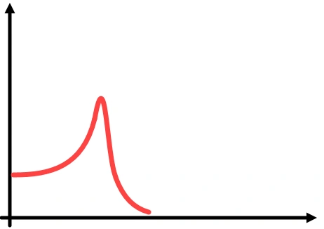

Random processes are often identified by the shape of their PSD functions.
Figure 4: Example of random processes in time and frequency Domain
 F(t)PSD(ω)
Sinusoidal
Narrow-Band
Wide-Band
Ideal White Noise

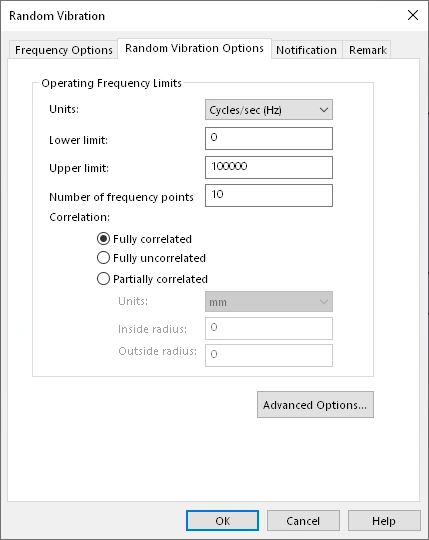

When setting up a random vibration study, in addition to determining the number of modes to include in the analysis, you must also define the operating frequency limits within the Random Vibration Options tab of the study properties.
The options within the Random Vibration Options tab allow you to set the exciting frequency range that the solution considers in its analysis by setting the lower limit and upper limit frequencies. For example, if the exciting frequencies extend above the default Upper limit frequency value, you must manually input an appropriate value that will cover the range of frequencies to consider in the analysis.
Within the Random Vibration Options and its Advanced Options tab you can also adjust options which set determine the number of frequency points to be selected between adjacent natural frequencies, as well as the biasing parameter which controls the selection of frequency points for integration.

Response spectrum analysis studies determine the maximum response of a structural given a specified input spectrum. This study can simulate problems with random or shock base excitations. The input is a response spectrum that provides the maximum response of a single degree of freedom (DOF) system vs. natural frequency. The output is the overall peak response due to the input excitation. Although the excitation is a function of frequency, this output response is neither a function of frequency nor time.
The input is a curve of maximum responses of single DOF systems of different natural frequencies to the same base motion. In practice, you would start with the transient acceleration loading as shown in Figure 5. This excitation would be applied onto a single degree of freedom oscillator that has some mass and stiffness that we know the natural frequency for. The peak response of this system is measured, which makes one data point for the response spectrum. This is repeated so that the peak response is plotted for a range of single degree of freedom systems so that you have the peak response as a function of natural frequency. An example single DOF system response to an excitation is shown in Figure 5.
Figure 5: Single degree of freedom response to an Imperial Valley earthquake excitation
Damping effects are taken into account in the input response spectrum by incorporating damping effects into the single DOF systems themselves. Different spectrum curves are usually available for different values of modal damping ratio of the single DOF system. Otherwise, it is customary to use a damping ratio of 5%, which is the normal damping ratio of most buildings.

    • In dynamic problems under the influence of base excitations, usually the number of modes considered must contribute to a total mass participation factor of at least 80% of the system mass in the direction of the base motion.
    • For harmonic and random vibration problems, in addition to the 80% mass participation factor requirement, the range of natural frequencies considered for analysis must cover the highest frequency in the excitation.
    • In the case of systems under the influence of force excitations, it is essential to consider all modes that contribute to the static deformation shape of the structure.
    • These are simply guidelines, and do not guarantee the inclusion of all important modes. Carefully analyze the problem setup and obtained results to determine if all important modes have been considered.
