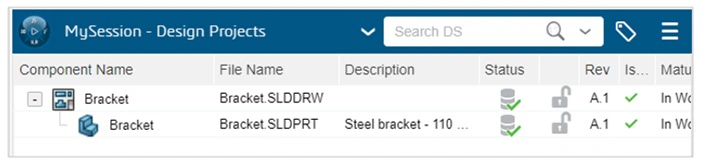

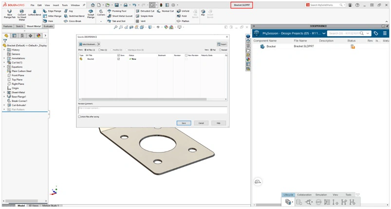

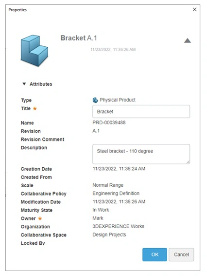

In the image below, a SOLIDWORKS part called Bracket.sldprt is saved to the 3DEXPERIENCE platform for the first time.
The resulting Title is “Bracket”, and the ENOVIA Description field has been used to capture a detailed description of the part.

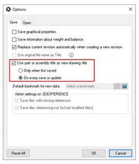

When creating a new drawing, the Title of the parent part or assembly can be used as the new drawing Title. This is the default behaviour, and provides a method of making a related drawing easily identifiable with its parent.
If you do not want the drawing title to match the title of its parent, the MySession option “Use part or assembly file as new drawing title” must be unchecked.

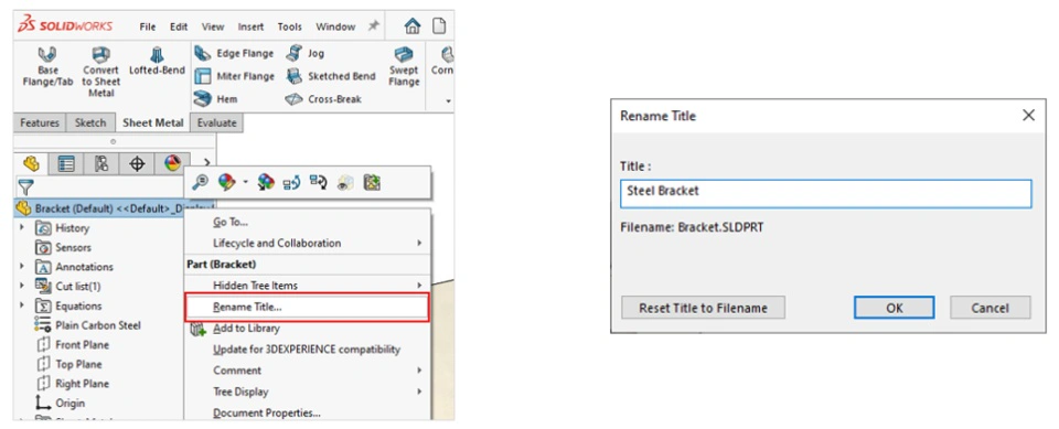

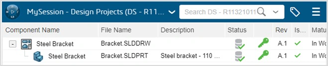

Once a Part, Assembly, or Drawing has been saved to the 3DEXPERIENCE platform, its Title can be modified from either inside SOLIDWORKS or in one of the web apps. For SOLIDWORKS users new to 3DEXPERIENCE, the most logical place to change a Title is in SOLIDWORKS. This is done by right-mouse clicking on the component name at the top of the feature manager design tree and then selecting “Rename Title” from the menu.
After the Title of a file has been changed, it must be saved to the 3DEXPERIENCE platform for the modification to be fully applied. If a part or assembly being renamed has a related drawing, the next time that drawing is saved to the 3DEXPERIENCE platform, the Title of the drawing will always update to match its parent, unless the MySession option “Use part or assembly file as new drawing title” has been unchecked or set to “Only When First saved”.
Note: The “Rename Title” command does not change the file name on disk. Once a part, assembly, or drawing has been saved to 3DEXPERIENCE, its file name is fixed and cannot be changed. From this moment onwards, the Title is used as the primary identifier.Defining the Title Manually – Summary

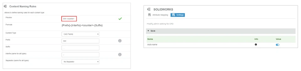

When choosing to adopt a manual naming strategy, by default, SOLIDWORKS Design does not block the saving of an item with a Title that is a duplicate of an existing item in the database. However, to ensure that every file saved to the 3DEXPERIENCE platform has a unique title, a SOLIDWORKS setting in the Collaborative Spaces Configuration Center called “Check File Title for uniqueness” can be enabled. This option can be set to either just warn a user if the Title is already in use (user can still save with a duplicate Title) or to block the save to 3DEXPERIENCE operation.
Avoiding duplicate names is often one of the fundamental reasons a company will adopt a PDM/PLM solution. If this is a requirement, the “Block Save” option should be enabled by the platform administrator or one of the alternative item naming methodologies adopted instead.

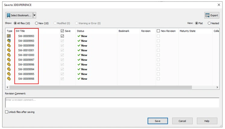

Working with sequential naming turned on, when a user saves new files to the 3DEXPERIENCE platform from SOLIDWORKS Design for the first time, each Title is automatically populated with the next sequential value generated by the CAD Family object “Content Naming Rule”, e.g. SW-00001, SW-00002, etc. A platform administrator defines the content naming rule using the Collaborative Spaces Configuration Center. The naming rule must always contain a counter in combination with one or all of the following: prefix, suffix, and interfix. Once the naming rule has been defined, the automatic naming behaviour for SOLIDWORKS can be enabled (or disabled) using the Auto-name option in the SOLIDWORKS settings panel.

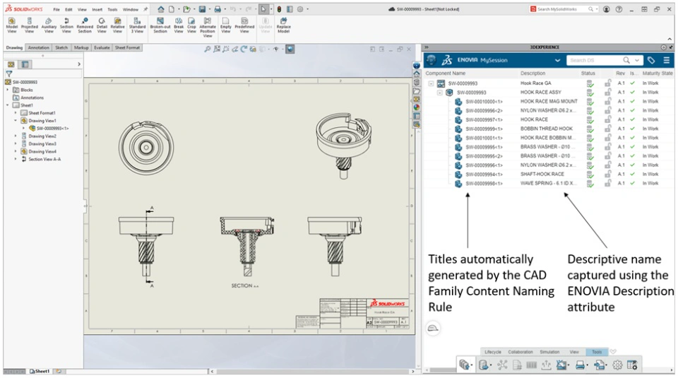

The following example shows the process of saving a drawing and its referenced assembly to 3DEXPERIENCE for the first time with Auto-naming turned on.
1. A pre-existing drawing called Hook Race.slddrw, and its referenced assembly Hook Race.sldasm are saved to the 3DEXPERIENCE platform for the first time.
2. The CAD Family Content Naming Rule generates new and unique Titles for each file.

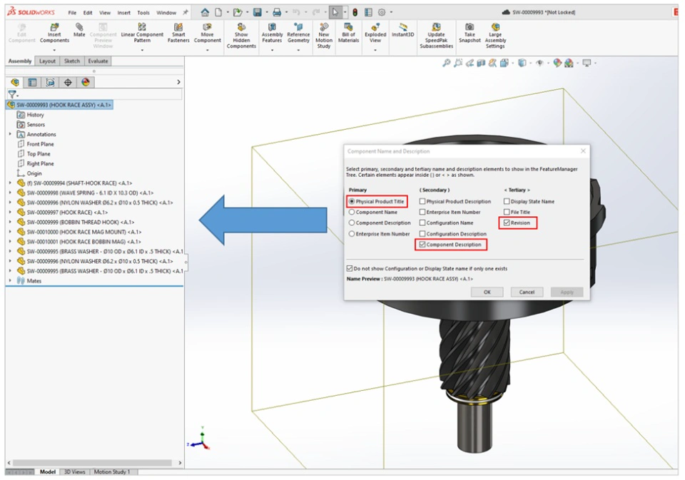

3. After the save operation is complete, the new Titles are displayed in the MySession task pane and in the Feature Manager Design Tree.
4. For quick and easy identification, using the Tree Display setting for Component Name and Description, the information displayed in the Feature Manager for each component can be configured to show both Title and Description, or Description only.

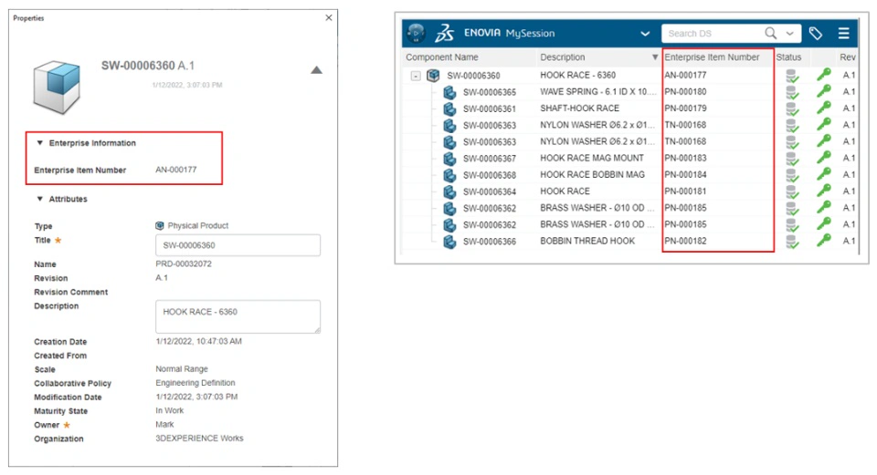

An EIN can be assigned to parts and assemblies; this can be done either in SOLIDWORKS Design via the MySession Tools toolbar or by using the Engineering Release app (SOLIDWORKS PLM Standard or Product Release Engineer Role) in a web dashboard.
Once an EIN value has been assigned to a part or assembly, it can be viewed via ENOVIA Properties dialogue, and by adding the EIN column to SOLIDWORKS MySession, and web apps (for example, Bookmarks Editor and Product Explorer).
An EIN can only be assigned to a part or assembly once it has been saved to the 3DEXPERIENCE platform and the resulting Physical Product has been created. Some organizations will not want to, or need to, assign item numbers until a design reaches a certain level of maturity. However, many companies want to ensure that each file being saved to the 3DEXPERIENCE platform has a unique Title. Therefore, in this scenario, automatic naming could be used to generate unique Titles for each file when they are saved to 3DEXPERIENCE for the first time. The EIN for each Physical Product could then be assigned later, when the design reaches a chosen level of maturity.
Tip: Once EIN’s have been assigned to components in an assembly structure, for greater clarity, a user can switch their SOLIDWORKS Feature Manager display to show only EIN and Description, instead of the automatically generated Titles.
