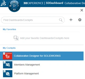

When a SOLIDWORKS Design role is assigned to a user, a corresponding user dashboard of the same name is also created. This role-themed dashboard presents all of the necessary features required for a SOLIDWORKS user to be instantly productive the moment that role is assigned to them.
The role-themed dashboard will appear under “My Cockpits".​​​​​​​
