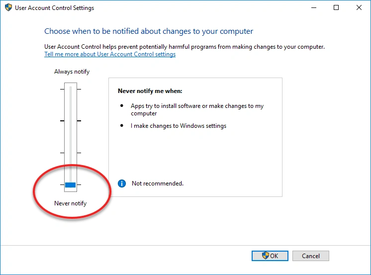

3) Turn Off User Account Control (UAC)
  • Press the Windows key, type User Account Control settings, and then click the item when it appears in the results list.
  • In the User Account Control Settings dialog box, move the slider control to the Never notify level > click OK.

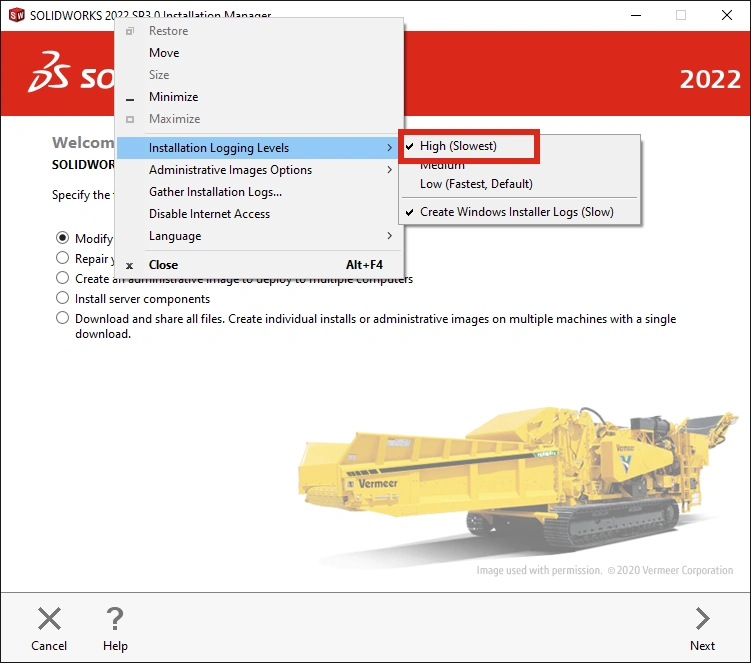

Right-click the SOLIDWORKS Installation Manager title bar, click Installation Logging Levels, and then click Create Windows Installer Logs (Slow). When active, this option creates installer logs that capture any issue during the installation.

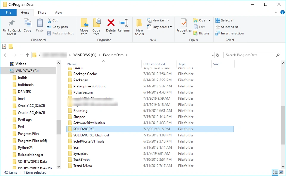

After uninstalling the SOLIDWORKS software, delete the following folders:
Note: It is always a best practice to back up program data before deletion.
C:\\ProgramData\\Solidworks

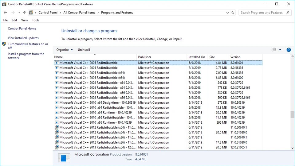

a) Uninstall the C++ Redistributable Components
Go to Control Panel > Programs > Programs and Features.
In the list of programs, uninstall all of the C++ Redistributable components.

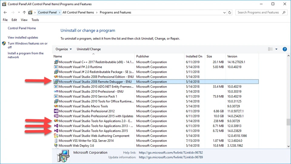

b) Uninstall Specific Microsoft Visual Studio Components
Uninstall the Microsoft Visual Studio Remote Debugger and Microsoft Visual Studio Tools for Applications programs indicated by the red arrows.

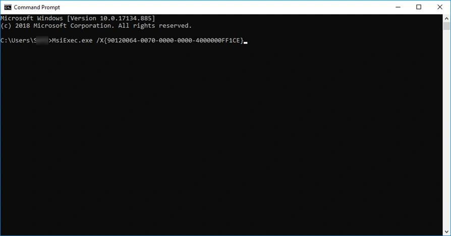

To uninstall the Microsoft Visual Basic 7.1 software, open a Windows command prompt, and then enter the following command:
MsiExec.exe /X{90120064-0070-0000-0000-4000000FF1CE}
The Visual Basic application does not appear in Programs and Features.

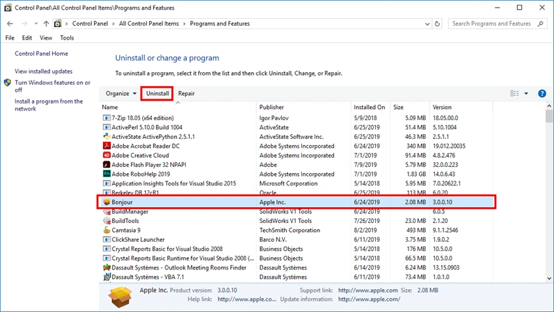

9) Uninstall the Bonjour Software
  • Go to Control Panel > Programs > Programs and Features.
  • Right-click the Bonjour program item > click Uninstall.
  • After uninstalling this item, restart the computer.

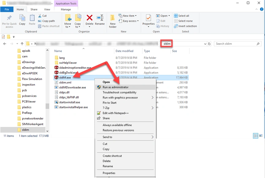

After installing all of the prerequisites, browse to the sldim folder and run the sldIM.exe program as administrator.
IMPORTANT! When the SOLIDWORKS Installation Manager appears, make sure that the Create Windows Installer Logs (Slow) option is active. To confirm this, right-click the SOLIDWORKS Installation Manager title bar, click Installation Logging Levels, and then verify that a check mark appears next to the Create Windows Installer Logs (Slow) option.
