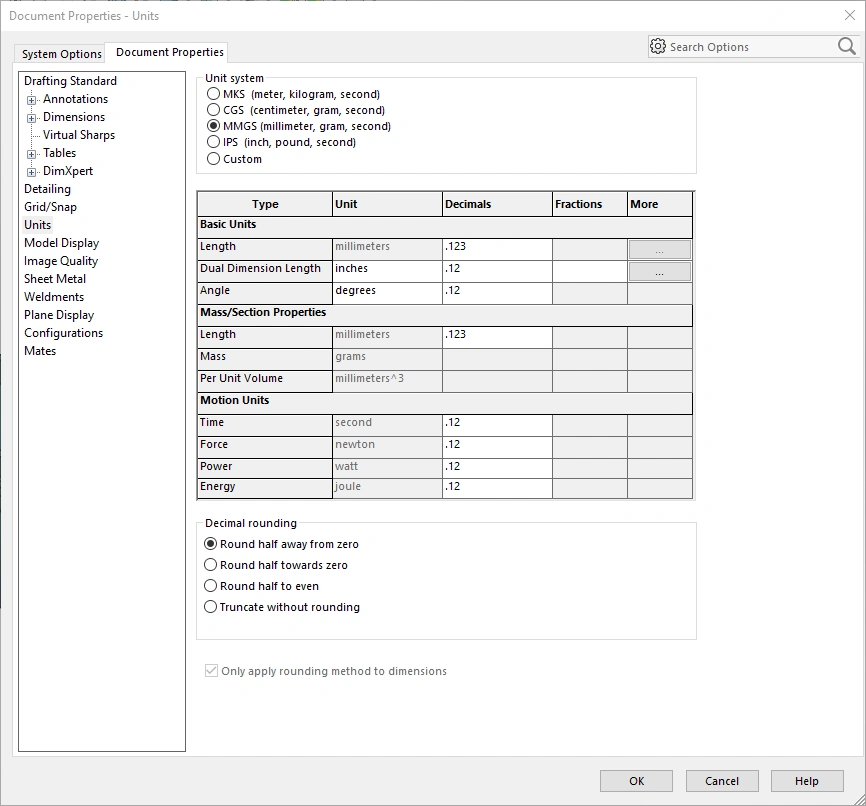

a) Specifying Units in Document Properties
There are several ways to change the units of your document. Any document, whether it is a part, drawing or assembly, can use its own unit system. To change these units, go to Tools > Options, and click the Document Properties tab. In the document properties, select the Units category. There are four default unit systems. You can also create a custom unit system. You use different units for Length, Dual Dimension Length, Angle, Mass, Volume and others. Refer to the following image.
Help Document: Units and Dimension Standard
b) Changing Units in Documents

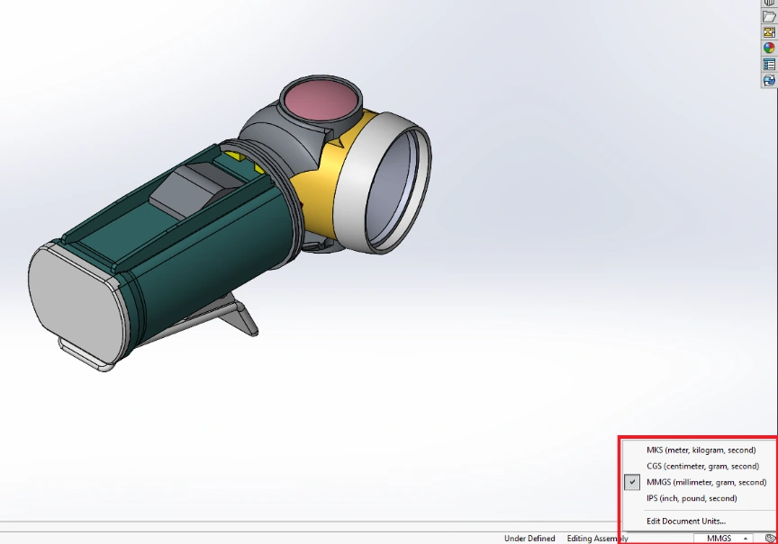

You can quickly access and change these options by selecting the units function on the right side of the status bar within SOLIDWORKS.

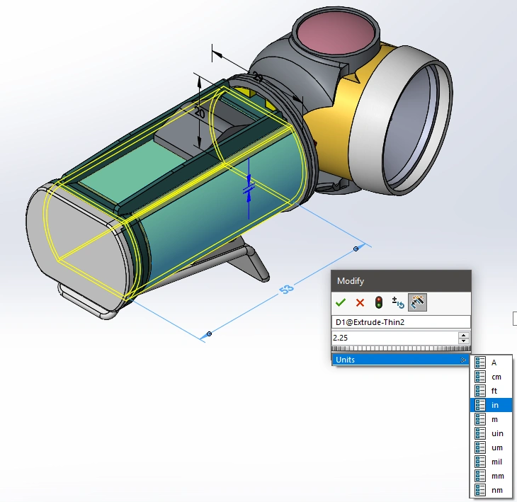

When you change units within a document, the physical size of dimensioned entities remainsunchanged. SOLIDWORKS converts the numerical value to the equivalent value in the newunit system. This can be particularly useful when specifying a dimension in a different unitsystem than the system used within the document. A user can simply enter the numericalvalue for that dimension, followed by the units. SOLIDWORKS then converts the dimensionto the unit system of the document.

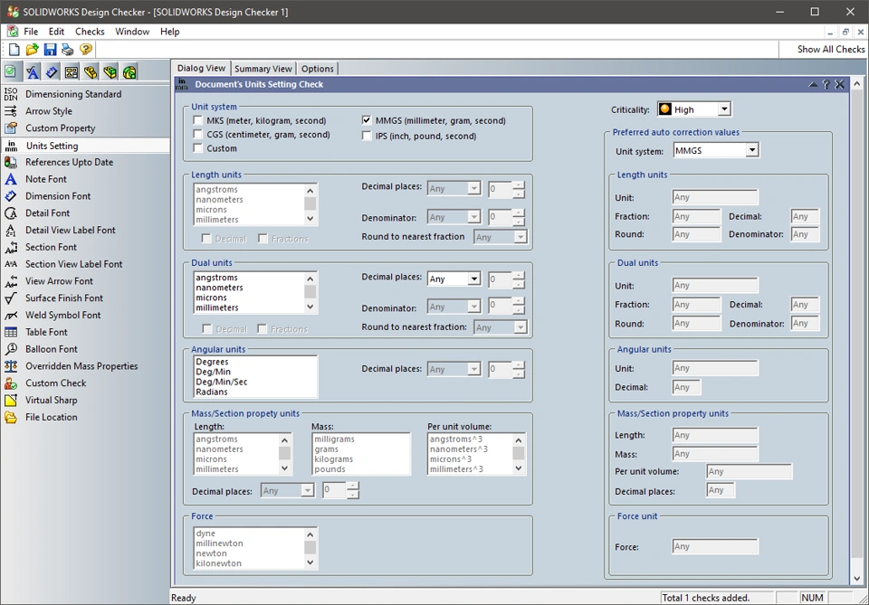

d) Checking Units with Design Checker
Even when using custom templates and a standard unit system, nonstandard units might still exist within a document. To look for these inconsistencies, SOLIDWORKS provides the Design Checker tool. This tool lists any nonconforming dimensions, and can correct the unit system automatically if you choose to do so.

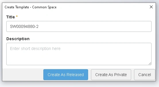

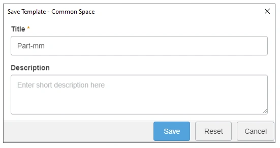

a) Creating Templates
As mentioned in the previous chapter, templates are a great way to store your specifications for unit systems. In addition, you can store any modifications to options within the document properties in a document template. This is a great way to prevent the need to make frequent changes to those settings. For drawings, templates can also save the choice of sheet format file.
It is a good practice to create custom templates for parts, drawings and assemblies. While you can use any file to create a template, it is typically best to start with a blank document.
To create a template:
  1. Open a new document.
  2. Change the Document Properties as required.
  3. Click Save As.
  4. For Save As Type, choose the respective template type from the list. You can select a part template (*.prtdot), a drawing template (*.drwdot), or an assembly template (*.asmdot).
Selecting a template file type automatically switches your save as location to the first folder in the Document Template folders in the File Locations options (Tools> Options > System Options > File Locations). You can reorganize the file locations to place the required folder at the top.

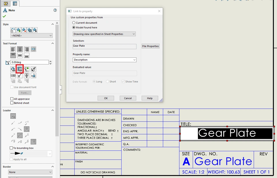

For drawing templates, SOLIDWORKS saves a file location for the sheet format within the template. The sheet format file contains the border, zone labels and title block for the drawing. Users can either create a sheet format from scratch, modify one of the default files for the sheet format that are included with SOLIDWORKS, or create a sheet format by importing an existing DWG or DXF file that uses an existing standard for your organization.
You can link items in the title block to custom properties, which makes it easier to populate a title block with properties.

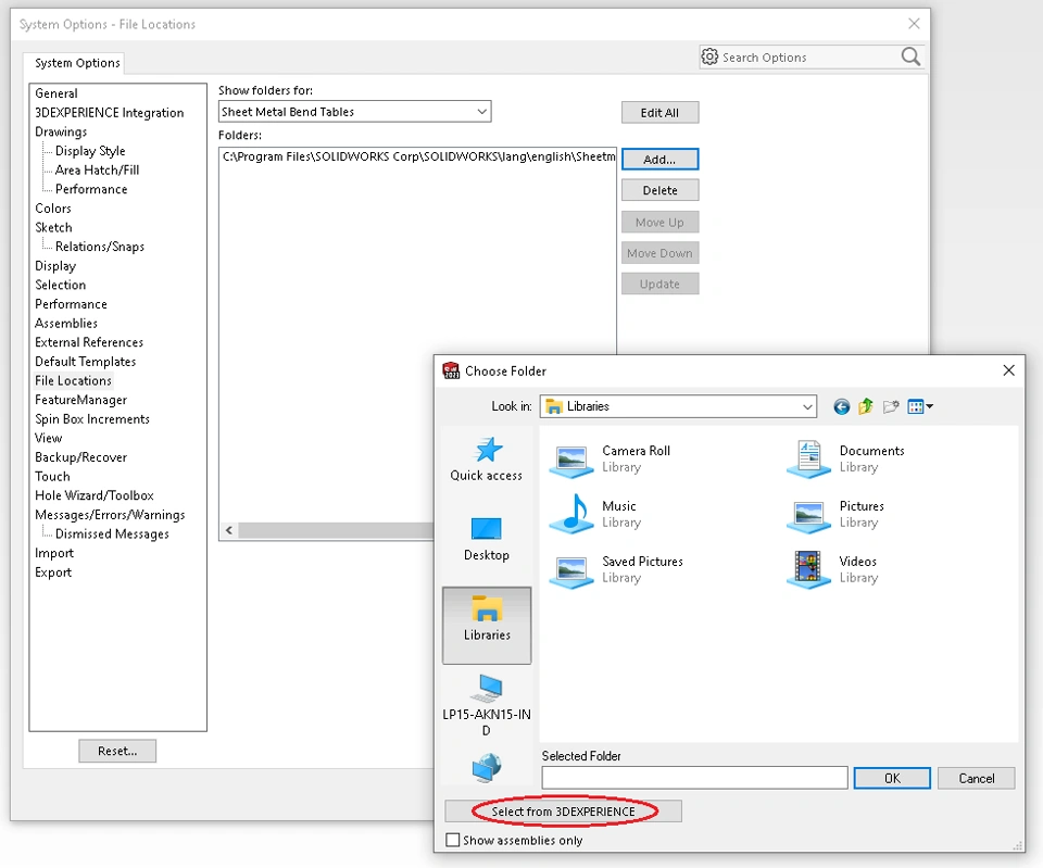

d) Managing Template Locations and Permissions
After creating templates, you can share the templates with multiple users. This helps ensure consistency in the document settings across the organization. One way to do this is to store the templates in a shared folder on a network drive. Users can then add that folder location to their list of Document Templates in the File Locations category of the System Options. When using this practice, the recommendation is to specify the Read-only permission for each template file. This prevents users from making inadvertent changes and breaking from company standards.

b) Editing the Sheet Format and Title Block
The default drawing template includes a single sheet, which also includes a default sheet format file. The sheet format file contains the border and title block that appear on the drawing sheet, as well as anchor points for the available tables. To edit the sheet format file, either right-click the sheet or sheet format nodes in the drawing tree, or on any blank area of the drawing sheet, and then choose Edit Sheet Format. You can also enter the sheet editing mode by going to Edit > Sheet Format.
The title block contains data pertaining to the part or assembly that appears in the drawing. You can enter this data manually or using the Note tool to add text to the title block. It can be helpful to populate these data fields automatically. After adding a note to a title block field, you can link the note to the properties by choosing the Link to Property option in the PropertyManager for that note, as shown in the next image.
Many properties require that you first add a model view to the drawing.

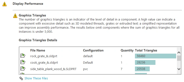

b) Level of Detail
If you experience a slowdown when rotating larger parts or assemblies, consider moving the Level of detail slider further to the right for less detail and faster performance. Refer to the next image. This reduces the level of detail as the part or assembly rotates, pans or zooms. This is particularly helpful with larger assemblies, because the number of graphics triangles dynamically reduce when the Level of detail is set to Less (faster) SOLIDWORKS automatically sets the Level of detail slider all the way to the right when Large Assembly Settings are active. Large Assembly Settings are activated if an assembly’s component count is higher than the threshold specified within the Assemblies category of the System Options, or when a user activates them manually from Tools > Large Assembly Settings. If you are using a high-performance graphics card, you might want to consider moving the slider further to the left, or all the way off to preserve detail during view manipulation.

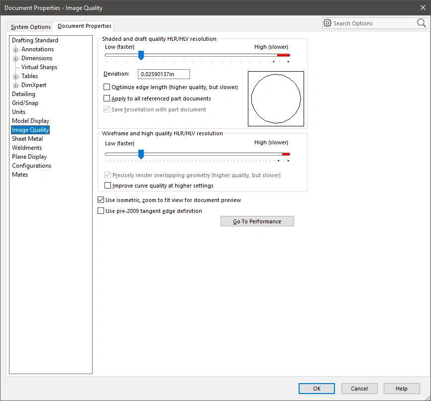

e) Image Quality
For some users, round edges and edges of holes might appear blocky or polygonal. To improve the quality, increase the Shaded and draft quality HLR/HLV resolution from the Image Quality category of the Document Properties. Because this option is in the Document Properties, it applies only to the current active document. Users might consider changing this setting in their templates, so all new documents inherit the setting. Be aware that an increase in resolution might come at the cost of a decrease in performance.

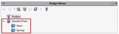

a) Advantages to Using the SOLIDWORKS Toolbox Library
The SOLIDWORKS Toolbox is a library of common hardware, such as nuts, bolts, screws, bearings, etc. The SOLIDIWORKS Toolbox is included with the SOLIDWORKS Professional and SOLIDWORKS Premium software versions. The Toolbox helps prevent the need to manually create numerous types of hardware that are used common in assemblies. If your organization uses many different types of fasteners and assorted hardware, having an integrated library of these components can lead to a significant amount of timesaving.
The Toolbox library contains many of the standard sizes needed for various hardwarecomponents. In cases where you need a different or custom size, you can enter the necessaryinformation, which the library database then stores for future use.
There are distinct advantages to using the integrated Toolbox. When you drag a Toolbox component from the library into an assembly, SOLIDWORKS mates the Toolbox to the geometry on which it is dropped automatically. In addition, many Toolbox components change size automatically to match the mated geometry. If there is an update to the size of the geometry, the Toolbox component size also updates to match the modification in the geometry. You can also apply Custom Properties, such as part numbers, per each size of each component within the Toolbox database. This is helpful in streamlining documentation such as bills of material.

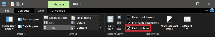

The installation logs are typically stored in the following location:
%SystemDrive%:\\Users\\%username%\\AppData\\Roaming\\SOLIDWORKS\\Installation Logs\\%installed_version%
To view these files, users might need to activate the Hidden items option in Windows® File Explorer:

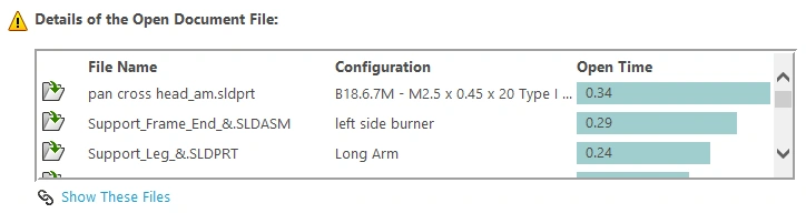

b) Performance Log
The SOLIDWORKS Performance Log is typically available in the following location:
%SystemDrive%:\\Users\\%username%\\AppData\\Roaming\\SOLIDWORKS\\SOLIDWORKS %release%

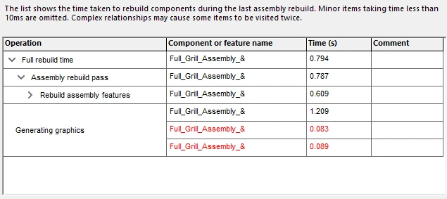

The performance log contains information about your current or last running session of SOLIDWORKS. These logs can be helpful when troubleshooting instances where SOLIDWORKS closes unexpectedly, or when you experience other behavioral problems with the application.

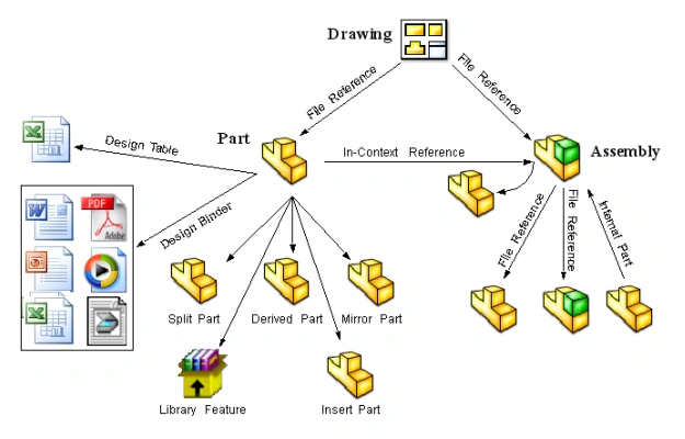

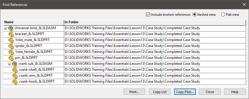

a) File Associations
SOLIDWORKS is a fully associative application. This means that assemblies and drawings reference part files. If a drawing or an assembly contains a part, and if there is a modification to that part, that modification then appears in the associated drawing or assembly. While this makes it easy to keep everything up to date with design changes, it can present some challenges when it comes to file management.
Help Document: Basic Concepts

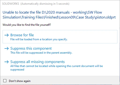

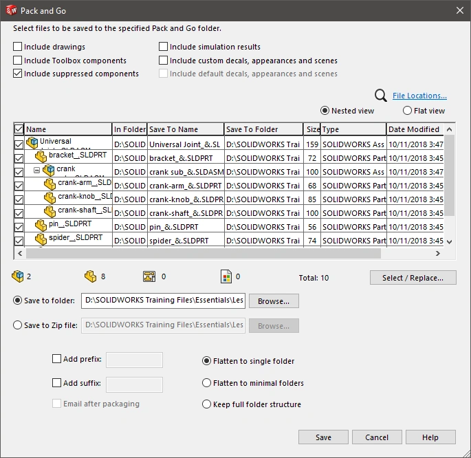

b) Warnings About Moving Files
Typically, users manage non-CAD files by simply organizing them into folders, and it is not uncommon to move or copy files from one folder to another. In SOLIDWORKS, this is not a recommended procedure. If a SOLIDWORKS assembly or drawing references a part file that has moved, the user receives a prompt to locate that file. In assemblies with many components, this can become disastrous if too many files are moved.
The same problems apply if users rename files in Windows File Explorer. TheSOLIDWORKS assembly or drawing is referencing the original name of the part file. If thereis a change to the file name, SOLIDWORKS has no way to detect that, and therefore displaysthe same prompt to locate the missing file.
c) Unique File Naming
Another recommendation is to use unique file names for SOLIDWORKS documents. For example, if two assemblies are open, and they both reference unique parts that share the same file name, SOLIDWORKS cannot open the second file name instance as a unique part.
d) Finding References
If an assembly build contains parts from multiple folders, it can sometimes be difficult to track down the locations of all those parts without opening each part individually. Fortunately, the Find References tool makes it easy to view the file locations of every part reference within the assembly (File > Find References).
Help Document: Find References Dialog Box
e) Pack and Go
Pack and Go is another tool that can help manage moving and copying SOLIDWORKS drawings and assemblies. Pack and Go allows users to copy a drawing or assembly file to a folder or a zip file, along with all of the referenced part and assembly files also. Pack and Go can also include additional files, such as drawings, toolbox components and simulation results. There is also an option to add a prefix or a suffix to all files, as well as the ability to flatten the folder structure for additional simplification.
The ability to add a prefix or suffix to the file name allows users to create copies of existing parts, drawings or assemblies, with new, unique names. This preserves the original documents, and you can modify the newly copied files without affecting references to the originals.
When deciding whether to apply pack and go functionality to a zip file or a folder, you should consider the use case. If the purpose of the pack and go operation is to send the package document to a collaborator for design review or modification, use of a zip file simplifies the process by producing a single file with a smaller file size. This is also the best option for sending a drawing or assembly to a Value Added Reseller (VAR) for technical support. If you only need to copy a drawing or assembly to a new location, a folder is often the better option.
Help Document: Pack and Go Overview

g) External References
In addition to the standard file references that exist between parts, drawings and assemblies, it is also possible to create external references. These external references create dependencies between files. As an example, when a part is created in the context of an assembly, and the new part uses edges or sketches of an existing part, that new part will have a dependency created using an external reference back to the assembly and the component to which that reference was established. To determine which files have external references, you can right-click the part name at the top of the SOLIDWORKS FeatureManager Design Tree and choose External References.
If a part has an external reference that is out of context, meaning the reference file it is dependent upon is not loaded into memory, it is possible to load the file by right-clicking the feature with the external reference and choosing Edit In-Context.
Help Document: External References

e) Unit Options
In the Units category, specify the Unit system according to your dimension standard. You can also specify either the default precision, or the number of decimal places for each unit type. It is also good to specify the Decimal rounding options to an agreed standard.
f) Image Quality
Image Quality should be set to provide smooth edges without sacrificing view performance. If zooming, panning and rotating a model is too slow, consider moving the sliders lower for the Shaded and draft quality HLR/HLV resolution option and the Wireframe and high quality HLR/HLV resolution option.

a) Open Performance
The first section details the Open Performance. This provides a full detailed list of how long it took to open each individual part and assembly file within the top-level assembly, in order from longest opening time to quickest. Clicking the Show These Files link displays a complete list of the files, configurations and the open time. You can print, copy or save the list for reference. You can also open individual files by selecting them in the list and clicking Open.
The Open Performance also shows the number of Previous Version References. These older version files take longer to open and affect the overall open performance of the top-level assembly. Converting older version files to the current SOLIDWORKS version will improve open performance.
Help Document: Performance Evaluation for Assemblies
b) Display Performance
Display Performance indicates the number of graphics triangles contained within each part in the top-level assembly. More complex geometry or components with excessive detail contain a higher number of graphics triangles, which can significantly affect assembly performance. For components with many graphics triangles, it might be helpful to create a simplified configuration for use within the top-level assembly if the full level of detail is not required.
c) Rebuild Performance
The Rebuild Performance section indicates how many mates are evaluated when the assembly is rebuilt, as well as a report of the last assembly rebuild.
This report is broken down into the full rebuild time; the assembly rebuild pass and the timeto rebuild assembly features. It also breaks down the time required to generate the graphics.

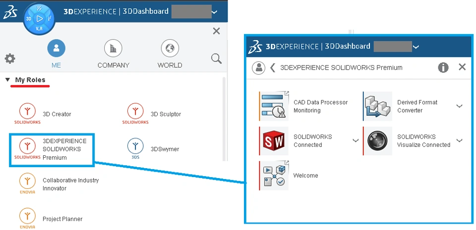

b) Access to the 3DEXPERIENCE Platform
The first step to experiencing the power of the 3DEXPERIENCE platform is to gain access. If you do not have an account yet, contact your organization’s system administrator or your VAR. Ensuring a smooth onboarding process is helpful to setting yourself up nicely on the path to using the collaborative capabilities and advanced features of the platform.

  • Design Library
The SOLIDWORKS Design Library tab in the SOLIDWORKS Task Pane provides a central location for reusable design elements such as parts, assemblies and sketches. Customers that adopt 3DEXPERIENCE can store their Design Library parts and assemblies in a collaborative space, and organize them using a bookmark structure. This is called a Connected Design Library and it appears in the Task Pane with a blue library icon.
Bookmarked parts and assemblies appear in a connected design library as a hierarchy in thesame way as a local folder structure. You can download the library to a local workstation ondemand. To create a connected design library, first upload the library parts and assemblies toa collaborative space, and then organize them in a bookmark structure.
Help Document: Connected Design Libraries

  • Create Template
3DEXPERIENCE users can create templates for the 3DEXPERIENCE platform directly from SOLIDWORKS in the following way:
  1. Open a SOLIDWORKS part, assembly, drawing or template that you want to save as a template.
  2. Go to File > Save as Template.
  3. Enter a Title and Description.
  4. Save the template with one of these options:
  • Create As Released - Creates template in the Released state. You cannot modify a template in this state.
  • Create As Private - Creates the template in the Private state. You can modify a template in this state.
  • Save Template
If a template file already exists in 3DEXPERIENCE, all Save commands open the Save Template dialog box. Silent saving is not supported for templates.
In this dialog box, you can:
  • Change the Title and the Description.
  • Save the template modifications.
  • Reset the fields to the default value.
After saving the template in 3DEXPERIENCE:
  • MySession refreshes and shows the 3DEXPERIENCE information that relates to the template.
  • The template file becomes available in the New SOLIDWORKS Document dialog box from SOLIDWORKS File > New, under the 3DEXPERIENCE tab.
After saving to 3DEXPERIENCE, you can revise and modify the templates. Who can make a modification and when depends on a users’ collaborative space permissions and the maturity state of the template. You can delete templates from a collaborative space using the same methods as a physical product using either the 3DSearch, Bookmarks Editor or Collaborative Lifecycle widgets.

iii) List Other File Locations Now Supported in 2023x FD03
In earlier product versions, administrators had no way to share SOLIDWORKS resources (non-CAD files) with users using the platform tools. However, 3DEXPERIENCE customers can now upload and manage those resources as documents in the Bookmark Editor. For collaboration, a person or team can upload and bookmark the documents for all SOLIDWORKS users on the platform to share.
When adding a folder for a SOLIDWORKS file location, each SOLIDWORKS user can browse from 3DEXPERIENCE and pick the bookmark that contains the content type they want. After selecting the bookmark, the bookmark appears in the File Locations options and the content downloads to a local folder for use by SOLIDWORKS.
As an example:
  1. Go to Options > System Options > File Locations.
  2. Select Sheet Metal Bend Table > Add Location > and choose Select From 3DEXPERIENCE.
  3. Select the applicable bookmark. The bookmark appears in the file location for Sheet Metal Bend Table.
Be aware that the Select from 3DExperience option is only available for the file location that supports bookmarks. In earlier versions, the Design Library was the only file location that supported bookmarks. For now, the following file location options support this option:
