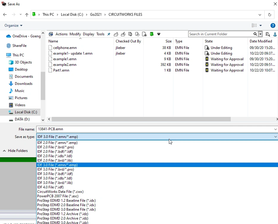

3) Supported File Types
CircuitWorks supports two direct translation standards: the International Data Format or IDF standard and the ProStep EDMD or IDX standard. CircuitWorks also supports PADS ASCII format files. Most PCB layout tools support the IDF standard; however, the ProStep standard is newer, and fewer applications support that standard. The ProStep file extensions are IDX, IDZ, and XML. The IDF standard uses a combination of two files, typically EMN, which contains information about the board, components, and their positions, and an EMP file that contains information about the physical attributes of the components. The definition of these attributes comes from the footprint and other component parameters (such as height). The IDF translation in CircuitWorks also supports the BRD, BDF, and IDB file formats.

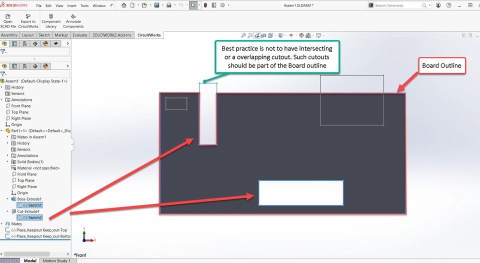

Creating Board Shapes and Cutouts

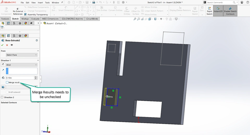

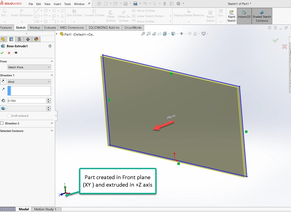

This section covers some tips and best practices for creating the boards and cutouts. First, when sketching, avoid use of nonstandard sketch feature types. SOLIDWORKS provides many best-in-class sketch tools that some common layout tools do not fully support. Items such as ellipses, parabolas, and splines have no equivalent feature in other layout tools. When creating features like fillets and chamfers, it is best practice to add the features to the sketch instead of adding them as features to the 3D body. It is also a good practice to add any cutouts to the board sketch instead of individual features. In general, add cutouts in areas where you want to remove board material that does not affect the operation of the PCB.
When creating or modifying a PCB, consider the following best practices.

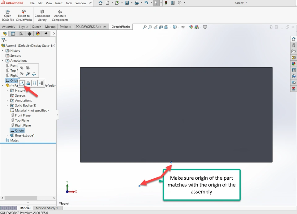

  • When creating a sketch, do so on the front plane and extrude in the +Z direction.

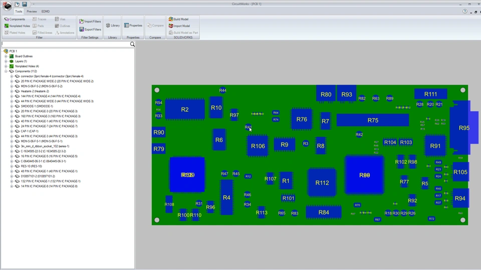

f) Filtering
Another key feature of the CircuitWorks interface is filtering. By using the filters, you can customize what is built or represented in the SOLIDWORKS application. For example, you might need to verify that tall components will not interfere with the mechanical enclosure or other boards that are part of the overall product. By using the component filter, you can specify that only components that are taller than a certain value be represented. You may also filter out components that are below a specific height value to improve performance of densely populated boards. Another option to consider is filtering out all components and leaving only the board and the holes required for mounting. Filtering not only saves time, but with the ability to save the filters, you can use them, when necessary, on every board that you run through CircuitWorks.
g) Associating Components
Here is where the power of SOLIDWORKS modeling really comes into play. When you read a file into CircuitWorks, the software compares the board and every component to its database. It is not necessary to create components that already exist in the database when placed them into the SOLIDWORKS assembly. This saves considerable time. Another key benefit comes from the overall appearance of the component. By default, components are created from the outline or footprint that is contained in the originating file. This creates extremely efficient models for performance, but lack a detailed representation of the components. One feature for translating PCB’s into SOLIDWORKS is the ability to use SOLIDWORKS add-ins such as SOLIDWORKS Visualize for photorealistic board images, or SOLIDWORKS Composer for work instructions. With these options, it is desirable to have the components look like the physical product. By taking advantage of the CircuitWorks Component Library, it is possible to download or build directly into SOLIDWORKS real world representations of the components, and associate them with the component libraries in CircuitWorks. This eliminates the need for a SOLIDWORKS user to replace the basic model shapes with realistic models after building the assembly. By taking advantage of the component library and filtering, you have the flexibility to use fully detailed PCBs while controlling the type of components required.

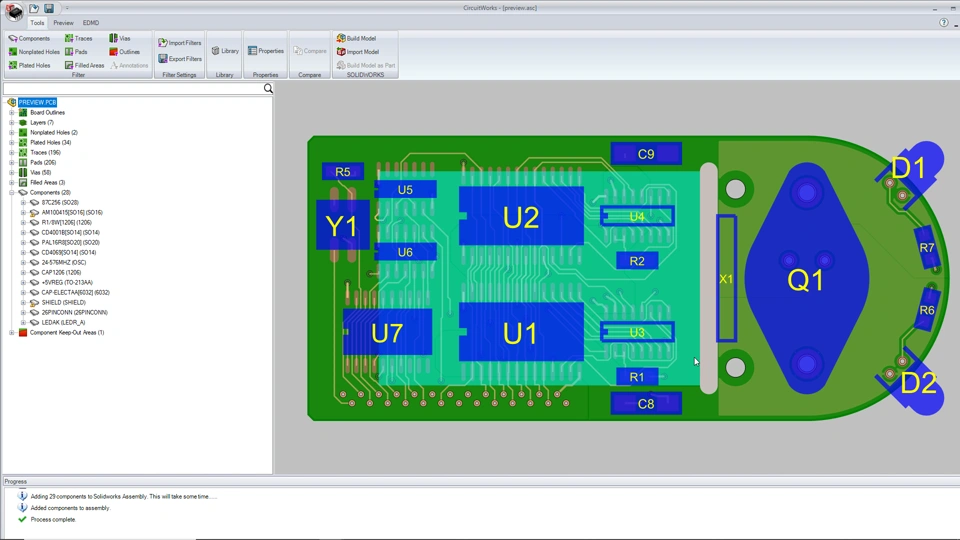

h) Building the Board
The basic or default workflow when working with external files (those created by the electrical engineering group), is to open the supplied files in CircuitWorks and then review the PCB. Here, you can verify the board thickness, the number and types of components, the hole information (plated and nonplated), and the position of components. At this point, you might apply filtering as needed. Then you can click Build Model to create a SOLIDWORKS model of the board. If there is no assembly open in the SOLIDWORKS application, the software creates a new assembly and then creates the new board. It then places the board into the new assembly, and then places the components. If you have already run the file through CircuitWorks and a SOLIDWORKS assembly already exists, open the assembly before clicking Build Model and SOLIDWORKS will update the existing assembly with any changes that are present.

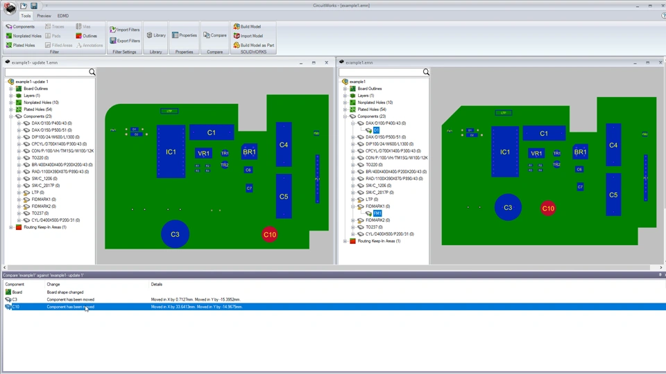

b) Comparing Boards
Whether pull changes from SOLIDWORKS or receive an updated file from the ECAD team, the CircuitWorks Compare tool allows you to review and verify changes before committing the changes to the SOLIDWORKS application or sending them to the ECAD team.
c) Save to CircuitWorks and Create an IDF
When you create changes in SOLIDWORKS and push the changes to the CircuitWorks interface, you can save the changes as an IDF or ASC file to send back to the ECAD team. This is also possible if you start the board creation process in SOLIDWORKS.

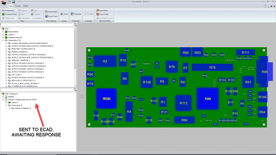

    b) Making and Sending Changes from SOLIDWORKS
    When making changes from SOLIDWORKS, the software pushes the updated SOLIDWORKS assembly to the CircuitWorks interface and creates a change file that you can send to the ECAD team. When creating the change file, the application provides a chance to add comments about the changes that then appear in the ECAD application.

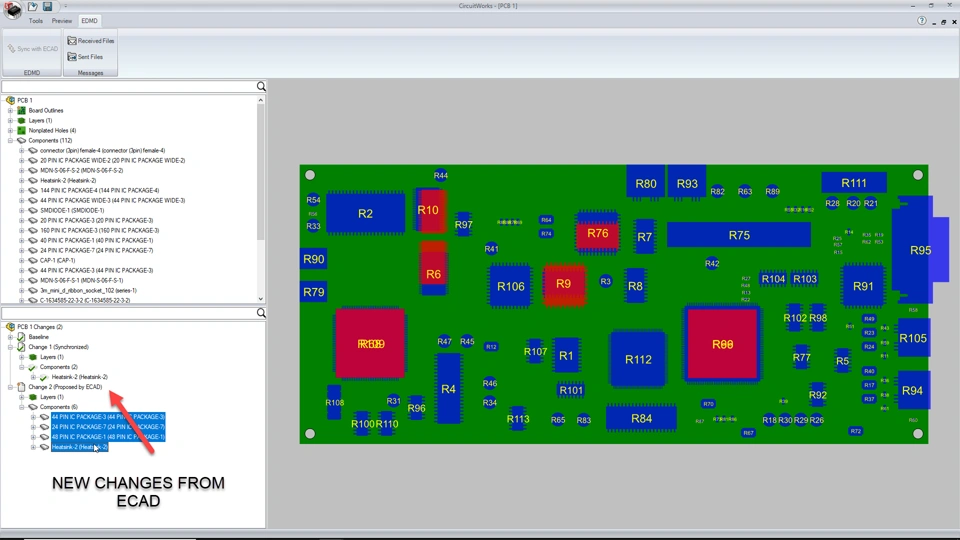

    c) Handling Changes from ECAD
    When the ECAD team makes changes, they will send update files. These update files are placed into the directory defined in the CircuitWorks options. When you open the baseline file in CircuitWorks, the software parses the change files automatically parsed. At that point, you have the opportunity to cycle through and approve each baseline file, review the comments of either team, and update the SOLIDWORKS assembly based on the change files.

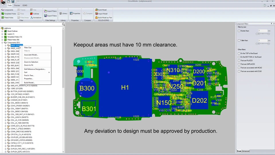

    A quick and efficient method to get realistic models is to use the work already done by CircuitWorks. After creating a board, open the model of a component you want to replace and then insert a model that you download or create. Use the move body commands to mate the model to the original body. Once aligned, delete the original body. This leaves a realistic model that already links to the CircuitWorks component database and has the correct orientation.

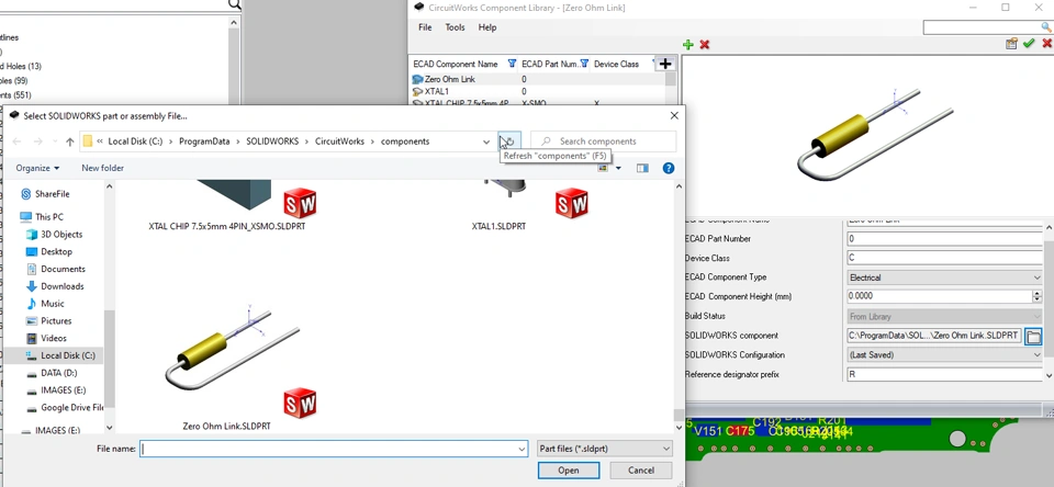

    Another option that some consider a best practice is to use the CircuitWorks Export Wizard (Component). To use this wizard, follow these steps:
    1. Open the component or model you want to add.
    2. In the CircuitWorks add-in, click Export to CircuitWorks.
    3. Follow the steps in the wizard to select the appropriate component type.
    4. For complex component outlines, the recommendation is to create a component outline sketch. Using silhouette edges can affect performance.
    5. It is a good practice to add a coordinate system that matches the system of the components on the ECAD side. Name the coordinate system CWX or select an existing system. For additional information about user-defined coordinates, see the SOLIDWORKS help topic at https://help.solidworks.com/2023/english/SolidWorks/circuitworks/c_User-defined_Coordinates.htm?verRedirect=1
    6. Verify that the component package name and component part number match the information from the ECAD tools. This ensures that CircuitWorks can properly match the model to the ECAD component for placement.
    7. Ensure that you select the Add the component to the library option.

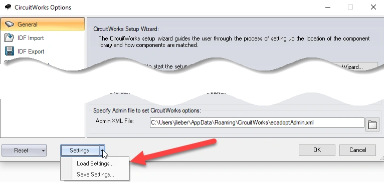

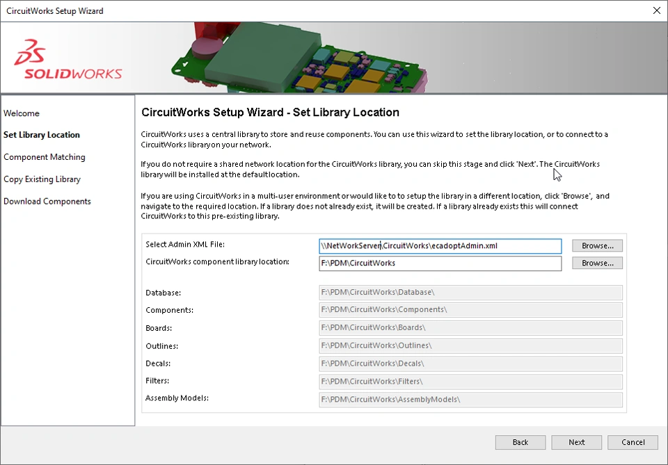

    a) Saving and Sharing CircuitWorks Settings
    When you specify options in CircuitWorks, those settings save into a file with the name ecadoptSettings.xml. This file can be stored on a local computer or on a network computer, and you can share the file with other users.
    If required, you can control the CircuitWorks user options from an administrator location by using Windows® user permissions. This method allows you to control who is an administrator or a client user (Read/Write versus Read Only) based on their Windows user rights for the shared folder.
When using the ecadoptAdmin.xml file, most of the options in the CircuitWorks Options dialog box are not active. However, you can still edit some options from the client computer, which are stored in the ecadoptLocal.xml file in the following location: C:\\Users\\User_name\\AppData\\Roaming\\CircuitWorks
The client user can still select the library location from CircuitWorks Options > Models.

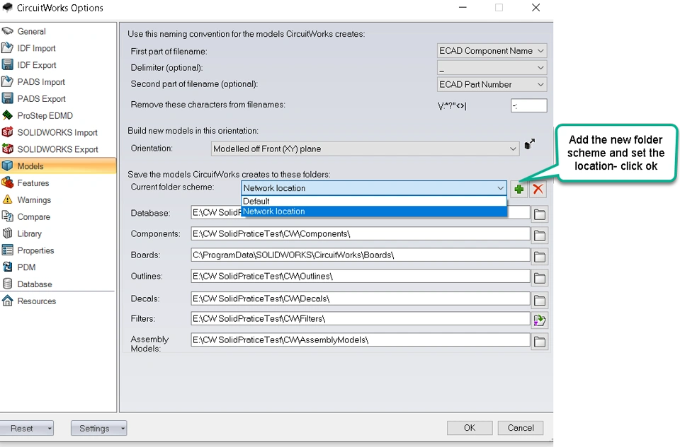

As a best practice, create a different folder scheme for the network location.
To do so, go to the General page of the CircuitWorks options and for Specify Admin file to set CircuitWorks options, browse to the folder that contains the ecadoptAdmin.xml file. When setting the location, you can specify which users have Read/Write access by right clicking on the xml file and selecting Share with > Specific people.
For additional information, see the SOLIDWORKS help topic at https://help.solidworks.com/2023/english/SolidWorks/circuitworks/t_Set_Administrator_Rights.htm?verRedirect=1

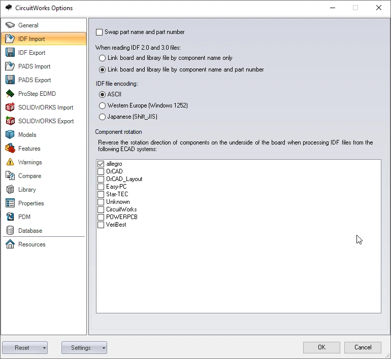

  • IDF Import
For importing IDF, there is an option to specify component rotation based on the originating system. When using CircuitWorks to create a PCB and the components appear in the incorrect orientation, make sure that you specify the correct originating system. You can also specify if you want to link by the name of the component and part number or by only the name of the component.

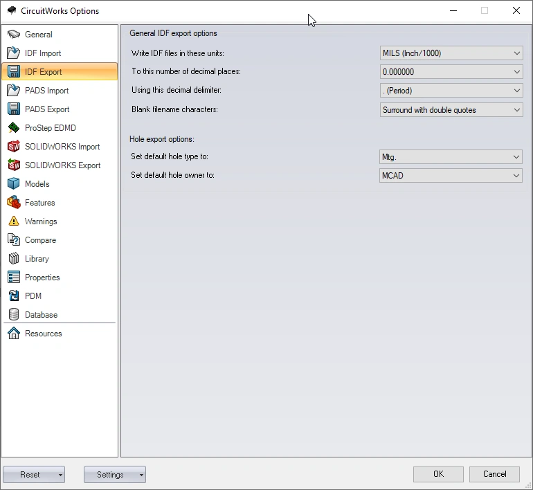

  • IDF Export
When exporting IDF files you can specify the unit of measure and precision. There are also options for the attribution of holes. It is best to create an example file and have your ECAD team import the file to determine if they need any changes.

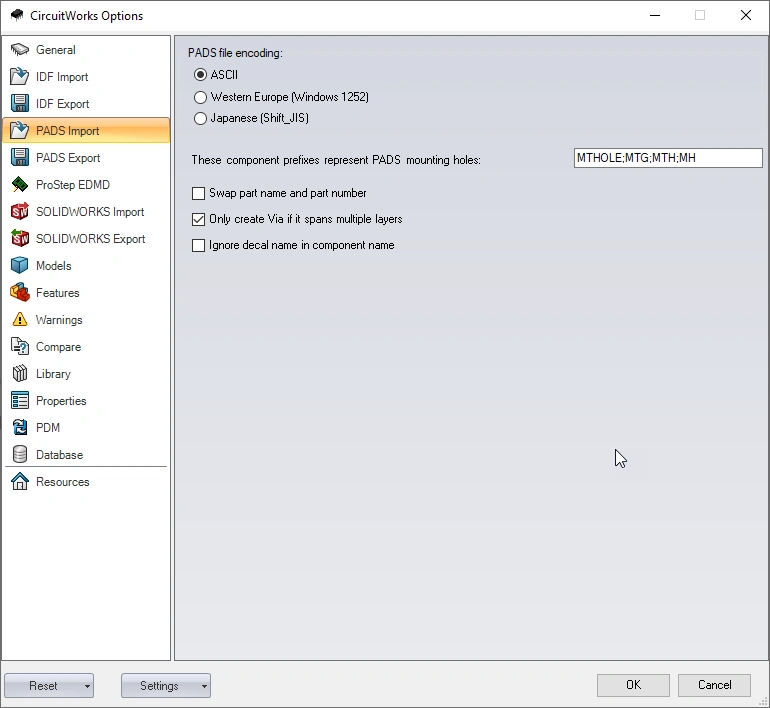

  • PADS import
There are very few options for importing PADS files because CircuitWorks has everything except some attribute settings. It is best to standardize on the unit of measurement. Speak with your ECAD team about the preferred unit.

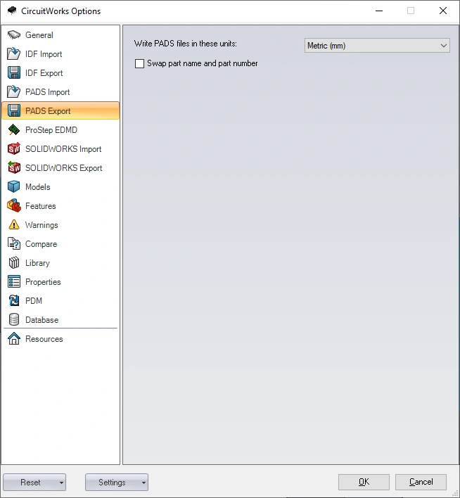

  • PADS Export
The PADS Export options allow you to specify the units and to swap the part name and number if required when exporting.

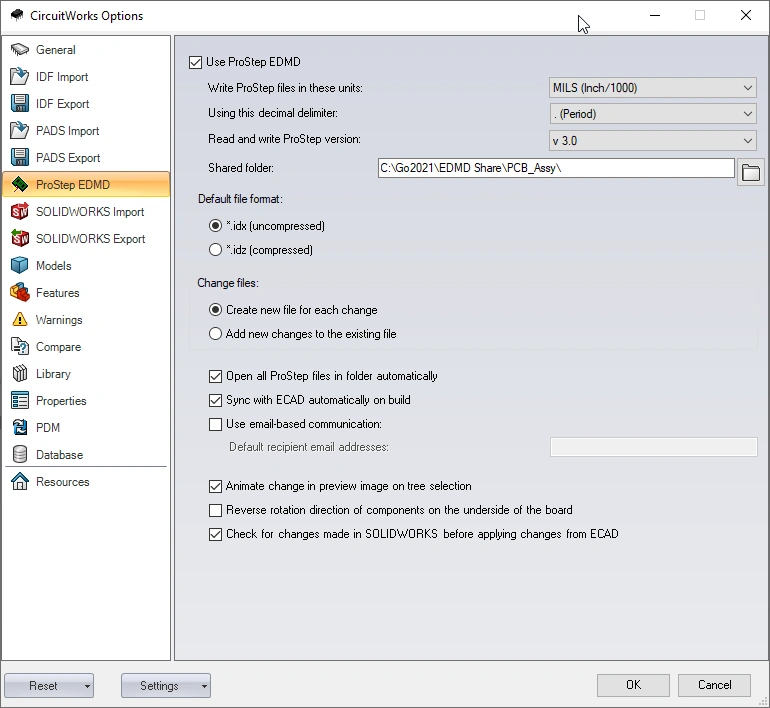

  • ProStep EDMD
When working with ProStep, it is important to discuss three important options with the ECAD team, their preference for unit of measure, which version of ProStep they are using now, and the specification of a central location for storing the files. ProStep can monitor a folder for changes from both ECAD and SOLIDWORKS, and it is a best practice for both systems to place the files created in the same location. Afterward, you can choose to create new files for each change or to add changes to the existing file.

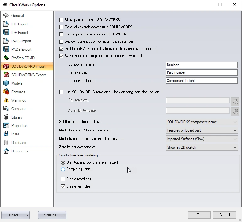

  • SOLIDWORKS Import
    The SOLIDWORKS Import options are among the most important specifications you must make, and the ones that you do not want to change much after you get started. The first few options control how components are created as parts in SOLIDWORKS. For example, whether to constrain sketch geometry and if the components creation is visible in SOLIDWORKS. For the greatest flexibility and best performance, do not activate these options. However, if it is company policy that everything must be fully defined, then activate the options accordingly. After part creation, you have the option to specify which templates to use and how the components appear in the assembly FeatureManager® design tree. For example, you might choose to use the component name or ECAD designator. Next, you have the option to define how to model copper (traces, pads, filled areas) items. Surface generation is faster than solids, but you can ignore copper creation, which would be fastest. Finally, you can define how CircuitWorks handles zero-height components. The default specification is to create a sketch, and this is probably the best option available. This option gives you an opportunity after creating a component to specify the height manually by extruding the sketch and then saving the model with the extruded sketch into your component library. The next time a PCB uses that component, the height comes from the library.

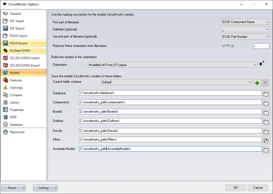

  • Models
    The options on the Models page are those that you do not what to change after setting everything up. Run through in import and then review the SOLIDWORKS assembly. Verify compliance with company standards and make any necessary changes. For example, the part names are correct and the storage locations are correct.

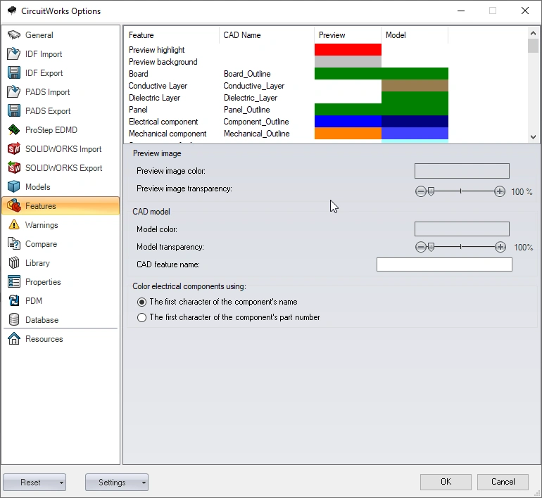

  • Features and Warnings
Options in the Features and Warnings page specify the colors for specific ECAD features warning levels. For example, warning levels notify you if you are about to create a very large assembly, which may affect performance.

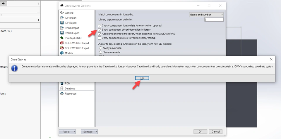

  • Compare and Library
Options on the Compare and Library pages control how changes appear when comparing two files in CircuitWorks, and what criterion is used to match components to the CircuitWorks library. When bringing a file into the CircuitWorks interface, the application examines each component and tries to match the component to existing components in the library. To do this, the software uses a specified combination of name, number, and height. It also has settings to handle replacing existing components defined with sketches (missing component heights) with new files that have a defined height.
In addition, after activating Show component offset information in library option, you can see the component orientation in the component library. The offset information is a good check if you experience issues with component rotation. The components and the board should have the same orientation.

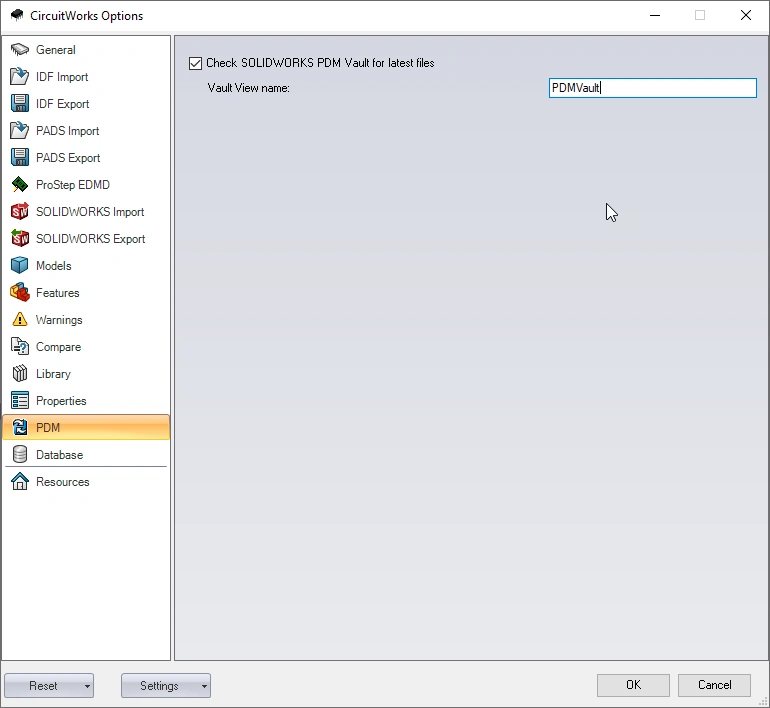

13) Using SOLIDWORKS PDM With CircuitWorks

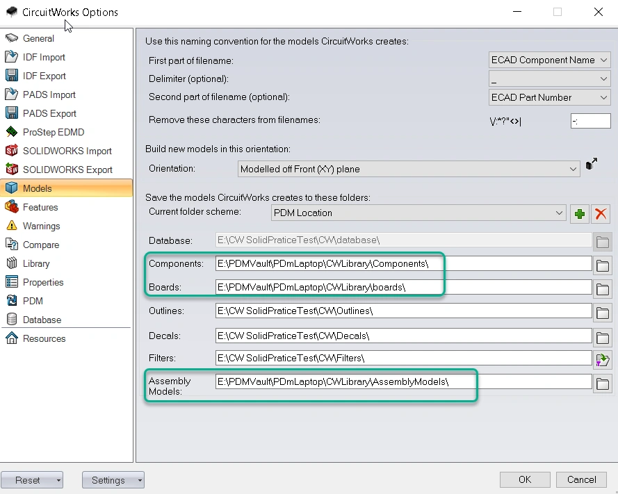

As mentioned in section 12, you can save files in a SOLIDWORKS PDM vault. Remember that you are creating SOLIDWORKS assemblies with their associated part files, and these files require management. SOLIDWORKS PDM is perfect for managing your SOLIDWORKS files. However, keep in mind that CircuitWorks creates the files, not you. Because of this, CircuitWorks needs information about your PDM server, specifically the vault name. From here, CircuitWorks uses your PDM login to check-in and check-out files.
  • To use SOLIDWORKS PDM with CircuitWorks, you must first activate the Check SOLIDWORKS PDM Vault for the latest files option on the PDM page of the CircuitWorks options. From there, enter name of your vault. This feature requires a SOLIDWORKS PDM Professional vault.
    After doing this, a dialog box appears and reminds you to define the Components path on the Models page of the CircuitWorks options to a path within your local vault view.
    CircuitWorks integration with SOLIDWORKS PDM requires the SOLIDWORKS PDM Professional version.
    • Option 1
    • Store the .db format file in a network location and all users point to that location.
    • Store decals and filters in a shared drive.
    • Store components in a SOLIDWORKS PDM vault.
  • Option 2- Preferred Solution
    • On the Database page of the CircuitWorks options, specify to use the same SQL server as SOLIDWORKS PDM. Make sure that users have the appropriate permissions to access the SQL server.
    • Share components in a SOLIDWORKS PDM vault.
