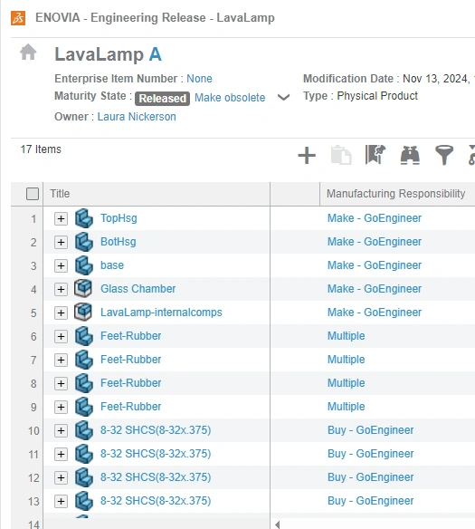

The Engineering Release user interface displays the product’s Identity Card at the top, showing the information of the open structure. The overall structure list and metadata are shown below the Identity Card. Information and commands are activated from icons, right click menus, and also from hyperlinked metadata in the structure list, denoted in blue text.
Figure 1 Engineering Release User Interface
The Home icon will return to the Engineering Release Home Page.
Figure 2 Home Icon

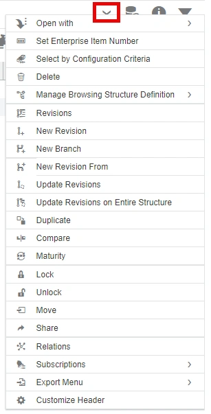

The dropdown arrow at the end of the Identity Card displays the commands that can be performed on the open structure as a whole.
Figure 3 Commands Performed on a Structure
Some of the more commonly used commands are:
Set Enterprise Item Number allows users to generate an Enterprise Item Number for the structure. Detailed information about working with Enterprise Item Numbers is provided in Chapter 5: Creating a Bill of Material, Enterprise Item Number.
Delete allows users to delete an item or a structure from the 3DEXPERIENCE platform with the option to include structural objects and delete all the child components.
Users can view Revisions and perform revision management for the structure using the commands Revisions, New Revision, New Branch, and New Revision From.
Update Revisions allows a user to selectively swap revisions or create a new revision for an object in the structure.
Figure 4 Options for Replace by Revision
The option Replace by Latest Stable Revision is available if an object has multiple revisions in both the Frozen and Released Maturity States. This will select the latest revision found in either the Frozen or Released Maturity States.
The Update Revisions dialog box displays a warning message as an alert if a revision change could create a potential issue, indicating that additional actions may be required.
Figure 5 Update Revisions Dialog Box Warning Indicator and Message
Update Revisions on Entire Structure will automatically update all the objects to the latest revision and, when appropriate, create a new revision to avoid errors.

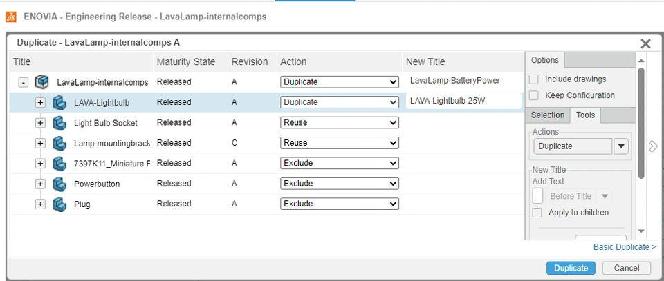

Duplicate will create a new object using the content of an existing object. Detailed information about duplicating structures is provided in Chapter 5: Creating a Bill of Material, Duplicate.

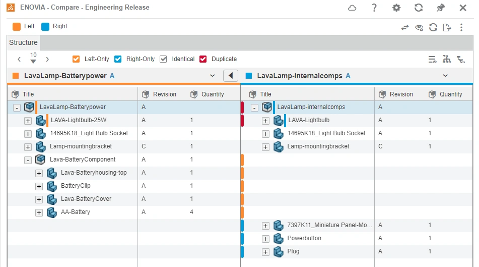

Compare opens the Compare app, designed specifically for analyzing and comparing two structures. Detailed information about comparing structures is provided later in this document.
Maturity allows users to manage the structure’s lifecycle.
Relations launches the Relations app to display parent and child references of the structure.
Export Menu allows users to export the structure in its native CAD format. Detailed information about exporting structures is provided later in this document.

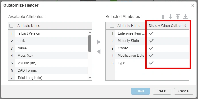

Customize Header allows users to customize the information found in the Identity Card. The Identity Card can be collapsed or expanded. The option Display when Collapsed shows the selected attribute when the Identity Card is in the collapsed state.
Figure 6 Icon to Collapse the Identity Card
Figure 7 Customize Header Dialog Box

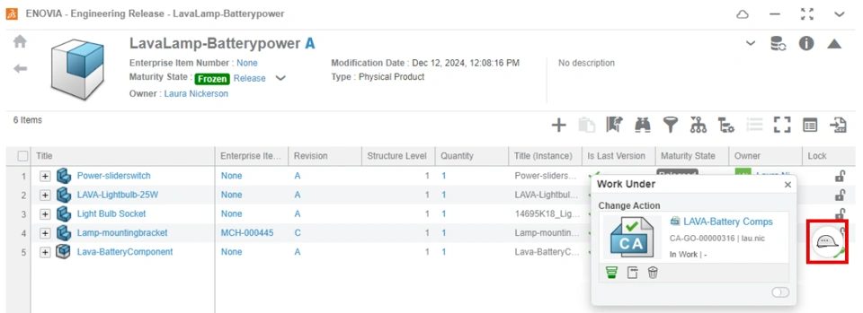

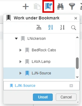

Work Under Bookmark, found in the row of icons, activates an existing Bookmark to work under, capturing any new objects created in Engineering Release.
Figure 8 Work Under Bookmark in Engineering Release

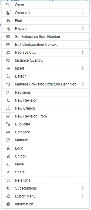

To select the item without opening it, hover over the left-most item number to display a checkbox and click the checkbox to select. Commands for individual objects are found in the right-click menu.
Figure 9 Right Click Menu on an Object in Structure List
  • Individual objects can be opened in Engineering Release by right-clicking and selecting Open. The Back icon will return to the open item’s parent structure.
Figure 10 Back Icon
  • The Detach command is unique to working with Structures. It allows users to remove the selected item from the Structure. It does not delete the item from the 3DEXPERIENCE platform.

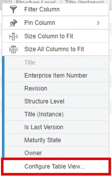

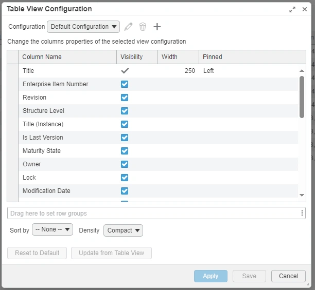

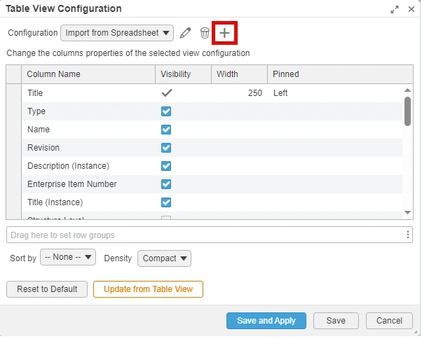

Visibility of columns can be controlled by right clicking the column headings and selecting Configure Table View.
Figure 11 Configure Table View Option
In the Table View Configuration dialog box, enable or disable the checkbox to show/hide the Column Name in the Engineering Release user interface.
Figure 12 Table View Configuration Dialog Box
If the Column Name is not listed in the Table View Configuration dialog box, click the Attribute Manager icon to open the Attribute Management list. This list lets you manage additional Attributes for visibility.
Figure 13 Table Preferences Icon
Figure 14 Table Preferences Dialog Box
From this Table Preferences dialog box, expand the Column Types in the Available Columns panel to show and select the desired Attribute. If you do not know which Column Type it falls under, use the Find icon to search for the Attribute.
Table 15 Table Preferences, Find Command
Use the right pointing arrow to add the selected Attribute to the Selected Columns panel and display it in the column headings. To remove a selected Attribute from the Selected Columns panel and from the column headings, use the left pointing arrow.
Once the Attributes are added as column headings, the columns can be rearranged with a drag and drop.
Column headings can also be configured and saved for a custom view of the data. From the Table View Configuration dialog box, the + icon will create a new view configuration. You can customize the visibility and order of the column headings. Moving a column heading up in the list will move the column to the left in the user interface. Moving it down moves the column to the right.
Figure 16 Table View Configuration
Tailoring and saving column heading configurations allows quick access to only the specific data you need, for instance, for Purchasing or as an Engineering Manager or a Designer.

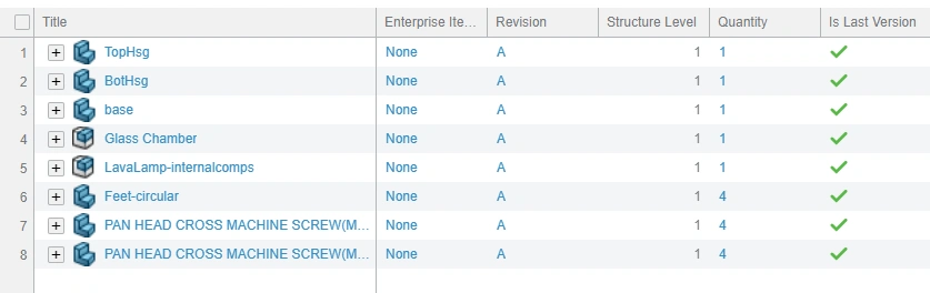

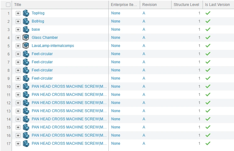

Usage and Reference controls how component instances are shown in any of the display formats. Use the Usage view to display each instance individually. Use the Reference view to group the instances and display a quantity.
Figure 17 Usage View with Indented Format, Displays Individual Instances
Figure 18 Reference View with Indented Format, Displays Quantity

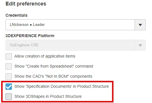

The Edit Preferences dialog box also has options to change how the structure list is displayed.
The options Show Specification Documents in Product Structure and Show 3DShapes in Product Structure control the display of Specification Documents and 3DShapes in the Structure list.
Figure 19 Engineering Release Preferences

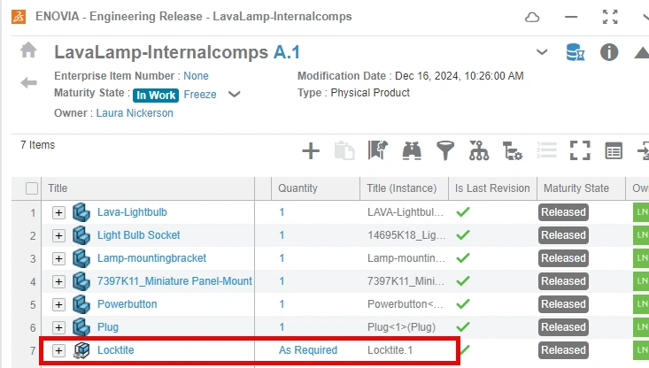

For most customers, a Specification Document is relevant to the BOM, as it helps define the object. Enabling Show ‘Specification Documents’ in Product Structure will show the Specification document as a child of the referenced object in the Structure list. More information on working with Specification Documents is provided in Chapter 4: Physical Product Information, Specification Links.
The 3DShape, however, is simply a graphics file representing the item. It is not related to the BOM and typically does not need to be displayed in the structure list.
Figure 20 Specification Document Shown as a Child

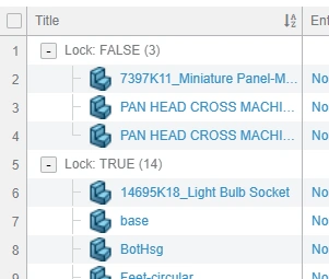

The Group By command will reorganize and display groups of items in the structure list based on one of the criteria provided.
For example, grouping objects via the Owner filter can show who owns an item. Grouping objects via the Lock filter can indicate if someone is working on a specific item. The Maturity State filter can identify any objects that need to be promoted to the Released Maturity State prior to Releasing the overall structure. The option None will clear all groups.
Figure 21 Group by Criteria
Figure 22 Structure List Grouped by Lock Criteria

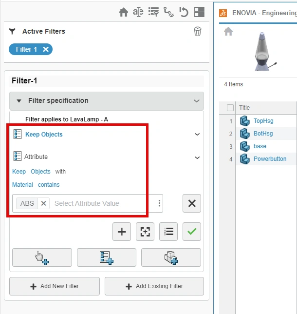

Filters provide advanced filtering to drill down to the exact information needed. Filters are based on 6W Tags and attribute values. Filters can be combined to further refine the search and can be saved for reuse. This will save time in set up and reduce errors in repetitive tasks. For example, a user can filter for ‘Powertrain’ on a vehicle that could encompass hundreds or thousands of individual parts.
Figure 23 Filter on Material Attribute  = ABS

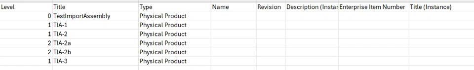

A product structure can be exported to a .csv file for review and further use in downstream applications.
The Export command, found in the toolbar, conveniently provides a quick .csv output of the BOM, as shown, with the columns and format displayed in the user interface. This is helpful for a quick review of the BOM for reference.
Figure 24 Export .csv Table

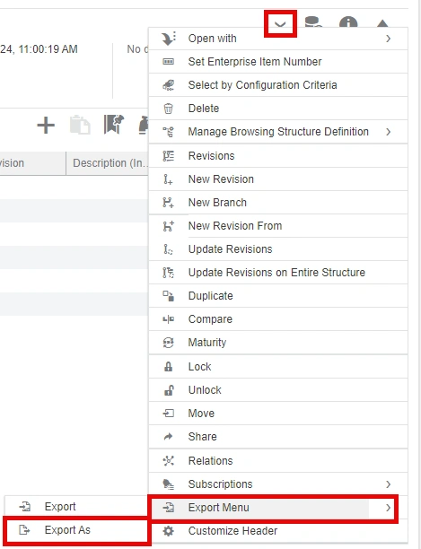

When exporting to a downstream application that requires specific column headings in a defined order, such as an ERP system, it is best to configure the column headings as previously shown in Chapter 3: Columns, Customization. The custom configuration can be saved, allowing the custom data view to be easily recalled and exported at any time.

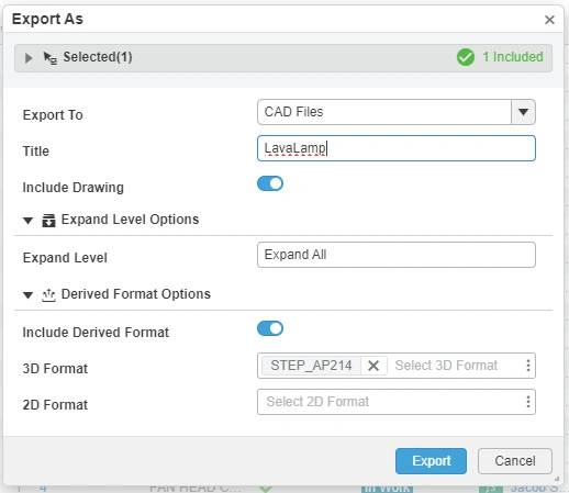

If you need to download CAD data from the 3DEXPERIENCE platform, from the Export Menu, select Export As. This command exports the CAD data in the native file format without having to open the CAD system.
Figure 25 Export Menu
Users have the option to include drawings and derived formats for both 3D and 2D data. A derived format is a file generated from the conversion of one format to another.
File TypeDerived Format Filetype Options
2D FileDWG, PDF, DXF
3D FileSTEP, STEP_AP203, STEP_AP214, STEP_AP242
Figure 26 Exporting CAD Data with Export As

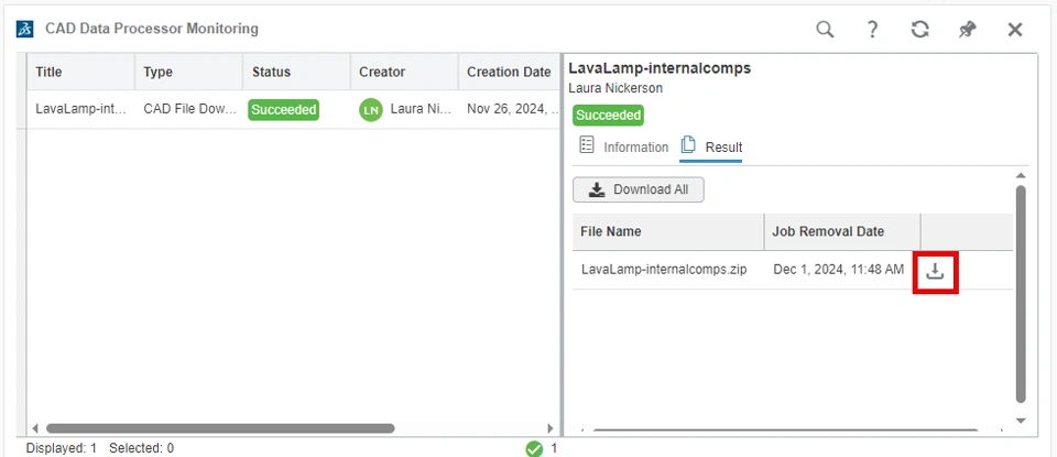

A Notification is received when the export process has finished. This is a link that launches the CAD Data Processor Monitoring dialog box, displaying the status of the newly created ZIP file.
Figure 27 Notification for Exporting CAD Data
Figure 28 CAD Data Processor Monitoring Dialog Box
The ZIP file can be downloaded to your local drive and shared.

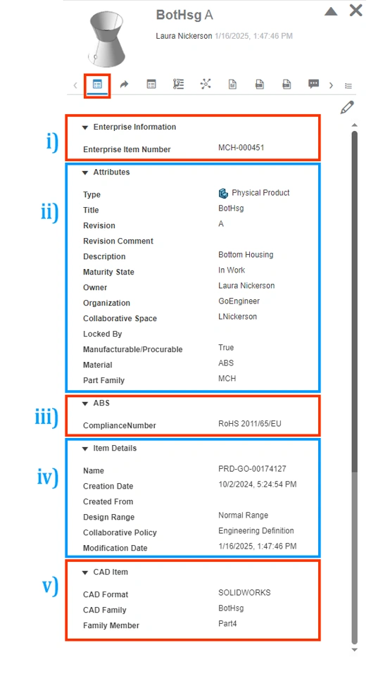

The Information Panel displays the 3DEXPERIENCE attributes of the whole structure or of a selected file in the structure list. The row of icons at the top of the Information Panel includes tabs for viewing the object’s details such as Properties, Revisions, Relations, Comments, and History. Additionally, it includes commands for enhancing the EBOM with information such as Specifications or Attachments, specifying and displaying Alternates, Manufacturing Equivalent Items, Raw Materials or Make/From connections. These commands may rely on other roles for the item’s definition. The data generated is easily accessible directly from within the Engineer Release user interface.
Figure 29 Information Panel Icon
Figure 30 Row of Icons in the Information Panel
a) Properties

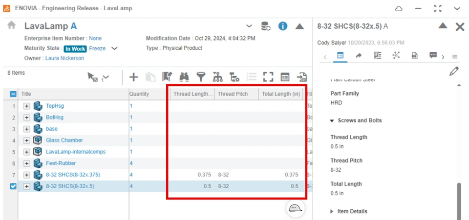

The columns in the Engineering Release user interface display a subset of the object’s complete properties. The full set of properties can be accessed via the Properties Tab of the Information Panel. As additional properties are added to the object, they will become visible within the Properties Tab.
Figure 31 Information Panel, Properties Tab

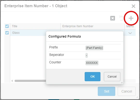

i) Enterprise Item Number (EIN)
An Enterprise Item Number is the equivalent of a Part number. This unique identifier complies with company policies on standardized naming conventions for downstream applications, such as manufacturing and integration with an ERP system.
The EIN can be assigned to an object through the hyperlink available in the overall structure list or within the individual component's Identity Card. Once assigned, it is visible in the object’s Properties Tab in the Information Panel.
More information on working with Enterprise Item Numbers can be found in the section Creating a Bill of Material.
ii) Attributes
An attribute stores non-CAD information linked to the object and is regarded as metadata. Attributes can be created manually through custom attributes or automatically, either through the CAD system or within 3DEXPERIENCE. Attributes are displayed in the Properties Tab for convenient review.
Users can modify editable attributes using Edit Mode, depending on their access rights and the object's Maturity State.

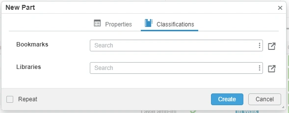

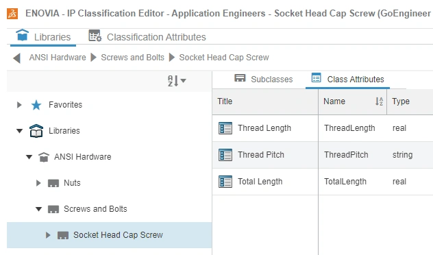

iii) Classification Attributes
Classification allows objects to be enriched by assigning Class Attributes that define their characteristics. These attributes provide further details or specifications, offering a more complete definition of an object.
The Class, along with Class Attributes and their values, is displayed in the Properties Tab for easy reference once assigned. For more information on Classification and Class Attributes, see Chapter 6: Appendix, Classification Manager Role.
iv) Item Details
These general attributes are based on the item’s object type. The Name (Database Object Name) is displayed, and is the Platform-wide identifier for the object. The Collaborative Policy is also shown, and it governs various administrative settings and workflows.
v) CAD Item
These attributes are associated with the item’s CAD authoring tool and configuration details within the CAD system. Knowing the CAD information is important if modifications are required.

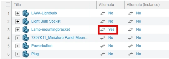

d) Alternates
Alternate items can be defined for any component in the structure. They are other physical products that can be used in place of the specified primary object in the structure. Each Alternate must be validated for satisfying the form, fit and function of the assembly, ensuring the component meets quality and performance standards. Previous revisions of a component or comparable material specifications are common Alternates for a component.
Alternates are defined in the Alternates Tab of the object’s Information Panel. A physical product can be deemed the Alternate for:
  • all usages of the primary object in any structure
  • all instances in this structure
  • one selected instance of the primary object in this structure
Figure 36 Alternates Tab in Information Panel
The Alternate column and Alternate (Instance) column in the Engineering Release user interface will display Yes or No, indicating if the object has an Alternate item(s) specified. Clicking the icon will open the Alternate Tab in the Information Panel.
To display the Alternate column as a column heading, please refer to Chapter 3: Columns, Customization.
Figure 37 Alternate and Alternate (Instance) Columns and Icon in Engineering Release

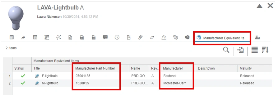

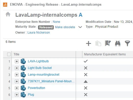

g) Manufacturing Equivalent Items
Manufacturing Equivalent Items (MEIs) are for organizations that are leveraging Supplier Item Management and Supplier Network Management in the 3DEXPERIENCE platform.
A Manufacturer Equivalent Item designates the supplier-provided item(s) to serve as the primary component in the structure list. For example, a bolt used in a structure is a purchased part, and the Manufacturer Equivalent Item identifies the specific manufacturer and manufacturer part number to be used in manufacturing.
Manufacturing Equivalent Items provide a method to track and approve vendors and part numbers in the 3DEXPERIENCE platform. Commonly, SOLIDWORKS users will add a SOLIDWORKS custom property to a component to represent the Vendor and Vendor Part Number. If either of these designations need to be updated, those components will need to be revised and rereleased. Using MEIs will reduce the unnecessary component revisions for modifications to vendor information.
MEIs can be viewed from the Manufacturing Equivalent Item Tab of the component’s Information Panel. More information on Manufacturing Equivalent Items can be found in Chapter 6: Appendix, Supplier Item Manager Role.

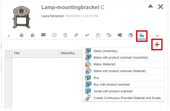

h) Manufacturing Responsibility
Manufacturing Responsibility is for organizations that are leveraging Manufacturing Bills of Materials (MBOMs) in 3DEXPERIENCE. This allows a user working on the Engineering BOM to create initial Manufacturing Items and tie them to the responsible party at the organization.
When an item in the Engineering BOM is added to the Manufacturing BOM, a Manufacturing Item and a Scope relationship are created. The Manufacturing Item and related metadata can be found in the Manufacturing Responsibility Tab of the component’s Information Panel. More information on working with Manufacturing Items can be found in Chapter 6: Appendix, Manufacturing Items Engineer Role.

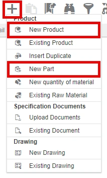

There are several methods to create a new product through the EBOM in the Engineering Release user interface. These include creating a new product (structure) directly within the interface, importing a spreadsheet to create a new structure, or using the Duplicate command.
a) Creating BOMs and Using Existing Parts

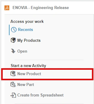

The New Product command in the Engineering Release home page provides a method to create a new empty structure.
Figure 42 New Product Command in Engineering Release

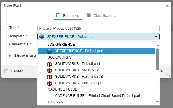

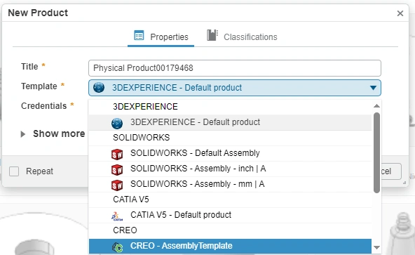

The New Product dialog box provides options to select a specific template from a CAD authoring tool. If an organization is using a single CAD tool within the 3DEXPERIENCE platform, it is recommended to align the template with the preferred CAD system. Classifications can be assigned to include specific attributes in the product. Classifications will be discussed in the Appendix.
Figure 43 New Product Dialog Box
Once the Structure has been created, components can be added, building out the structure.
The New Product command within an existing structure will create a new, empty, assembly in the structure list. The New Part command will create a new, empty, single component in the structure list.
In both the New Product and New Part dialog boxes, there are options to select the specific template from the CAD authoring tool.
Figure 44 New Part Dialog Box

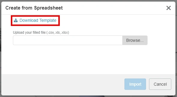

b) Importing a Spreadsheet
Structures can be created or updated by importing a spreadsheet. The file formats .csv, .xls, and .xlsx are supported. The Create from Spreadsheet command must be enabled in Preferences to display and launch the Create from Spreadsheet command in the home page of Engineering Release.
The spreadsheet must follow a precise format for successful import. A template can be downloaded containing all necessary headings.
Figure 45 Option to Download a Spreadsheet Template
Figure 46 Spreadsheet Template for Importing Structures
The data entered into the spreadsheet determines if a new physical product is created as a root or child component, or if the structure is updated by adding new physical products. The Level and Type columns must be filled in for each component whether you are creating a component or updating one.
If only the Level and Type columns are filled in, a new object is created.
  • Level 0 is the Root assembly. There can only be one Level 0 component in the structure.
  • Level 1 is a component of the Root assembly.
  • Level 2 is a subcomponent of the Level 1 component preceding it in the spreadsheet
Figure 47 Example Creating a New Structure from a Spreadsheet
Figure 48 Resulting Structure from Import
To update a structure, reimport the same spreadsheet with the Level, Type, Name and Revision fields filled in for the existing objects. This will reuse the existing objects, while allowing new objects to be added.
Figure 49 Example Updating a Structure from a Spreadsheet to Add New Components
Figure 50 Resulting Structure from Import
c) Use Export
To save time and minimize errors when updating a structure, customize the column headings for the import format and save as a new Table View Configuration, as previously shown in Chapter 3: Columns, Customization. Then, use the Export command to generate a spreadsheet preformatted for the required import format. All the fields will be automatically populated with the metadata for the existing components and new components can be added.
When importing items from a spreadsheet:
  • Each new object imports as an assembly.
  • The CAD format is 3DEXPERIENCE for all newly created objects and cannot be changed.
  • The CAD format is honored when existing CAD objects are specified in the spreadsheet.
Figure 51 Resulting Structure from Importing an Existing SOLIDWORKS File
d) BOM Compare
Compare, when launched from Engineering Release, displays two BOM structures side by side. The user interface includes Revision and Quantity columns to facilitate comparing the details of the structures.
Common use cases for Compare include comparing the previous revision of a BOM to the latest revision to identify changes between revisions. Also, in the case of creating a new BOM from an existing structure, Compare helps to account for each component, preventing any from being inadvertently omitted.
The Compare command is found in the drop-down menu in the Identity Card.
Figure 52 Compare - Engineering Release
The structures can be shown in the Structure view or List view. List view displays the total quantity of instances in the Quantity column.
Differences between the structures are highlighted and color-coded, with filters at the top that enable users to analyze the differences in detail. For example, users can identify which components have changed and which remain identical, or which components have a new revision and which have changes in quantity. This provides clear insights into the changes and differences.
The types of differences found between the structures (for example, revision, identical, quantity) determines the available filters.
Figure 53 Example Filters in Compare
Being able to compare the structure lists from different revisions or two different models is especially useful for large structures. It enables users to quickly filter out identical components and focus only on those that have changed. It helps track changes and ensures the correct parts are used in production. It can help identify the differences in components and quantities to ensure an accurate inventory supply and avoiding delays.
e) Duplicate
A highly efficient and commonly used method for creating a new structure is to Duplicate an existing one. Duplicate will create a new object using the content of an existing object. Advanced Duplicate provides editing options to exclude components, reuse components, or duplicate a component and provide a new title.
In Engineering Release, Duplicate can be launched from the dropdown arrow of an object in the Home page or from the Identity card, or from the right click menu on an object in the structure list.
Figure 54 Advanced Duplicate Dialog Box
The Include Drawings option will duplicate the associated drawings, maintaining the file references. However, the copied drawing will not adopt the title of the new object. Retitle the copied drawing separately in Bookmark Editor to align with the new object name.
Figure 55 Resulting Structure from Duplicate Command
f) Enterprise Item Number
An Enterprise Item Number (EIN) is a Part Number that uniquely identifies an inventory item across the entire organization. Having every component labeled consistently according to an organization’s naming policies will clearly categorize the item, eliminating any confusion. It allows interoperability with downstream systems, such as an ERP system, and it facilitates inventory management and tracking.
There are a few administrator settings for Enterprise Item Numbers found in Collaborative Spaces Configuration Center > Engineering Definition that should be considered.
  • The Platform Administrator will configure the Enterprise Item Number formula. The formula can contain up to 15 fields, but only one global counter field containing up to 15 digits. For example, XXX1-YYY2-123456.
Figure 56 Enterprise Item Number, Formula Configuration Dialog Box
  • Under Enterprise Item Number: Admin Configuration, the Administrator can enforce using unique Enterprise Item Numbers by enabling the setting Enable Enterprise Item Number uniqueness for Product.
Enabling this option will ensure each EIN will be a unique identifying part number and will reduce the confusion of having duplicate data.
  • The option Allow different Enterprise Item Number for a Product within its revision chain controls whether a new revision of an item with an EIN can be assigned a new EIN.
Commonly, this setting is disabled. When a new EIN number is introduced during a revision update, the new part number does not start with the initial revision (Rev A). Because the structure is derived from the existing revision, it lacks the complete revision history of the development process. This breaks the continuity of the revision chain and disrupts the traceability across revisions. If the changes in the new revision justify a distinct part number, it is best practice to start by creating a new structure beginning at Rev A.
  • The option Always allow Manual Input for Enterprise Item Number allows the EIN to be edited manually.
If manual entry of part numbers is enabled, ensure the Enable Enterprise Item Number uniqueness for Product setting is enabled to prevent users from creating duplicate part numbers in the system.
Figure 57 Enterprise Item Number: Admin Configuration Settings
Once the Enterprise Item Numbers are configured, an EIN can be set from the EIN hyperlink or by right-clicking on an object(s) in the structure list in Engineering Release.
The Enterprise Item Number dialog box displays an existing EIN where the user can edit or clear the EIN number. To set a new EIN number, the user must select the item’s check box in the list, click the + sign to open the Configured Formula dialog box, and then click OK prior to clicking Set.
Figure 58 Enterprise Item Number Dialog Box, Generate New EIN

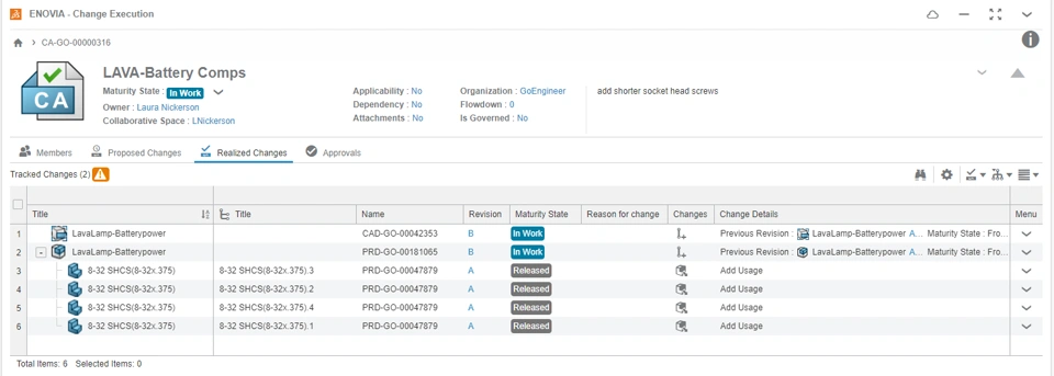

i) Working under a Change Action
The setting to control the visibility and location of the Work Under icon is found under Preferences. Enabling Work Under in Engineering Release will track and record any modifications to the structure while the Change Action is active.
Figure 59 Work Under in Engineering Release
The Realized Changes Tab in Change Action (Change Execution app) lists the modifications to the structure made in Engineering Release. It displays which objects changed as well as how they changed.
Figure 60 Realized Changes Tab in a Change Action
The Change Action further documents who made the changes and who approved the changes, with any comments and the approval date. This provides a clear record of the change, ensuring traceability.

i) Overview of the IP Classification Editor
The IP Classification Editor app, found in the Classification Manager role, defines the framework to categorize data. Libraries serve as the primary category or criteria. Within each Library, the Classes and Subclasses define specific subcategories and assign unique Class Attributes.
For instance, a plastic molded housing is categorized within the Molded Parts Library and Polypropylene Class. It is assigned a Class Attribute that list the compliance number for the material. A socket-head cap screw is categorized withing the ANSI Hardware Library, Screws and Bolts Class, and the Socket Head Cap Screw Subclass. It is assigned Class Attributes that list the thread length and pitch. Each item is classified in its respective Library and Class and receives only its relevant Class Attributes. For example, a screw does not require a material compliance number, and a plastic molded part does not require thread information.
Figure 61 Libraries, Classes and Class Attributes in IP Classification Editor

  • The New Part dialog box in Engineering Release contains the Classifications Tab to specify the Classification Library upon creation.
    Figure 62 New Part Dialog Box with Option to Classify Object on Creation

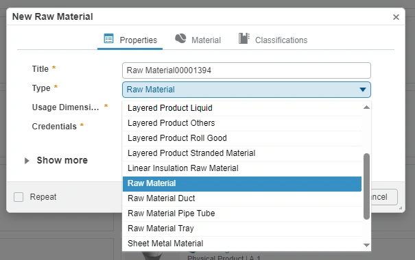

i) Creating Raw Materials in Specification Manager
The Specification Management app, within the Specification Manager role, creates and manages Raw Material objects that can be used in other apps, such as Engineering Release. When creating a new Raw Material object in Specification Management, there are various options for defining the Type of Raw Material object. By selecting a specific type, the object is assigned additional specialized attributes that reflect the characteristics of that type. For instance, an object designated as the Cable Raw Material type will receive attributes such as bend radius, outside diameter, and gauge.
Figure 64 Raw Material Types
Note: These attributes can only be modified within a specific modeling application on the 3DEXPERIENCE platform.
Instead, to enhance accessibility, it is recommended to use the generic Raw Material and use Classifications to organize the Raw Material objects. Classification Libraries will assign specialized Class Attributes to the object with editing capabilities.
The Raw Material object in the Released Maturity State will be visible and accessible to other members in the Collaborative Space. The Raw Material object in the In Work Maturity State is only visible and accessible to the owner.

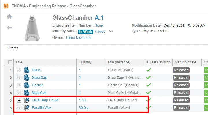

ii) Using Raw Materials in Engineering Release
The most common use case for Raw Materials is when the item is consumed during the manufacturing process. For instance, the rear differential in the powertrain assembly requires a specific volume of gear oil. The oil must be accounted for in the Engineering BOM and is used during the assembly of the rear differential.

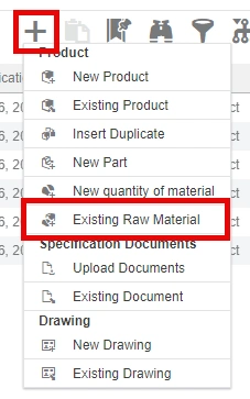

Selecting the Existing Raw Material option from the New menu will search for Raw Materials created under the Specification Management role.
Figure 65 New, Existing Raw Material in Engineering Release
The Volume or Mass field is determined from the selected Raw Material and cannot be changed. Users provide the quantity value and units of measure, or specify As Required, for the quantity of the line item in the BOM. The following figures are examples of each.
Figure 66 Choose Quantity of Raw Material, Volume
Figure 67 Choose Quantity of Raw Material, Mass
Figure 68 Choose Quantity of Raw Material, As Required
The Raw Material is added to the structure as a separate line item. The Structure View must be set to the Reference view in order to see the Quantity column.
Figure 69 Raw Material Shown in Engineering Release
Figure 70 Raw Material Shown in Engineering Release

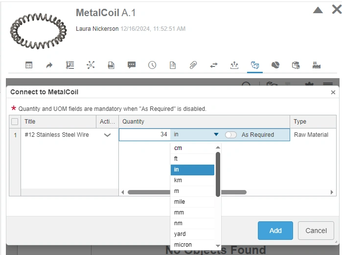

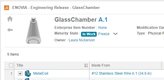

iii) Using Raw Materials in Made From
A Made From connection is another use case for Raw Materials. The Made From relationship is created between the final product and the Raw Material from which it will be created. For example, the metal coil (final product) is made from 34 inches of the #12 Stainless-Steel Wire (Raw Material).
The Make From relationship is created in the object’s Information Panel, in the Make From Tab. The Raw Material must be created in the Specification Management app prior to creating the Make From relationship.
Figure 71 Make From Tab, Information Panel
The Quantity and Units of Measure are mandatory and are editable in the Connect dialog box. There is also the option for As Required.
Figure 72 Input Quantity and Unit of Measure, Made From Tab, Information Panel
The Make From relationship can be displayed as a column heading in Engineering Release. As described in Chapter 3: Columns, Customization, enable the check box for the Made From and Raw Material Quantity Attributes from Attribute Management. The user interface updates, displaying the column heading and populating the metadata within the column.
Figure 73 Made From Column with Quantity in Engineering Release

In Engineering Release, MEIs are indicated within the Manufacturer Equivalent Item column. If the Manufacturer Equivalent Item column is not shown, please refer to Chapter 3: Columns, Customization for instructions on how to enable its visibility.
Figure 74 Manufacturer Equivalent Items Column
As shown above, the user interface displays an icon (or combination of icons) that reflects each MEI’s validation status:
  • An X indicates there are no valid MEIs for this item.
  • A check indicates there is at least one valid MEI.
  • An up triangle indicates there is a qualification process ongoing for at least one MEI.
  • A clock indicates at least one MEI is expiring soon and is pending Obsolete.
  • A filled circle indicates at least one valid MEI and at least one is in the qualification process.
Users can click the status icon to open the Manufacturer Equivalent Items Tab in the component’s Information Panel, allowing them to review the existing Manufacturer Equivalent Items.
Displaying the Information Panel in the Table View provides a quick reference for downstream activities. The Purchasing department, for example, can easily see if MEIs exist, and have easy access to detailed information such as the Manufacturer and the Manufacturing Part Number for sourcing.
Figure 75 Information Panel, Manufacturer Equivalent Items

An engineer can also proactively define the Manufacturing Item for a specific component within Engineering Release. From the object’s Information Panel, in the Manufacturing Responsibility tab, the user will create the Manufacturing Item corresponding to the function of the object. The most common types are Make (Assembly), Make (Material) or Buy.
Figure 76 Information Panel, Create New Manufacturing Item in Engineering Release
Make (Assembly)Creates a manufacturing-specific intermediate assembly.
Make (Material)Creates an individual part from a fabricated or produced material.
BuyCreates individual parts that can be produced internally and raw materials are identified.

In the Engineering Release user interface, Manufacturing Items are indicated in the Manufacturing Responsibility Column. If the Manufacturing Responsibility column is not shown, please refer to Chapter 3: Columns, Customization. The Manufacturing Responsibility column displays the Manufacturing Item Type with Organization. This indicates an MBOM item exists, with quick reference to whether it is produced or purchased (either Make or Buy, depending on the specified Manufacturing Item Type) along with the responsible organization. If a component has two Manufacturing Items, one being produced, the other purchased, the Manufacturing Responsibility column will display “Multiple.”
Figure 78 Engineering Release, Manufacturing Responsibility Column

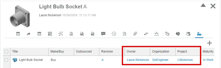

Users can click on the component’s Manufacturing Responsibility to open the Manufacturing Responsibility Tab in the component's Information Panel. Displaying the Information Panel in Table View shows the Manufacturing Item Type, Owner, responsible Organization, and the Collaborative Space. This provides further detailed information to determine if the item is being used in manufacturing.
Figure 79 Information Panel, Table View Display
