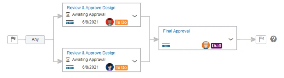

In a situation where reviewing and approving a change will involve multiple people, a route approval process can be defined. Routes in the 3DEXPERIENCE platform are used to automatically generate tasks that are then automatically assigned to people to action. Any stage of a route can include one or more people, and can be configured so that either all or just one of the people is required to approve before the route moves to the next task.
When creating a change action, a route can be selected as the approver instead of an individual person. For more information explaining how to use Routes in combination with change actions, please refer to the SolidPractices guide titled Route Management.

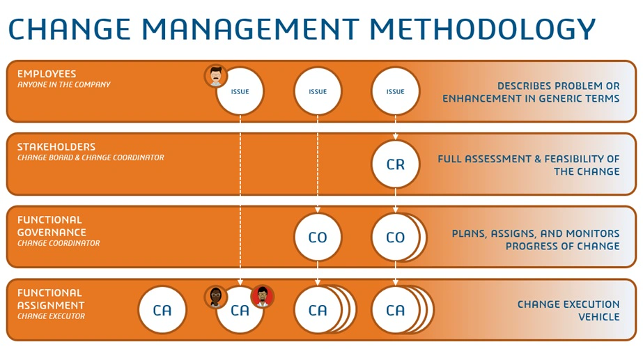

Managing Design Change with Issues Capture
As previously discussed, change actions are the core item used to manage change in the 3DEXPERIENCE platform. The previous use case explained how change actions can be assigned to a person or team nominated to execute the change, how the necessary revisions are created automatically, and how the lifecycle of the associated SOLIDWORKS files is transitioned when complete. This is the recommended starting point for SOLIDWORKS Design users adopting the 3DEXPERIENCE platform.

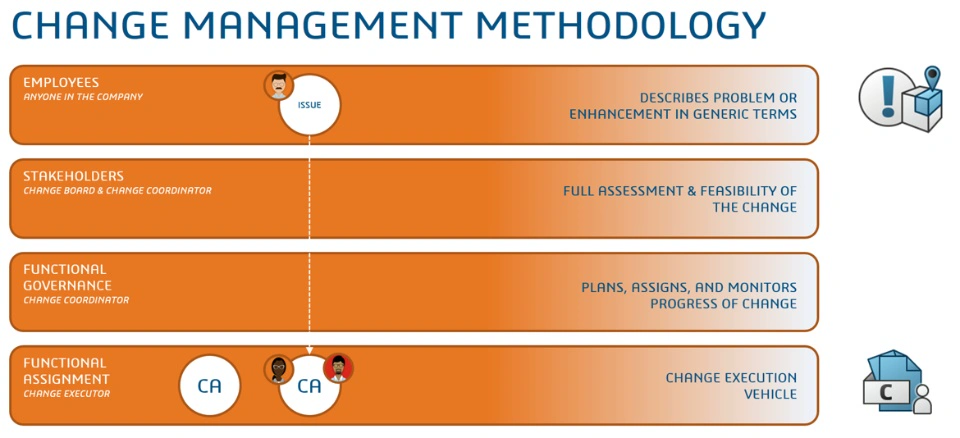

Once users are comfortable and familiar with using Change Actions, if required, the change process can be expanded further so that anyone within a company can initiate an issue related to a SOLIDWORKS design, and that issue can then be used to drive a change action. Issues are captured and managed using the Issues Management app available in the SOLIDWORKS Design roles. Issues are a great way for anyone in a company to capture and document an issue related to a design, and then share that information directly with the relevant person or department in their organization.
Expanding the Solution Beyond Change Actions
For companies operating in regulated industries that need to formally manage a high degree of change to complex products, the SOLIDWORKS PLM Professional role offers a scalable solution that expands on the capabilities of Change Actions.
Using issues in combination with SOLIDWORKS PLM Professional, issues can drive change orders, and a change order can drive multiple change actions. Issues can also govern a change request that in turn governs a series of change orders, and those change orders can drive multiple change actions.
For specific guidance related to implementing change governance, please refer to the Implementing a Formal Change Process section of this adoption guide.
