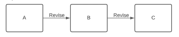

i) Differences between a revision and a version
The 3DEXPERIENCE platform requires you to select the Revise command when you want an additional iteration of your content. When saving to 3DEXPERIENCE, it overwrites the current In-Work Revision. It does not create a new version on each 3DEXPERIENCE save.

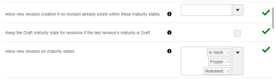

3DEXPERIENCE platform out of the box has two revision options each with a second variant. The primary can be either Numeric or Alpha. If you require the Numeric option, you can start at 1 or 0. If you select the Alpha option, you can have straight alpha that is, A, B, C.. Or you can begin with -, A, B, C and this scheme also skips I, O, Q, S. X, and Z.
i) Revision and Lifecycle States
The standard Revision increments following a release of a document, part or file. The item typically begins in an In Work state, promotes to Frozen and then promotes to Released. Settings within the Permission Rules control when you can create new revisions and at what lifecycle.

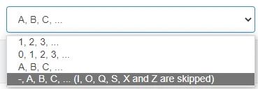

Select the Revision Scheme in the Lifecycle And Collaboration Configuration. There are three revision behaviors:
  • Primary
  • Primary and secondary
  • Primary and secondary for 3DEXPERIENCE content with SOLIDWORKS master
i) Primary
This revision format only shows the primary revision. For example, A, B, C.
The primary revision increments every time you create a revision, independent from the maturity state of the object.
This is the recommended Revision scheme.

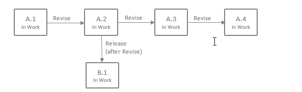

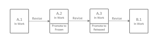

ii) Primary and secondary
In this revision format, a secondary revision displays after the primary revision in the [REVISION.#] format.
The primary revision increments every time you create a revision from the Released content. The secondary revision resets to 1. This identifies major changes.
The secondary revision increments every time you create a revision from non-Released content.
For example, the names of the new revisions of In-Work or Frozen maturity states are A.1, A.2, A.3, until Released. A revision of the Released content named B.1 follows the same revision naming rules.

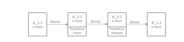

iii) Primary and secondary for 3DEXPERIENCE content with SOLIDWORKS master
In this revision format, a secondary revision displays after the primary revision before the minor revision [REVISION _#.# ]. The behavior of the primary and secondary in this scheme is similar to the primary and secondary format.
For example, the names of new revisions of in-process content are A_1.1, A_2.1, A_3.1, until A_3.1 is Released. The next revision of the Released content named B_1.1 follows the same revision naming rules.
NOTE: This is a legacy scheme and not intended or recommended for use by new customers.
When you enable either the primary or secondary revision options and you promote a revision after revising it, you create the next revision from the latest revision. The case illustrated below results in an incremented secondary revision instead of an incremented primary revision.

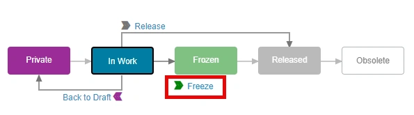

3) 3DEXPERIENCE Release Lifecycle
All object in 3DEXPERIENCE, process through a lifecycle with the default In Work, Frozen and Released states. Private and Obsolete states are available. You can manually promote and demote objects or process them with change actions.

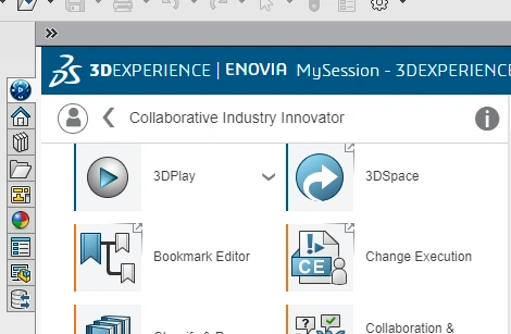

a) Creating a Stand-Alone Change Action Using the Change Execution Widget
Use the Change Execution widget to create a stand-alone CA.

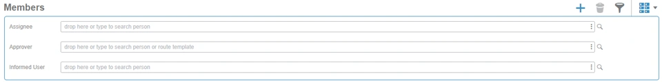

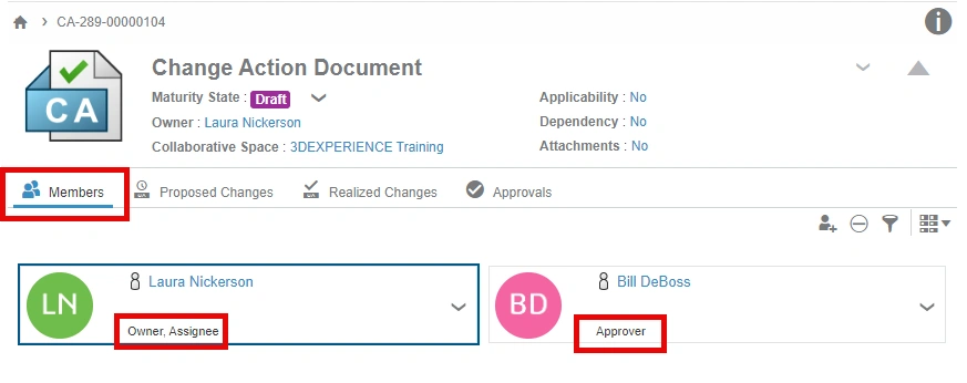

  • An Assignee is one or more individuals that you assign the CA to and who processes the changes to the documents listed on the CA.
  • An Approver typically is someone different from the Assignee and is one or more individuals who are responsible to approve the changes defined in the CA. To complete the CA, one of the listed approvers must have a Leader Role in the Collaborative Space that the CA resides in.
  • An Informed User is the person to notify when the CA completes. The user can select how you notify them. An Informed User does not have an active role in the completion of the CA. This user is only listed for notification purposes.

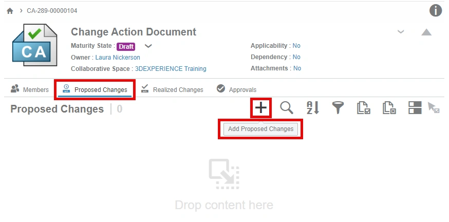

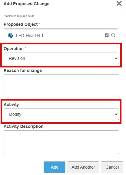

When you create a Change Action, attach a Proposed Change to the CA. The Proposed Change tab lists the objects for the CA. The Proposed object tab can contain the component or document to change as well as documentation directing what to change or create.
When adding objects to the Proposed Change tab, the Operation selection prompts you for Revision, New Branch or Modify. In the Activity selection, your options are: No Activity, Modify or Change Maturity to Release.
The Operation field is what you are trying to accomplish in the CA. The Activity field is how the CA affects the object listed in the Proposed Change tab as the CA processes.
The Operation attributes Revision and New Branch are specific attributes within an object. If you choose the Modify Operation, you most likely change the design of the object. The Operation attribute just describes what the user wants to do with the CA and the Proposed Change object. The Operation attribute does not indicate what to do; it is only a data point.
After you choose the Operation attribute, choose your Activity. The Activity attribute is the actual Activity that happens to the Operation you select. If you make changes to the object but do not want any activity to occur on the object, select No Activity. If you want to modify the object, select Modify. Below are the numerous options and their results of each combination selected.
Operation: Revision
Activity: No Activity
Result: The CA creates and completes, but the Proposed Object does not change.
Operation: Revision
Activity: Change Maturity to: Obsolete
Result: Not selectable because a Revision cannot have a maturity state change.
Operation: Revision
Activity: Modify
Result: The CA creates and a new Revision creates and automatically releases for the Proposed Object.

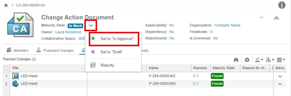

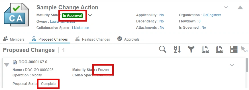

Objects in the Realized Changes must be in a Frozen state to promote the CA to In Approval. If the object is not in a Frozen state, ensure that you put it into a Frozen state to be able to move forward with the CA lifecycle.
When a CA is in the In Work state, the Assignee can work under the CA on the tasks needed to complete the proposed change. After you complete all tasks for the change, the Assignee promotes the CA to the In Approval state.
After the Approver approves, the CA is in a Completed maturity state. The proposed change now turns into a Realized Change. The user can see the Realized Change object change its maturity state to Released automatically after the CA completes.

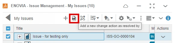

c) Creating Change Actions from Issues
You create Change Actions for several different reasons and uses. If you create an Issue within the platform, each Issue can have Change Actions created within it to resolve an Issue.
When you are within an Issue, you can select the Change Action icon from the Issue Management widget.
When you create a Change Action from the Issue Management widget, you can save the change action as a draft (Save as Draft) or go right to In Work (Begin Work). If you created the Change Action after you already worked on, it is best to begin this in the In Work state. If you create the Change Action before you complete any work, it is best to keep it in the Draft state.
When you create a Change Action from the Issue Management widget, there are two ways to access this Change Action. The first way is to use the Issue Management widget and go to the Contents tab of the Issue. You use a Change Action in an Issue to resolve the issue. Therefore, you can find the Change Action in the Resolved by section of the Contents tab in the Issue. To open the Change Action, right-click it and Open with – Change Execution.
When you create the CA from the Issue, the Members, Name and Description of the Issue all transfer to the CA. In addition, the Reported Against object also transfers to the CA as the Proposed Change. Make sure that the appropriate members are in the original Issue and the appropriate objects are in the Reported Against attribute. This ensures that all required information transfers to the new Change Action.
From there, follow the normal process as a stand-alone change action and proceed with closing out the CA.
When you create a change action from an Issue, you have the option to save the Change Action as Draft. Then you can access the Change Action from the Change Execution widget.

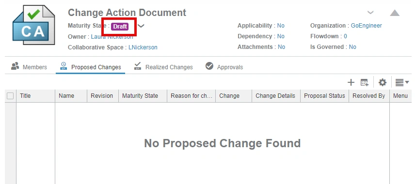

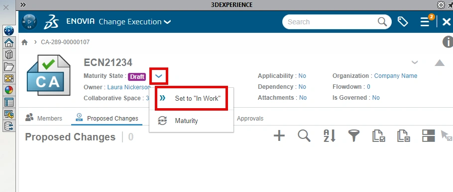

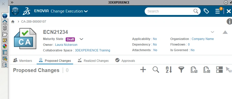

1) After you create a Change Action, you start it in a Draft state. This allows you to add appropriate Members and Proposed Changes.
2) After you create a Change Action, you start it in a Draft state. This allows you to add appropriate Members and Proposed Changes.
3) Search for the Proposed Object (or you can also drag from another widget) and make sure that you added an object that is in the Released state.
To create a new revision for an object, select Revision in the Operation field and then select Modify in the Activity field. This begins the process of creating the next revision for the Proposed Object.
At this point, you see the released object in the Proposed Changes tab. If you go to the Realized Changes tab, you do not see anything now because your CA is still in a Draft state.
After the Author or Owner of the change action reviews and confirms all proposed changes, go to the Members tab. Add the appropriate members to the CA, so there is an Assignee and an Approver.

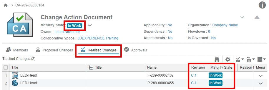

After you change the CA to In Work, a new revision for the Proposed Change object(s) creates and moves to the Realized Change tab.
Depending on the Admin settings, you may see both the CAD Family and Physical Product new revisions create as shown previously. At this point, the CA is In Work and the Assignee is working on it.

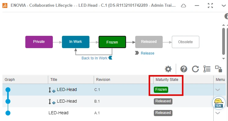

After the Assignee finishes their work on the object, they must change the maturity state of the Realized Change object to Frozen. There are two options to change the maturity state of the Realized Change.

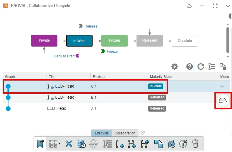

The first option is to access the Collaborative Lifecycle tools from within SOLIDWORKS (outlined in the Working Under a Change Action section).
The second option is to open the Collaborative Lifecycle widget while in the web. Search for the Realized Change object. When you promote the maturity state, verify that the object you selected is in the In Work state and is the correct revision. In both cases, you must have the Work Under active on the appropriate CA.

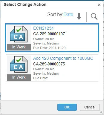

To Work Under the CA that we created, click the Hard Hat icon from the Collaborative Lifecycle widget and then click Change Action.
Find the change action that you created and then click OK. The Hard Hat icon becomes active and turns yellow to show that the Work Under feature is active.

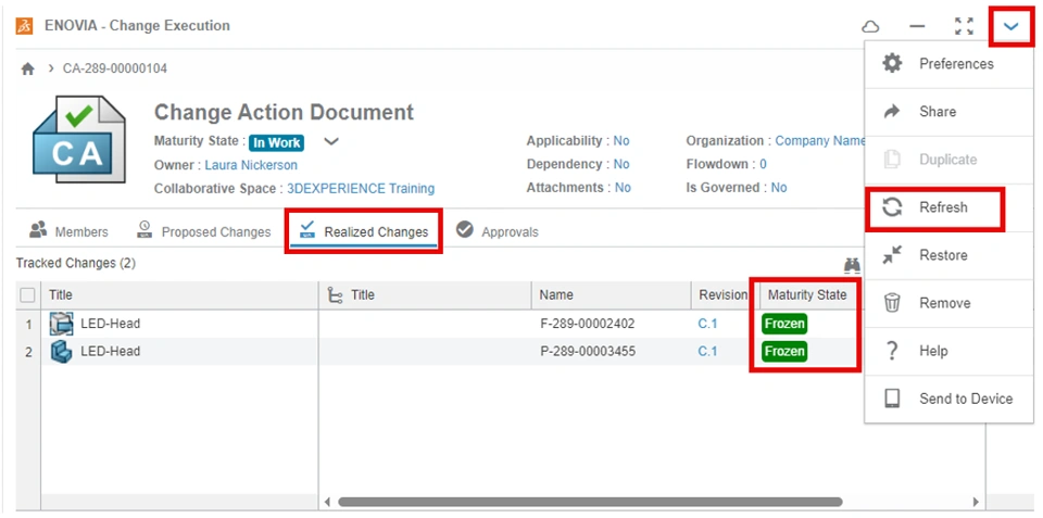

Now promote the Object to Frozen.
The object promotes to the Frozen state. After verification, click the Hard Hat icon again and turn off the Work Under feature so no other changes capture for this object.
After you are back in the CA, refresh the CA to see the changes to the objects in the Realized Changes tab.

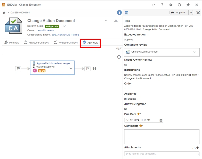

The CA is now ready for approval by the approver listed in the Members tab. The assignee changes the maturity state of the CA to In Approval to send a notification to the approver that it is ready for them to review and approve.

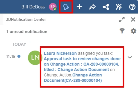

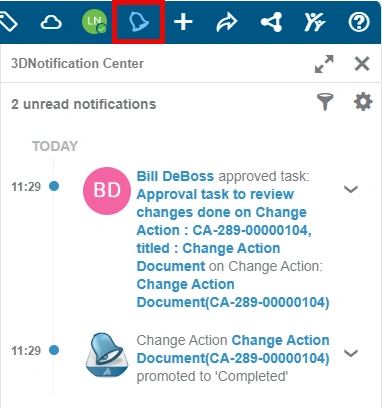

The approver receives a notification that there is a CA ready for them to approve.
The approver can click the link to the Approval task and start the task automatically with the Change Execution widget.
The approver must now enter their comments and then can Approve, Reject or Abstain the changes.
After the approver approves the CA, the notifications show that the Approval Task was approved and the Change Action completed.

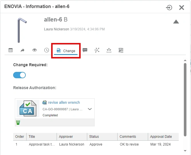

Navigate back to the CA and refresh the CA to see the final results.
The CA shows as Completed and the Realized Changes objects also shows as Released with the new revision Released through the CA process.

After the object within the CA moves to a Frozen state, the CA populates a Realized Change. The realized change object modifies or changes maturity states (whatever you chose for the operation when you created the CA), after the CA is processed to the Complete state.
9) Transferring Realized Changes
If you have other licensing (Change Management option), you can transfer Realized Changes to another CA for an early or delayed release or you can cancel a particular change.

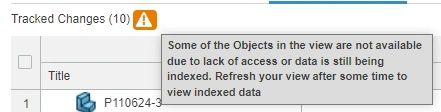

a) Refresh Change Execution often
A Change Action’s automation requires indexing to update the object’s revision, Maturity State and/or Change Required status. Displaying the updated information is not instantaneous as the warning message indicates. Refresh the Change Execution app several times to view the indexed data.
b) Ensure objects in Realized Changes are in the Frozen Maturity State
To prevent errors in the approval stage, ensure all the objects in Realized Changes are in the Frozen Maturity State.
NOTE: If the administrator enables the Change Action Auto Freeze functionality, an object will automatically be set to Frozen once the Change Action is promoted to In Approval, provided the Change Action has one or fewer Assignees.

f) Ignore and Move Objects from a Change Action
There may be circumstances where you’ve inadvertently added objects to a Change Action. For traceability, you cannot delete or remove objects from Realized Changes. You have the option to Move or Ignore the object in Realized Changes.
If the modifications resolve a different problem, the object can be Moved to another Change Action. The Move operation will relocate the object from Realized Changes to another (existing or create new) Change Action’s Realized Changes Tab.
If the object is unrelated to the Change Action, or if you want to keep certain objects unchanged while implementing modifications to others, an object can be Ignored. The Ignore operation will exclude the object from Realized Changes and the object will not be acted upon by the Change Action’s automation.
With both the Move and Ignore operations, the objects are not removed from the Change Action, they are essentially hidden in the Tracked view. The objects can be viewed in the Ignored or Moved view, depending on the operation.

h) Turn ON/OFF Change Required as needed
When an object is added to the Realized Changes Tab or is Released through a Change Action, it acquires the Change Required status. Change Required means that any revisions or lifecycle changes to the object must now occur through a Change Action. This ensures that all modifications, reviews, and approvals are tracked systematically as part of the change management process.
The Change Required setting can be turned ON proactively, manually enabled, to ensure changes to an object are captured, tracked and documented through a Change Action.
Leaders in the Collaborative Space can turn OFF the Change Required setting, allowing the object to be modified and progressed through its lifecycle without needing a Change Action.
The Change Required setting is located in the Change Tab within the object’s Information Panel. The Change Tab also displays the related Change Action(s) and the change history for traceability. This provides a clear record of the Change Action, who approved, when, and any comments, capturing all activity for accountability throughout the change process.
