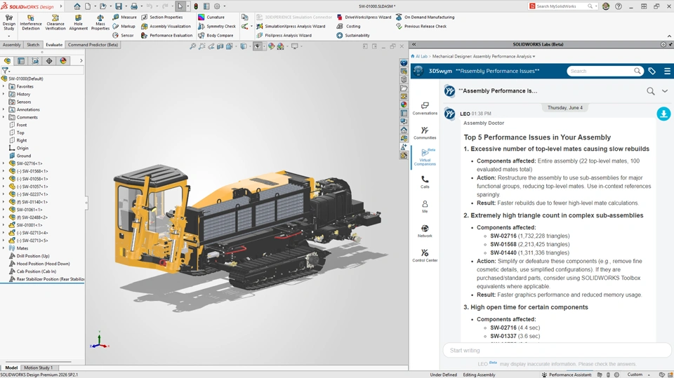

  1. In your SOLIDWORKS Design session, open an assembly from the 3DEXPERIENCE platform or from the local file system.
  1. From the AI Labs tab in the SOLIDWORKS Task Pane, select Assembly Performance Analysis.
    This starts a new conversation with LEO.

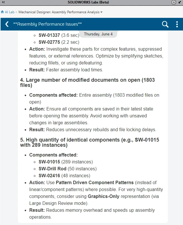

  1. To get LEO to evaluate the assembly by typing the following prompt "evaluate my assembly for performance", followed by the Enter key.
  2. After a few moments, LEO will reply with a summary report. The report will highlight any potential issues that are impacting performance related to saving, opening, rebuild times, and graphics performance.
    If any issues are found, LEO will provide recommendations on how to maximise the performance of the assembly. The recommendations are intended as guidance; it is up to the user to decide whether to make the suggested changes or not.
