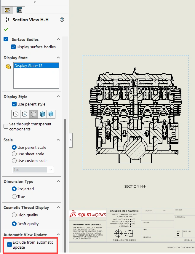

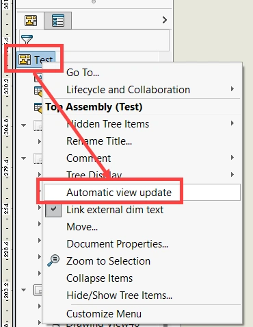

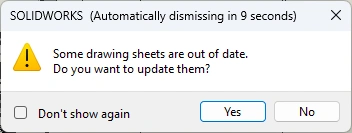

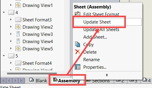

 - Controlling Drawing Updates

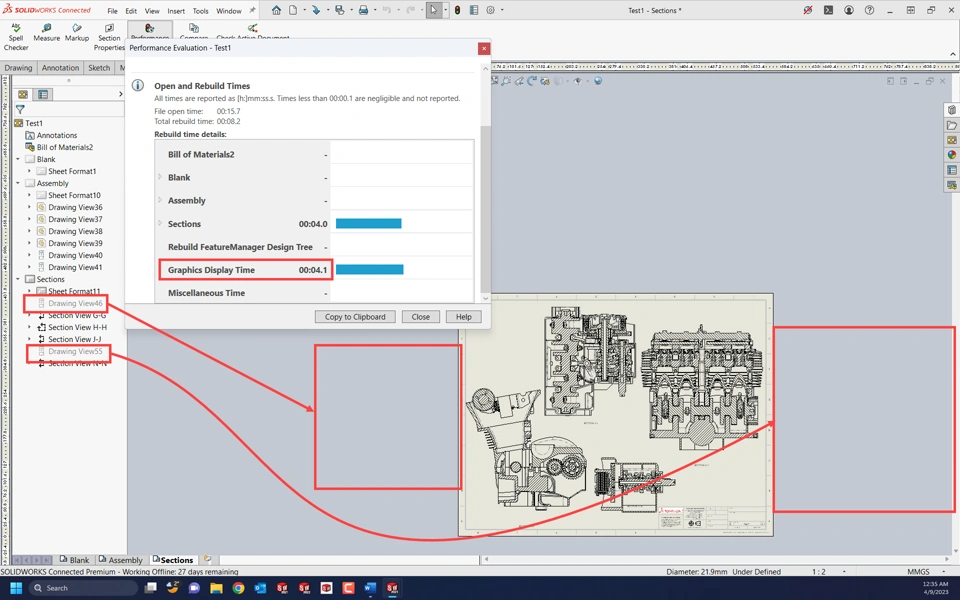

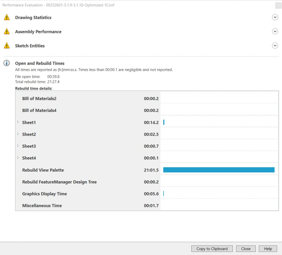

 - View Palette and Potential Impact on Update Time
 - Types of Drawing Views and Their Impact on Performance

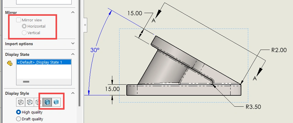

 - Configurations Versus Display States
 - Draft Quality Versus High Quality Views

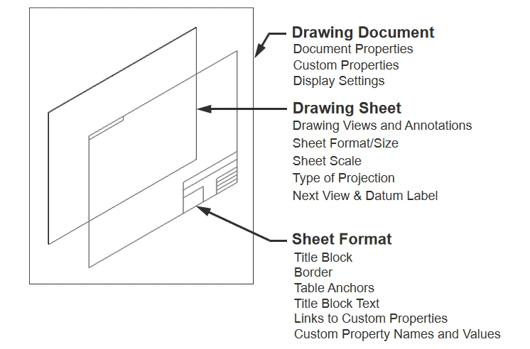

2) Structure of a Drawing Document

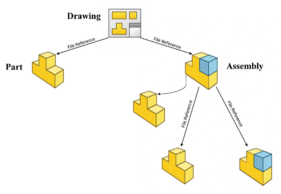

There are many types of elements that relate to drawings. Therefore, to better understand the structure of a SOLIDWORKS drawing, consider the schematic in Figure 3.
The drawing file is the main container of information. When you start a new drawing from a drawing template, the new drawing inherits all the information shown in Figure 3 from the drawing template automatically.
You can imagine the drawing sheet and the sheet format as two transparent layers that can contain information independent from each other. It is possible to update elements from both automatically using information that saves in sheet format templates.

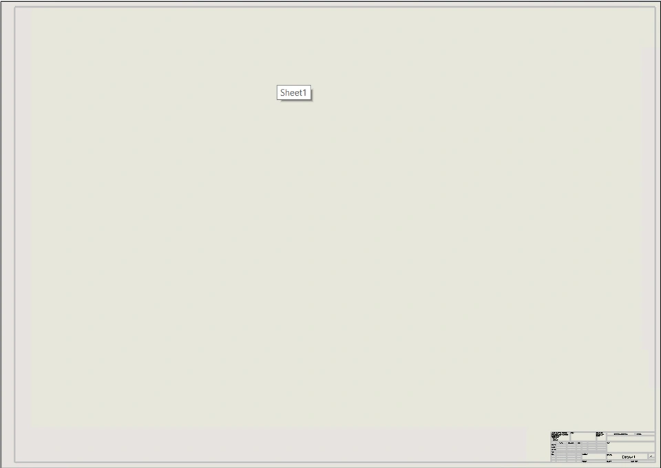

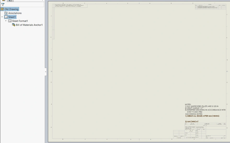

If the border on your drawing contains no zones, like the border in Figure 4, refer to section 3)b).
In cases where your border has zone information, confirm that the setup is accurate. For example, the drawing in Figure 5has zones around the border, but they produce incorrect location labels, which introduce the potential for costly production errors if a user attempts to insert such parametric labels.

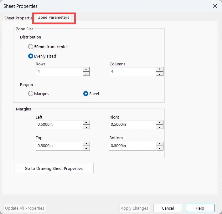

To confirm that the drawing zone of your template is properly established, start a new empty drawing and add a note containing the zone information anywhere on the sheet. For example, see Figure 6.
Move the note around the sheet and observe how the zone label updates. Does it synchronize with the zones on the border? If it is not, you have two options:
- Keep your existing border and adjust the zone parameters in the sheet properties to match the information on the border. See Figure 7.
 - Use the Automatic Border tool to recreate the border.

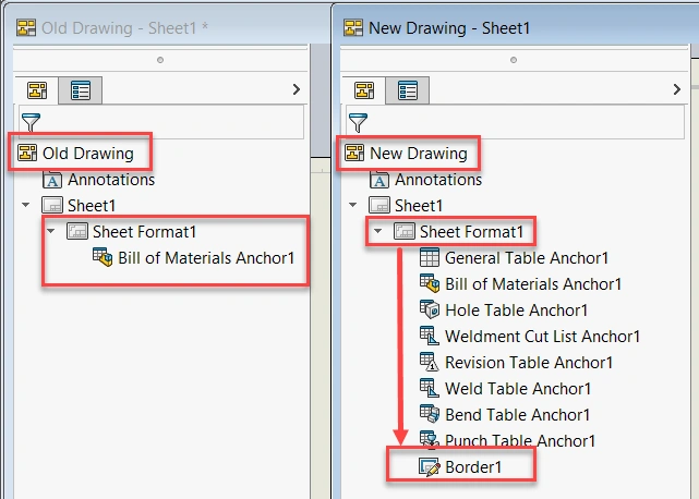

To determine if your sheet format has an intelligent border, expand the Sheet1 node in the FeatureManager® design tree. If the Sheet Format folder does not list a Border in the contents (Figure 8), you are using an inefficient drawing template.

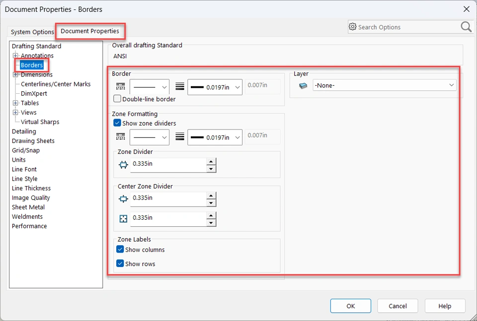

- Adjust the document properties for the border according to your company standards (Figure 9).

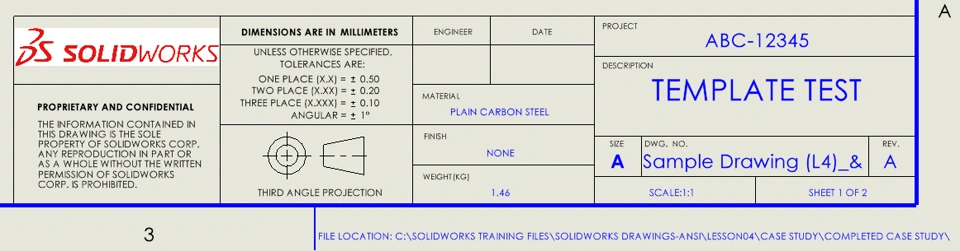

c) Title Block
Because the title block does not offer the same degree of automation as the border, if the old template has a title block, you may be able to use that template with minimal modifications.
A good introduction about how to create and customize title blocks is available in the self-guided video lesson Sheet Formats and Templates on my.solidworks.com. Be aware that you need to log in with your 3DEXPERIENCE ID to access this lesson.
Depending on the specifics of your company, you might use some or all of the following steps:

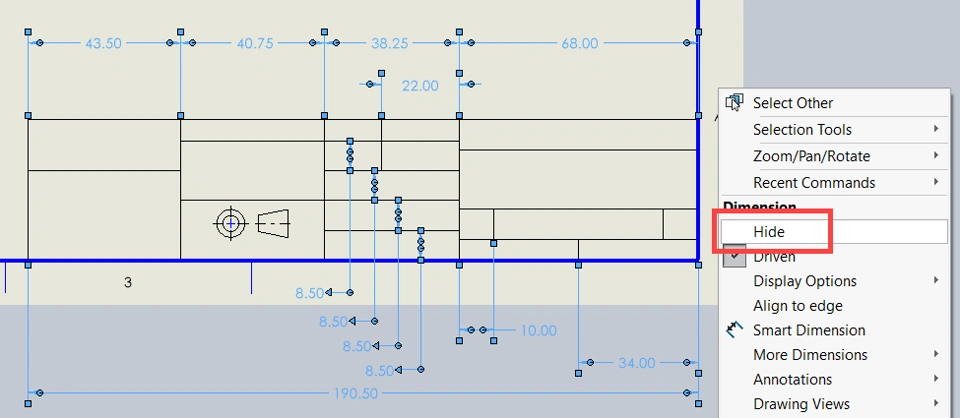

- Edit the sheet format.
 - Create the border. See section 3b.
 Draw sketch lines to define the title block and use relations and dimensions to constrain them.
- Hide all dimensions that relate to these lines:
- Select one dimension.
 - Press Ctrl +A to select all dimensions.
 - Right-click the selection.
 - Select Hide.

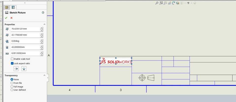

- Optionally, you may use Insert > Picture to insert a company logo. Resize and relocate the logo as required.
- Add notes and link them to custom properties as required. For more information about how to do this, see section 4.
Optionally, you may use the Title Block Fields command to select a number of notes as title block fields. After selecting these notes, you can edit them directly from the sheet focus. You do not need to edit the sheet format to access the notes.
d) Table Anchors
In the sheet format, you can define the default anchor locations for several types of tables:
| General Table Anchor | Revision Table Anchor | ||
| Bill of Materials Anchor | Weld Table Anchor | ||
| Hole Table Anchor | Bend Table Anchor | ||
| Weldment Cut List Anchor | Punch Table Anchor |

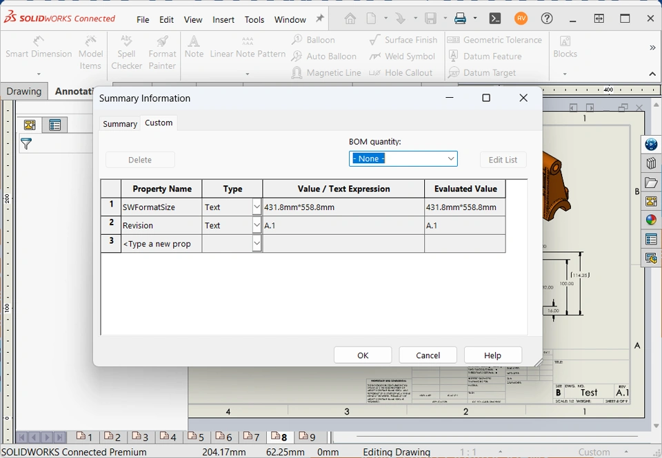

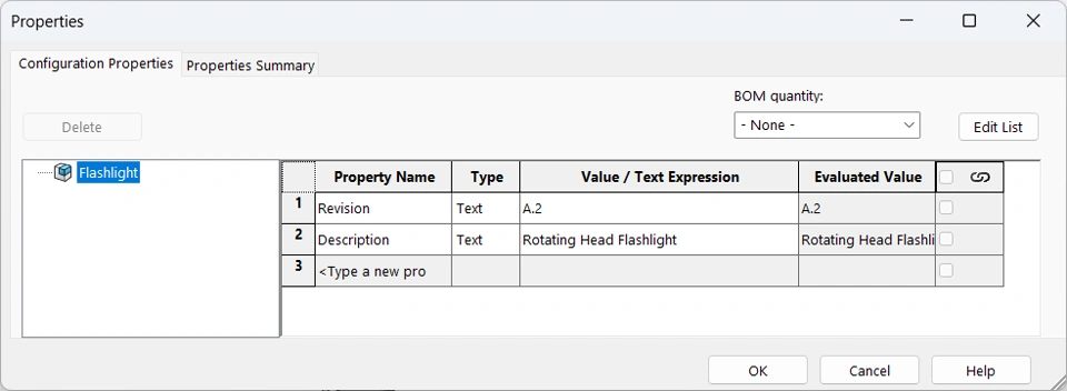

4) Use of Custom Properties in Drawings
When working with drawings, custom properties are essential for maximizing efficiency. The optimal usage follows the “Single Source of Truth” principle. In other words, enter the value for a custom property once, in one place, and refer to it anywhere else.
This document uses the term custom properties to refer to all metadata within each SOLIDWORKS file, including the configuration properties. This is important to know because in 3DEXPERIENCE SOLIDWORKS, all properties are configuration properties.
There are multiple ways to create custom properties and modify the property values, including but not limited to:
- SOLIDWORKS PDM data cards – This is the method that SOLIDWORKS PDM users prefer.
 - PLM attributes – This is the method that 3DEXPERIENCE users prefer.
 - Property tabs – This is the method that non-PDM users prefer.
 - File > Properties menu
 - Editing bill of materials (BOM) cells (link values)
 - Title block fields
 - Design tables
To determine at what level to locate a custom property, consider the associativity between parts and assemblies of various levels and drawings.
It is possible to link to custom properties that exist in other files if those files are lower in the file reference chain, not higher.

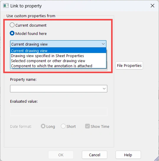

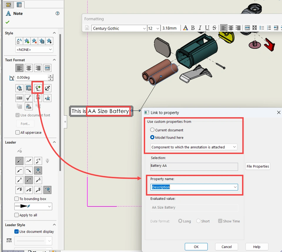

a) Custom Properties in Notes
You can use the Link to Property function in the Note Property Manager to parametrically include custom properties in notes.
You can extract the property value from:
- Current document (drawing)
 - Model referred by the current drawing view
 - Model referred by the drawing view specified in the sheet properties
 - Selected components
 - Component to which the annotation is attached
- For example, the note in Figure 21 includes the Description property value of the component to which the note is attached.

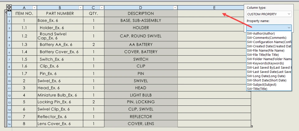

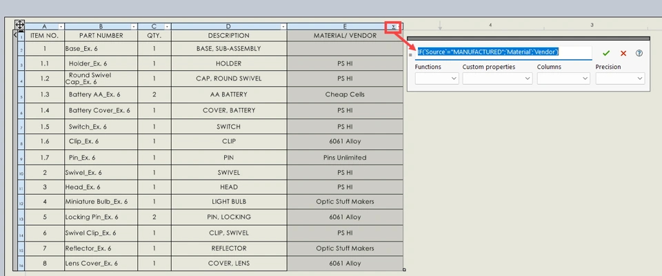

b) Custom Properties in the Bill of Materials
You can select any property from any component of the assembly as a column header.
You can also use the values of custom properties in BOM formulas, including as decision criteria.
In the column E of Figure 23, if the value of the property Source is MANUFACTURED (case sensitive), then the cell links to the value of the property Material, otherwise the value of the property is Vendor.

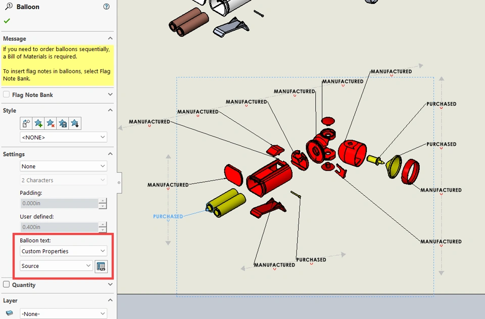

c) Custom Properties in Balloons
Balloons can refer custom properties. Figure 24 depicts a good example of using an efficient process to quickly document the sourcing of the assembly components. In this case, the Auto Balloon tool was used to populate all the notes with the Source property values attached to each component.

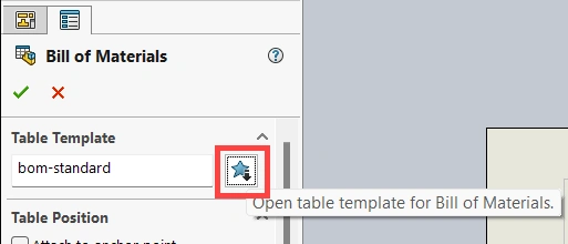

5) Table Templates

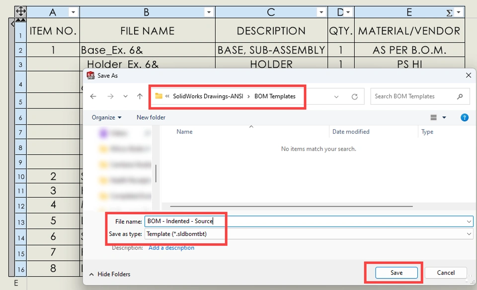

To save time and foster consistency within your team, customize templates and save them in a shared templates location for frequently used tables. SOLIDWORKS allows saving templates for the following types of tables:
| Table | File Name Extension |
| General Table | .sldtbt |
| Bend Table | .sldbndtbt |
| Bill of Materials | .sldbomtbt |
| Hole Table | .sldholtbt |
| Punch Table | .sldpuntbt |
| Revision Table | .sldrevtbt |
| Weldment Cut List | .sldwldtbt |
| Weld Table | .sldwldtbt |
| Title Block Table | .sldtbt |

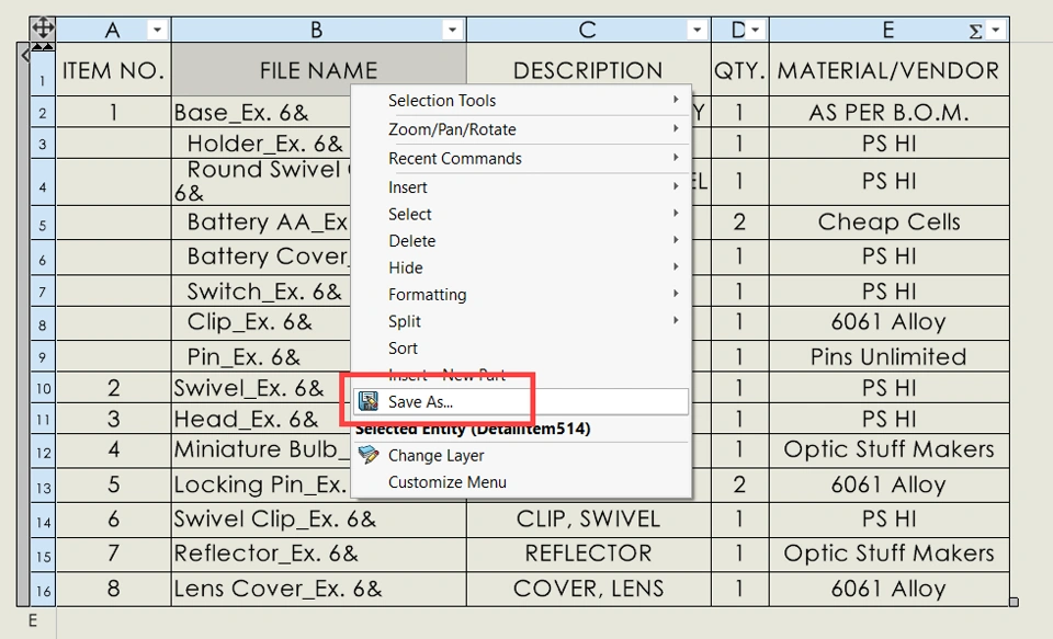

To create and save a table template, follow these steps:
- Create and customize a table according to your company standards.
 - Right-click anywhere in the table and select Save As.
- Select Template as the file type then browse to the shared folder and save the file.
When users insert a new table, they typically click the Open table template icon to browse to the location of the template that they want to use.

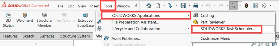

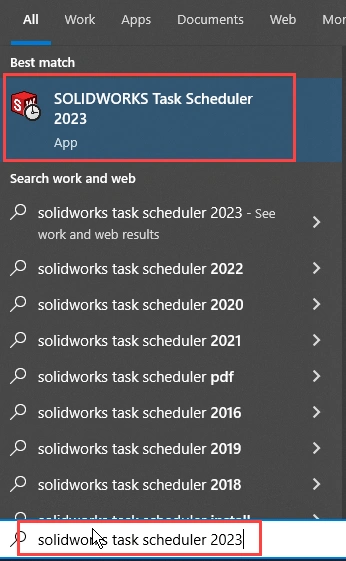

a) Starting SOLIDWORKS Task Scheduler for SOLIDWORKS Desktop
If you have a SOLIDWORKS 3D CAD installation (the traditional desktop version), you can run the SOLIDWORKS Task Scheduler directly from a Windows® Search (Figure 28).
b) Starting Task Scheduler for 3DEXPERIENCE SOLIDWORKS
If you are using 3DEXPERIENCE SOLIDWORKS, start the SOLIDWORKS application first. The Task Scheduler is available from the Tools > SOLIDWORKS Applications menu (Figure 29).

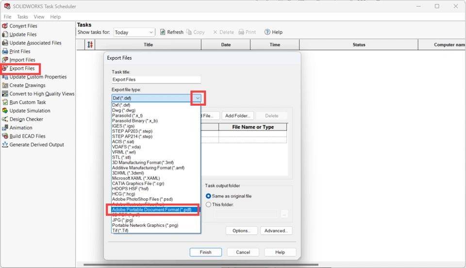

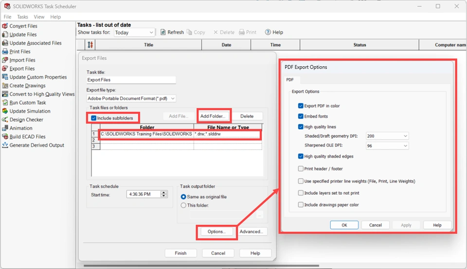

c) Example: Saving all Drawings from a Folder in PDF Format
To save all drawing files from one or more folders, follow these steps:
- Start an Export Files task.
 - Select the Adobe Portable Document Format (*.pdf) file type.
- Click Options and then adjust the export settings.
- Specify the start time and then click Finish.

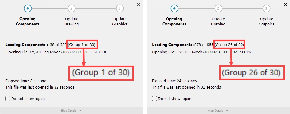

When users complain that a certain drawing is large or slow, they usually refer to these three major symptoms:
- Long opening time
 - Lag when performing various tasks after the opening a drawing
 - Long saving times
For existing drawings, you can greatly mitigate such symptoms by asking a critical question:
Why do I need to open this drawing?
The answer to this question allows you to match any task with the most efficient mode of opening a drawing.

There is a simple fact that explains the recommendations in Table 3; “A drawing opens faster if the minimal amount of data is loaded in the RAM.”
Most users open drawings by double-clicking the file name in Windows File Explorer or from the SOLIDWORKS PDM add-in. That action causes a drawing to open in either Lightweight mode or Resolved mode, depending on the system options. Both of the modes require that the assembly first opens in the RAM.
As shown in Figure 33, opening the assembly starts multiple computation phases. All of these phases are time consuming.
For most tasks in Table 3, the information required already exists in the drawing. For example, if the drawing is in a released state, opening its assembly is even counterproductive because it can potentially trigger an update of the drawing views.
The following sections examine each of the opening modes.

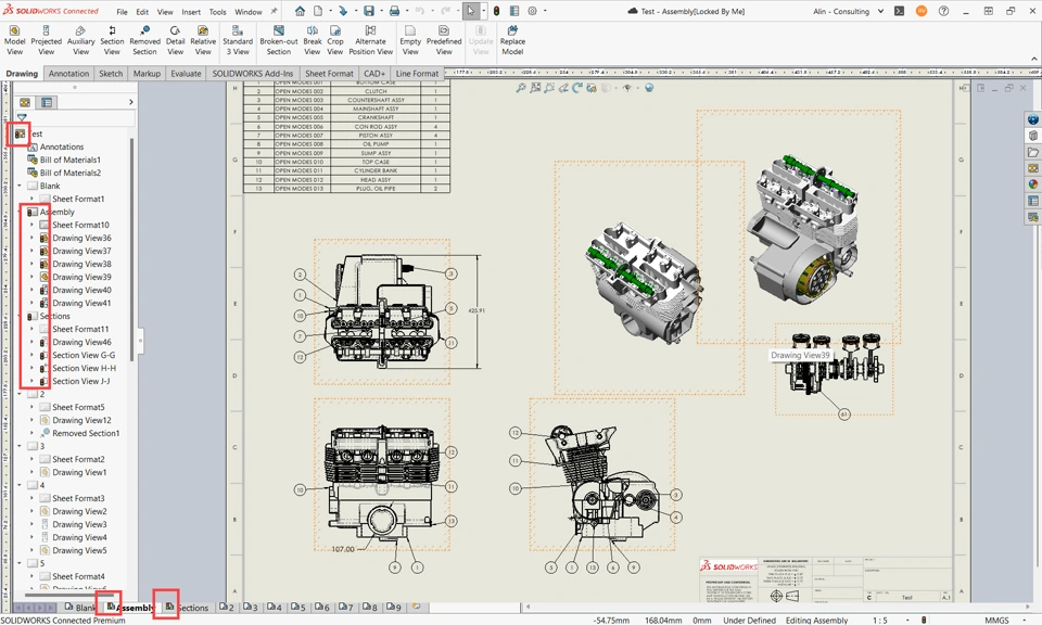

a) Detailing Mode

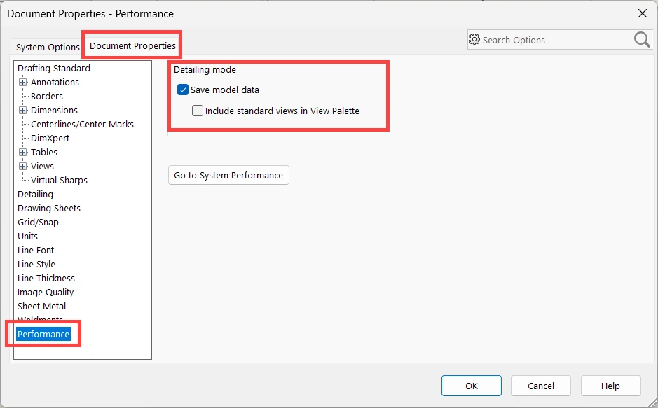

If the Save model data option is active in the Document Properties >Performance options (Figure 34), more information saves in the drawing file for each drawing entity. This allows the drawing to open for detailing operations without loading the model into RAM.
The only file that is required for working in this mode is the drawing file. This opens interesting opportunities for collaboration with third-party associates.
i) Functionality
When a drawing opens in Detailing mode, the operational speed is optimal. There is no lag when switching sheets, zooming in or out or when panning or selecting entities.
An impressive number of tools are available to:
- Edit file properties
 - Edit document properties including the drafting standard
 - Add, edit or delete layers
 - Add, move or delete sheets
 - Edit sheet properties including the sheet format
 - Add standard views from the View Palette (if they were saved in the drawing file)
 - Add detail views of existing views
 - Break or crop existing views
 - Add empty views
- Provide access to most detailing tools. As the software evolves, more tools become available. It is a recommendation to review the tools that become available with each new release.
- AddHoletables andRevisiontables

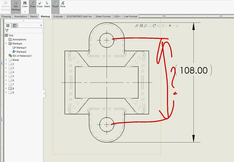

 - Add, edit or delete markups
- Use the Design Checker to ensure that a drawing complies with the company standards.

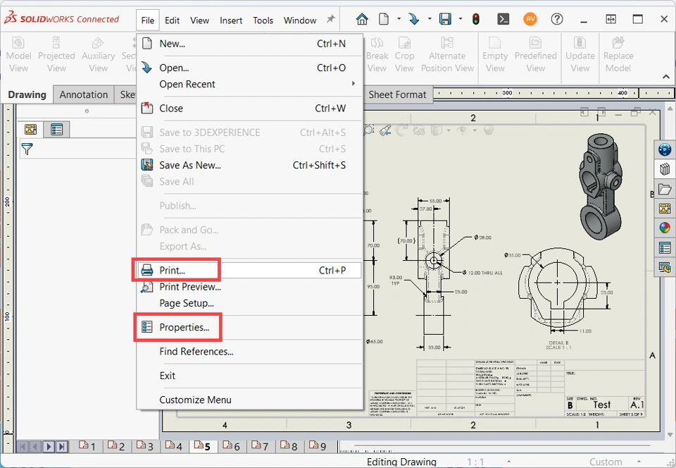

 - Print: If the drawing is in an approved state (read-only), opening it in Detailing mode is the best way to ensure that what prints corresponds to what was approved.
- Read and edit file properties: Only the properties of the current file are accessible in this mode. You cannot access the properties of the referred models because the model does not load.

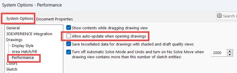

To avoid an automatic update when opening a drawing, clear the check box for the Allow auto-update when opening drawings option in System Options > Drawings > Performance
With this option inactive, if there is a modification to the model, you receive a warning. To postpone the update, click No.
After the drawing loads, sheets and drawing views that are out-of-date are highlighted in the FeatureManager design tree, on the status bar and in the graphics area.
At this point, you can decide which drawing views or sheets require an immediate update.
i) Updating all views from a sheet
To update individual sheets, right-click the sheet and select Update Sheet.
In the example shown in Figure 43, the user postponed the upgrade of the Sections sheet because of work being performed on the current sheet.

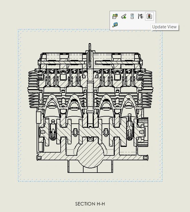

c) Control Updates of Individual Views

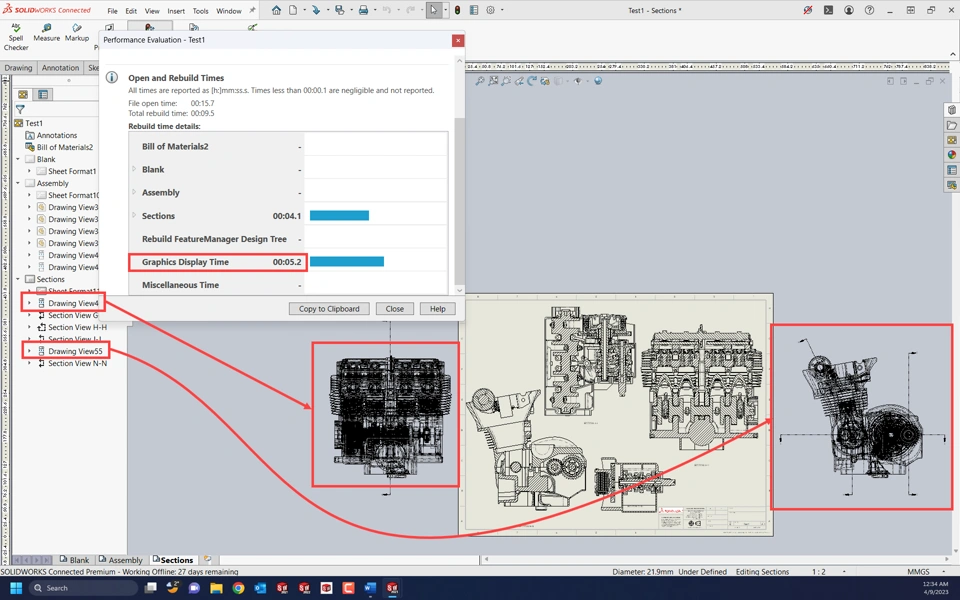

Some drawing views take more time to update than others. You can use the Performance Evaluation tool to generate a report that contains the rebuild times for both sheet and drawing view levels.
For example, in Figure 46, Section View H-H takes the most time to update. You can exclude this view from automatic updates by activating the Exclude from automatic update option in the PropertyManager of the view.
Excluding complex views from automatic updates allows you to work efficiently when making frequent modifications to assemblies and drawings.
The good news is that saving the drawing triggers the update of all views. Therefore, the drawing is up to date after saving.
9) View Palette and its Potential Impact on Update Time
If a drawing refers to a complex model with many saved orientation views, rebuilding the View Palette can increase the opening and update times significantly.
To troubleshoot this problem, use the Performance Evaluation tool and review the Rebuild View Palette time. If the time for this task is not acceptable, deactivate the automatic rebuild of the View Palette.

i) Drawing Open Progress indicator
When a drawing opens, each individual set of configuration data that loads into the RAM appears as a Group in the Drawing Open Progress indicator.
For example, if you know that the drawing for Figure 50 refers only one assembly file, it means that at least 30 drawing views show either a different configuration or a section view. As mentioned in section 10), each section view generates a supplementary configuration in the RAM.

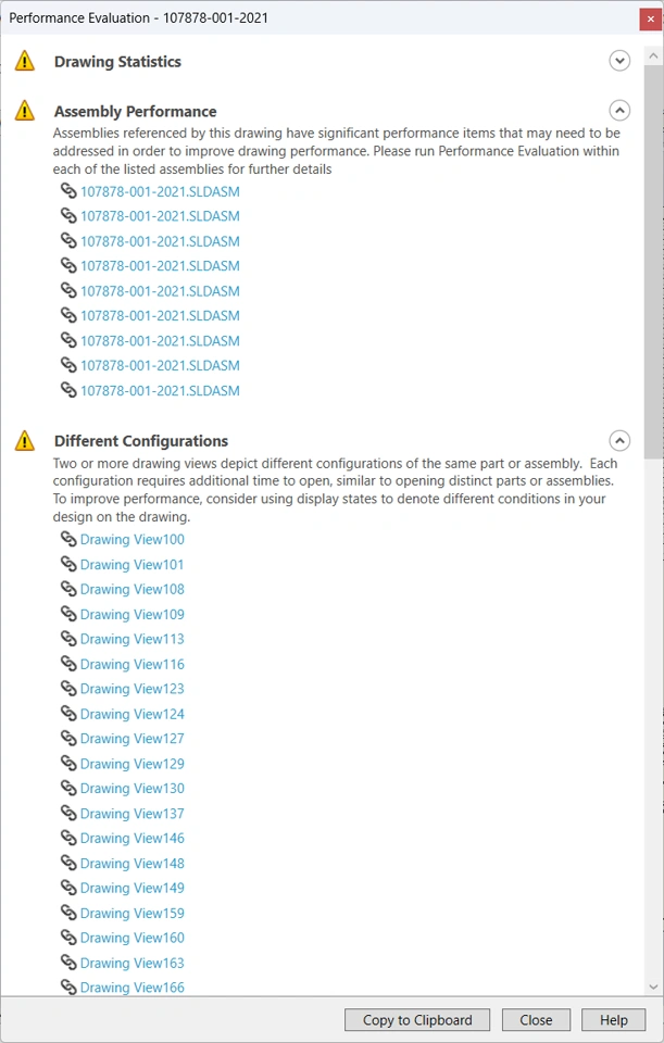

ii) Performance Evaluation tool
The Evaluate > Performance Evaluation tool in a drawing has two areas that could show (Figure 51):
- Assembly Performance: Displays the number of assembly loads into RAM.
 - Different Configurations: Displays drawing views that refer to different model configurations.

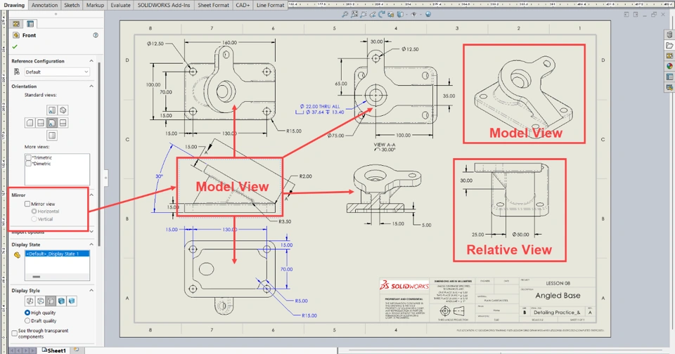

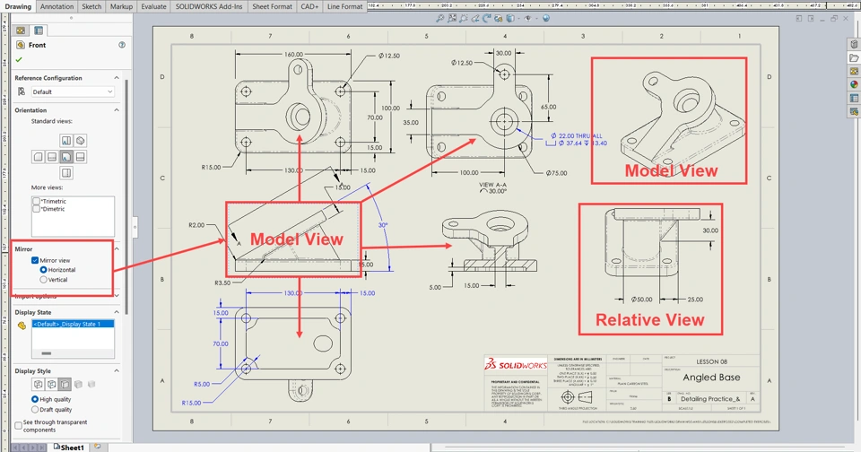

13) Mirror Existing Drawing Views
If your company procedures permit, in situations where you need to create 2D drawings for pairs of symmetrical products (left and right hand) from only one 3D model, you can use the Mirror drawing view options to save time.
In Figure 54, the only views that require mirroring are the independent views: two Model views and one Relative to Model view.
As shown in Figure 55, all derived views are mirrored automatically according to the options specified for the parent view.
Views represented with the Shaded or Shaded With Edges display styles cannot be mirrored.

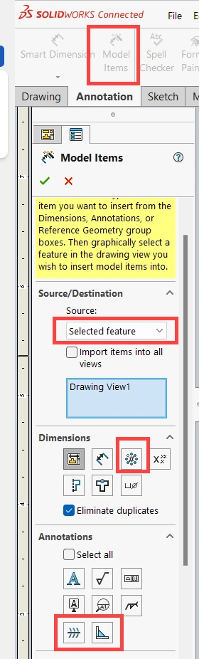

a) Annotation Views
Annotation views are useful to collect relevant product and manufacturing information (PMI). PMI includes entities like the dimensions and annotations in a model (part or assembly), and assigns them to a specific orientation.
i) Creating Annotation views
SOLIDWORKS creates some annotation views automatically, when a user adds dimensions or annotations parallel to a standard drawing view. A user can add others manually and the user can add, remove or move dimensions between existing annotation views.
As a starting point in learning more about using annotation views, you can view the self-paced Annotation Views video training lesson on my.solidworks.com.
After defining annotation views in the model, you can use the views to automatically populate the drawing views with PMI.
ii) Updating the PMI on drawings after revising Annotation views
When adding, editing or removing dimensions and annotations from the model annotation views, it is easy to update the corresponding drawing views.
After modifying the annotation views, the first perform a Rebuild of the drawing or Refresh of the view palette runs the Annotation Update command. While this command is active, previously hidden annotations and modified annotations appear as gray in the existing drawing views. Right-click the annotations to display them.
Be aware that you can access hidden dimensions anytime using the Hide/Show Annotations command.
Another way to run the Annotation Update command is by following the two steps from Figure 62:
- Click the Sheet tab.
 - Click the PropertyManager tab.

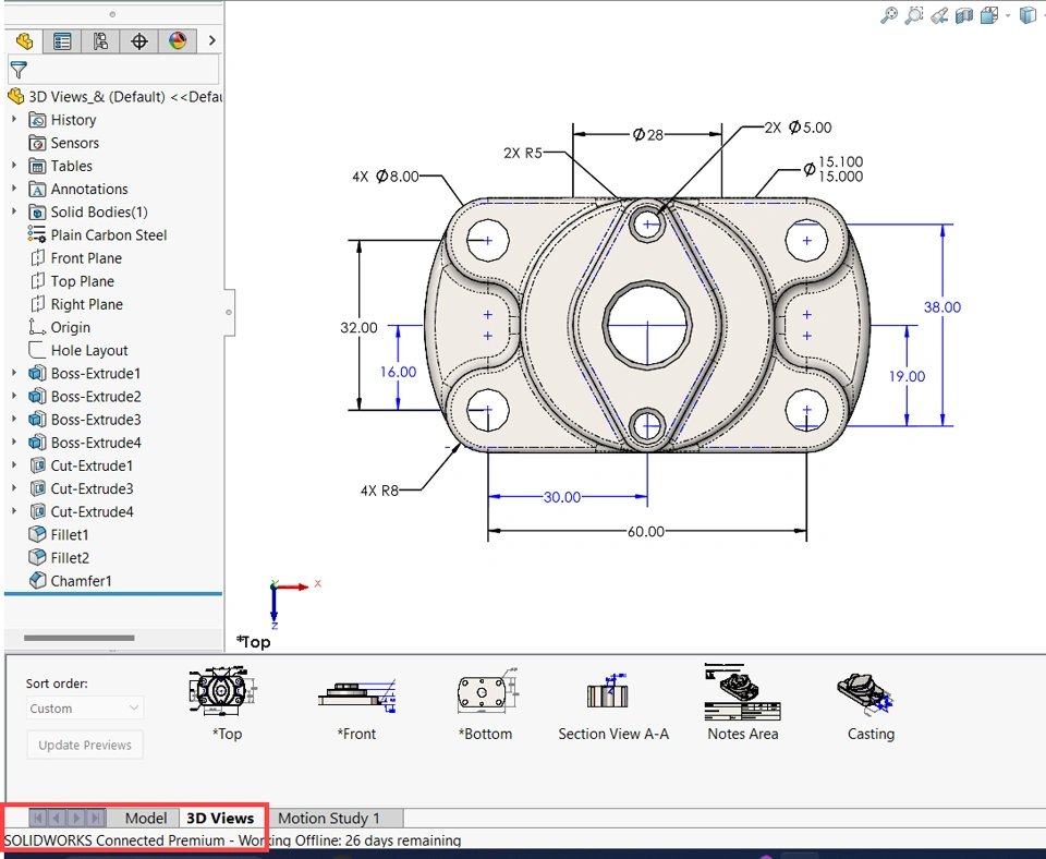

b) 3D Views
3D views are the best tools to capture multiple settings such as the following and save them under one name:
- Orientation
 - Annotation views
 - Configuration
 - Display State

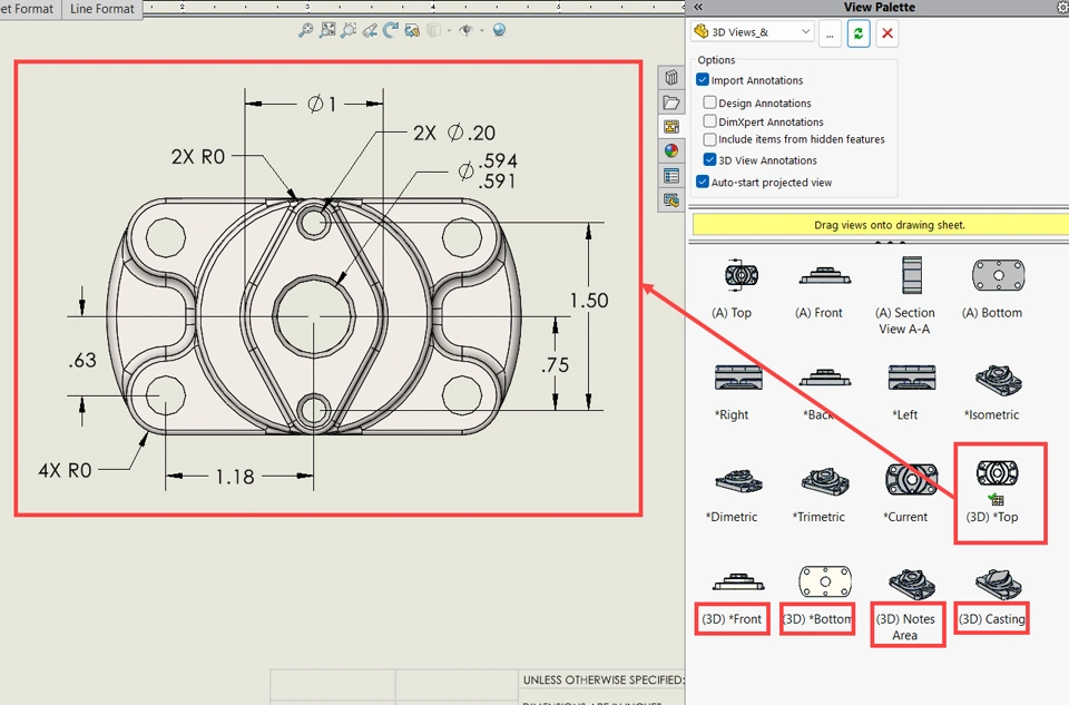

To create 3D views, you must have a license for the SOLIDWORKS MBD application. Be aware that at this time, SOLIDWORKS MBD is not available to users of 3DEXPERIENCE SOLIDWORKS.
After creating a 3D view, the view is accessible to all SOLIDWORKS users, regardless of the type of license.
You can learn more about 3D views on my.solidworks.com.
You can insert 3D views in 2D drawings as drawing views by dragging the views from the View Palette to the drawing sheet as shown in Figure 64.
c) Model Items
You can use the Model Items command to perform further customizations when inserting model dimensions and annotations in the drawing views. For maximum efficiency, consider using Annotation views first and Model Items second. The Model Items functionality includes:
- Adding dimensions for selected features
 - Adding annotations that annotation views do not recognize, such as:
- Pattern instance counts
 - Caterpillar
 - End treatments

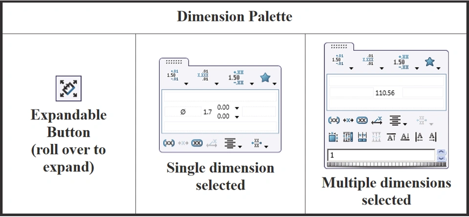

iii) Dimension Palette
The Dimension Palette is a productivity enhancer that you can incorporate in the “Stay in the Flow” modeling workflow described in section 3 of the Efficient Modeling SolidPractices document.
Simply select one or more dimensions and an expandable button appears next to the cursor. It provides shortcuts to some of the most commonly used dimension properties as well as additional settings for arranging and aligning dimensions.
16 Tables
The topic of tables in drawings is vast. This document attempts to briefly cover as much as possible. For maximizing efficiency, the best practices for customizing the environment and ensuring a unique source of truth described throughout this document also apply to working with tables.
- Use table templates as per your company standards.
 - As much as possible, use the parametric metadata from the models to populate table cells.
For more information about tables, watch the video lessons available from my.solidworks.com, including:
- Bill of Materials
 - Custom Properties in BOM Tables
 - Equations in a Bill of Materials Table
 - General Tables and Hole Tables
 - Weldment Drawings

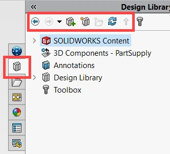

17 Design Library
One of the best ways to eliminate duplicate work and foster consistency in your team is to save the most frequently used drawing elements in adesign library. For example:
- Annotation styles
 - Notes
 - Blocks
 - Symbols

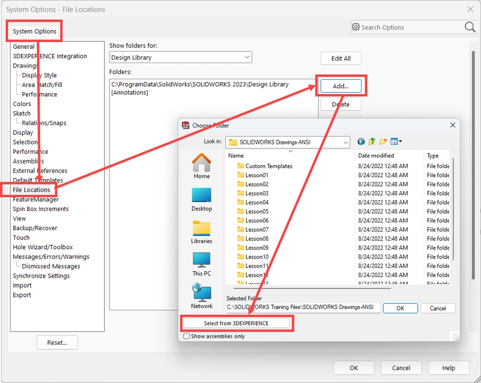

An easy way to configure and interact with these libraries is from the Design Library tab in the Task Pane.
The Design Library provides a central location for reusable elements including annotations. In Figure 68, the grey Design Library
folder is located on the local computer or on the network. The blue Annotations folder is a 3DEXPERIENCE bookmark.
| Design Library | Subfolders populated by SOLIDWORKS with reusable items such as parts, blocks and annotations. You can add folders and content. | |
Connected Design Library (3DEXPERIENCE users only)  | Provides access to content from the 3DEXPERIENCE platform by means of the Task Pane. For more information, see Connected Design Libraries. |
To add bookmarks in the Design Library, use the System Options shown in Figure 69.
