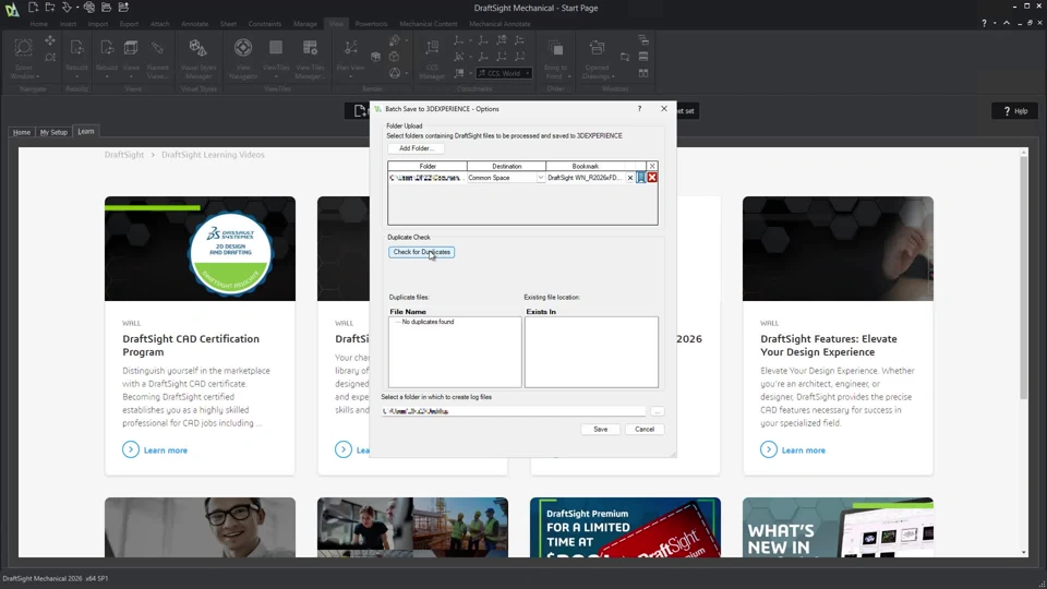

Batch Upload: Folder-to-Bookmark Structure Sync
Seamless data transitions enable you to maintain your existing workflows as you move to the cloud. By mirroring local directory structures in a designated bookmark, the upload process becomes predictable and hands-off, eliminating the need to reorganize files after the transfer.
  •  Applicable to DraftSight Premium, Mechanical, and Collaborative Designer for DraftSight only

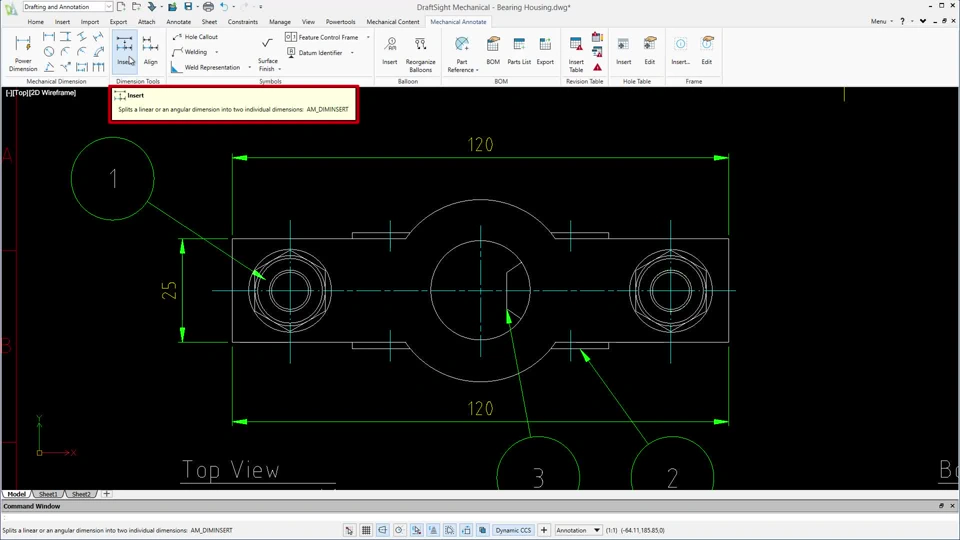

Dynamic Dimension Segmentation
Optimize annotation workflows with the AM_DIMINSERT command, which lets you split linear or angular dimensions into segments instantly. The tool automates property inheritance, ensuring that new segments maintain the original’s tolerances, fits, and layer assignments for total documentation consistency.
•    Applicable to DraftSight Mechanical only

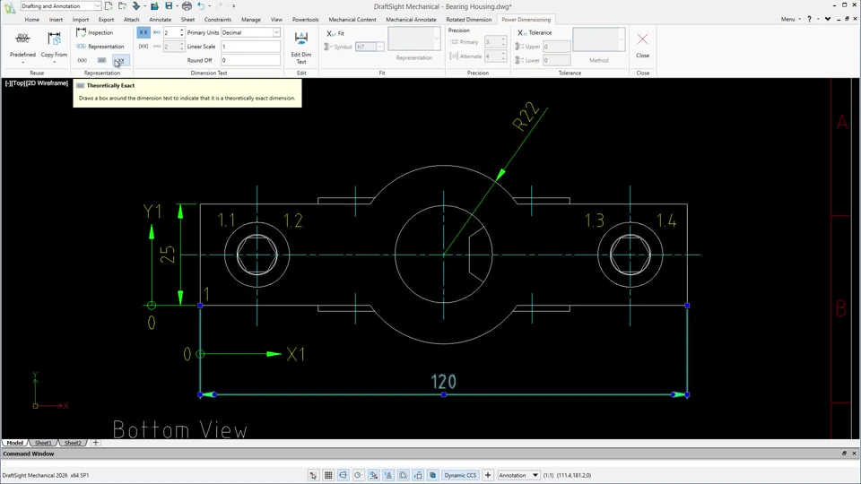

The New “Representation” Panel for Power Dimensioning
Automate technical annotations using the Representation panel to instantly apply standardized visual tags—such as reference, theoretically exact, and inspection indicators—to dimensions. This eliminates manual text overrides and ensures compliance with mechanical drafting standards by embedding design intent directly into the dimension properties.
