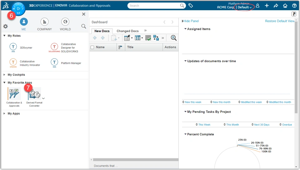

The Collaborative Spaces Configuration Center app is most commonly accessed by means of the Content tab of the Platform Management dashboard. You can also access this app by opening the Collaborative Spaces Control Center app from the Compass.

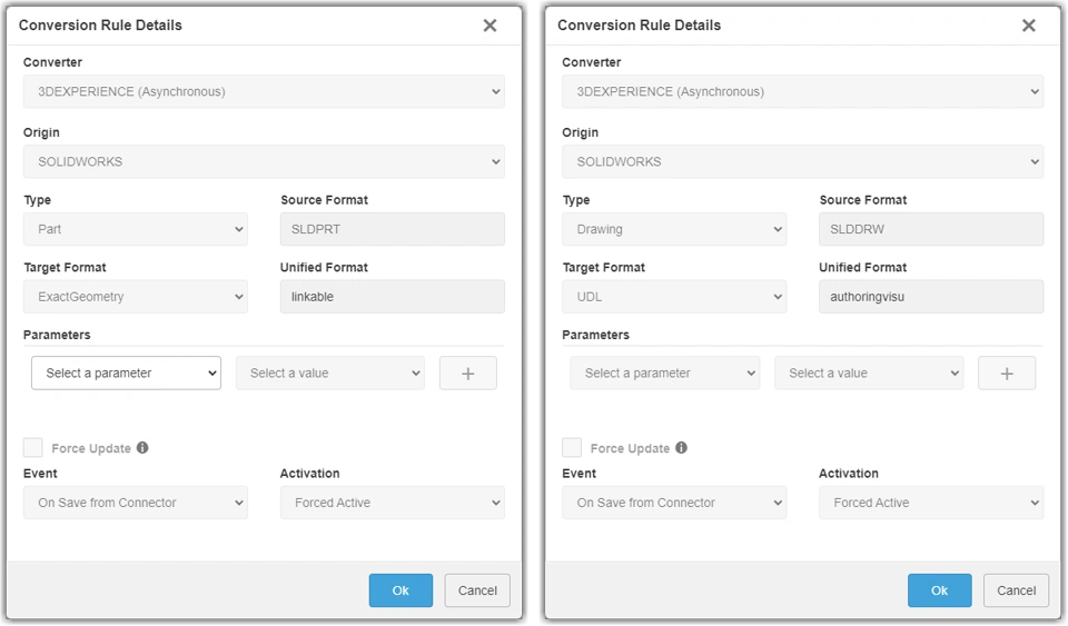

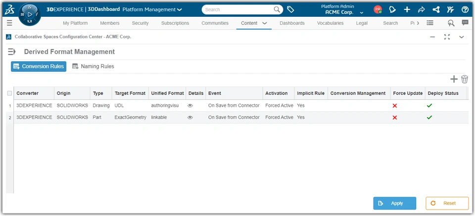

All new tenants have two implicit, asynchronous conversion rules:
Figure 2 - Click Modify Filter to hide and show implicit conversion rules. Right-click any column header to hide and show columns and customize the table display. NOTE: The system does not save table customizations.
Figure 3 - Default, implicit, asynchronous conversion rules
Figure 4 - Details of the default, implicit, asynchronous conversion rules
These two conversion rules are implicit or hidden. Never delete them. The ConversionAdministration Cloud Service processes these rules. They are responsible for the following functionality:

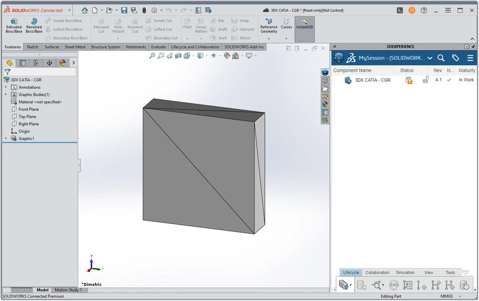

  1. Thumbnail previews for Physical Product and Drawings, as shown in 3DSearch, Properties, and Bookmark Editor.
    • The system uses the CATIA Graphical Representation (CGR) data within the ExactGeometry derived output to generate thumbnail previews for part Physical Products. The system post-processes thumbnails for assembly Physical Products. It combines the part Physical Product CGR data to construct the assembly thumbnail.
    • The system uses the Universal Drawing Light (UDL) derived output to generate thumbnail previews for Drawings.

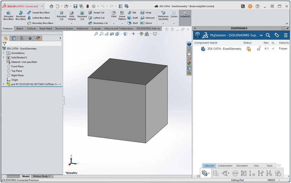

  2. 2D and 3D previews for Physical Products and Drawings, as shown in 3DEXPERIENCE platform viewer apps like 3DPlay, 3D Navigate, and 3D Markup.
    • When you open Physical Products, the CGR data within the ExactGeometry derived output loads.
    • When you open Drawings, the UDL derived output loads.
  3. 2D and 3D data used to generate other derived output. See section 6) Derived Output for more information.

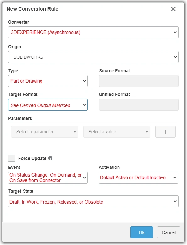

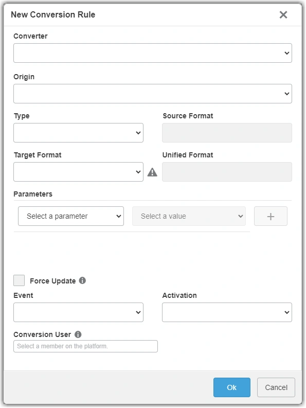

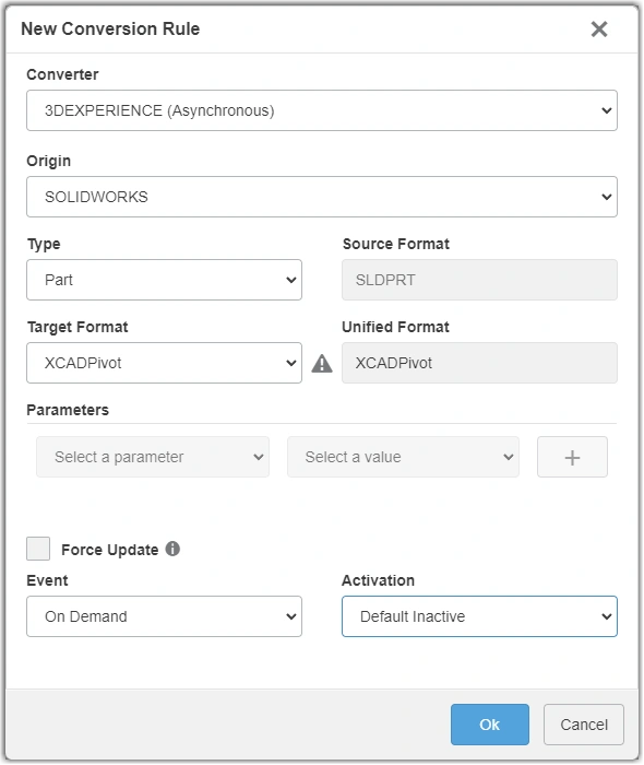

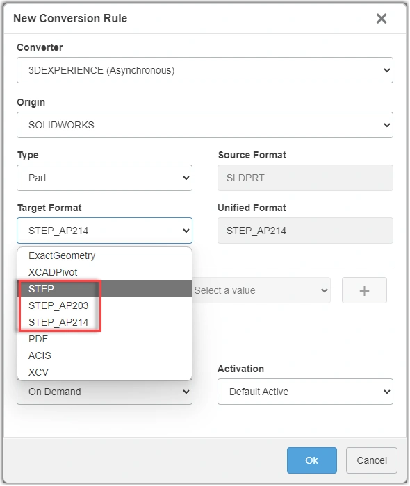

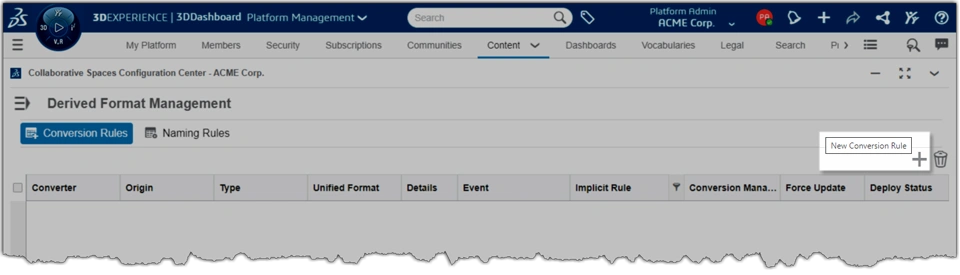

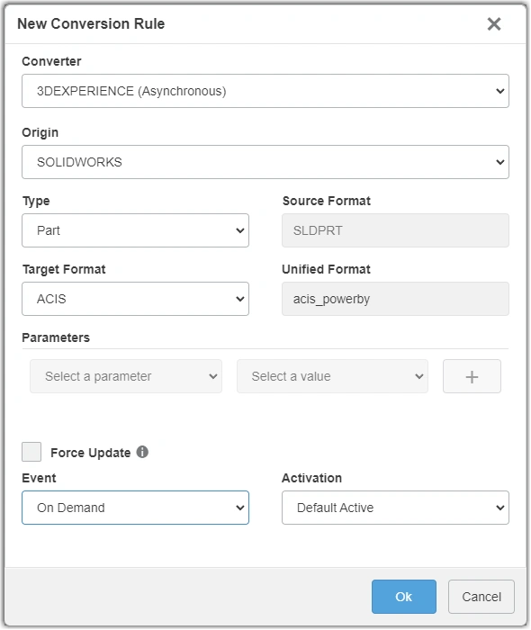

To add conversion rules, in the Derived Format Management console,
  1. Click New Conversion Rule:
Figure 6 – The New Conversion Rule icon.

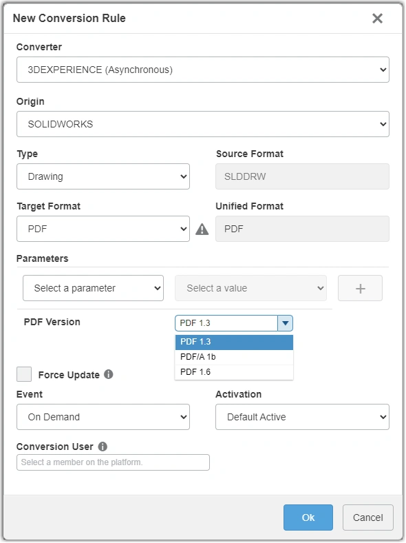

2. Define the conversion parameters.
The following parameters are available for synchronous and asynchronous rules:
Figure 7 - Blank conversion rule dialog
  • Converter: The application that generates derived output.
  • Origin: The source of your CAD data. For this document, SOLIDWORKS or 3DEXPERIENCE.
  • Type: The CAD document type, part or drawing.
  • Target Format: The file format that you want to generate.
    The following parameters are only available for asynchronous rules:
  • Parameters (Optional): Only for some formats.
  • Force Update (Optional)
  • Event
  • Activation
  • Conversion User:Only for STEP and CATPart.
For more information, see section 4)b)ii) Asynchronous Converter
3. Click OK to close the New Conversion Rule dialog.

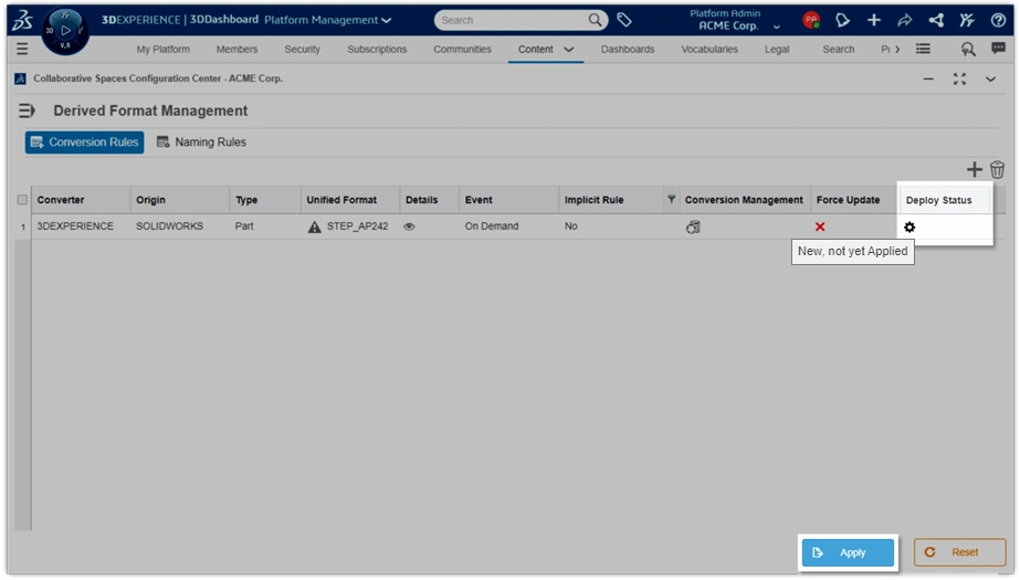

Figure 8 – Example of a new conversion rule that is not deployed.
The rule shows in the table, and the Deploy Status has the following symbol. This symbol means, New, not yet Applied
4. Click Apply to deploy the conversion rule.
The Deploy Status changes from (New, not yet Applied) to (Applied).
NOTE: If the Deploy Status is New, not yet Applied and you click Reset, the system deletes the conversion rule. The Reset does not delete deployed conversion rules.

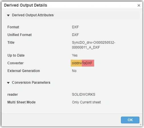

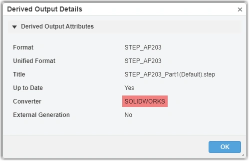

Figure 9 - If the converter is set to anything other than 3DEXPERIENCE, then it is a synchronous rule.
Synchronous converters, like SOLIDWORKS Design, create derived output jobs, process the jobs, and generate the derived output when you save to the 3DEXPERIENCE platform. The derived output generates at the same time as a CAD operation.
Synchronous converters have the following advantages and disadvantages:
AdvantageDisadvantage
Derived output is always synchronized and up-to-date.Save performance is slower.
The derived output result is identical to
File > Save As or File > Export As.
A limited number of formats.
No requirement for an additional converter.Derived output generates on save only.
Derived output generates quickly.No optional parameters.
 Only applies to 3DEXPERIENCE SOLIDWORKS and Collaborative Designer for SOLIDWORKS.
 Only SOLIDWORKS users create jobs.
 You cannot control derived output filenames.

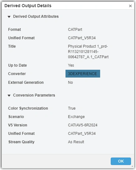

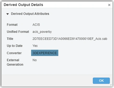

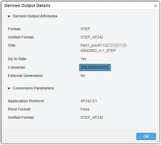

Figure 10 - If the converter is set to 3DEXPERIENCE, then it is an asynchronous rule.
Asynchronous converters rely on the 3DEXPERIENCE platform or a web app to create derived output jobs. The converter (ConversionAdministration Cloud Service or Derived Format Converter) processes the jobs and generates the derived output after an event. The derived output does not generate at the same time as a CAD operation.
Asynchronous converters have the following advantages and disadvantages:
Save performance is faster.DO is not always synchronized and up-to-date.
More formats are available.DO result can be different from File > Save As.
DO generates after an event of your choosing.There can be a requirement for another converter.
More parameters and options for some formats.There can be a requirement for more licenses.
You can create jobs outside of SOLIDWORKS in web apps.There can be a requirement for more workstations.
Non-CAD platform members can create jobs.Derived output generates more slowly with DFC.
Applies to all 3DEXPERIENCE Works roles and apps, including SOLIDWORKS Cloud.
You can control derived output filenames.

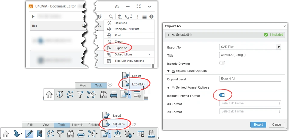

  3. On Demand

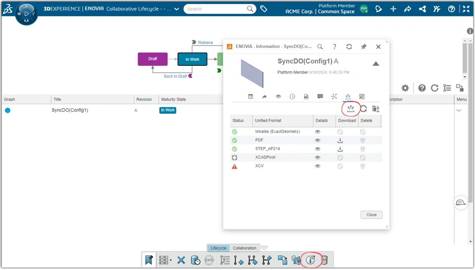

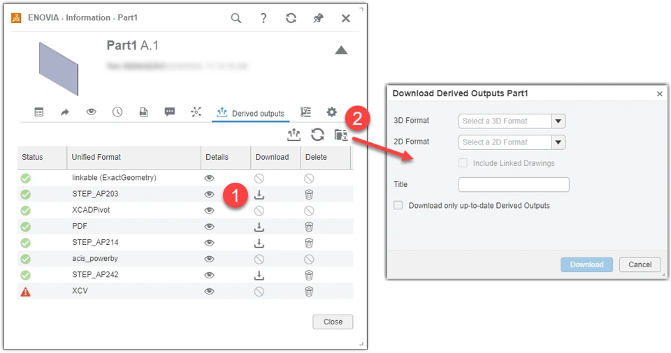

    The 3DEXPERIENCE platform creates jobs when you click the Generate Derived Outputs command and select rules. Conversion rules that have this event are available for selection inside the Generate Derived Output dialog. The command and dialog are available in several web apps:
    • MySession
      Figure 11 – Action Bar > Tools > Generate Derived Output. Or,
      Action Bar > View > Display Side Panel > Derived outputs > Generate Derived Output.
    • Product Structure Editor
      Figure 12 – Action Bar > View > Information, then Action Bar > Tools > Generate Derived Output.

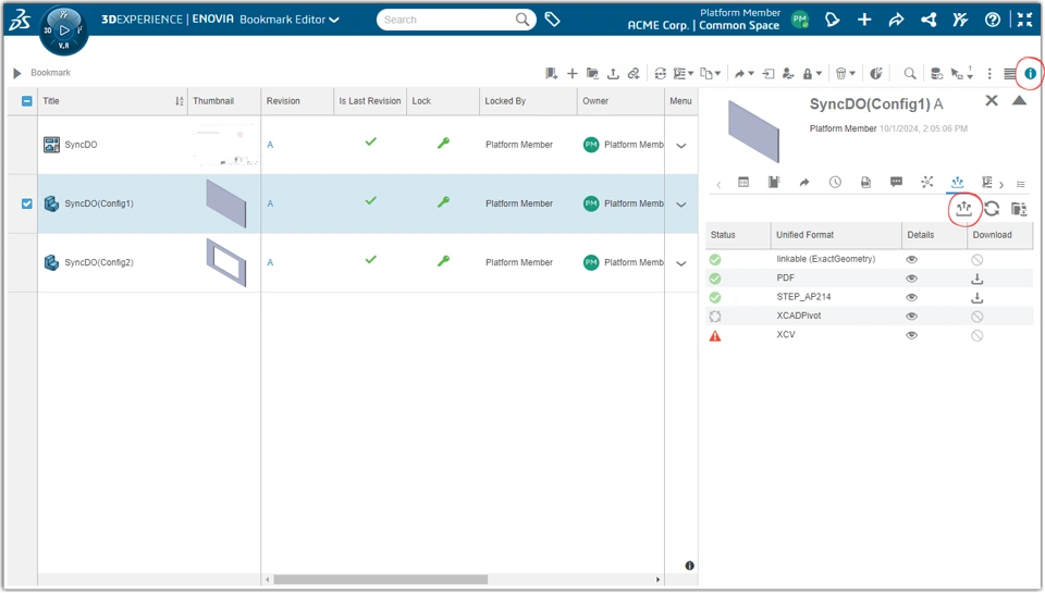

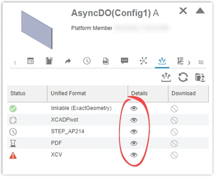

    • Information widget or panel within 3DSearch, Collaborative Lifecycle, and Bookmark Editor
      Figure 13 - Action Bar > Lifecycle > Information, opens the widget.
      The Generate Derived Output command is on the Derived outputs tab.
      Figure 14 – Click the Information command to open the side panel.

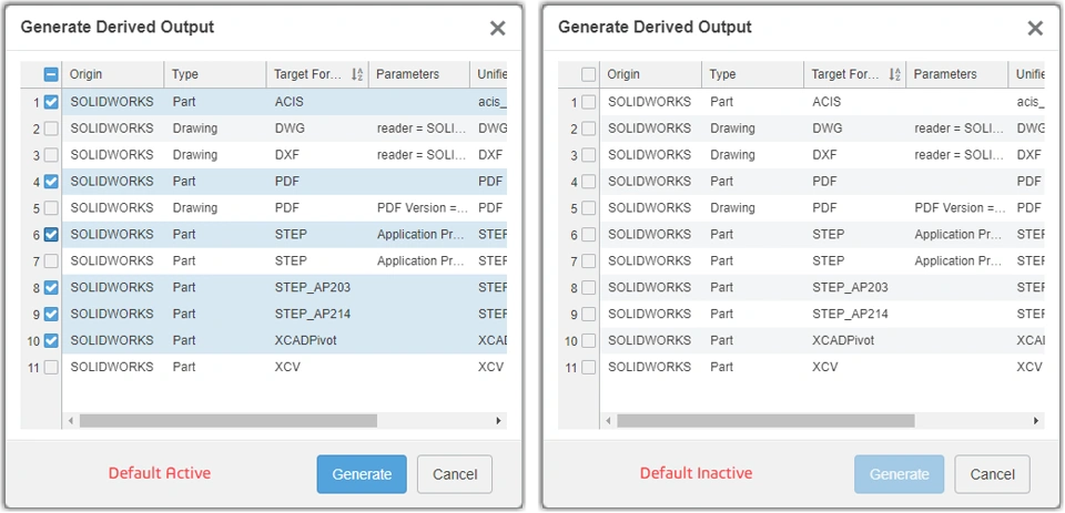

  • Activation
For On Demand events, you can choose an activation type. (For On Save from Connector and On Status Change events, the system applies the Forced Active activation type.) There are two activation types that you can choose:
  1. Default Active
    This means that there is preselection of the rule in the Generate Derived Output dialog. (You click the Generate Derived Outputs command to open this dialog.)
  2. Default Inactive
    This means that there is no preselection of the conversion rule.
If you frequently generate the derived formats in this manner, then the Default Active setting accelerates the job creation process. You do not need to find and select the correct rules.
Figure 15 – Generate Derived Output dialog showing six asynchronous, on demand, conversion rules with Default Active (left) versus all on-demand conversion rules with Default Inactive (right).

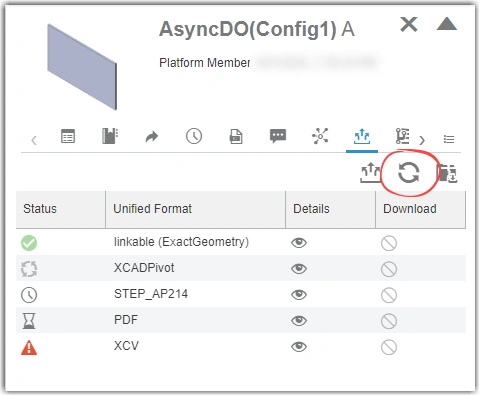

  • Force Update
As stated in the tooltip, the Force Update setting allows you to recompute or rerun a rule, even if the derived output is up-to-date or synchronized. This setting only applies to asynchronous conversion rules that have the On Status Change or On Demand event.
Recomputing a derived format can be a requirement of scenarios where you update or change object attributes in a web app instead of the CAD app. For example, you have a drawing that contains annotations which are linked to an attribute. You promote the drawing to Frozen, which generates the derived output. Afterwards, you change an attribute in a web app. In this scenario, you can recompute the derived output with an On Demand rule to update it to the attribute change.
This feature can also be useful if you accidentally delete derived output. In the scenario where derived output generates On Status Change, instead of demoting and promoting the object again, you can recompute the derived output on demand.

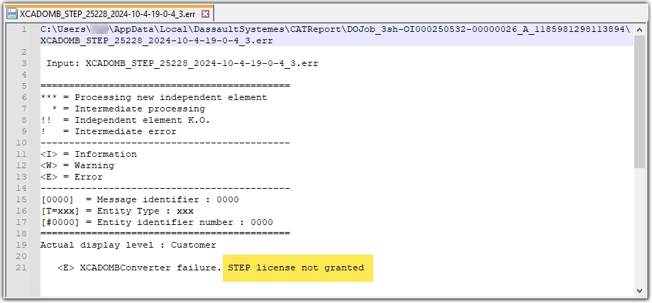

For STEP and CATPart derived output, you can specify a Conversion User. The converter uses the licenses of this platform member to process the jobs.
  • STEP derived output requires the Conversion Data Integrator for STEP Multidiscipline role and license. You can grant this role to one user, and you can specify that user as the Conversion User for all STEP conversion rules.

c) Deleting Conversion Rules
To delete deployed conversion rules,
  1. Use the selection check boxes on the far left of the console to select the conversion rules.
  2. Click Delete
  3. Accept the warning.
    The Deploy Status changes to
  4. Click Apply to delete the conversion rules.

Figure 16 - Asynchronous STEP AP242 derived output example
ProductTitle = Part1
ProductName = prd-R1132101281145-00642902
Revision = A.1
Format = STEP
When downloaded, the Windows filename is “Part1_prd-R1132101281145-00642902_A.1_STEP.stp.”

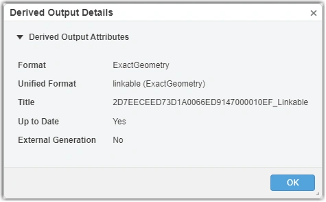

a) ExactGeometry
Figure 18 - The implicit, asynchronous ExactGeometry conversion rule should never be deleted.

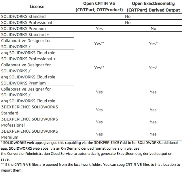

A 3D format based on the CATIA® V5 geometry kernel. It generates automatically each time you save a SOLIDWORKS part to 3DEXPERIENCE.
It is a linkable format that you cannot download and cannot delete.
When considering the interoperability of 3DEXPERIENCE platform data into SOLIDWORKS Design, this derived format results in the import of CATPart files. (See QA00000002109 to determine the version of a CATPart file.) For more information, see section 7) Interoperability between SOLIDWORKS and 3DEXPERIENCE.
Figure 19 – Asynchronous ExactGeometry derived output details
b) UDL
Figure 20 - The implicit, asynchronous UDL conversion rule should never be deleted.
The Universal Drawing Light (UDL) format is a 2D format that is proprietary to Dassault Systèmes. Web viewer apps (3DPlay, 3D Navigate, 3D Markup) open this format. It generates automatically each time you save a SOLIDWORKS drawing to 3DEXPERIENCE.
It is a linkable format that you cannot download, cannot delete, and cannot view the details of.
This format is a prerequisite for PDF derived output.
c) STEP
Figure 21 - Asynchronous STEP_AP214 conversion rule which requires SOLIDWORKS to be generated.
A 3D format based on one of seven ISO 10303-21 or STEP Application Protocols: AP203, AP203 E2, AP214, AP214 E3, AP242, AP242 E2, or AP242 E3.
It can generate synchronously or asynchronously. It is an exchange format that you can download and delete.
Three formats are available. STEP_AP203 and STEP_AP214 use the Derived Format Converter or SOLIDWORKS as the converter. STEP, which includes all seven protocols, uses ConversionAdministration Cloud Service or the Derived Format Converter as the converter.
This format requires a Conversion Data Integrator for STEP Multidiscipline license.
Figure 22 – Synchronous (SOLIDWORKS) generated STEP AP203 derived output details.
Figure 23 – Asynchronous (Derived Format Converter + SOLIDWORKS) generated STEP AP203 derived output details.
Figure 24 - Asynchronous (Derived Format Converter) generated STEP AP214 derived output details.
Figure 25 – Asynchronous (ConversionAdministration Cloud Service) generated STEP AP242 derived output details.
d) PDF
A 2D format, applicable to parts and drawings, based on one of four PDF versions: 1.3, PDF/A 1b (based on 1.4), 1.4, or 1.6.
When generating synchronously, SOLIDWORKS export options for PDF determine the result. SOLIDWORKS generates PDF version 1.4.
When generated asynchronously, several optional parameters are available including: Multi Sheet Mode, Exclude Detail Sheet, Color Mode, Print text blanking, and Print white vectors in black.
Figure 27 – Asynchronous PDF 1.6 derived output details.
Figure 28 - Asynchronous PDF/A 1b derived output details.
Figure 29 - Synchronous PDF derived output uses SOLIDWORKS export options.

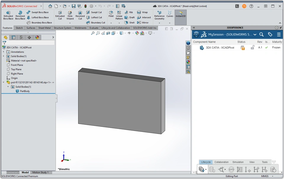

f) XCADPivot
Figure 32 - Asynchronous XCADPivot conversion rule.
A 3D format based on ISO 10303-21 or STEP Application Protocols: AP242 E3.
This format generates asynchronously using ConversionAdministration Cloud Service or the Derived Format Converter as the converter.
This format is for interoperability between any CAD system.
Figure 33 - XCADPivot derived output details.
g) ACIS
Figure 34 - Asynchronous ACIS conversion rule.
A 3D format based on version 26.0 of the ACIS geometry kernel.
This format generates asynchronously using ConversionAdministration Cloud Service or Derived Format Converter as the converter.
This format is for interoperability with SIMULIA® applications. It is also useful for interoperability with CAD systems that use ACIS as the geometry kernel.
Figure 35 - ACIS derived output details.

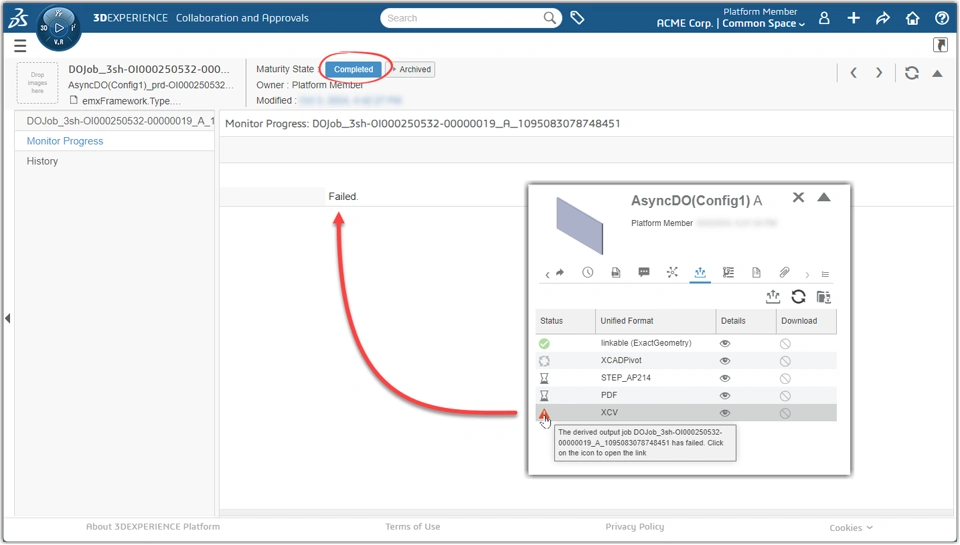

A ZIP format which uses data from ExactGeometry derived output. It is a 3D component signature that enables semantic search and 3D similarity capabilities. The Standard Component Manager / Preferred Component Consumer roles, and PartSupply Enterprise Manager / PartSupply Enterprise Reuse apps use this format.
This format generates asynchronously using ConversionAdministration Cloud Service as the converter.
It is a linkable format that you cannot download and cannot view details of. You can delete it.
Figure 37 – XCV derived output details of a failed job because improperly configured PartSupply index.
i) CATPart
Figure 38 - Asynchronous CATPart conversion rule.
A 3D format, CATPart is a native file format for the CATIA® V5 desktop app. Sixteen versions are available, V5R19 through V5-6R2024.
This format only applies to SOLIDWORKS web apps. Within that context, this format generates asynchronously using ConversionAdministration Cloud Service or the Derived Format Converter as the converter.
Figure 39 - CATPart derived output details.

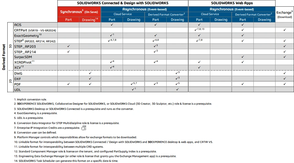

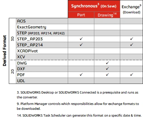

a) Synchronous
The following matrix summarizes all the synchronous derived output capabilities for the SOLIDWORKS Connected and Design with SOLIDWORKS apps.

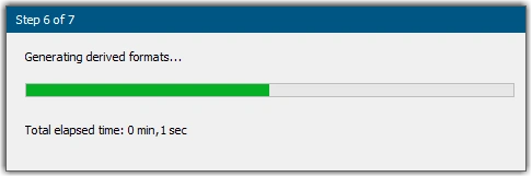

Figure 42 - Synchronous derived output matrix for SOLIDWORKS Connected and Design with SOLIDWORKS.
Figure 43 - Synchronous derived output generates during step 6 of the save to 3DEXPERIENCE process.

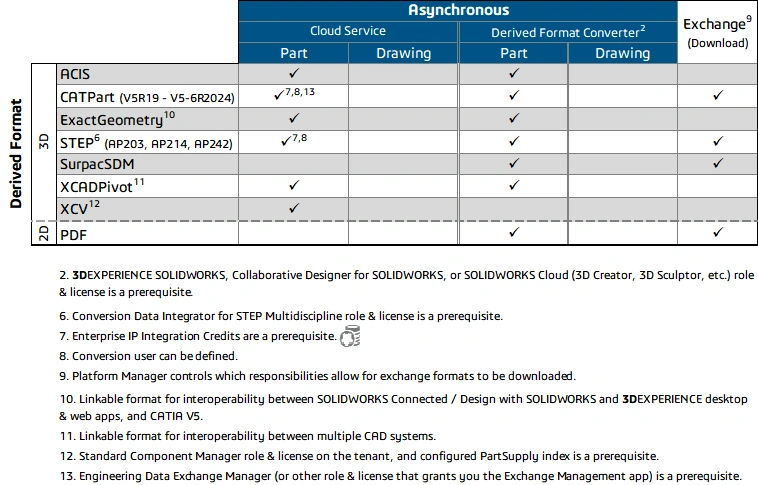

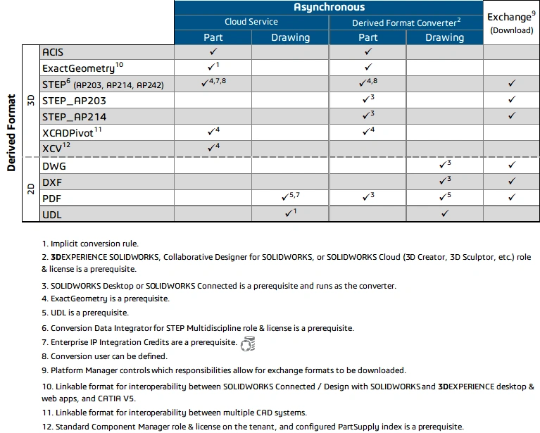

b) Asynchronous
The following matrix summarizes all the asynchronous derived output capabilities for the SOLIDWORKS Connected and Design with SOLIDWORKS apps.
Figure 44 - Asynchronous derived output matrix for SOLIDWORKS Connected and Design with SOLIDWORKS.
The following matrix summarizes all the asynchronous derived output capabilities for the SOLIDWORKS xDesign.
Figure 45 - Asynchronous derived output matrix for SOLIDWORKS xDesign.
i) ConversionAdministration Cloud Service
This asynchronous converter fully-automates the generation of derived output. It is a web service that runs as part of the 3DEXPERIENCE platform On Cloud. There is no installation or license requirement for it to operate. It operates with Platform Manager level access, so there is no requirement for collaborative space management. This converter simplifies and accelerates your ability to collaborate with internal and external stakeholders.
As specified in Figure 44 and Figure 45, this converter requires Enterprise IP Integration Credits to generate some derived formats: CATPart, STEP, and PDF. (STEP derived output requires a Conversion Data Integrator for STEP Multidiscipline license.) These credits apply to your tenant. You cannot assign them to platform members. The credits replace the IT overhead that is a requirement when you use the Derived Format Converter.
You can find details on the required number of credits to generate formats in the following page of the User Assistance: Social and Collaborative > Format Converters > Derived Format Converter > About ConversionAdministration Cloud Service.
The best practice is to use Enterprise IP Integration Credits and the Conversion Administration Cloud Service as the converter for all, or as many, derived formats as possible.

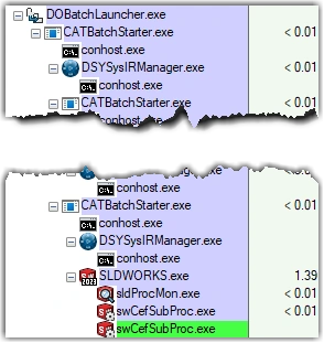

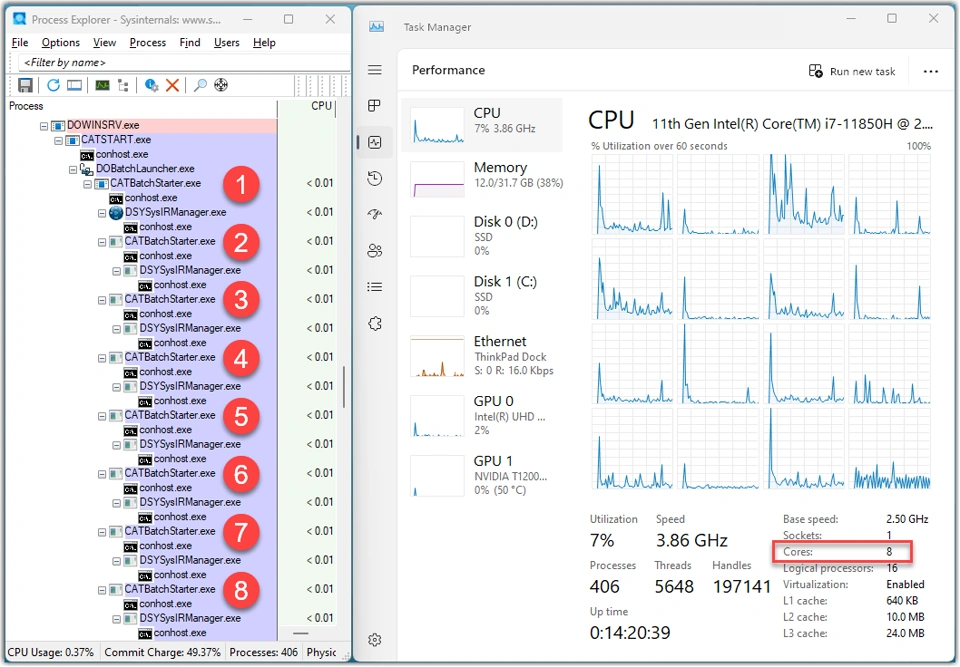

The name of this process is DOWINSRV.exe. This parent process has many child processes, specifically a CATBatchStarter.exe process for each CPU core in your workstation.
Figure 48 – Process Explorer view of the Derived Format Converter service running on an 8-core CPU.
The performance and number of concurrent jobs that the Derived Format Converter can process at the same time correlates to your workstation specifications. The more CPU cores, the more jobs can process at the same time.

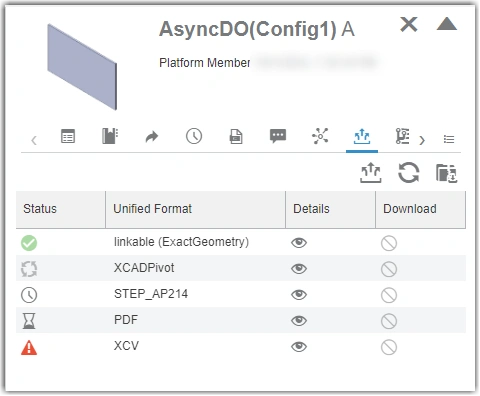

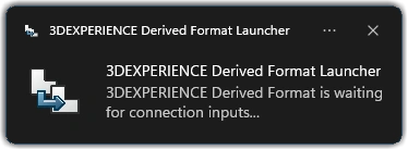

  • Service/App Status
When the service or app is running, you see the Windows taskbar icon depicted in Figure 46. You also see Windows toast notifications when derived output jobs are processing. The tooltip for the taskbar icon communicates the status of the service. There are four statuses:
  • Idle means that there are cached credentials in use, the service is ready to process jobs, or the service finished processing a job.

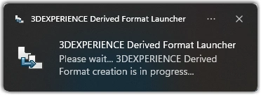

  • In Progress means that the service is processing a derived output job
This status causes the following notification to display:
  • Clean Up Jobs In Progress means that there is an interruption in the processing of previous jobs, or the processing is incomplete. The service reprocesses the previous jobs before it processes new jobs.
  • Not Connected means that there are expired credentials or no cached credentials. The service cannot process jobs.
This status can also cause the following notification to display:
To resolve this failure,
  1. Delete the following folders:
    %appdata%\\DassaultSystemes\\CATSettings\\RXXX\\DerivedFormatConverter
    %appdata%\\DassaultSystemes\\CATSettings\\RXXX\\ENODFBatchSettings
  2. Log in to your 3DEXPERIENCE platform.
  3. Open the Compass.
  4. Launch the Derived Format Converter.
Once the service successfully starts, then restart Windows.

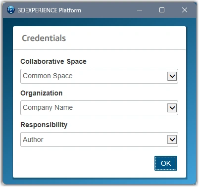

If the platform member has access to multiple collaborative spaces, or the platform member who signs in changes, then the following credential dialog displays:
Figure 49 - This dialog displays for platform members who have access to multiple collaborative spaces or organizations. You must accept this dialog for the service to start successfully.
Further, if you sign in to Windows and you have expired credentials or you do not have cached credentials, the following notification displays:
In this scenario, the status is Not Connected. To resolve this failure, you must sign in to your 3DEXPERIENCE platform, open the Compass, and start the Derived Format Converter manually. Starting the app establishes and caches credentials. When you start the app manually, the name of the parent process is DOBatchLauncher.exe. The DOWINSRV.exe process remains active and unused until you restart the service or Windows.

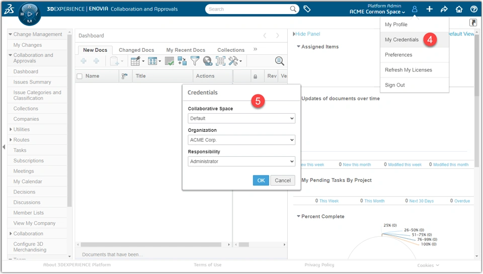

To start the Derived Format Converter in admin-mode:
  1. Log in to your 3DEXPERIENCE platform as a Platform Manager.
  2. Open the Compass.
  3. Launch the Collaboration and Approvals app.
  4. Me > My Credentials.
  5. Set your credentials to:
    1. Collaborative Space = Default
    2. Organization =
    3. Responsibility = Administrator
  6. After the web page reloads, open the Compass.
  7. Launch Derived Format Converter.
Figure 50 - Launching Derived Format Converter in admin-mode, steps 1-3.
Figure 51 - Launching Derived Format Converter in admin-mode, steps 4-5.
Figure 52 - Launching Derived Format Converter in admin-mode, steps 6-7.

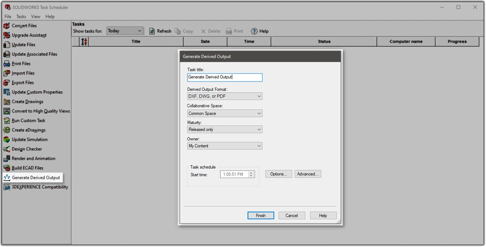

iii) SOLIDWORKS Task Scheduler
You can use the SOLIDWORKS Task Scheduler to create tasks that generate synchronous DXF, DWG, or PDF derived output of drawings. The app generates these derived formats in an asynchronous way. The parameters which apply are:
  • Collaborative Space: any collaborative space that you have access to
  • Maturity: In Work, Frozen and Released, or Released
  • Owner: My Content or All Content
    • Owner refers to the platform member who owns the drawing objects.
When a task runs, the synchronous SOLIDWORKS converter generates the derived output.
SOLIDWORKS Connected or Design with SOLIDWORKS must be running with a connection to a collaborative space for the task to complete.
Figure 53 - Parameters of Generate Derived Output task in SOLIDWORKS Task Scheduler.

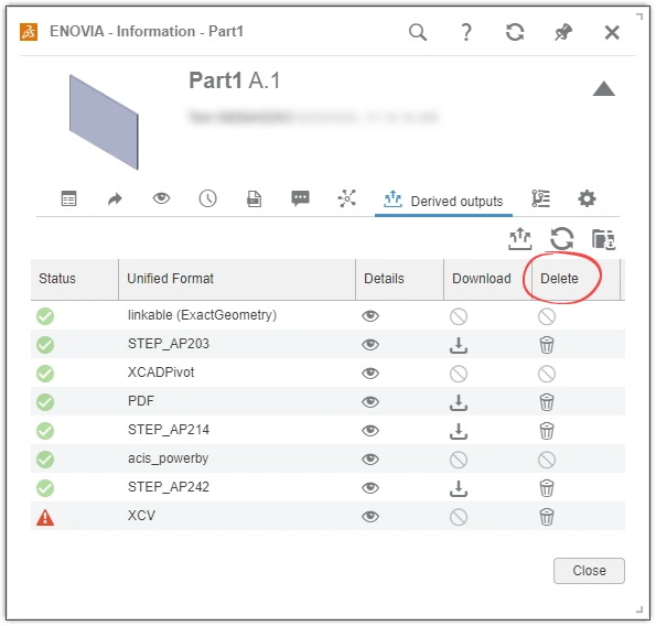

d) Viewing Derived Output

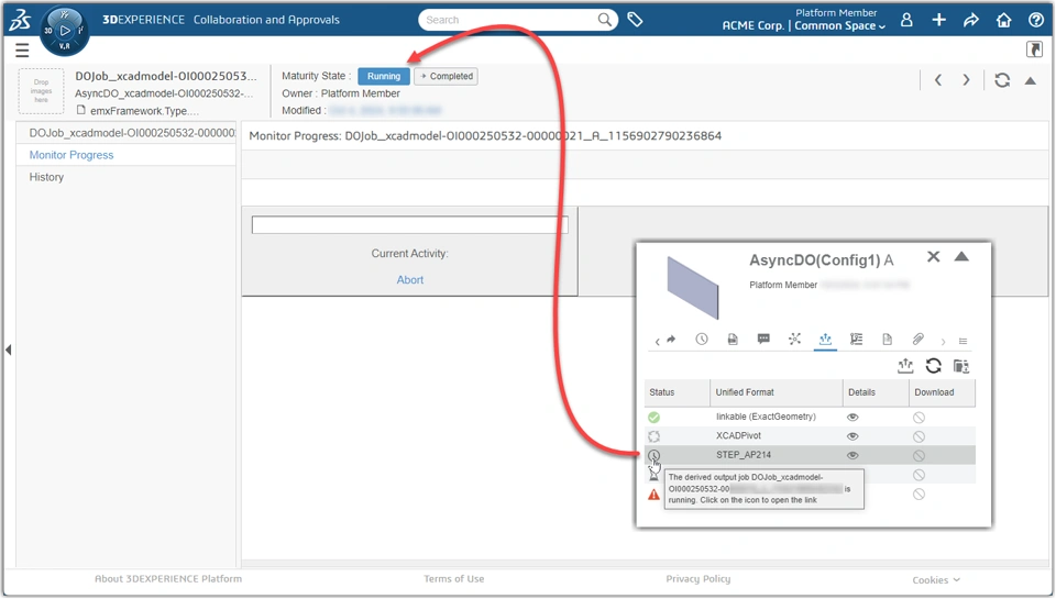

You can view and monitor the job status and derived formats using the Derived outputs tab of the Information widget or panel.
Figure 54 - Derived outputs tab of Information panel.

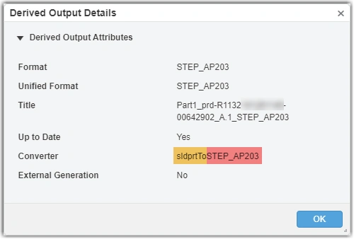

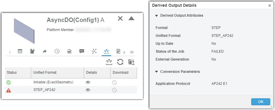

i) Format Details

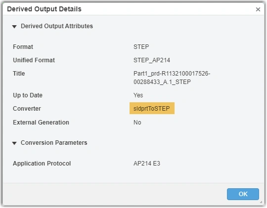

As depicted throughout section 5) Derived Formats, the Derived Output Details dialog gives you many important pieces of information.
Figure 55 - Click the eye icon to view details of the job and format.
Most importantly, the Derived Output Details dialog tells you the Format of the derived output, its Title, and the Converter that generated it. The converters you can see are:
Figure 56 - Asynchronous (ConversionAdministration Cloud Service) generated STEP AP242 derived output details.
3DEXPERIENCE
sldprtTo
slddrwTo
SOLIDWORKS
SOLIDWORKS Design
With the Derived Format Converter, you can use Process Explorer to monitor job processing. In Process Explorer, the Derived Format Converter shows as a DOWINSRV.exe process or as a DOBatchLauncher.exe process tree. When SOLIDWORKS Design is a requirement for processing, you see the SLDWORKS.exe process. For example, you see this process for the generation of asynchronous STEP_AP214 derived output.
Figure 57 - Derived Format Converter process starts SOLIDWORKS Design in the background to generate the derived output.
ii) Job Status
Except for XCV and UDL, the status for all other derived formats shows in this interface. Each format can show one of five job statuses:
Submitted. A platform member or app created the job.
Running. A converter is processing the job.
Up to date. A converter processed the job and generated derived output.
Failed. A converter failed to process the job and generate the derived output.
Out-of-date. A platform member modified the CAD object. The derived output is not accurate. You must regenerate it.
Click Refresh view to update the view of job statuses or derived formats.
Figure 58 - Refresh view icon.
Of the five statuses, you can click the Submitted, Running, and Failed icons to view more information about of the corresponding derived output job. Clicking an icon opens the job in the Collaboration and Approvals app.
Figure 59 - Details of a Submitted derived output job in Collaboration and Approvals.
Figure 60 - Details of a Running derived output job in Collaboration and Approvals.
Figure 61 - Details of a Failed derived output job in Collaboration and Approvals.
The derived output job reveals some useful information:
  • The Name (attribute) of the job. In the example from Figure 61, the Name is:
    DOJob_3sh-OI000250532-00000019_A_1095083078748451
    The Name of a derived output job follows this naming rule:
    DOJob_ContentTypeName_Revision_UniqueID
    You can search your tenant for ContentTypeName to find the related part Physical Product or Drawing.
  • The part Physical Product or Drawing that the derived output links to.
    In the same example, you can identify that XCV derived output generates from the 3D Shape. If there is a failure, knowing the related object is useful for troubleshooting.
iii) Collaboration and Approvals
Although not as user-friendly as the Information widget or panel, any platform member can view and manage their derived output jobs in the Collaboration and Approvals app.
Set your credentials then click the Background Jobs link in the left pane to view jobs.
Figure 62 – In the Background Jobs page, you can view the status and details of derived output job. You also have controls for filtering and deleting jobs.
Generally, it is best to select All and customize the table view to suit your needs. Adding the ENOJobTarget column is useful so that you can see and filter the jobs by format.
TIP: To refresh the table view and clear filters, click the Background Jobs link again instead of refreshing the web browser tab.
As a Platform Manager, you can change credentials to the Default collaborative space and Administrator responsibility. These credentials give you the ability to view all jobs from all platform members.
Similar to the Information widget or panel, Collaboration and Approvals shows one of four statuses:
  • Submitted. A platform member or app created the job.
  • Running. A converter is processing the job.
  • Completed. A converter processed the job and generated derived output.
  • Failed. A converter failed to process the job and generate the derived output. Or, a platform member ended the job.

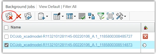

The Abort command is unique to Collaboration and Approvals. You can select a Submitted or Running job and click Abort to cancel the job. The status changes to Failed.
Figure 63 – Canceling a job changes the status to Failed. You can delete failed jobs to clean up what shows in the derived output details.
Canceling jobs is not a common operation. If you suspect that there is a stuck job or a job continues to process for many days, then you can end the job, and recreate it using an On Demand rule. You can also Delete failed jobs to remove them from the Derived outputs tab of the Information widget or panel.

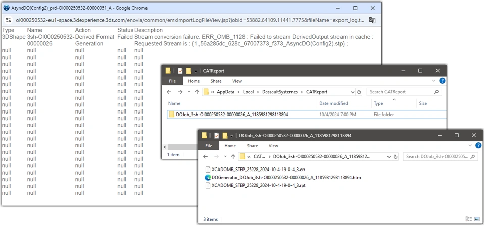

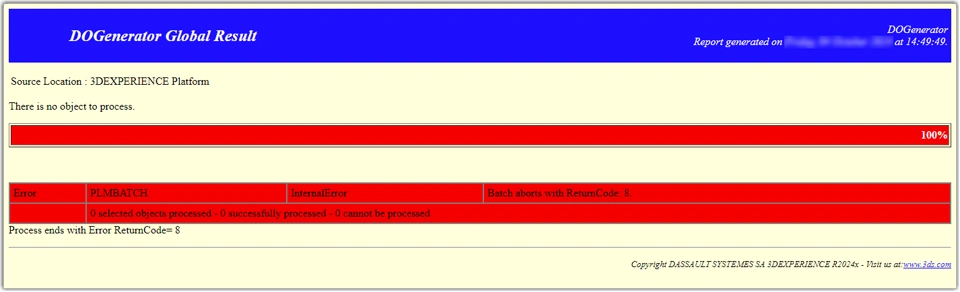

  • Case Study: Failed Job Analysis
Consider the following failed job:
Figure 64 – Since the format is STEP, the Derived Output Details tells us it is an asynchronous job.
Figure 65 – The failed asynchronous STEP derived output job in Collaboration and Approvals.
Figure 66 – The Collaboration and Approvals log gives a specific error code, ERR_OMB_1128.
Figure 67 - The HTM report states that, "There is no object to process."
Figure 68 - The ERR report reveals the problem. The platform member processing the job does not have a
Conversion Data Integrator for STEP Multidiscipline license. This license is a requirement to generate STEP derived output.
The Derived Output Details dialog tells us that the target format is STEP. This format means that the job is asynchronous. And the ConversionAdministration Cloud Service or Derived Format Converter processes asynchronous jobs.
The Background Jobs table shows us that there is a log. The system only creates these logs locally. The existence of a log means that the Derived Format Converter processes the job. If ConversionAdministration Cloud Service processes the job, then there is no log. The log gives an error code along with HTM, ERR, and RPT reports.
The ERR report tells us the problem. The platform member running the Derived Format Converter – or the conversion user – does not have a Conversion Data Integrator for STEP Multidiscipline license. This license is a requirement to generate STEP derived output.
This error can also be an indication that there is a change to the signed in platform member, or a connection to a different tenant. If one of these conditions is true, then the platform member must stop or exit the app, delete the CATSettings (DerivedFormatConverter and ENODFBatchSettings), and restart the app.

i) Information Widget/Panel
Platform members with Collaborative Industry Innovator licenses and the correct collaborative space responsibility (see Figure 69) can download derived output. They download derived output from web apps that can display an Information widget or panel:
  • 3DSearch
  • Collaborative Lifecycle
  • Bookmark Editor
  • Product Structure Explore

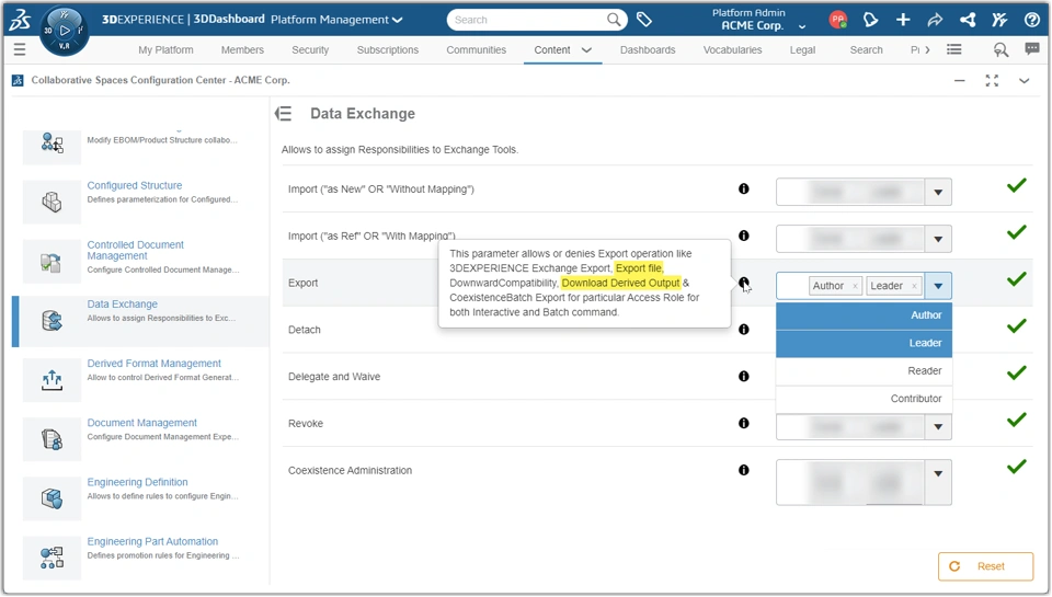

Figure 69 - The Platform Manager determines which responsibilities (Leader, Author, Reader, or Contributor) can export or download derived output in the Data Exchange console.
Within these web apps, open the Information widget or panel, go to the Derived outputs tab.
  1. Click Download the derived output next to any exchange format. Repeat this operation for each derived format.
  2. Click Download all Derived Outputs.
The Download Derived Outputs dialog opens. You can choose a 3D format and a 2D format to download. (You cannot specify more than one 3D or 2D format.)
Figure 70 - Download Derived Outputs dialog.
You can also choose Include Linked Drawings. This option is useful if you ran the command with a selected Physical Product. The option downloads the selected 2D Format (derived format) for all Drawings that link to the Physical Product structure. For example, you run the command from an assembly Physical Product. Each subassembly or part Physical Product in the structure links to a Drawing. This option downloads the 2D Format for all Drawings in the structure that have the selected derived format.
To avoid missing an object, it is a best practice to use Download Derived Outputs from a root (top-level) assembly Physical Product, with Include Linked Drawings, and Download only up-to-date Derived Outputs options.
Further, you can Download only up-to-date Derived Outputs. This option is useful if out-of-date derived output exists, or you do not know if out-of-date derived output exists. Out-of-date derived output is not accurate and you want to exclude it from download.
ii) Export As
Alternatively, platform members who have a 3DEXPERIENCE SOLIDWORKS or Collaborative Designer for SOLIDWORKS license can export derived output by means of the Export As command. Three web apps have this command:
  • Bookmark Editor
Figure 71 – The Export As command (from top to bottom) in Bookmark Editor, Product Structure Explore,
and Product Structure Editor. The command opens the Export As dialog which has a on option to include derived output.
Like the Download Derived Outputs dialog, you can only choose one 3D format and 2D format in the Export As dialog. In addition, this command always downloads the native SOLIDWORKS files. This command is most useful for platform members who want to extract or move CAD data out of their tenant.
When you export, the app creates a CAD File Download job. The CAD Data Processor Monitoring app processes this job and you receive a notification when the download package is ready. You can click the notification to open the processed job and download the package, or you can access the job from a CAD Data Processor Monitoring widget. The download package is a ZIP file that contains the selected SOLIDWORKS files and derived output.
Further, if platform members also have the Enterprise IP Integration Manager role, then an Include Up-to-date Derived Formats Only option is available in the Export As dialog. These platform members have several more options to exchange data.
Figure 72 - The Export As process.
f) Deleting Derived Output
The ability to delete derived output requires a 3D Product Architect license. With this license, you can delete exchange formats from the Information widget in Collaborative Lifecycle and Bookmark Editor. You cannot delete derived output from the Information panel in these apps. Or, you can delete derived output from the Information panel in the Product Structure Editor app.
Figure 73 - 3D derived formats that you can generate from SOLIDWORKS-mastered part Physical Products.

Thanks to the implicit conversion rule from 4)a) and the ExactGeometry derived output from 5)a), there is no requirement for extra configuration. When you open a SOLIDWORKS-mastered Physical Product in 3DEXPERIENCE CATIA, the ExactGeometry derived output opens. You cannot modify the SOLIDWORKS data in 3DEXPERIENCE CATIA, but you can reference it.

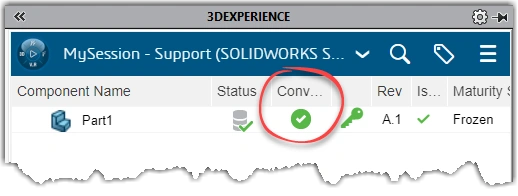

To verify that ExactGeometry derived output is available in your SOLIDWORKS data, you can use the Convert Status column of the MySession app. Or, as previously discussed, you can view the derived outputs of the Physical Product in the Information widget or panel.
Figure 74 - Convert Status column in MySession showing that ExactGeometry derived output is available for the part.

Figure 75 - Native 3DEXPERIENCE Physical Product, with no derived output, opened in SOLIDWORKS Connected.
In this scenario, you have multiple options for working with the graphics body. You can convert the graphics body to a mesh body, and use hybrid modeling techniques. Or, you can convert the graphics body to a mesh body, then convert the mesh body to SOLIDWORKS BREP geometry (surfaces).
2. ExactGeometry (best practice)
New tenants do not have an implicit conversion rule for 3DEXPERIENCE ExactGeometry. Platform Managers can create this conversion rule. The ConversionAdministration Cloud Service or the Derived Format Converter can generate this ExactGeometry without extra licenses. This derived output is based on CATIA V5 geometry and results in CATPart files. SOLIDWORKS opens this file format using 3D Interconnect. It results in a solid body feature that you can reference.
Figure 76 - Native 3DEXPERIENCE Physical Product, with ExactGeometry derived output, opened in SOLIDWORKS Connected.
3. XCADPivot
The ConversionAdministration Cloud Service or the Derived Format Converter generates asynchronous XCADPivot derived output. Extra licenses are not a requirement. This derived output is based on the STEP AP242 protocol. SOLIDWORKS opens this file format using 3D Interconnect.
4. STEP
The ConversionAdministration Cloud Service (with Enterprise IP Integration Credits), or the Derived Format Converter can generate STEP derived output. A Conversion Data Integrator for STEP Multidiscipline license is a requirement. This derived output can be any of the seven STEP protocols from 5)c). SOLIDWORKS opens these file formats using 3D Interconnect.
Figure 77 - Native 3DEXPERIENCE Physical Product, with XCADPivot derived output, opened in SOLIDWORKS Connected. STEP derived output has the same result.
If a Physical Product has multiple derived formats, or all four, then SOLIDWORKS opens ExactGeometry, then STEP, then XCADPivot, then CGR. In other words, regardless of the derived output, if ExactGeometry exists then it opens.
  • Open CATIA V5 data in SOLIDWORKS Design
With SOLIDWORKS 2023 SP2.0 and 3DEXPERIENCE platform R2023x FD02 (April 2023), the requirements to open CATIA V5 files changed. The following table summarizes the change:

For SOLIDWORKS web apps to generate ExactGeometry derived output on save, the Platform Manager must create the following conversion rule:
Figure 78 - Conversion rule that generates ExactGeometry derived output, on save, for SOLIDWORKS web apps.
The system treats this On Demand rule like an On Save from Connector rule. If you use 3DEXPERIENCE desktop app or other web apps, a converter does not generate ExactGeometry derived output from this rule. For data you create in all 3DEXPERIENCE desktop and other web apps, you can run this rule on demand to generate ExactGeometry derived output.

  • I have the Derived Format Converter running. How do I know if the ConversionAdministration Cloud Service or my Derived Format Converter processes a job?
Refer to the asynchronous matrices in 6)b). The ConversionAdministration Cloud Service always tries to process the derived formats that it can process. If credits are available, then the service generates the derived output. If credits are not available, then the job falls back to the Derived Format Converter. If the system cannot find a Derived Format Converter system with proper credentials and licenses, then the job times out and fails.
  • When do I use the Derived Format Converter?
If you have many platform members who create jobs in multiple collaborative spaces, then it is a best practice to use the Derived Format Converter in admin-mode on one or more dedicated workstations.
If there is a derived format, like STEP_AP203 or STEP_AP214, that you require, and you cannot or do not want to purchase a Conversion Data Integrator for STEP Multidiscipline license, then use the Derived Format Converter.
  • How do I know or how can I verify that SOLIDWORKS is a requirement for a conversion?
Refer to the matrices in 6) or 6)d)i) where you can monitor the system using a utility like Process Explorer.

  • If I change my credentials to Default • Administrator in Collaboration and Approvals, does that change affect other apps?
Yes. The same is true for other apps that allow you to choose these credentials, like Bookmark Editor. The credentials change propagates to new sessions of all apps, even if an app is not capable of working with the credentials.
If you intend to use DFC and any other app on the same workstation, then do not start DFC in admin-mode on that workstation.
In the context of technical support, troubleshooting, or platform administration, only use the Default • Administrator credentials, temporarily, to complete a specific task. If you must test DFC in admin-mode, then you have at least two workstations: one for the DFC, and one for client use. If your test does not involve saving data from SOLIDWORKS, then you can alternatively use one workstation and two different web browsers: one for the DFC platform administrator, and one for the platform member.
At any time, you can use Me > My Credentials in the Collaboration and Approvals app to see what your credentials are.
NOTE: If you start SOLIDWORKS Connected or Design with SOLIDWORKS with the Default • Administrator credentials, you are able to search for and open data from any collaborative space, regardless of your access to the collaborative space.

  • In the Derived Output Details dialog, what does External Generation refer to?
In the context of this document, the value for External Generation is always False. A value of True means that a custom-built application generates the derived output using REST API web services. For more information, see the following section of the 3DEXPERIENCE platform On Cloud Developer Guide: Web Services and Events > 3DSpace > Derived Outputs.

Figure 79 - Derived output for SOLIDWORKS matrix.
