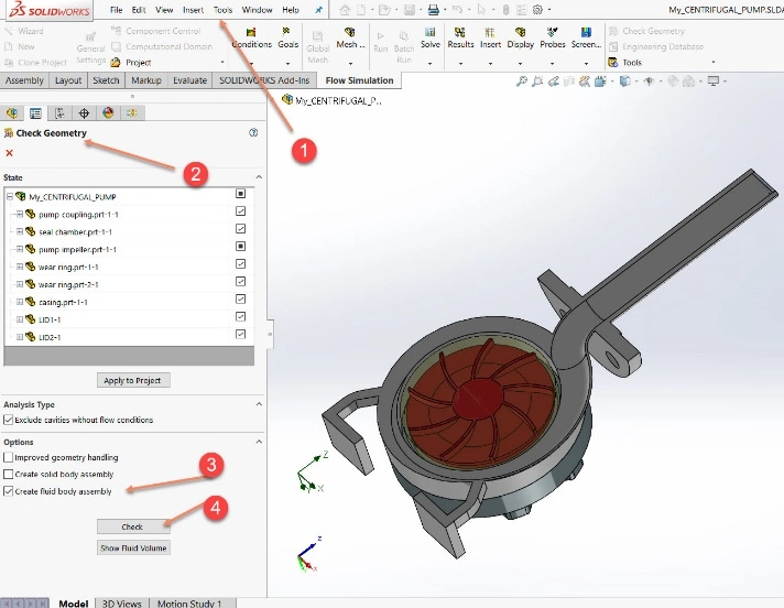

3) Before Performing a Simulation: Simplify!
Before running a simulation, simplify your model and prepare the geometry. An old adage applies: “Simplify or Suffer”.

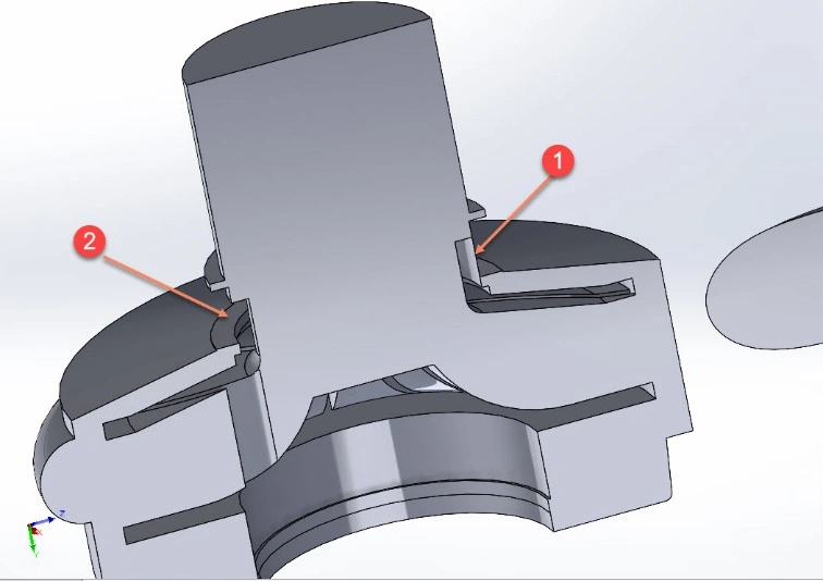

a) Thin Gaps
You can usually remove any thin gap, shaft, motor, filter, etc. In addition, you must strip down the CAD model by removing any screws, or other tiny features that the pump does not require. Some of the most significant complicating effects is the leakage. The Check Geometry Tool (Tools > Flow Simulation > Tools > Check Geometry”) is a valuable utility to verify the fluid domain. After generating the fluid domain, you can use the section view to examine it. This can save you time later.
As shown in the next image, the fluid domain shows a tiny fluid domain (arrow #1). Make sure to close that gap as shown with arrow #2. You can close these gaps in the mesh settings using the Close Thin Slots option, however the best practice is to close them in the CAD geometry.

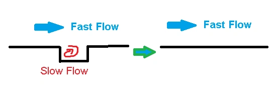

b) Cavities
Cavities create a slow flow as shown in the following image. It is best to remove cavities. The coexistence of fast and slow fluid regions cause slow solver convergence. Besides of this, solving for the swirling flow inside the cavity increases the simulation time.
Here is an example. Under the impeller, there is usually a bearing holding the shaft. Depending where the shaft stops, there is a small cavity where the pump fluid can enter, as shown in the next image on the left (with the arrows 1 and 2.)
Instead of solving for the swirling flow there, it is better to remove and close that cavity, as shown in the image on the right. Systematically using a section view of the fluid domain is very important to see where the fluid is going, and to act accordingly.

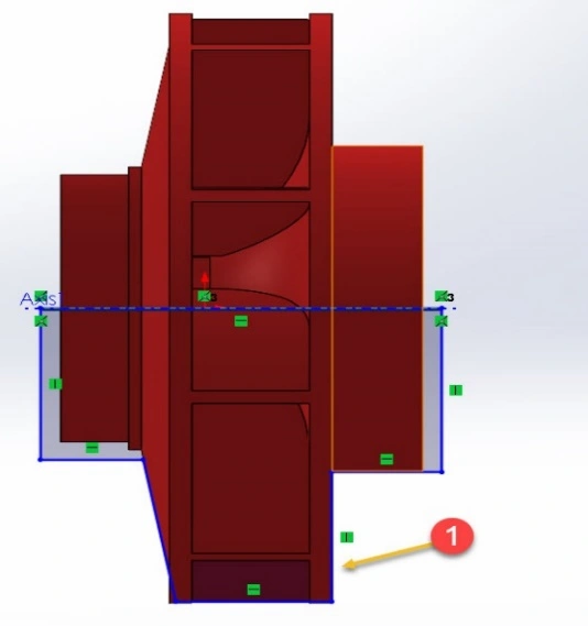

4) Creating the Rotating Region
You need to draw the rotating region (RR) in the SOLIDWORKS application. The RR captures the rotation of the impeller, and the fluid that is in close proximity to the impeller. In a sketch, you can draw the rotating region outline and then use a revolve operation. When doing so, follow these guidelines:
  • Ensure that the RR envelops (and not just touches) the impeller and a small amount of fluid.
  • Ensure that the RR is axisymmetric and concentric with the impeller (same axes).
Make sure that the RR is not tangent to the entire impeller body. If the RR is tangent in some location, as shown by arrow #1 in the next image, it can lead to a Solver Abnormal Termination error at iteration 0, or SOLIDWORKS Flow Simulation fails to generate the mesh. In that case, redraw the RR and try again. A common error that users make when including the rotating region in an assembly, is to use a coincident mate between the top surface of the impeller and the top surface of the rotating region. As a best practice, use an offset distance instead of a coincident mate.
Ideally, the RR is halfway between the impeller and the casing as shown in the following image on the right.
When using a schematic in an ideal situation, the RR boundary is half way between the impeller and the stator (volute wall), as shown in the next image.
Here, the clearance between the impeller and the casing is exaggerated. In practice, the clearance is actually very small. If the volute wall is too far, then make the RR boundary a little larger than the impeller outside boundary. If the volute wall is too close, you can expand the RR boundary inside the stator, as shown in the following image.
By placing the RR boundary within a solid instead of placing it into a narrow gap between the impeller and the stator, you can avoid the additional mesh refinement.
A simple trick is to extend the gap. You can make the gap a little bigger, which can be a good exercise to become familiar with the pump simulation. In most cases, the gap between the rotor and the bottom wall is narrow, as shown in the next image at the left. By enlarging that gap a little as shown in the image at the right, you can place the boundary of the RR halfway between the impeller and the stator. This reduces the mesh requirement and therefore reduces the simulation time. In addition, this does not affect too much of the pump’s efficiency curve. Therefore, it is a good starting point.
In summary, the RR should envelop (and not just touch) the impeller and a small amount of fluid. If the gap between the impeller and the stator is tiny, you can, as an exercise, make the gap a little bigger so that you can place the RR boundary halfway between the impeller and the stator. This does not increase the simulation time too much, and provides a rough estimate of the performance curve.
