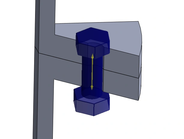

A SOLIDWORKS Simulation bolt connector is a simulation abstraction that makes it possible to model the effect of bolting components together without the need to mesh and solve the actual geometry. A bolt connector not only helps to connect parts, it also helps to transfer loads between parts, resist and take on preloads or external loads, and avoids using actual geometry. Most importantly, the bolt connector reports several different results such as axial force, shear force, bending moment, etc., to help you with a better understanding to determine bolt sizing.
4) Bolt Connector – Technical Definition
It is possible to define bolt connectors through a mixed stack of solids, shells, and sheet metal bodies. It is also possible to define bolt connectors by selecting entities of the same component.
a) SOLIDWORKS Simulation bolt connector method.

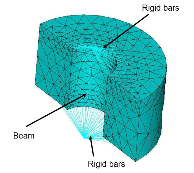

SOLIDWORKS Simulation uses its own bolt connector method. This method is similar to the spider bolt method as explained in “Methods for Modeling Bolts in the Bolted Joint” by Jerome Montgomery, Siemens Westinghouse Power Corporation, Orlando, FL. In reality, SOLIDWORKS Simulation uses a beam element to represent the bolt shank and uses rigid bar elements to connect the beam to the flanges. The software simulates the bolt preload by using thermal expansion and contraction. For example, to generate the preload force, it contracts the axial length by an appropriate amount. This calculation of the thermal expansion and contraction is automatically done by the solver. The method used comes from ”Modeling Pretensions in Bolted Connections”, by J.M. Stallings and D.Y. Hwang, Computers & Structures, Vol. 45, No.4, pp 801-803, 1992.
It is important to note that the beam used between the two ends is tension-resistant only (no resistance to compressive force). In fact, this feature is the reason for the problem to become nonlinear (in the absence of any other nonlinearity), and simulate a contact behavior (but in opposite direction to no-penetration contact due to the tension-resistance feature of it). That is why the problem must go through iterations and subsequently becomes slower (in the absence of any other nonlinearity such as actual contacts defined between the parts).
b) Rigid bars implementation for solids
Depending on the type of bolt connector used, the number of rigid bar elements depends directly on the type of mesh created. There are two types of fit options:
Loose fit bolt: On each side of the modeled bolt, the number of rigid bars is equal to the number of nodes on the face that are in contact with the nut and the screw head respectively. Therefore, it can only be determined after meshing the model.
Tight fit bolt: In addition to the rigid bar elements as generated for a loose fit bolt, SOLIDWORKS Simulation generates the rigid bar elements between the nodes on the cylindrical surfaces that are in contact with the screw shank and the node from where the spider arrangement originates.
There is no need to use split lines at bolt head and nut diameters because SOLIDWORKS Simulation will internally do some imprinting to get the head and nut area and mesh it. The mesh data is transferred to the analysis. The number of rigid bars is still equal to the number of nodes on the head or nut area for loose fit bolts and for tight fit, and the number of rigid bar elements is equal to the total sum of the nodes on the head, nut and cylindrical surfaces of the bolt. In more recent versions, the options to select the split surface have been removed.

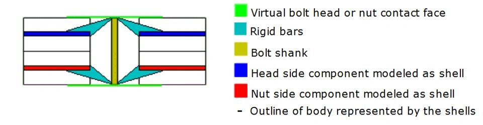

c) Rigid bars implementation for shells

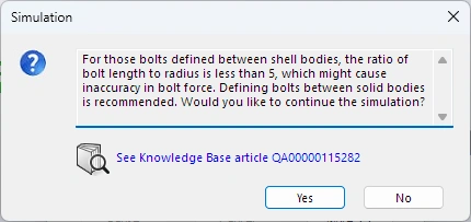

It has been determined that the result forces on bolt connectors defined between shell surfaces were not sufficiently accurate when the bolt shank was too bulky. A message will appear only when the ratio of bolt length to the shank radius is lower than 5. The user is then advised to define the bolt between the solid bodies.
For bolt connectors defined between shells, the following warning message appears at the beginning of the simulation:
The bolt radius is taken as half the Nominal Shank Diameter entered in the Bolt Connector PropertyManager.
The rigid bars construction for bolt connectors defined between shells is in the following manner:

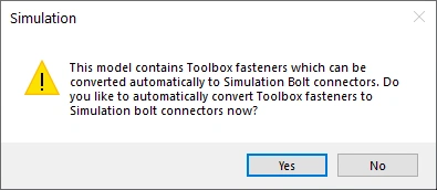

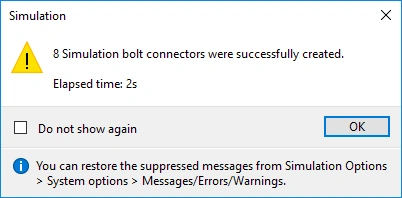

iii) First time you define a simulation bolt connector
If there are Toolbox fasteners in the SOLIDWORKS model that have not been excluded in the current simulation study, the following message will appear the first time a user defines a simulation bolt connector.

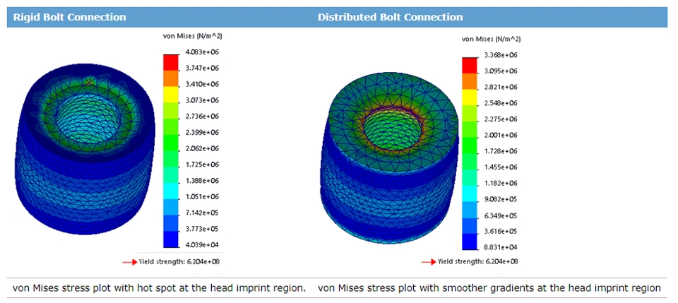

Starting in SOLIDWORKS 2020, the introduction of distributed coupling enhanced the formulation of the bolt connectors. Distributed coupling allows the faces attached to bolt connectors to deform, which delivers a more realistic representation of a connector’s behavior.
When you set the Connection Type to Distributed, a distributed coupling formulation connects a reference node (beam element node of a bolt shank) to a group of coupling nodes inside the imprint regions of a bolt's head and nut. Distributing coupling constrains the motion of the coupling nodes to the translation and rotation of the reference node. Nodes located inside the head and nut imprint areas can deform relative to each other.
This constraint is enforced in an average sense in a way that enables control of the transmission of loads through weight factors at the coupling nodes. For example, the constraint distributes a bolt's pre-load such that the sum of the forces at the coupling nodes is equivalent to the total pre-load at the reference node. Uniform weight factors are applied in this case.
As shown in the previous image, the von Mises stress plot shows a hot spot at the head imprint region when using Rigid Bolt Connection. In contrast, the von Mises stress plot shows smoother gradients at the head imprint region when using Distributed Bolt Connection.

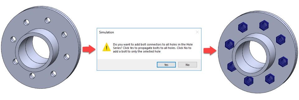

g) Propagating Bolt Connectors to Other Holes
There are lot of automation tools that leverage smart intelligent data from SOLIDWORKS to save you a lot of time. This is especially true when dealing with many bolt connectors in your assembly. For example, the Hole Series feature in SOLIDWORKS allows you to create a series of holes through the individual parts of an assembly. Using this feature in SOLIDWORKS allows the option to propagate the bolt connector to be available at your disposal and fast track your productivity when defining a bolt connector.
