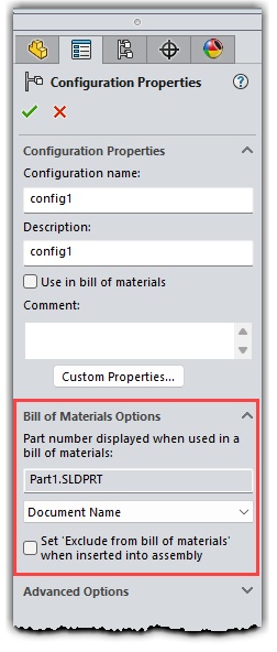

The name and Part number displayed when used in a bill of materials property, for each configuration, determine whether a configuration is updated to a Physical Product configuration or a Representation configuration. The following logic, which applies to parts and assemblies, satisfies the majority of use cases.

• If there is a configuration named Default, it takes precedence to update as a Physical Product configuration.
• Document Name updates to a Physical Product configuration.
• If there are multiple configurations with this property and one is named Default, then all others update as Representation configurations of Default
• If there are multiple configurations with this property and none are named Default, then the first history-based configuration updates as a Physical Product configuration, and all others update as Representation configurations of the first.
• Derived configurations with this property update as Representation configurations.
Configuration Name updates as a Physical Product configuration.
• Derived configurations with this property update as Physical Product configurations.
User Specified Name updates as a Physical Product configuration.
• If a User Specified Name matches a Configuration Name, then it updates as a Representation configuration of the matching Physical Product configuration.
Link to Parent Configuration updates as a Representation configuration.
Collaborative Designer for SOLIDWORKS +
SOLIDWORKS 2023 SP3.0 and older versions
Document Name updates as a Representation configuration and the system automatically creates a parent Physical Product configuration with a name that equals the Windows file name.

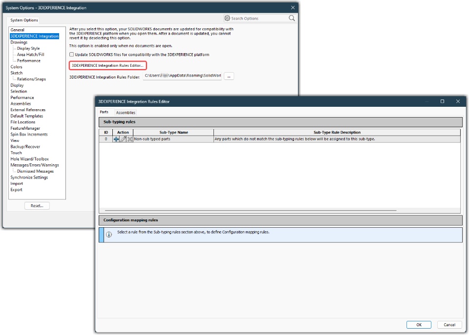

If you have very specific use cases or company standards to follow where the system-coded update logic does not give you the desired result, then you can create user-defined update logic instead, using the 3DEXPERIENCE Integration Rules Editor.
NOTE: This utility is only available in SOLIDWORKS Design and Collaborative Designer for SOLIDWORKS + SOLIDWORKS 2024 SP0.1 and newer versions.
The 3DEXPERIENCE Integration Rules Editor cannot be launched separately.
It must be launched from within the 3DEXPERIENCE Integration page of the SOLIDWORKS system options.
Unlike the system-defined update logic, which applies to parts and assemblies, the 3DEXPERIENCE Integration Rules Editor allows you to define different update logic for both file types, if needed. Defining update logic requires two sets of rules:

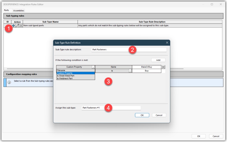

1. In the Sub-typing rules pane on the Parts tab, click the button.
2. In the Sub-Type Rule Definition dialog, enter a description for the rule.
3. Define a condition that identifies the parts based on any combination of: filename, custom property, is sheet metal part, or is weldment part. In this example, a custom property named MakeOrBuy that equals Buy is defined.
4. Give the sub-typing rule a name, then click OK to save.

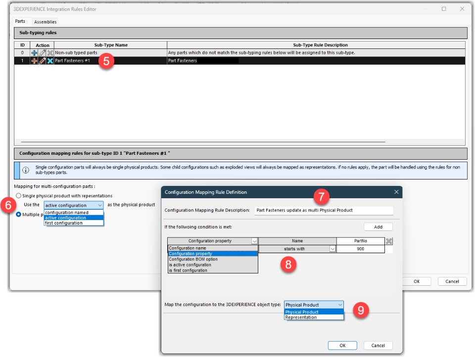

5. Select a sub-type rule.
6. Choose a configuration mapping. In this example, Multiple physical products.
7. In the Configuration Mapping Rule Definition dialog, enter a description for the rule.
8. Define a condition that identifies the parts based on any combination of: configuration name, configuration property, configuration BOM option, active configuration, or first configuration. In this example, a configuration property named PartNo starts with the number 900.
9. Choose a configuration mapping object type. In this example, Physical Product.

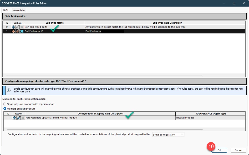

10. Click OK to save the rules.

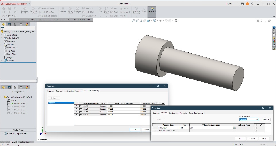

Before updating for 3DEXPERIENCE compatibility

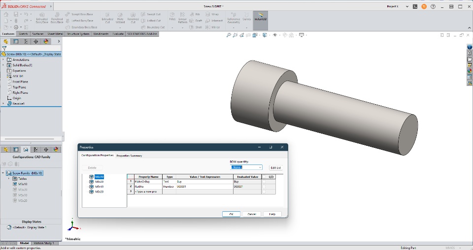

After updating for 3DEXPERIENCE compatibility
