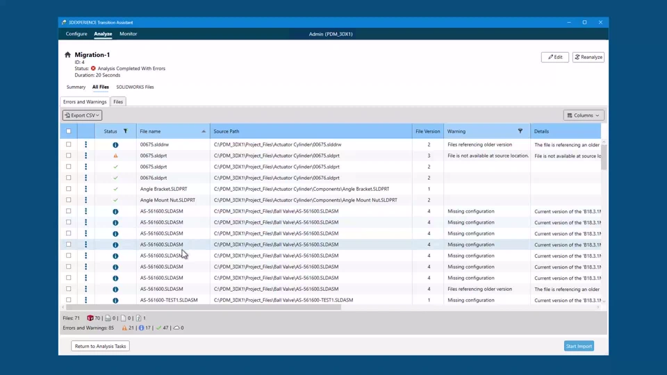

Improved Analysis Result View
Get a clearer picture of migration issues with a new Files tab that shows one line per file alongside the existing Errors and Warnings tab. The expanded summary at the bottom now also shows the count of each SOLIDWORKS file type analyzed, making it faster to assess scope and prioritize fixes.

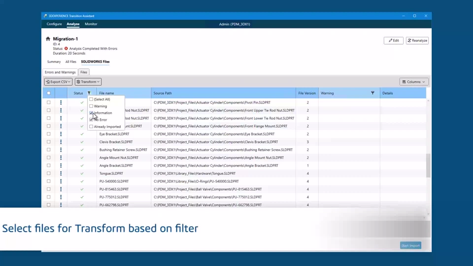

Improved Transform File Selection
Filter files for transform operations by Status and Warning to target only the files that need updating, reducing unnecessary transforms and saving time on large migration sets.
