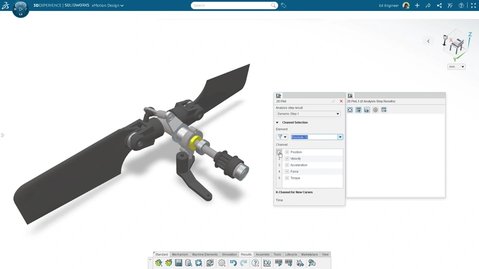

Interference Probe for Clash/Clearance Visualization
The interference probe enables you to investigate clash and optionally, clearance situations in your model. Any clash or clearance situation is indicated in the 3D view through highlighting the affected bodies in red. Visualize clash volume, minimal distance (for clearance situations), similar to the minimal distance probe, and clearance violation locations. This will reduce the turnaround time for clash and clearance violation analysis by directly reviewing clash volume and clearance information in the 3D view.
User Defined X-Axis Channels in 2D Plot
Improve your understanding of the mechanical system behavior by generating 2D plots over desired X- channels/axis. Pick and replace the default simulation time parameter with a suitable result output as the X-channel of the 2D Plot. This parameter will be stored for any new curves. All curves that are added to the plot later shall then use this output as the X-channel. Replace the stored X-channel by another X-channel or restore the default by resetting the stored X-channel back to the simulation time.
